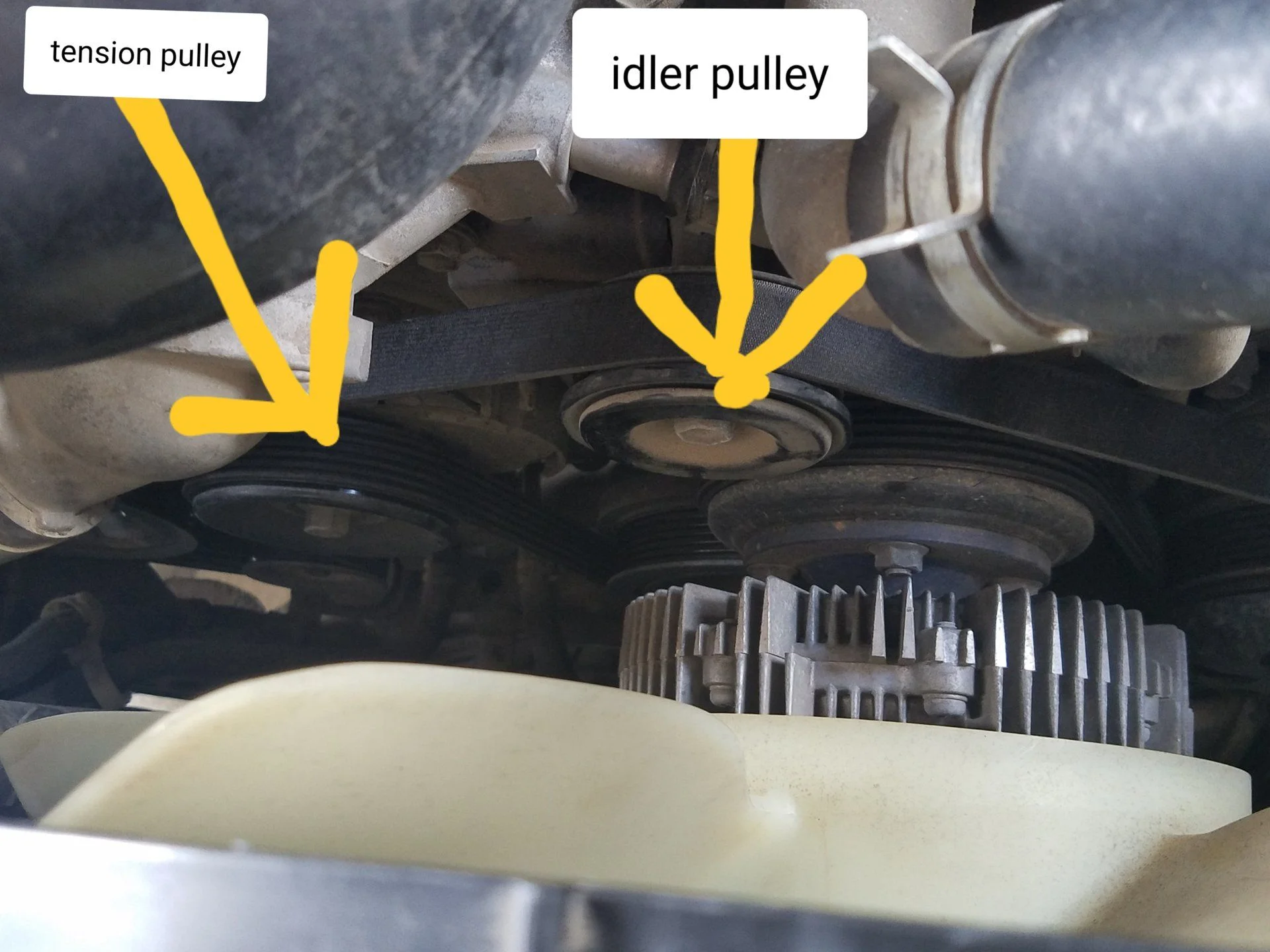

I pulled the belt off the tension pulley this am. The tension pulley still has solid tension on it(i didnt spin that pulley) I spun the idle pulley and it spun but it was wasnt smooth, there was a noise there but it still spun. Here are my questions:
1. How big of a pain is it to re-route the belt once i completly pull it off, i see diagram, just wondering how big of a pain it is.
2. Im assuming that idle pulley has a dry bearing in it, that one looks like its just pull and replace, not much to it.
3. The tension pulley looks the same, assuming the tension part is good, i should only need to replace the pulley right?
4. Would yall do both pulleys and belt at same time or just replace belt and idle pulley?
I have attached a pic so yall can verify im not a complete idiot. Ive done spark plugs on this engine so this should be easier right? Would you pull the mass air stuff to access pulleys?
I'd replace everything while in there if you were gonna do it. Replacing the belt is a pretty simple task, just remove the intake piping to get easier access to the belt. Might be easier to seat the belt onto the crank pulley from underneath if you already have your skid plate off.
I had the same squeak on start up. Removed the serpentine belt and gave the idler pulley and the tensioner pulley a good spin. The idler pulley sounded dry. Installed new idler pulley and a new serpentine belt. Squeak is gone.
NOTE the old idler pulley would spin longer than the new idler pulley. Bearings were tight on the old pulley but they sounded dry. I did read some posts on here about replacing just the bearings and reusing the pulley. Another post said that you can oil the bearing as a short term fix.
I just took the belt off again so i could go ahead and check the tension pulley, that pulley felt great, rolled smooth. Rolled the idle pulley again and its not near as smooth but still rolls. My belt looks great! I think i might just do idle pulley see if that helps the situation. I dont have a press so i think i will have to just buy the pulley wheel with new bearings. How much did that idle pulley run you?

Just replaced the tensioner pulley and idler pulley and belt yesterday on mine after having squeaking for a few weeks. Took 15 minutes. Super easy. I didn't replace the tensioner itself as it still felt strong and requires more parts removal. Tensioner pulley bolt is reverse threaded FYI.

@J1000 changed my idler pulley and still get a squeak at start up. Don't know whether to spring for a belt next or pulley on the tensioner? My tension pulley still has great tension and the pulley spins freely. When you changed yours does the pulley come off just like the idler pulley? I don't think I need to changed the whole unit, just pulley.
