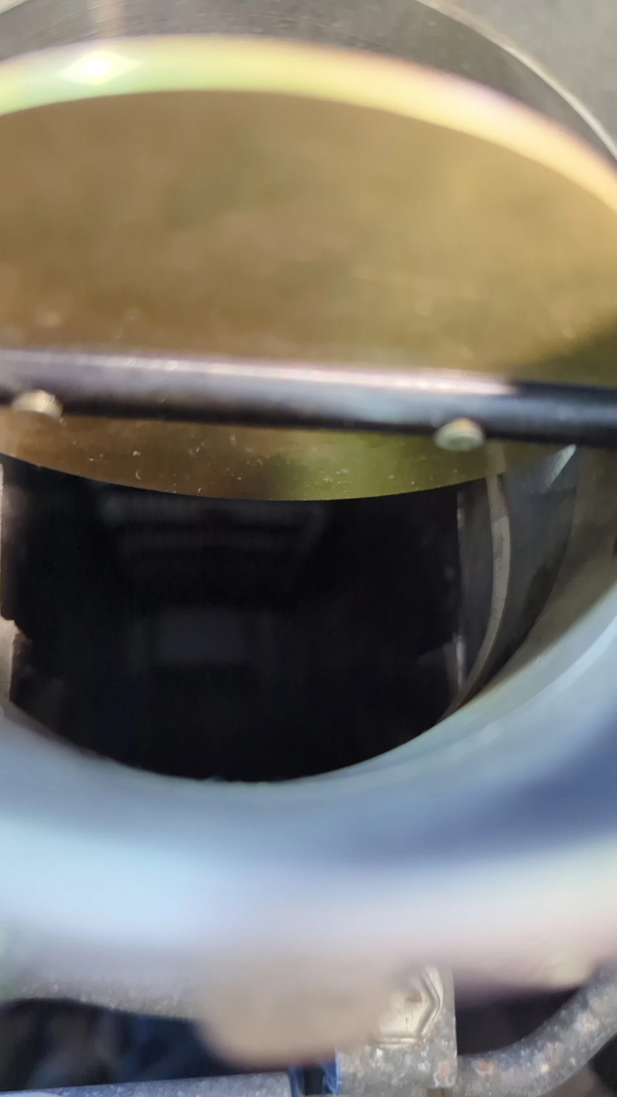

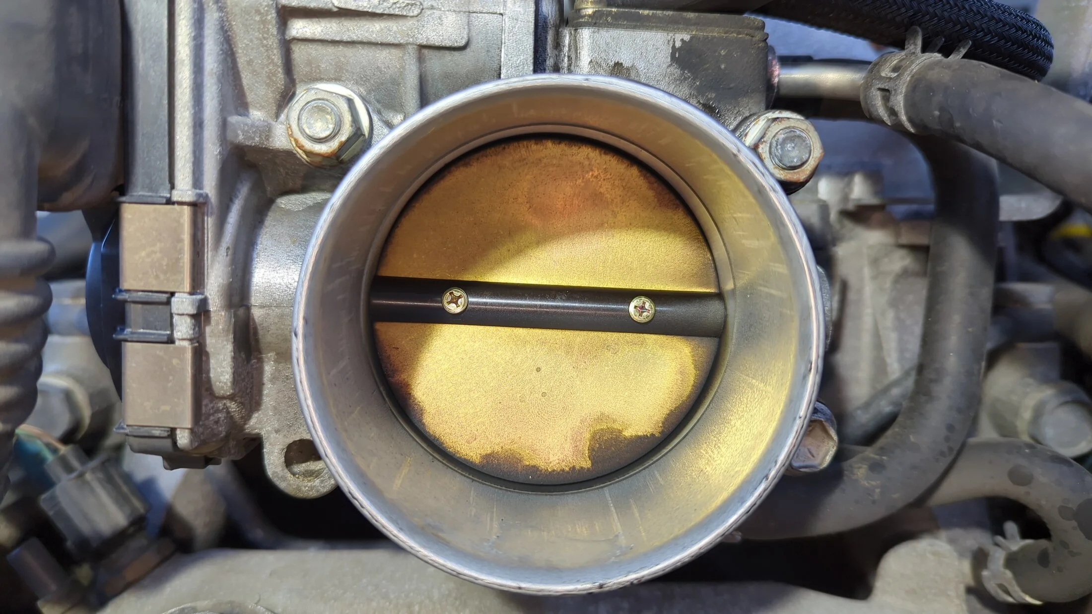

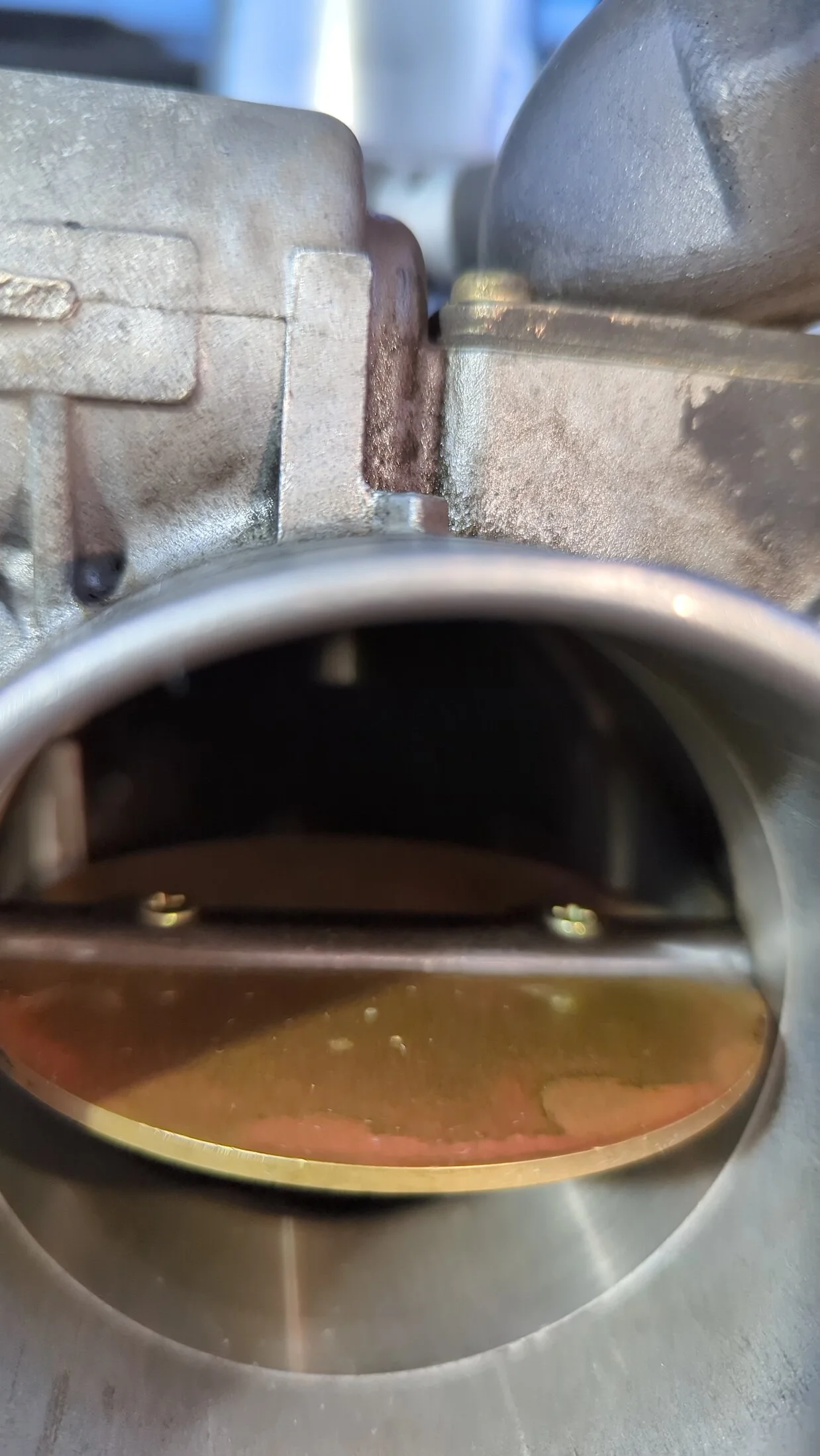

@rexington14 I cleaned the throttle body. It was in need. Here's some pics.
Before. I didn't get a pic behind it, but there was significant carbon buildup.
After, looking a good bit better.
But, this did not fix the issue. Though I may have recovered a horse or two from the motor, based on driving MPG this week.

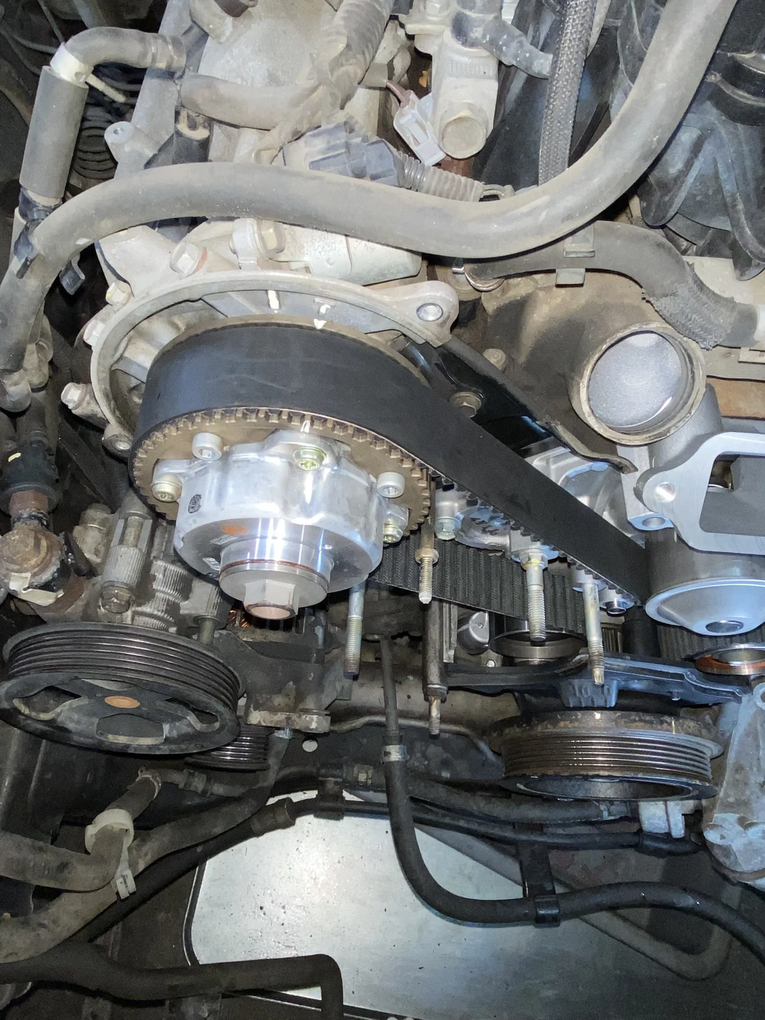

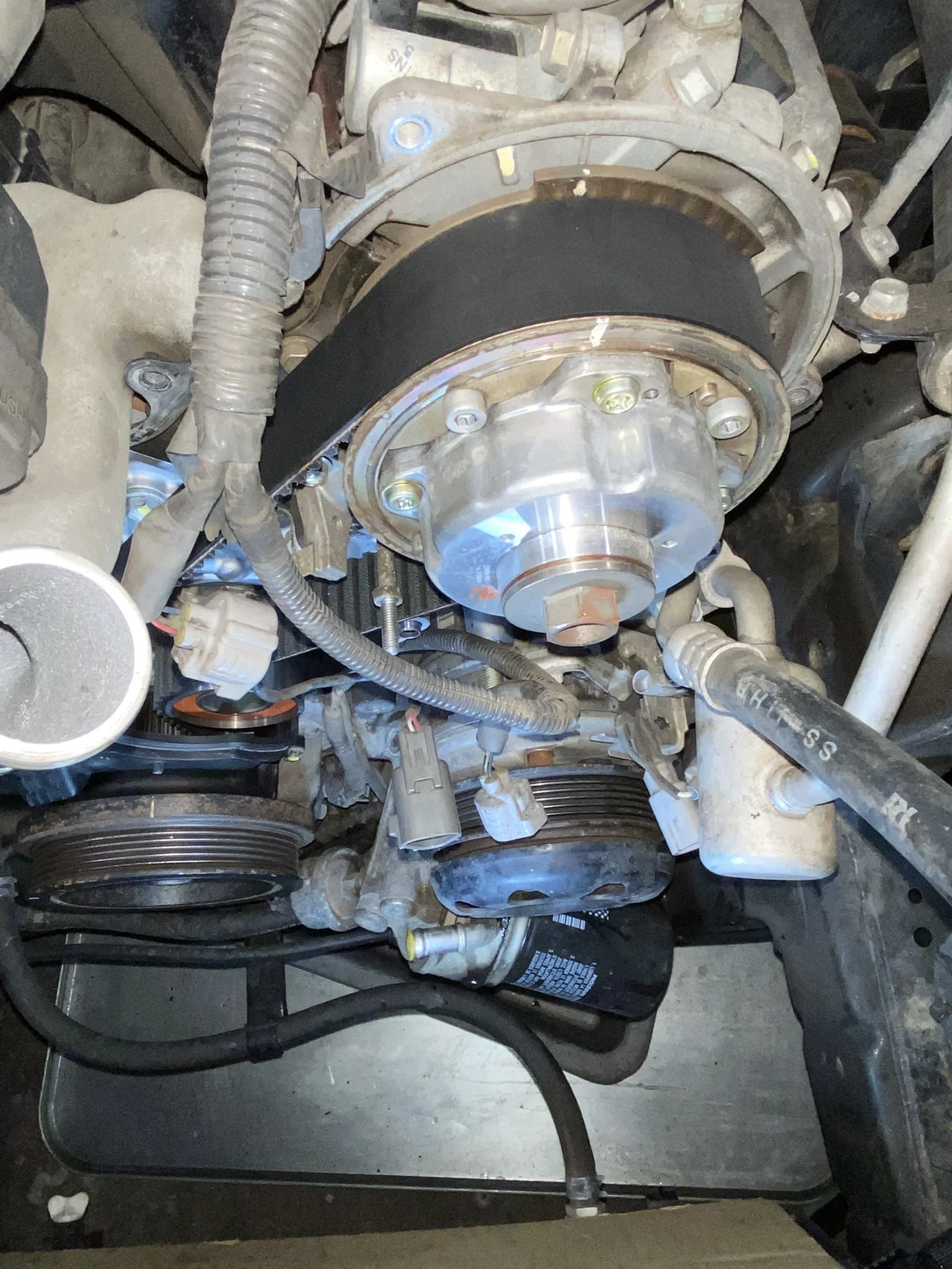

Try listening, from oil pump housing:
If you listen with stethoscope, on oil pump housing. It may yield, chirp pass through sounds from pulley bearing. Since both pulleys are secured to it.
Picture to help, know where to place stethoscope prob. With all covers still on, engine running.
In the end these are all just clues.
Bottom line:. You'll need to remove timing belt. Then spin pulleys and water pump by hand. It's not likely water pump, but check

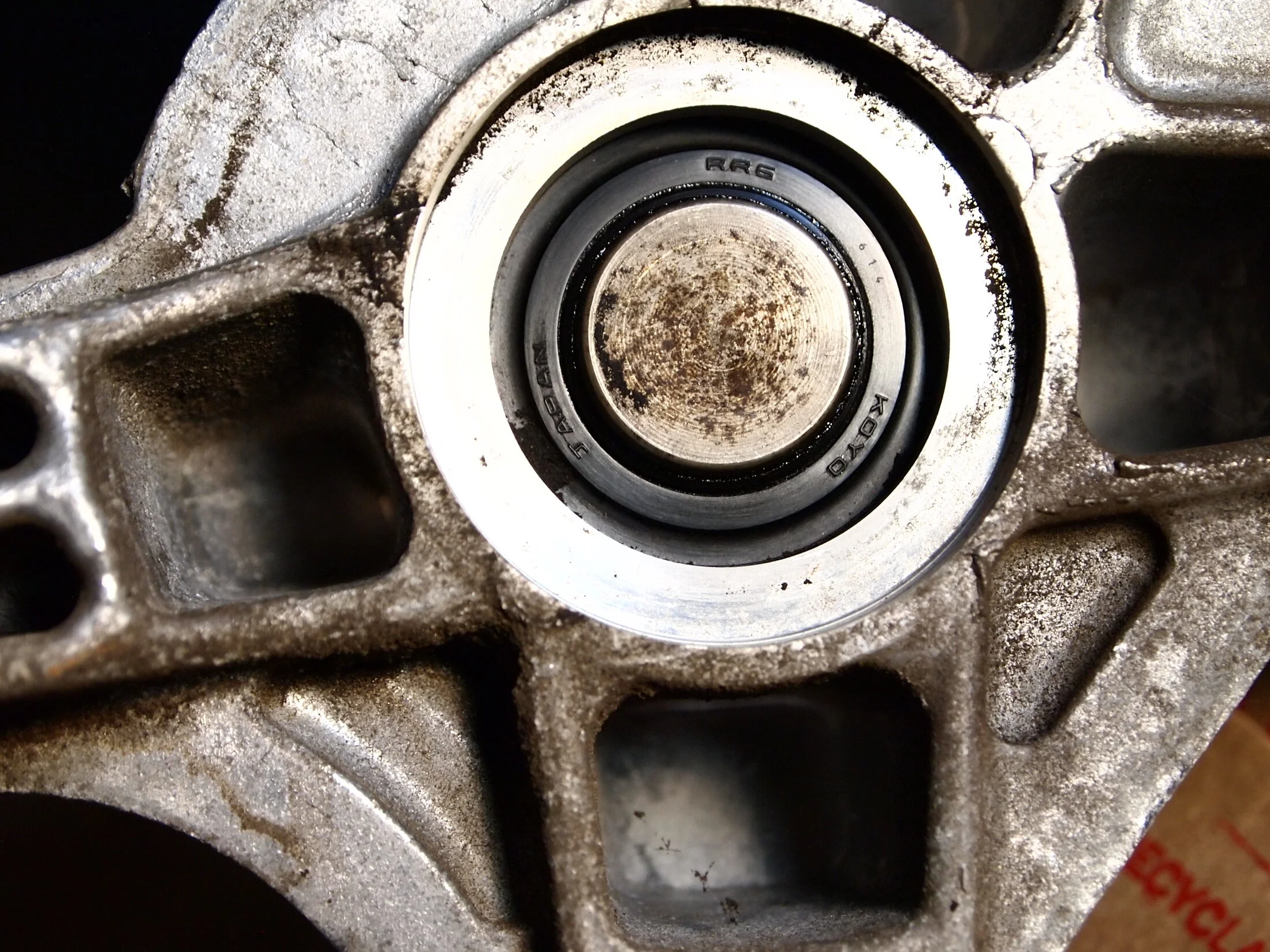

If they didn't replace TB pulleys. It is not likely they replaced fan bracket (FB) or serp belt tensioner. If either even questionable, replace them.

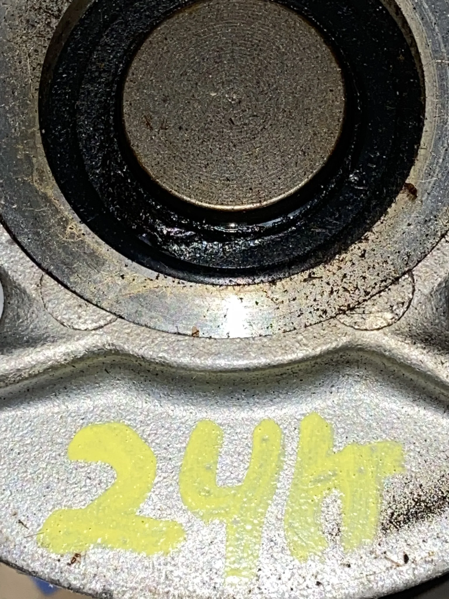

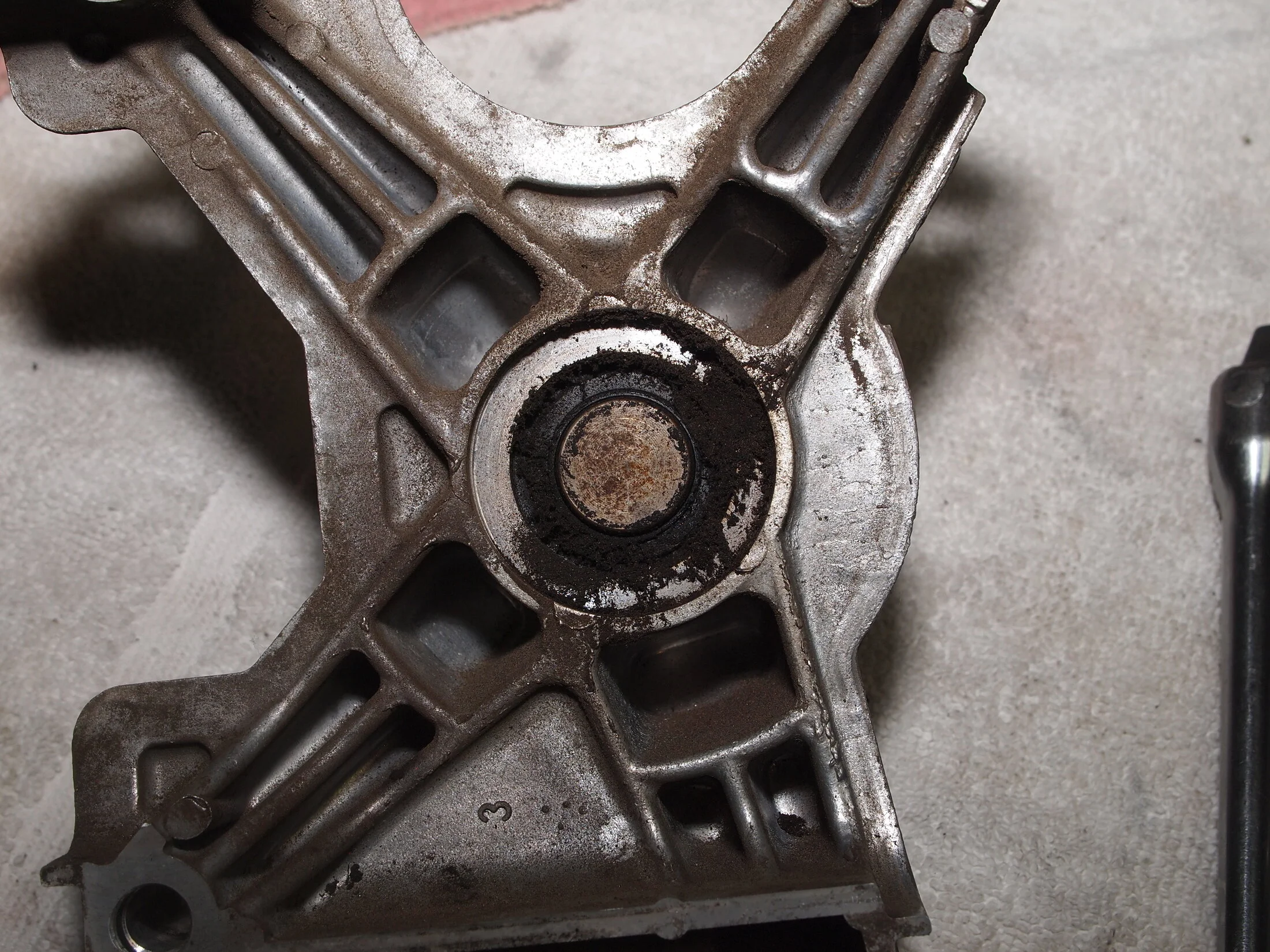

Here's a fan bracket at 18 years and 24K miles. FSM states: any oil coming from seal of FB, replace FB.

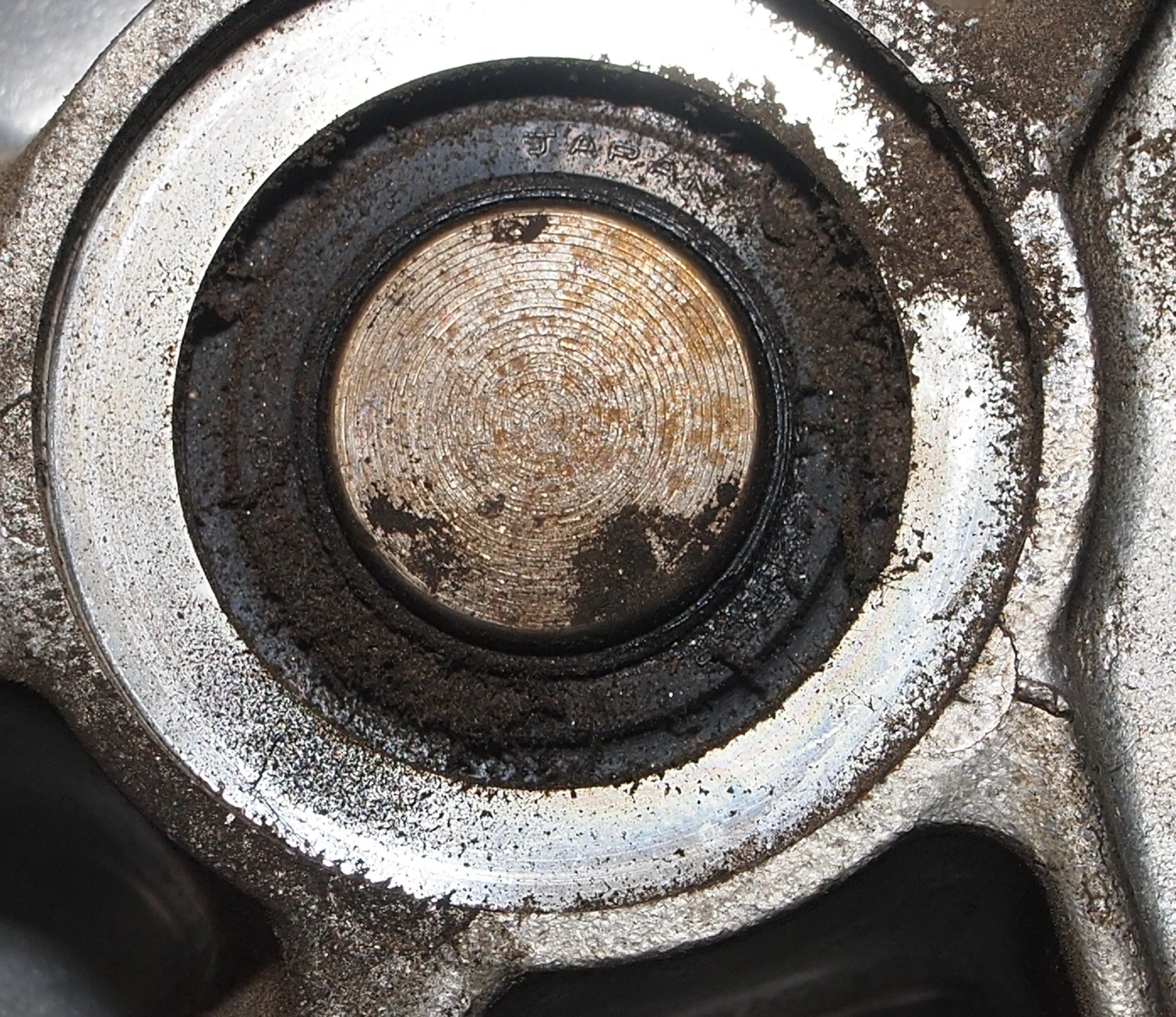

Others at various mileage and ages
This FB seal, was wiped clean. Look close and you can still see the oil shean.
If tensioner pulley makes any sound, or just free spins and keeps spinning. Replace the serp belt tensioner.

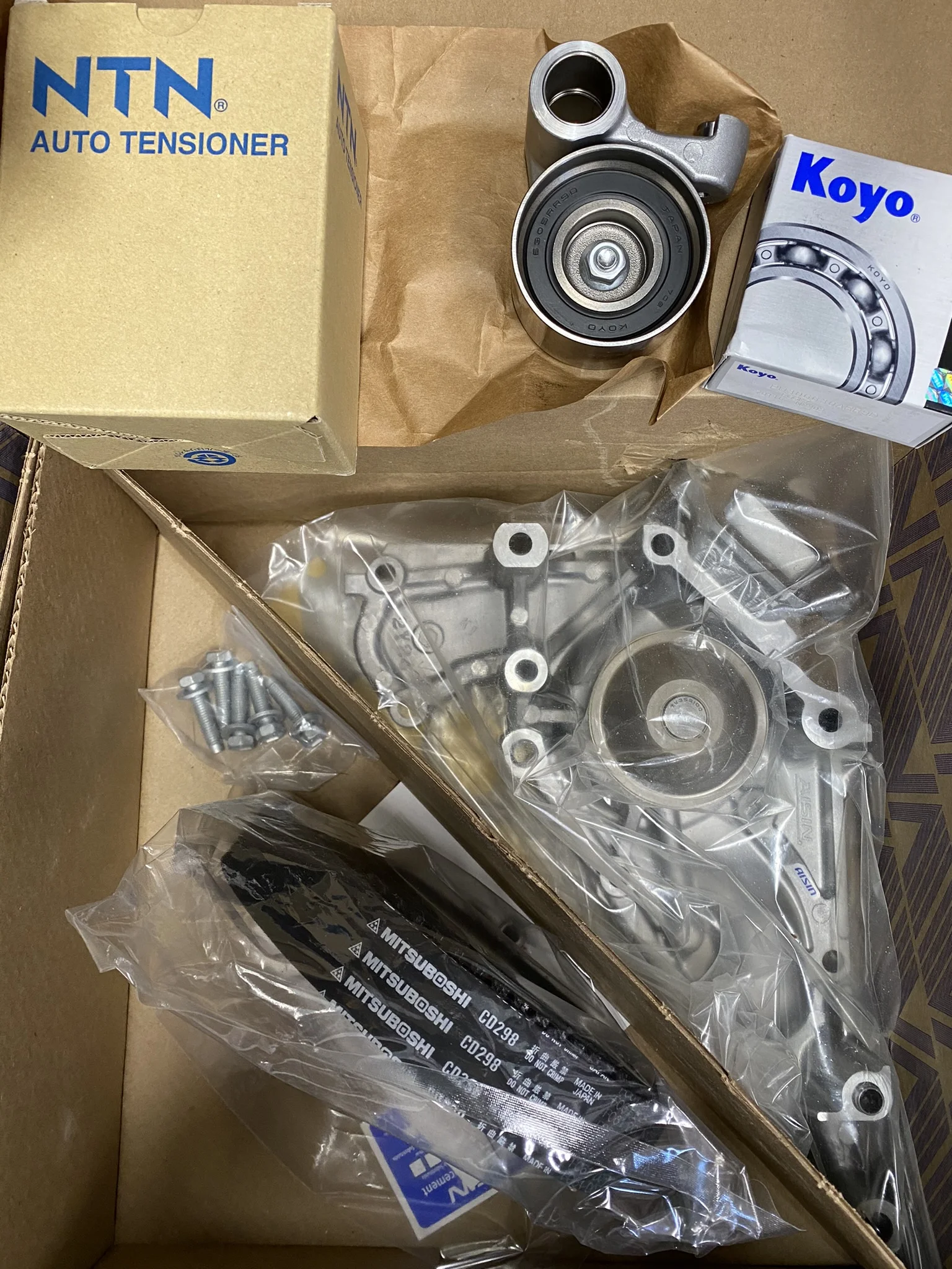

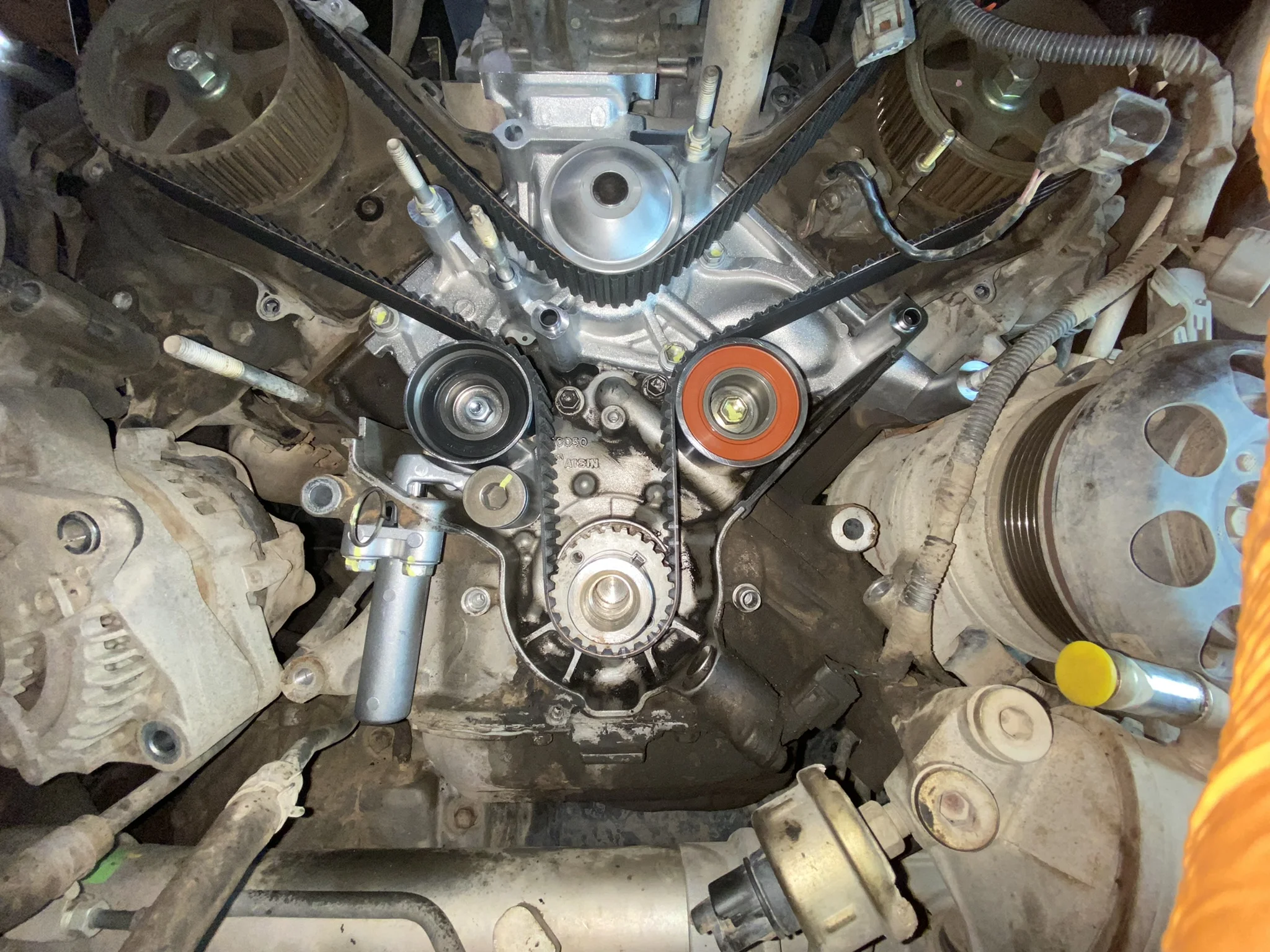

If getting, the Aisin TKT-021 kit. It, has all (belt, pulleys, water pump, both O-rings and tensioner), so may as well. If happy with water pump, that's there. You'll not need water pump or O-rings, or to remove water inlet.
If I don't have to for a low mileage TBelt, is it possible to de-tension the belt tensioner and remove the tensioner pulley and idler pulley while the TBelt is still attached and properly aligned? Then I can just swap them in.
Yes, if belt good. Toyota or Mitsuboshi are good belts. Gates are junk. Oil on belt, don't use.

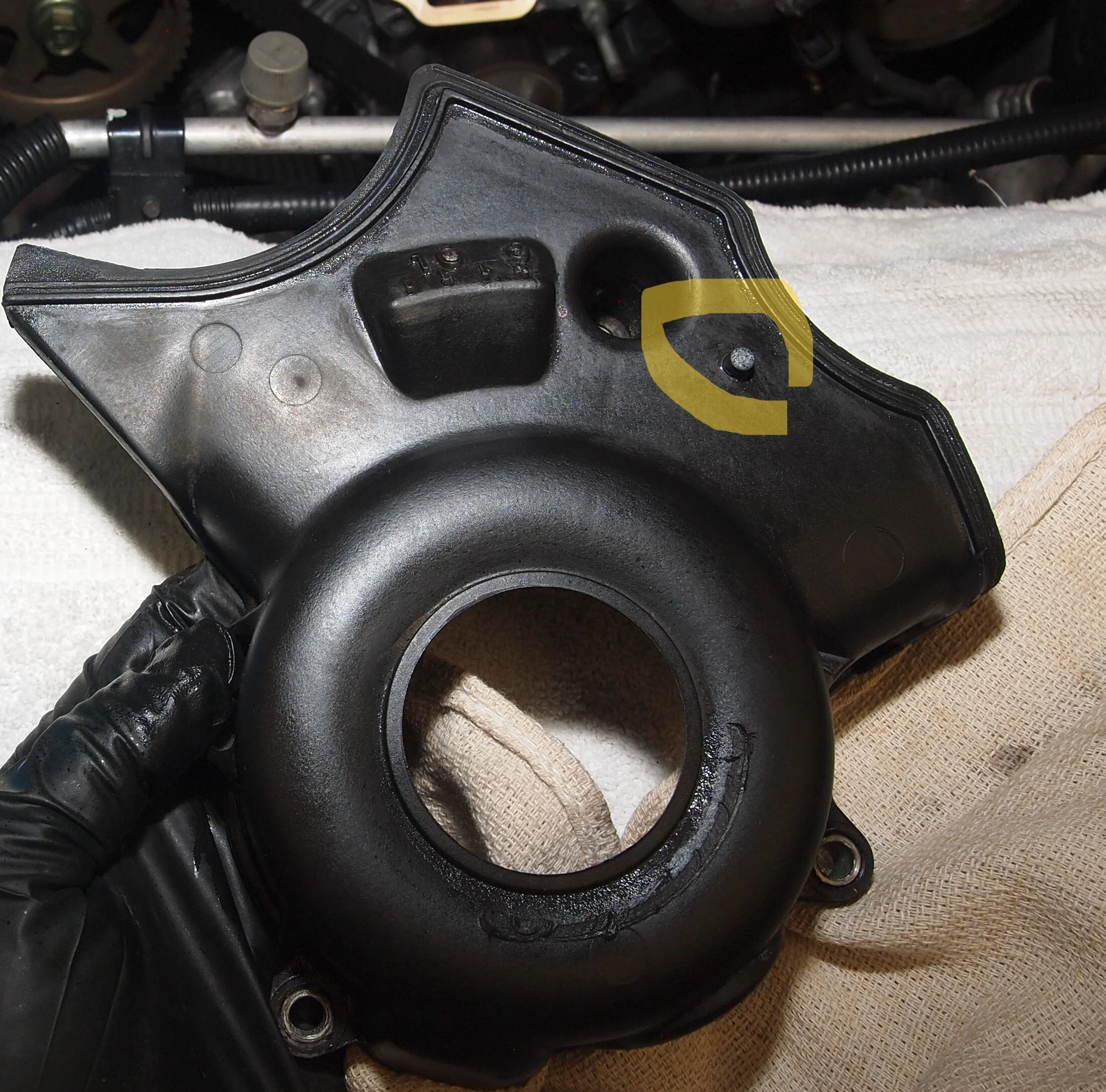

  1. Set crankshaft zero line on the lower T-cover's little peg. Camshafts timing marks on the "T"s. This position, camshafts will hold still.
  2. Place small clamp lightly holding belt on each pulley and crankshaft sprocket. This is so belt, can not change tooth position.
  3. Remove the two 12mm bolts, to pull off tensioner. You'll need to compression a stake, later to reinstall. 19ft-lbf.
  4. Then remove 10mm allen head bolt, from tensioner pulley (idler #1, RH pulley). 25ft-lbf. Very important: Use a sealant on it's threads
  5. Then remover idler pulley (idler #2, LH pulley) 14mm bolt and remove pulley. 25ft-lbf

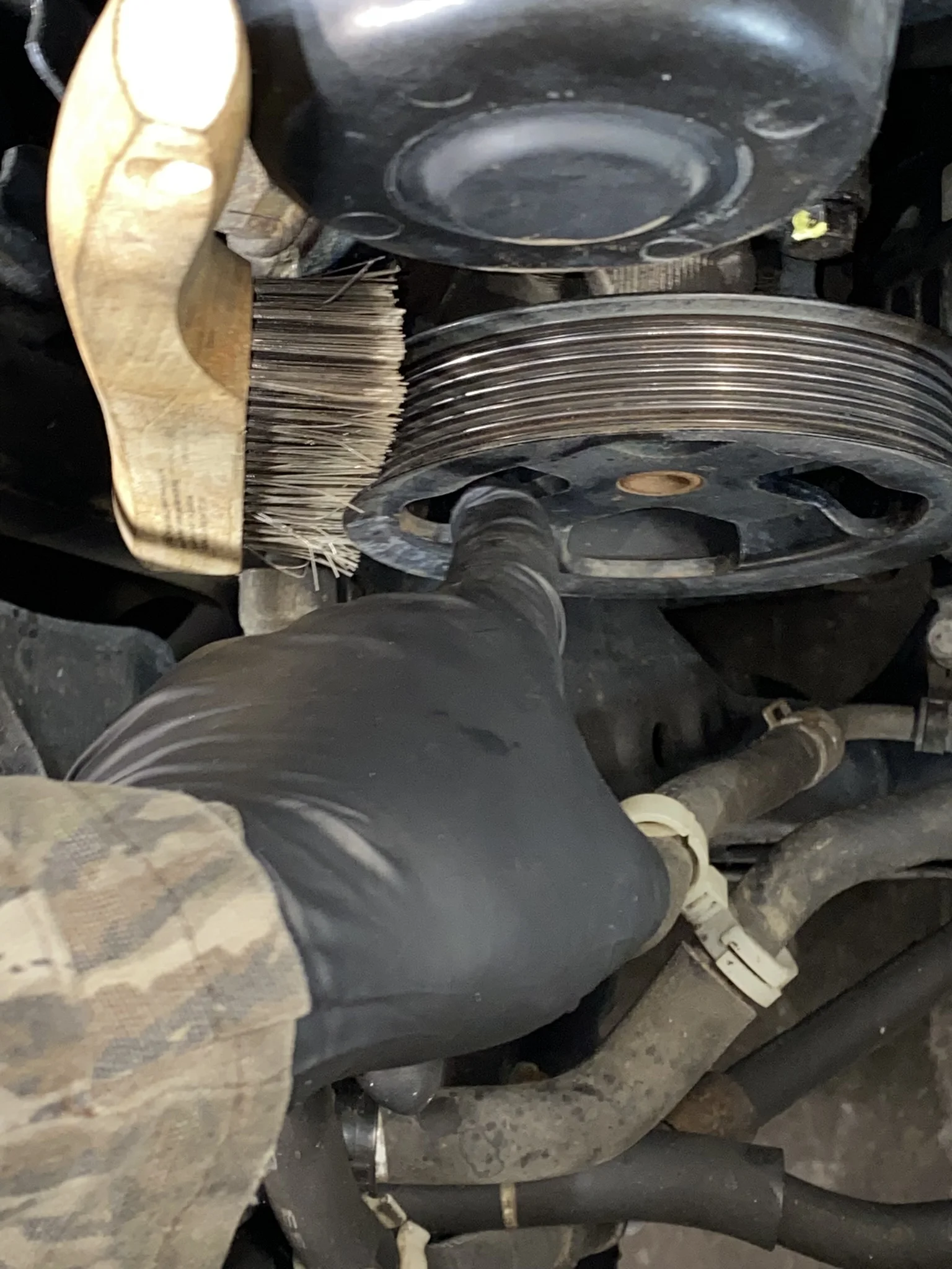

I clean even the grooves of all pulleys, even the serp belt if being reused.
