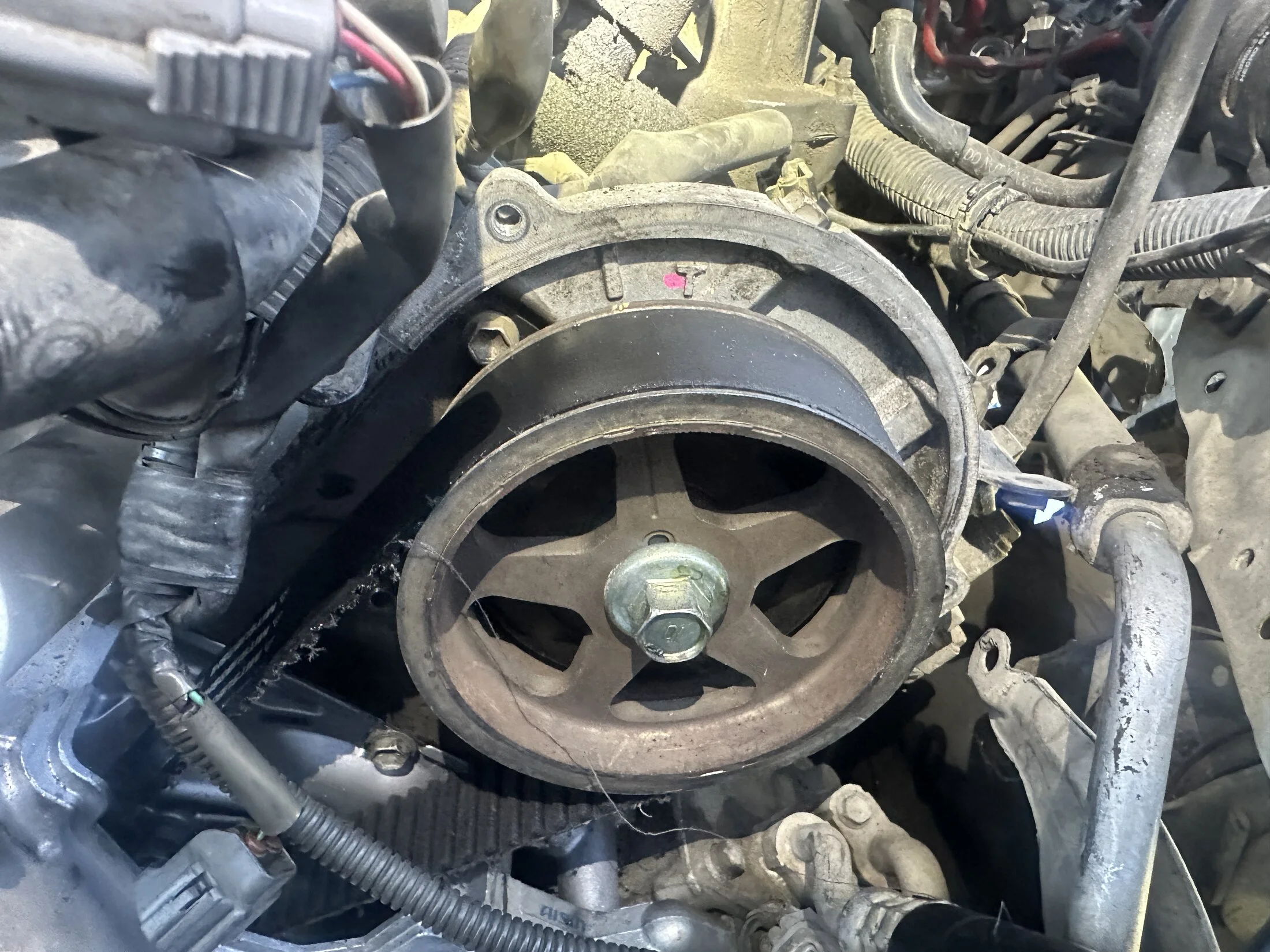

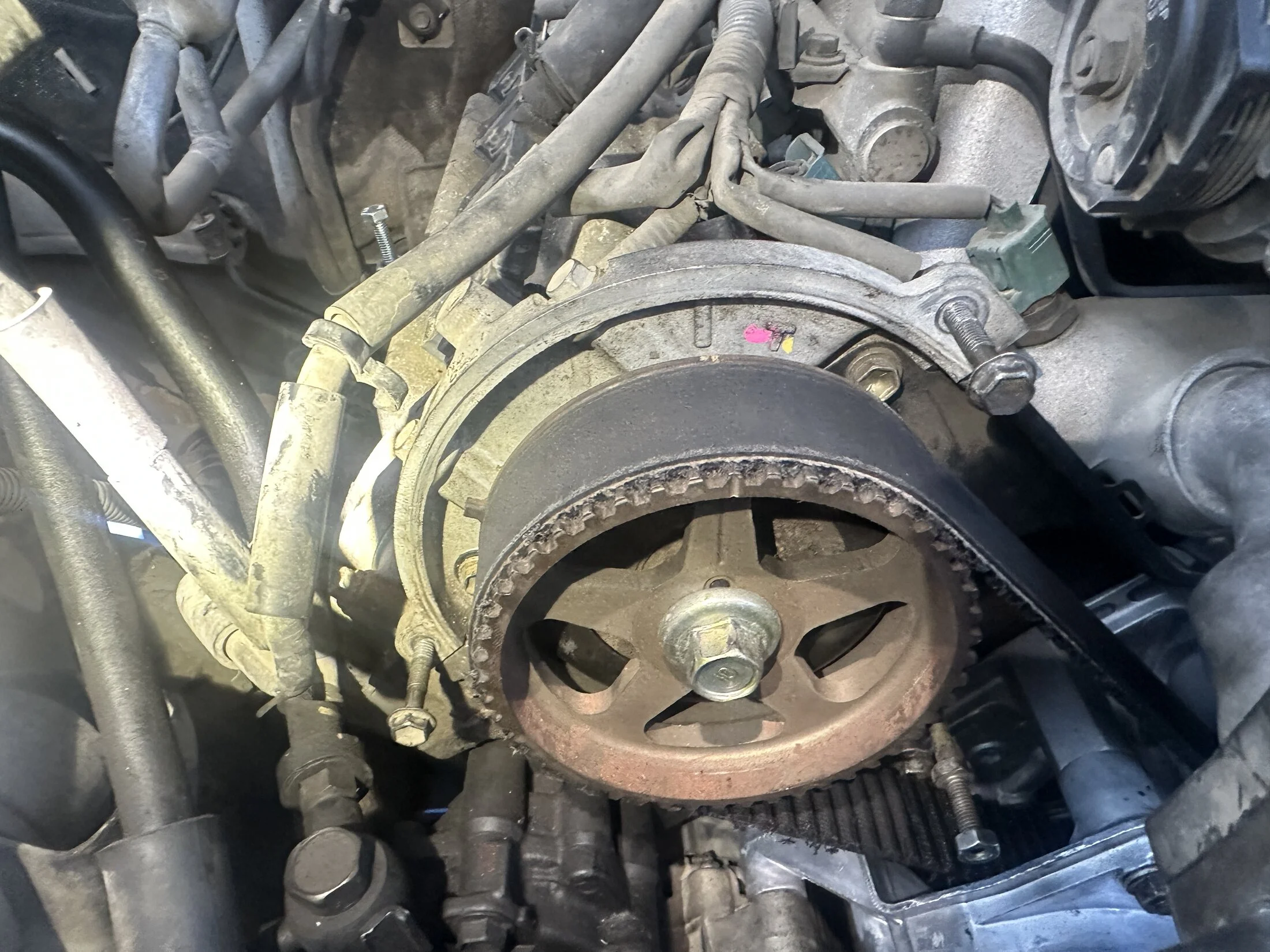

I tore everything back down and hoped to find something obvious—like a pinched or frayed camshaft position sensor wire—but it looks fine. I re-verified the timing alignment, and both the crankshaft and cam pulleys are lined up perfectly (see attached photos).

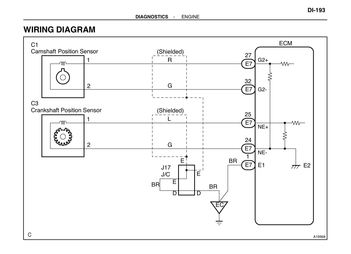

I’m leaning toward a camshaft sensor issue at this point, so I’ve ordered a replacement. While checking the wiring harness at the camshaft position sensor with the ignition ON, I found no voltage. Is the cam sensor supposed to be powered? Or is it just a passive sensor that sends data to the ECU without needing 5V or 12V supply?

That’s what I’m thinking too—it seems like an electrical issue. All the sensors and harness clips I can find are plugged in, so I’m going to start checking voltage and resistance across everything.
Do you know if the camshaft sensor is passive or powered? If it’s supposed to receive power, that could be the issue—I’m not getting any voltage to it with the ignition on.

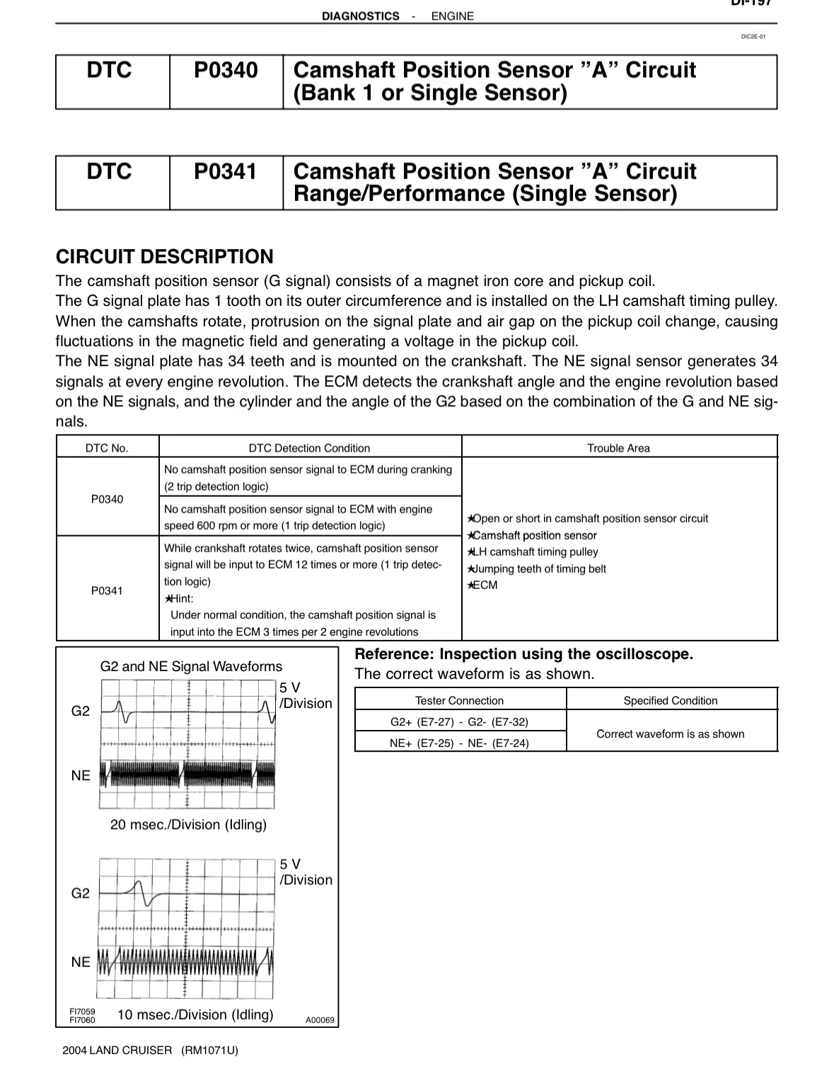

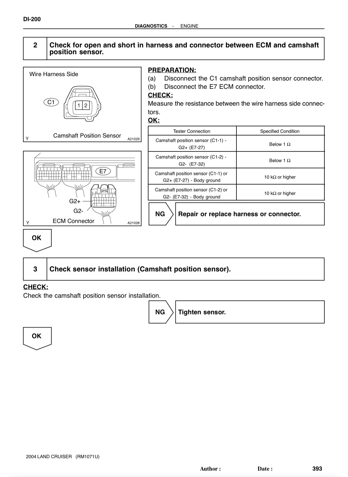

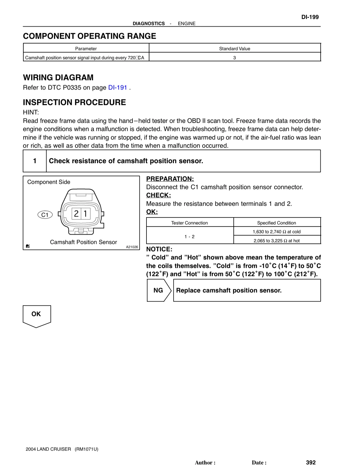

Ya, here are the pertinent pages from FSM. It doesn’t look like the camshaft wiring from ECM sends power to the sensor, so I’m gonna measure resistance between them to rule out wiring issue or faulty ECM. It appears the sensor is passive and only sends a magnetic signal back to the ECM.

I’m not exactly sure what the culprit was, but after reassembling everything, she fired right up and ran like a sewing machine. The only issue I noticed during disassembly was the timing belt guide being installed backwards — that could very well have been the root of the problem. I also replaced the crank sensor with a new one, but since the resistance readings were identical to the old sensor, I doubt the original was faulty.
