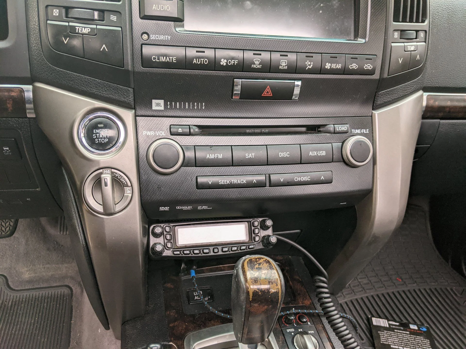

Not having ARB boxes in the back quite yet, I had to find another spot to mount my Yaesu FT-8900. It's not a big radio. And under the driver's seat, and inboard of the computer I found a nicely sized cavity. The radio slotted in there perfectly. I threaded the separation cable up through the a pillar panel and under the dash to get to the center console. It's mounted with hook-and-loop. But nevermind that...what a sweet little cranny for installing a radio!

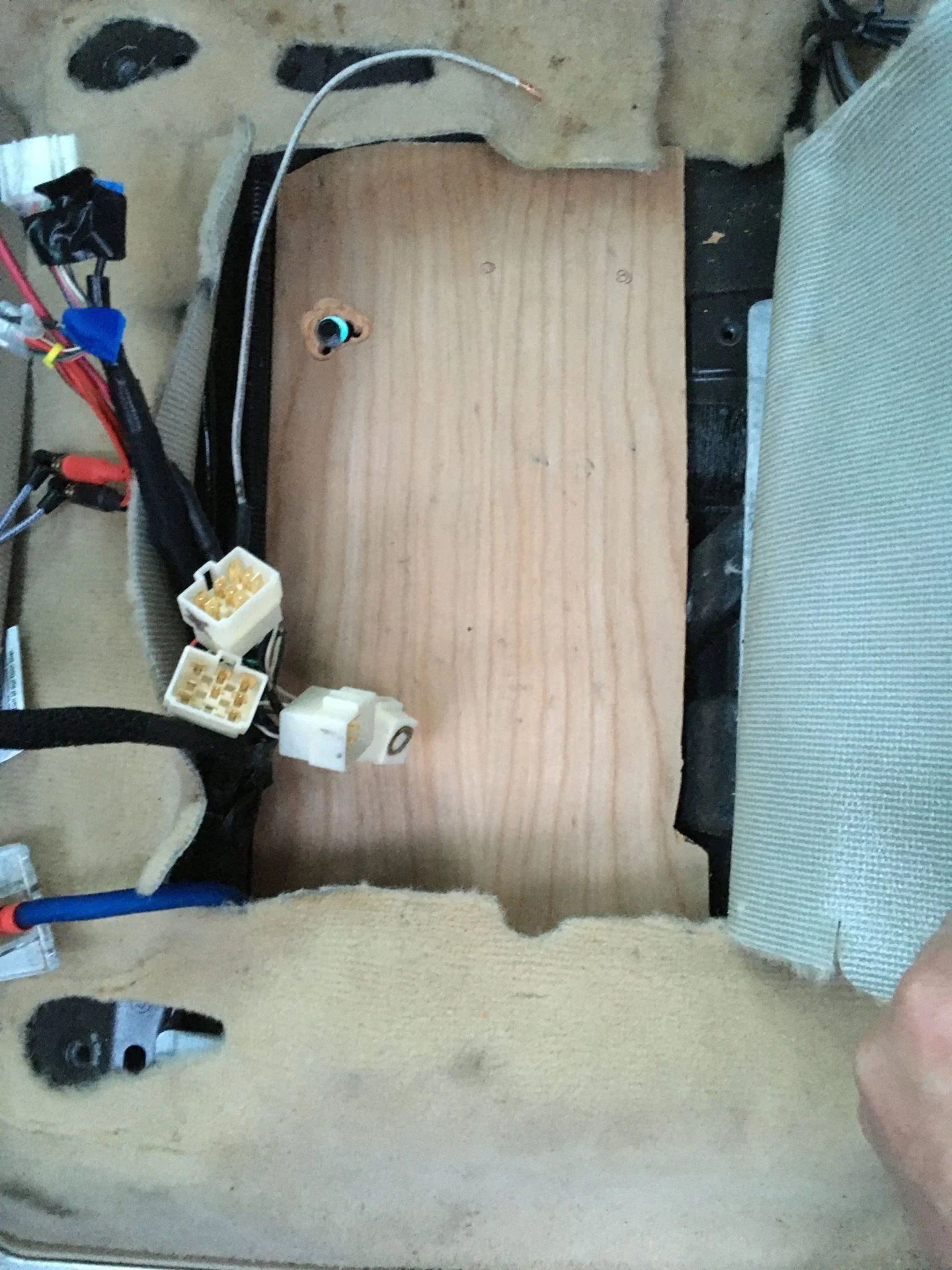

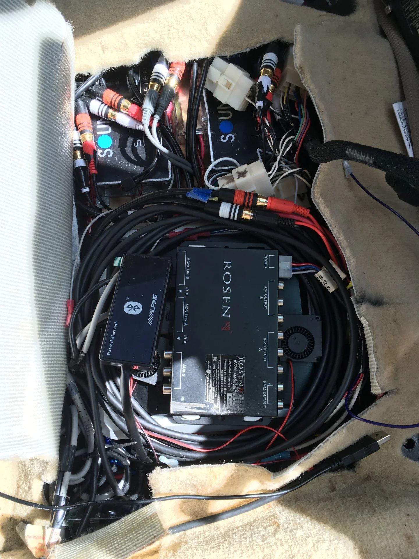

There is probably 5“ by 12” by 2” with the stock ML amp. There are some hvac ducts toward the back. I’ve got a dsp/amp, two 4 channel micro amps, a couple distribution blocks, the RSE box, and so much cabling and a couple small fans in there without the ML amp.
I think it’s 9” by 15” by 3” if you don’t put in a mounting board.

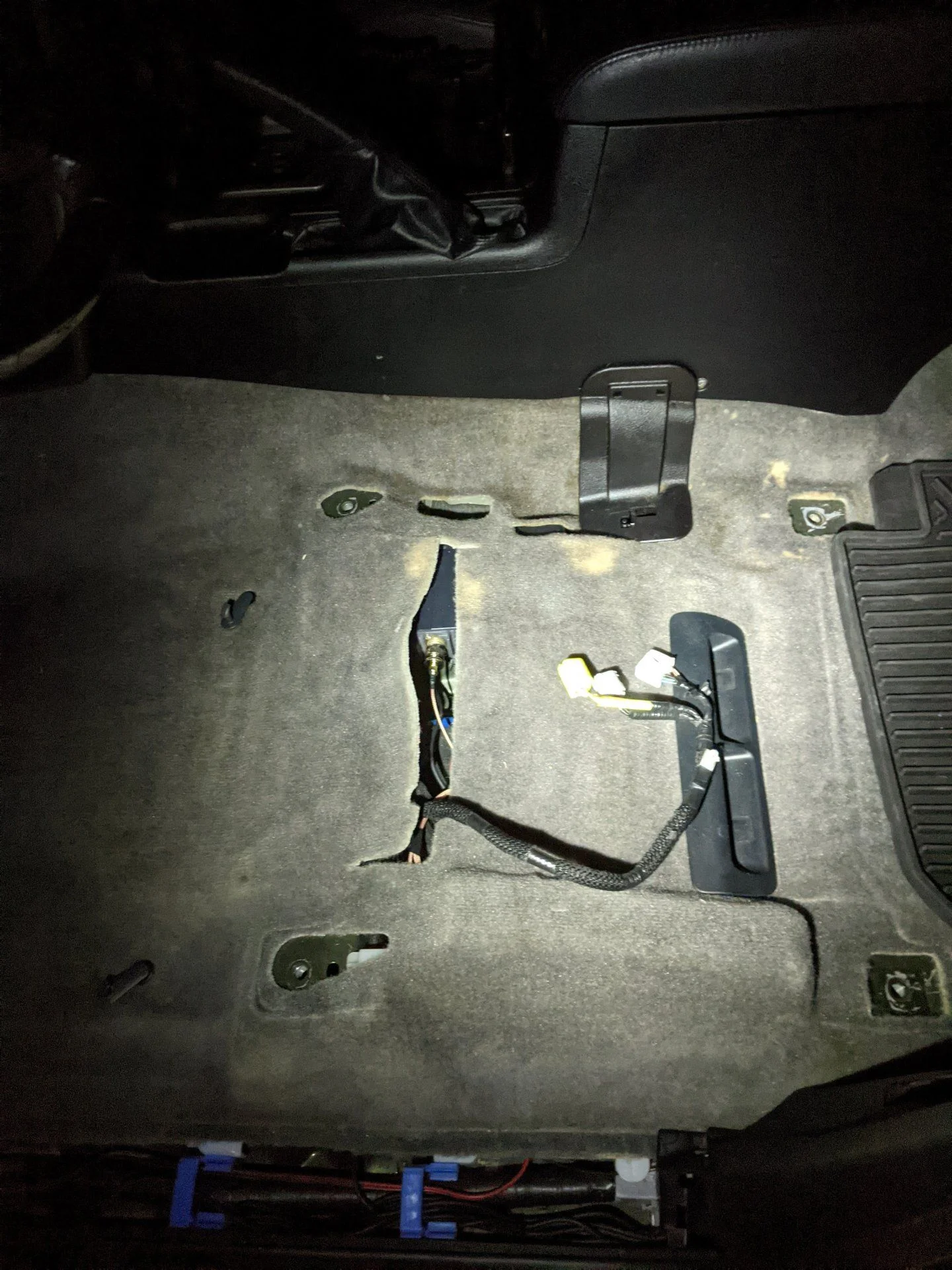

i suggest putting some masking tape on the steering wheel rim. Seat rubs it pretty good going in and out.

agree! best practice is a mounting board or spacers to get off the body. i did a board, stock amp uses standoff brackets.
Nice spot. You’ll want to cut or at least fold back the carpet so the fan can do it’s job. It’s especially important during longer transmissions/conversations with a higher power setting.

Very easy. Four bolts. And three wiring clips. Super straightforward. The key to to be careful not to break plastic bits during R&I
Agree on that ventillation. My use ends up in a low duty cycle. and I almost never go full power. I ended up lining the compartment with toolbox liner plastic.Then ziptied the radiodown to avoid rattle. I won't be doing any deep water fording and don't live in a snowy are...so I feel good.
