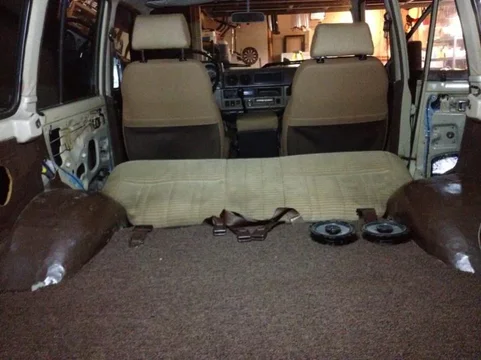

Just put them on last weekend. They were a little more than I wanted to spend, but in the end they look great. Installation was a chore, but if it werent for their spot on sewing match, could of been a lot worse. Highly recommend them (ordered brown w/ no tailgate).
I was lucky and had a parts rig with a really good pass seat, like yours it looks great in the drivers side position.
