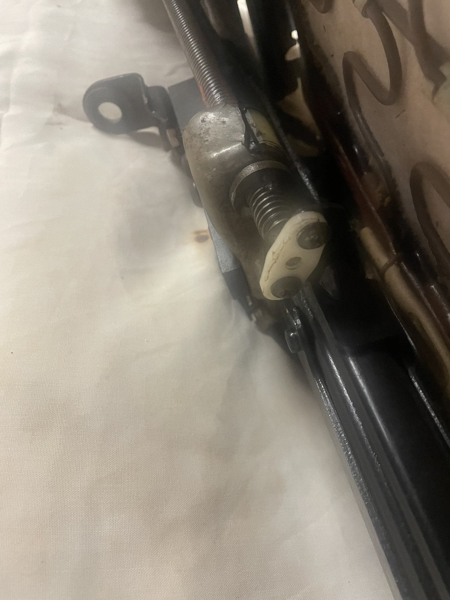

Started to PM and lx450 that I’ve owned for the last 8 years. Currently changing out the seat gears and it appears the white brackets on the end of the adjustment rod are cracked. Anyone know where to source them?

I just made some out of plastic laying around the workbench. Not a real specific design for tight tolerances.

If you can't source any used ones for your needs, send me pm. I have a couple of them laying around.
I used jb weld and fender washers of similar size as I had a timeline that I couldn’t wait for parts. Sandwiched the area and was good as new. Put washers on the other side to keep it symmetric.
