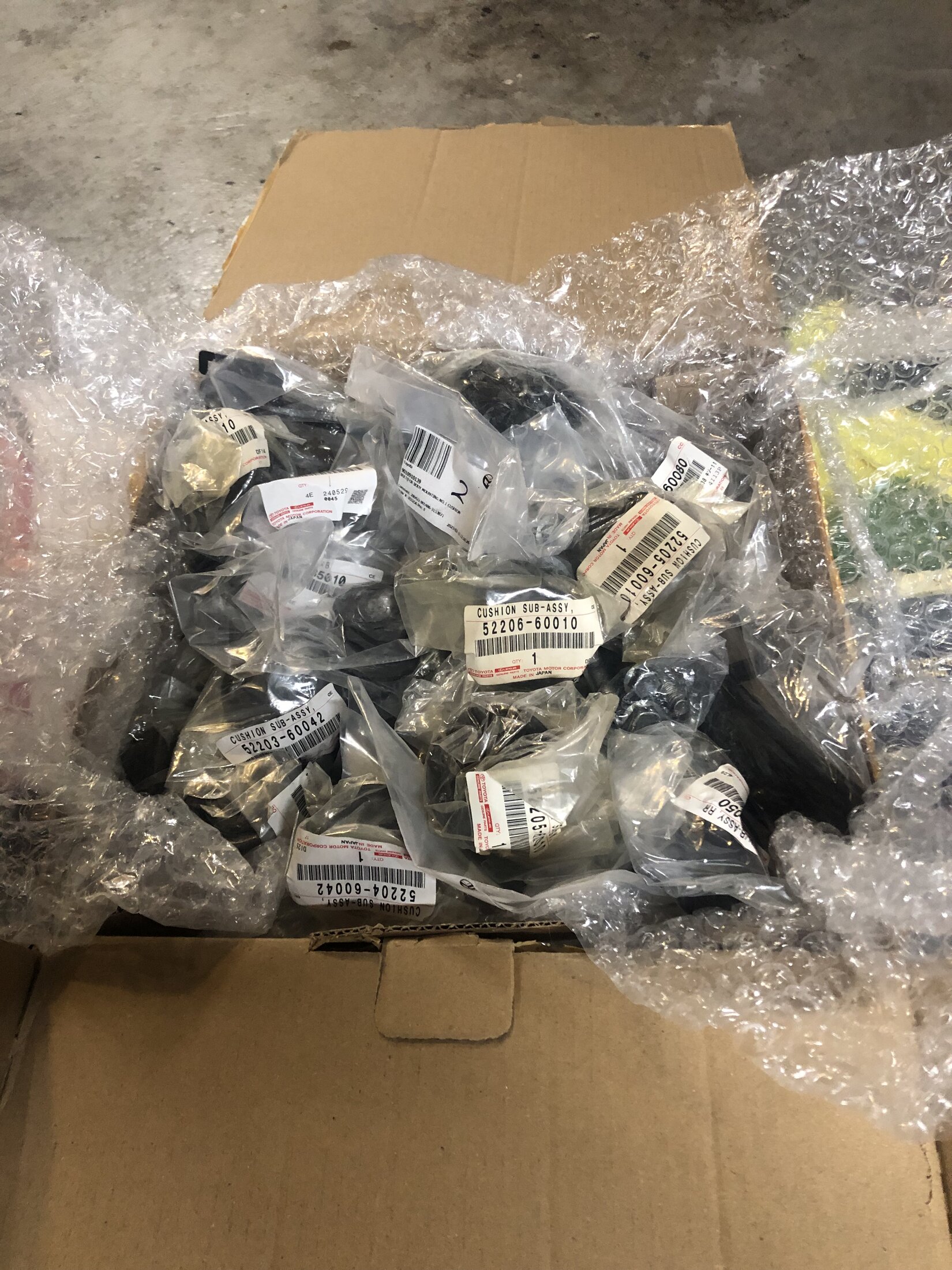

its super easy, just look at my previous post from energy suspension, they made a guide for swapping the body mounts.
From memory, the only difficult parts were:
(1) jacking the body off, its kinda scary but that's all.
(2) if you have rust, the bolts above the exhaust and the other side are rusted for sure and are very stuck
(3) remove the fan shroud or else it will get cracked.
I did the fuel filler neck and changed the BMs at the same time, so my memory of the above might be hazy on what was really necessary.
I will PM a photo of the parts list to anyone who would benefit from it.
The OEM parts are on the spendy side but that’s bc they last. Don’t bother with Febest. I messaged PartsOuq about Febest brand, which they did offer at that time, and they told me they would only recommend them as a temporary solution. (Chinesium)
Mind DM’ing me the parts list? Looking to do this in the next few months. Thanks!!
The rear mounts for the US FZJ80 series are NLA. The rear mounts for the HDJ are the same parts.
You can get them from Dave Stedman, or any online parts store. If you order from the desert, you're in for a surprise.
I will second that. I ordered what I thought were the OEM rear mounts but when they arrived, it was the fewest version.
