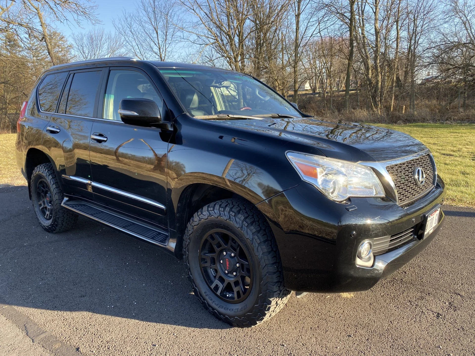

I just put 265 70 17 KO2’s with TRD Pro’s on my 2011. Didn’t have a chance to get a spare wheel yet for the spare.
No wheels spacers. They just bolt right on. The TRD Pro's are from a 2018 4Runner.

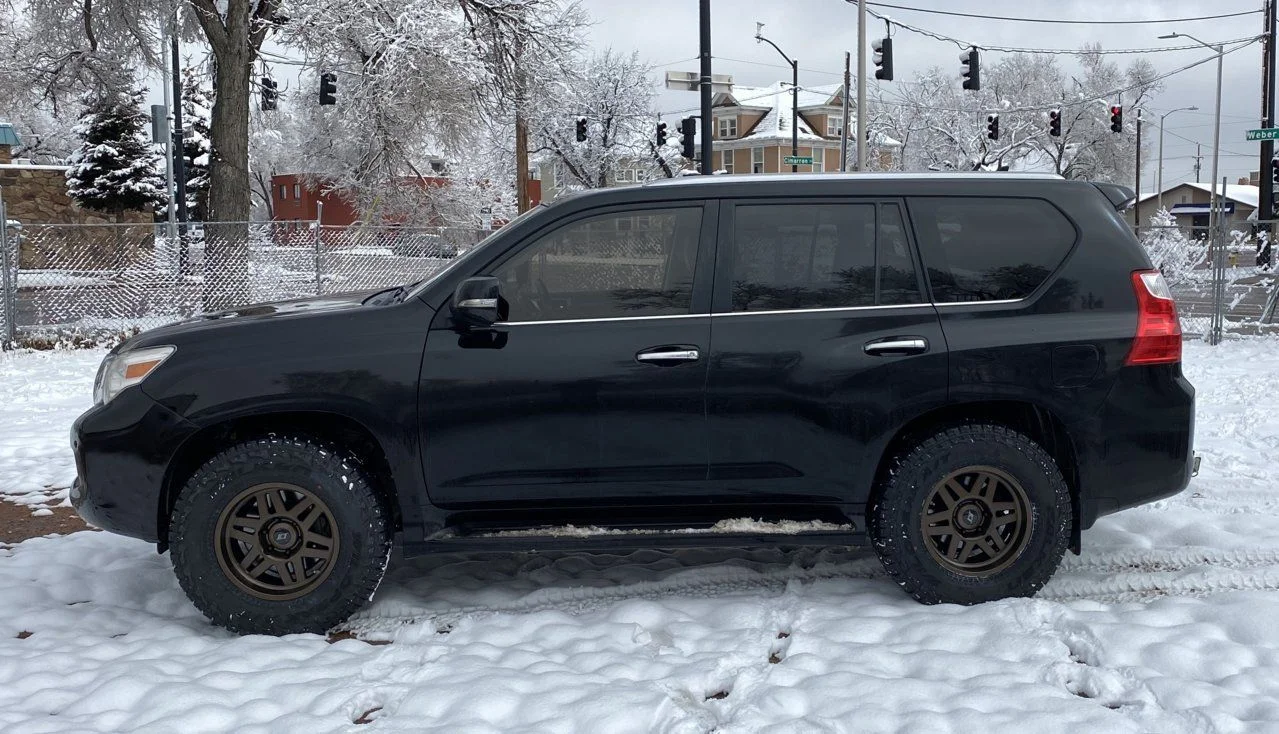

Great color wheels to contrast with the black body paint!
Thank you sir, I'll thank the wife as I'm color blind as hell and made her choose between matte gunmetal and dark matte bronze for me.
@jmanscotch Looks great! Any lift kits installed? I assume 285/70 will rub the walls especially in turns/reverse etc.
Did indeed go for a lift, Dobinsons 2-3” with 100LB+ springs up front and 200lb+ springs in the rear and JBA upper control arms to get some caster back. Been very happy with it all so far.
I feel I’ve had to do more trimming that others have for a similar tire/lift setup. I’ve done a BMC, moved the front fender liner forward 2”, trimmed the crap out of the rear fender liner (bottom 12-16” of it), several inches off the running board and I still get an occasional rub with off camber turning when suspension is stuffed a bit off-road. I think I need to flatten the pinch welds now. Not sure what gives there.
