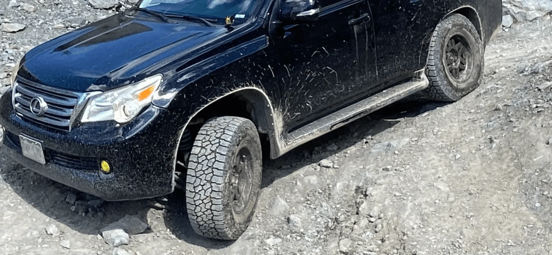

Did indeed go for a lift, Dobinsons 2-3” with 100LB+ springs up front and 200lb+ springs in the rear and JBA upper control arms to get some caster back. Been very happy with it all so far.
I feel I’ve had to do more trimming that others have for a similar tire/lift setup. I’ve done a BMC, moved the front fender liner forward 2”, trimmed the crap out of the rear fender liner (bottom 12-16” of it), several inches off the running board and I still get an occasional rub with off camber turning when suspension is stuffed a bit off-road. I think I need to flatten the pinch welds now. Not sure what gives there.

You're getting that much rubbing on 285/70/17s AND a 2" lift? I've got 285/65/18 and ever so barley rub- I'm going to 17" TRDs and figure I can do at least 275/70/17s, and was considering going to 285s.... now you got me rethinking

I really feel like I’m an odd ball on this. I think (though I never measured) I got 2.5 or 3” of lift out of my kit and yet I definitely have more rub than most I read about for a 285/70 17. Most say they do some trim and remove that one problematic bolt in the rear of the fender, some did a BMC for hard turns or off-roading, but not that AND some more.
That said, it’s all plastic, besides the BMC, and I’d definitely do it again for the results.
I can take some detailed pics if you’d like to see my efforts. Here’s the only one I have that shows some of the running board and rear liner trimming...and I’ve trimmed more since this photo.

I'm thinking it depends on wheel offset.
