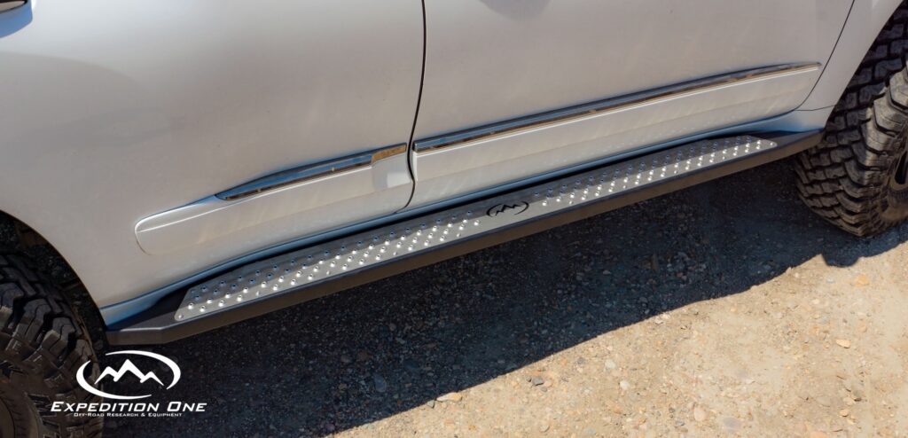

An alternative to the Slee sliders are those from Expedition One. They are full length and look similar to the Slee version, including being able to retain lights. Since it's full length it will restrict the size of Tire you can mount, the website states 'up to 33'. I'll be installing mine over the weekend so stay tuned for a full review!

I wanted to keep as much of an OEM and clean look as possible and was considering SLEE at first
Until I did my due diligence and kept digging then found Expedition One sliders. Actually they call them rocker guards, to me they are a lot cleaner looking
20220801_075732-jpg.3074864
20220801_075738-jpg.3074866
Limited to max tire size of 33" and I am only running 32". No plans to currently ever go above 33" on my DD. Too many other things would require changing as well.
Could have the aluminum tread plate powder coated for an additional $50 IIRC. But seeing how from the side view the molding trim, door handles and even roof rails are chrome will see how it looks when they finally come in and get mounted. If I don't like it can always remove the aluminum plates and take them into town and visit the Line-X shop and have the tops coated. Would likely be better than powder coat as well for longevity.
