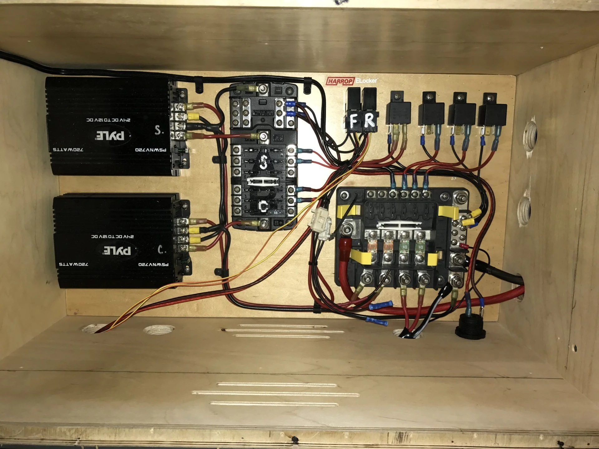

I've got 24v fog lights, back up lights and LED light bar. The arb fridge and Compressor both run on 24v. I've got a blue sea dual USB charger also on 24.
My Harrop elockers want 12v, as does the stereo, hella map lights, 12v plug for Garmin and cb and ham radios.
I still need to figure out if I want to spend the time to sort out the 24-12 v 7pin trailer harness.

It hasn't been an issue for me. A simple converter works the radio, the phone charges just fine on 24. Headlights are regular 12 volt. There is some extra cost when it comes time to buy new batteries and you need to be careful about wiring...you cant just tap power off of a battery willy nilly like you do with 12 volt...but its largely a non issue. Most alternator repair shops are very familiar with 24 volt and can work on and rebuild your starter and alternator once a decade if that is a big fear.
