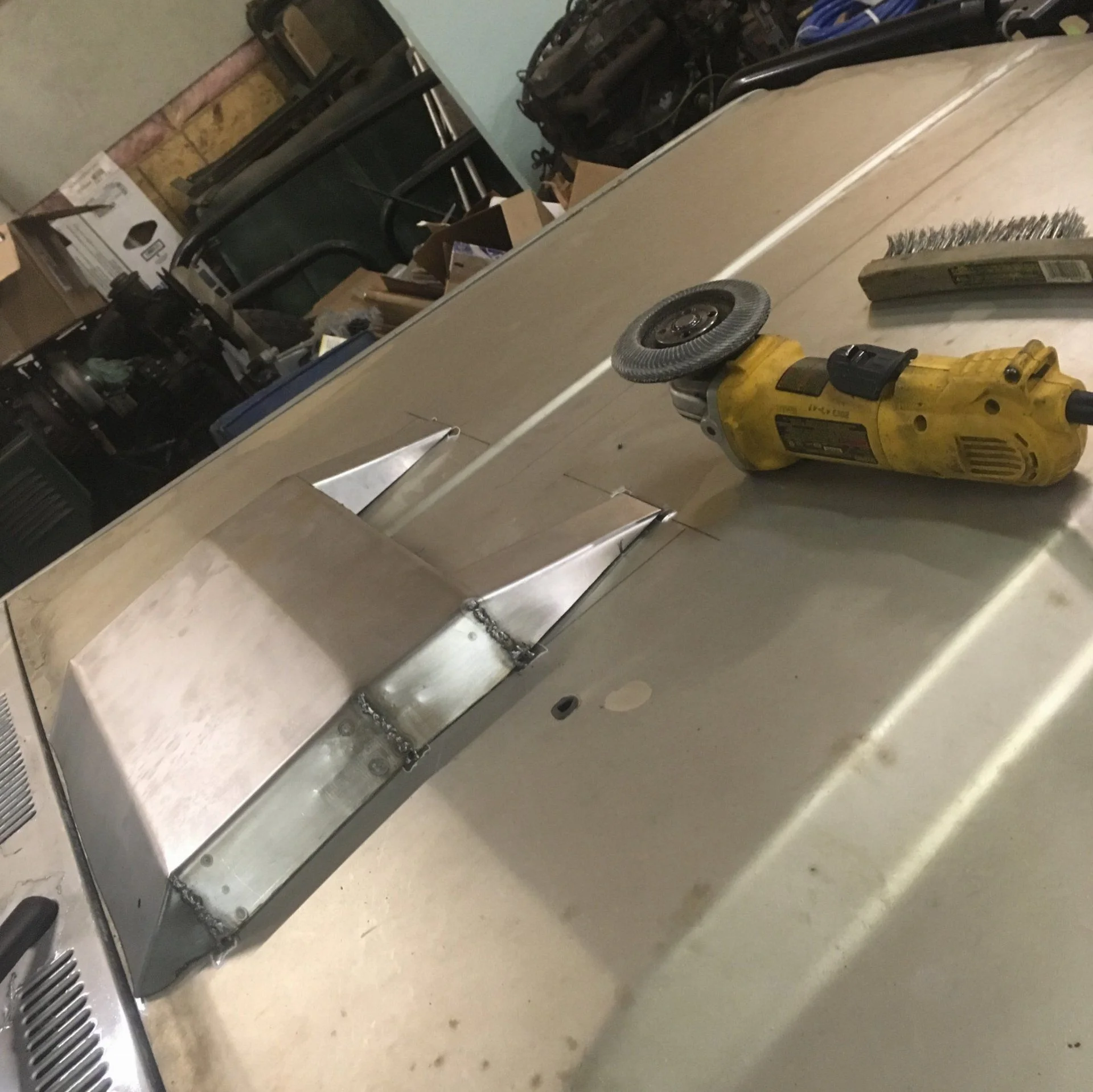

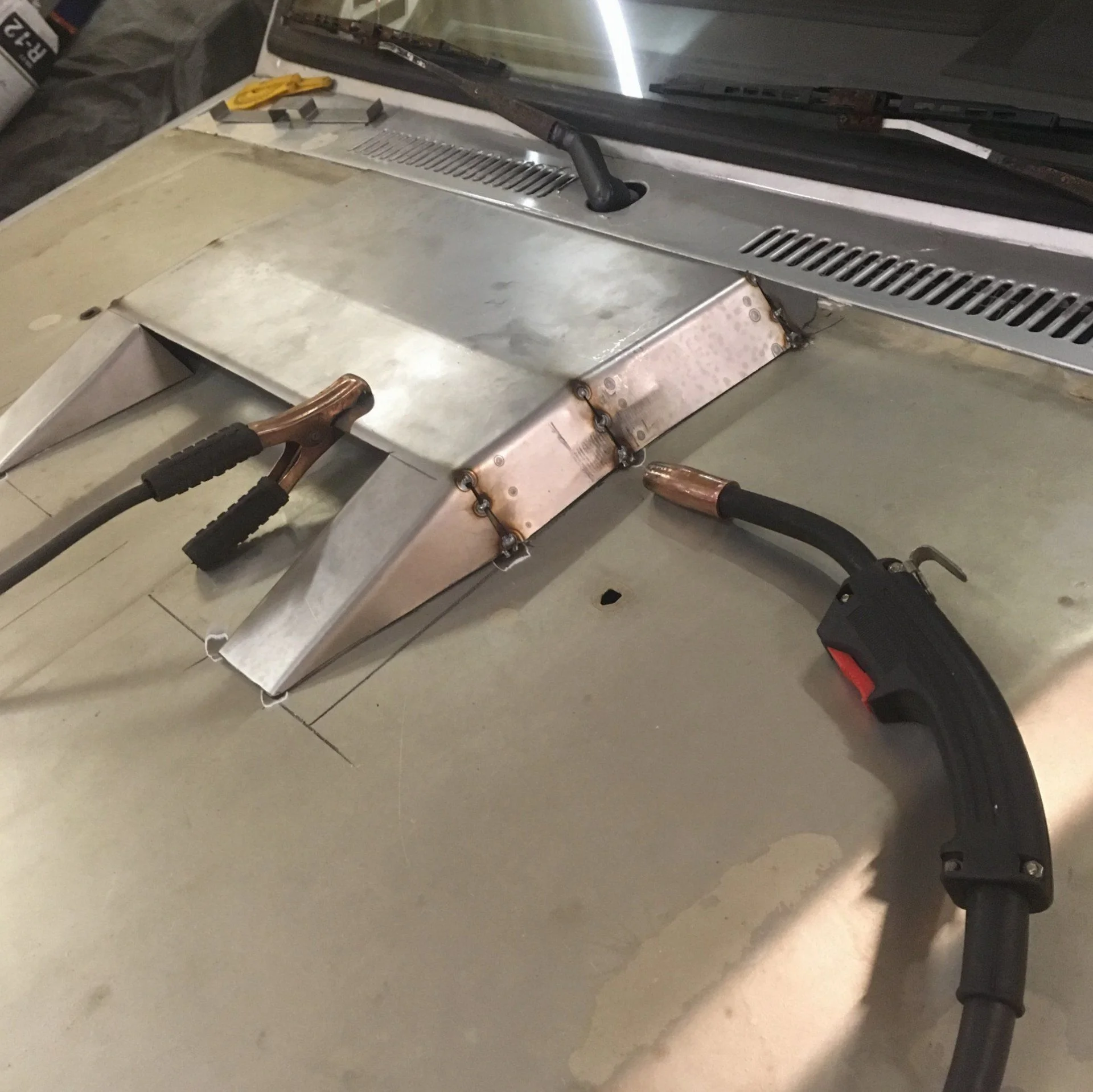

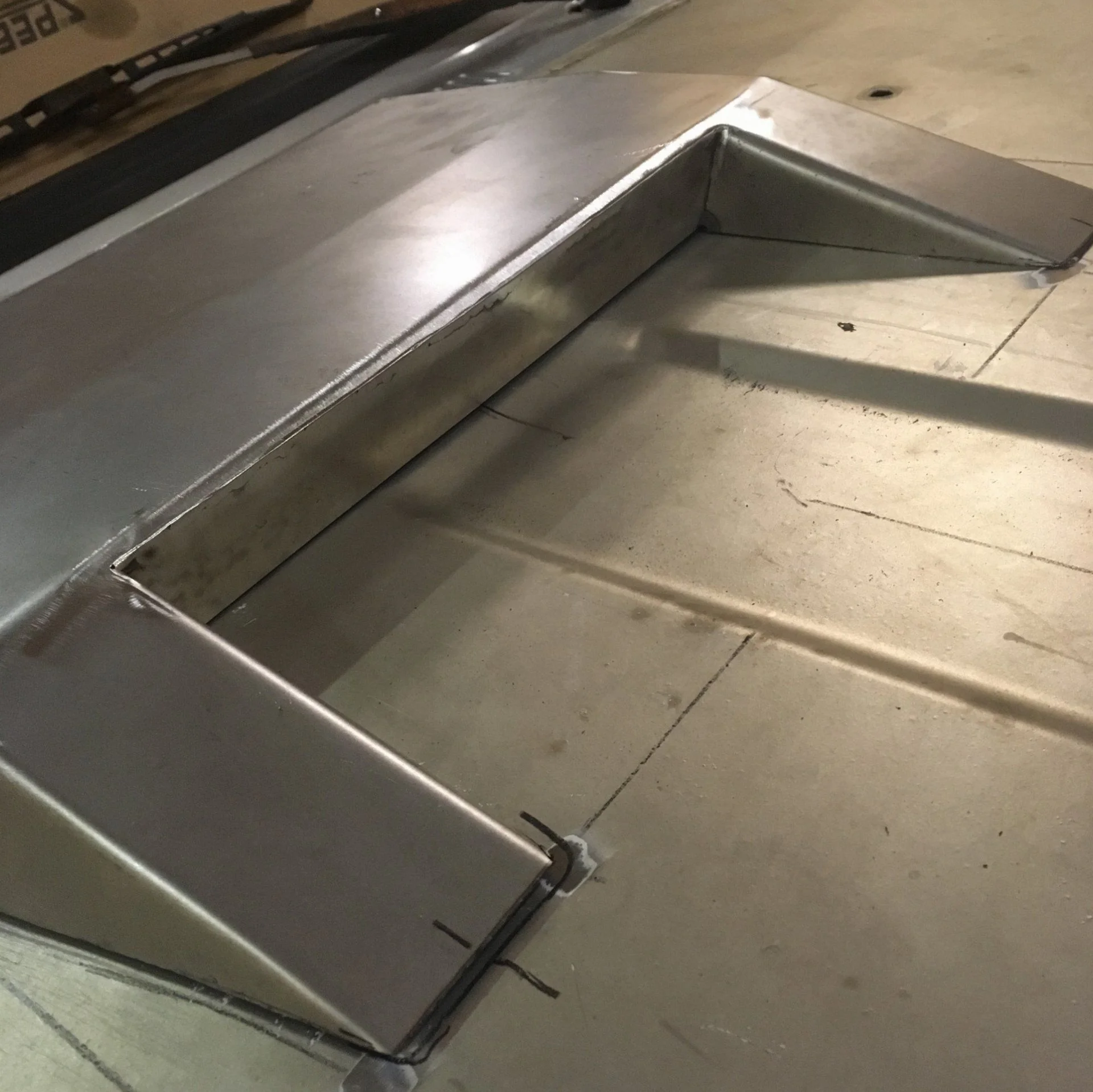

Measured up the hood, marked it out, and tacked the scoop down in a few places, and put a few tacks on each seam. (Backer plates on the other side)
I actually widened the scoop a little by flaring out the sides. Currently 18-1/2" wide at the base
Next I welded up the seams
And buffed it smooth again with flap discs on the grinder and die grinder. Not perfect, but with a super thin skin coat it will be fine.
I've cut it back off again, and next I need to weld in the front plate that the screen will attach to.

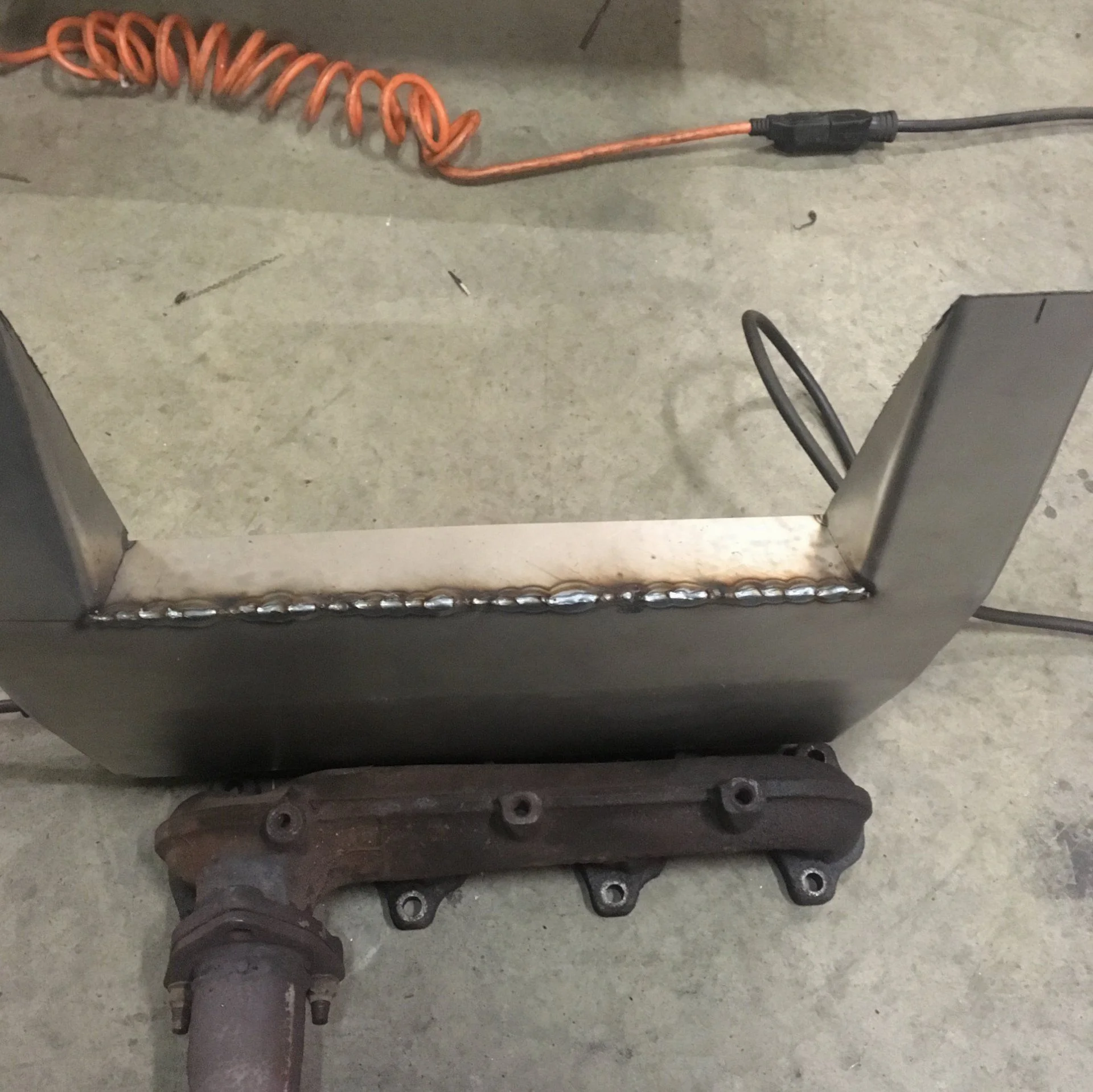

Cut and bent a strip for the screen frame. (90 degree bend at the top goes inside the scoop to help stiffen up the front)
Welded up in little stitches to reduce warping...
And then ground down smooth with flap discs on the grinder and die grinder... Yes, the majority of this will be cut back out again, it's just going to be a little 1/8" or so lip to attach a screen to.

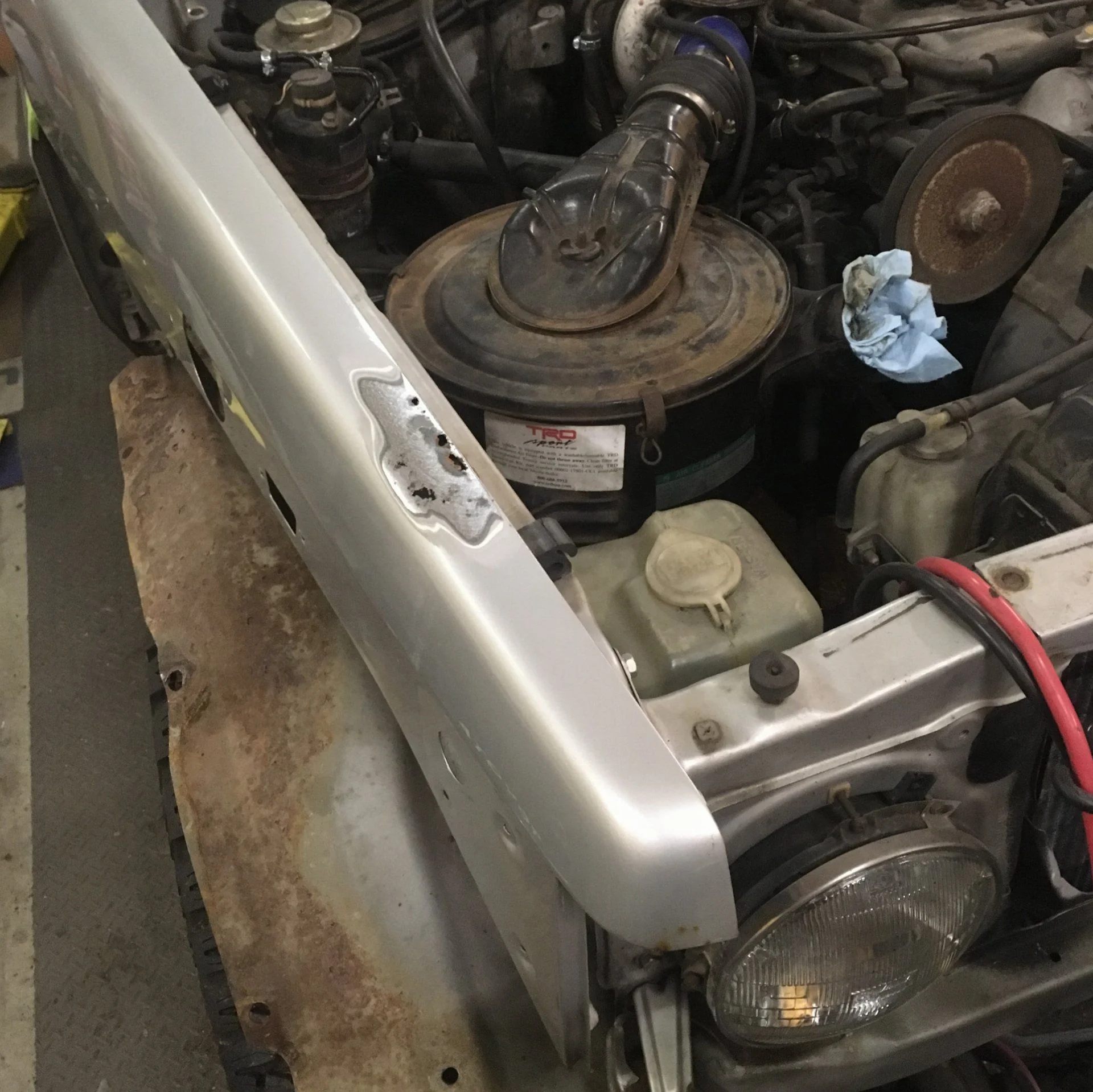

Well after the fight to get the lower fenders off, it was nice to work on the relatively clean upper fenders. With one exception, this spot on the passenger side upper.

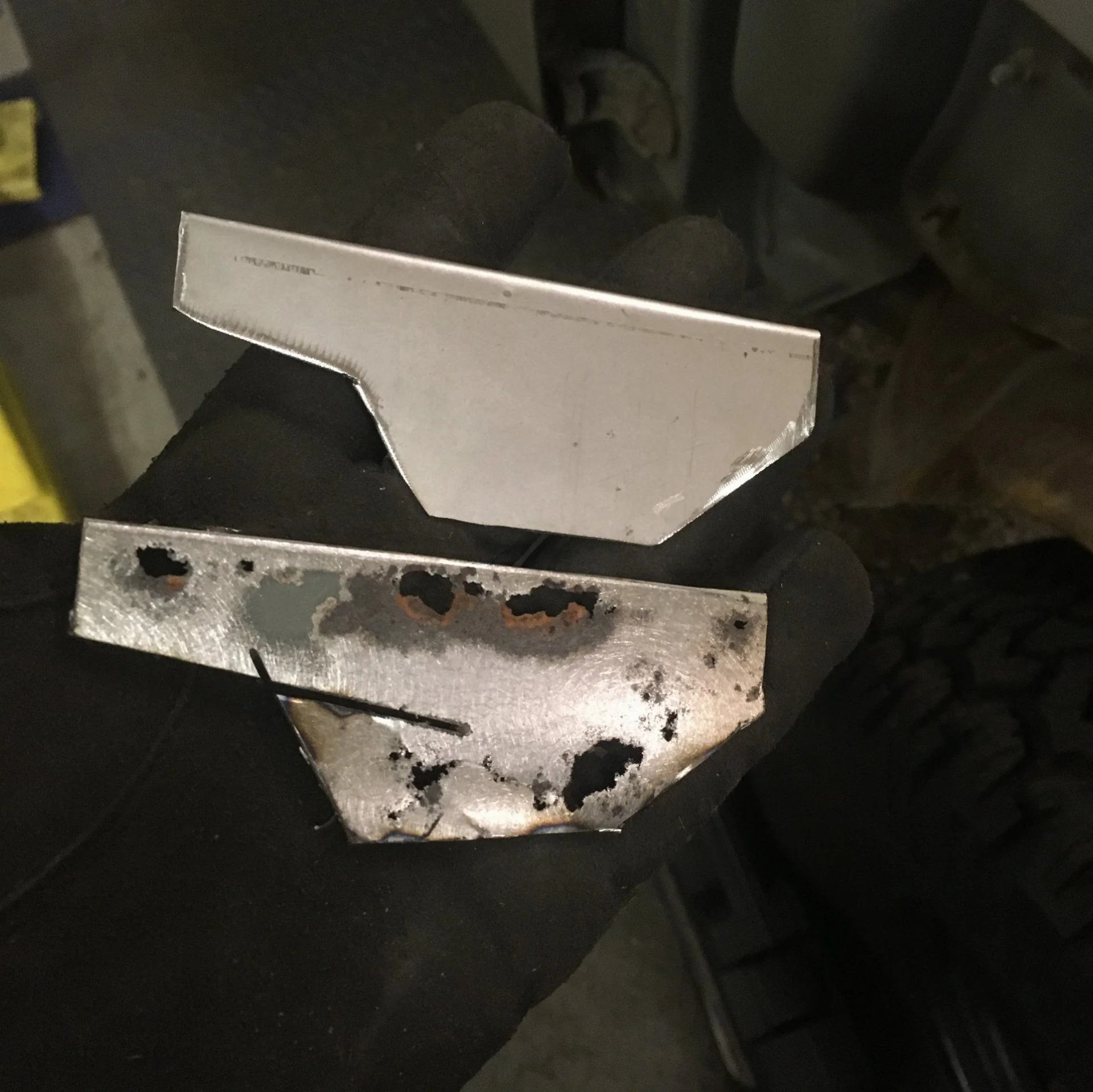

Sanded it down to expose all the nasties, then cut a section out
Close up.
Section cut out and section cut to replace it (has a 90 degree bend on the back to wrap down inside the hood opening)

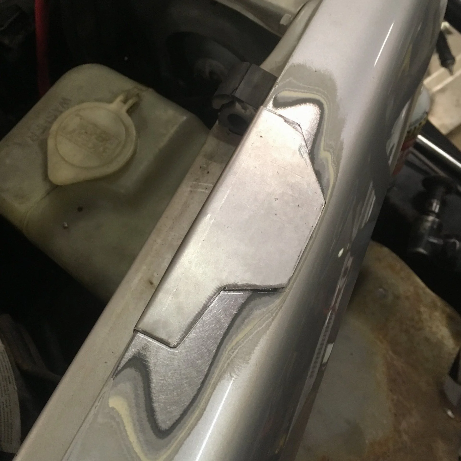

New part in place ready to weld (minus the small amount of curve needed to roll down to the outside edge)
Welded in and ground down. One dent at the bottom from when I was trying to curve the bottom in, and accidentally dented the metal below. Skim coat will take care of that.

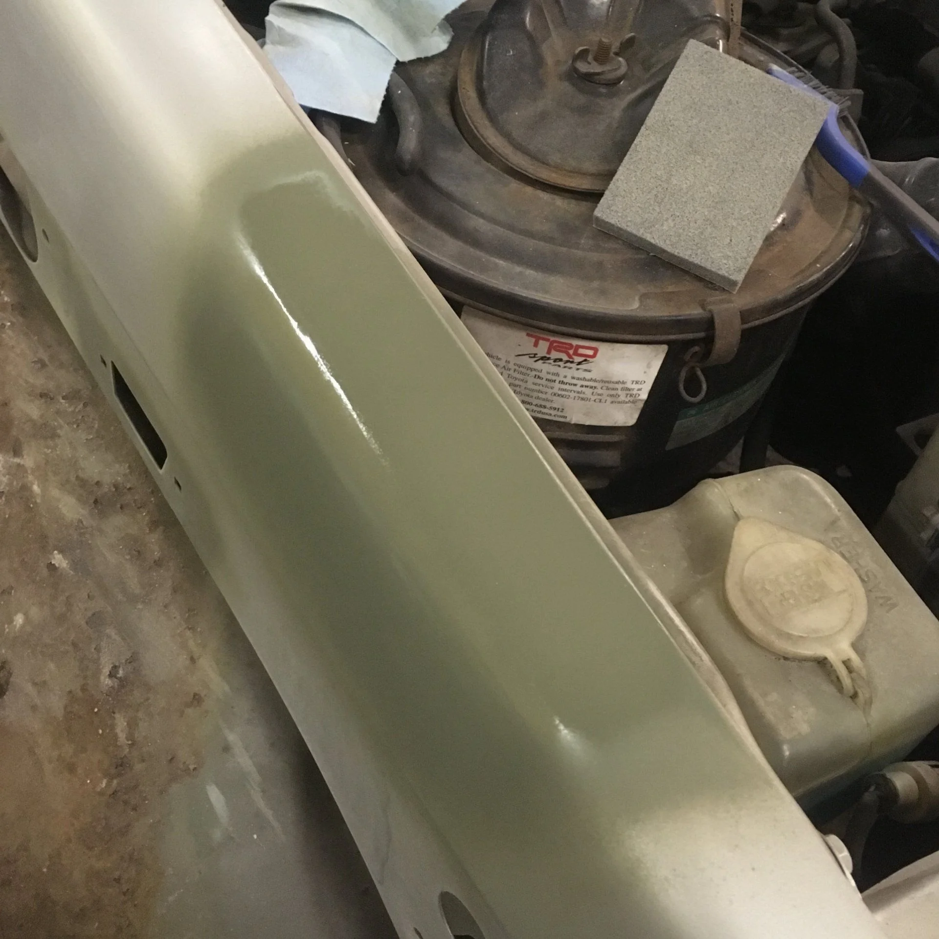

While tackling the skim coat on that section, I did a full sand down of the rest of the upper fenders. Sanded with 280/320 on the orbital, got rid of all the clear coat that was peeling, and then took it back a little further. Hit the spots that went through to bare metal with etch primer. Did a final sand with a 600 sponge, feels nice and smooth.
Final coat of etch primer over the skim coat still needs a final sanding.
Used a scotchbright pad to get in the recessed areas where the signal lights mount, and a sanding sponge on the corners, and strange curves like around the back edge at the door, and front edge where it ticks behind the grill.

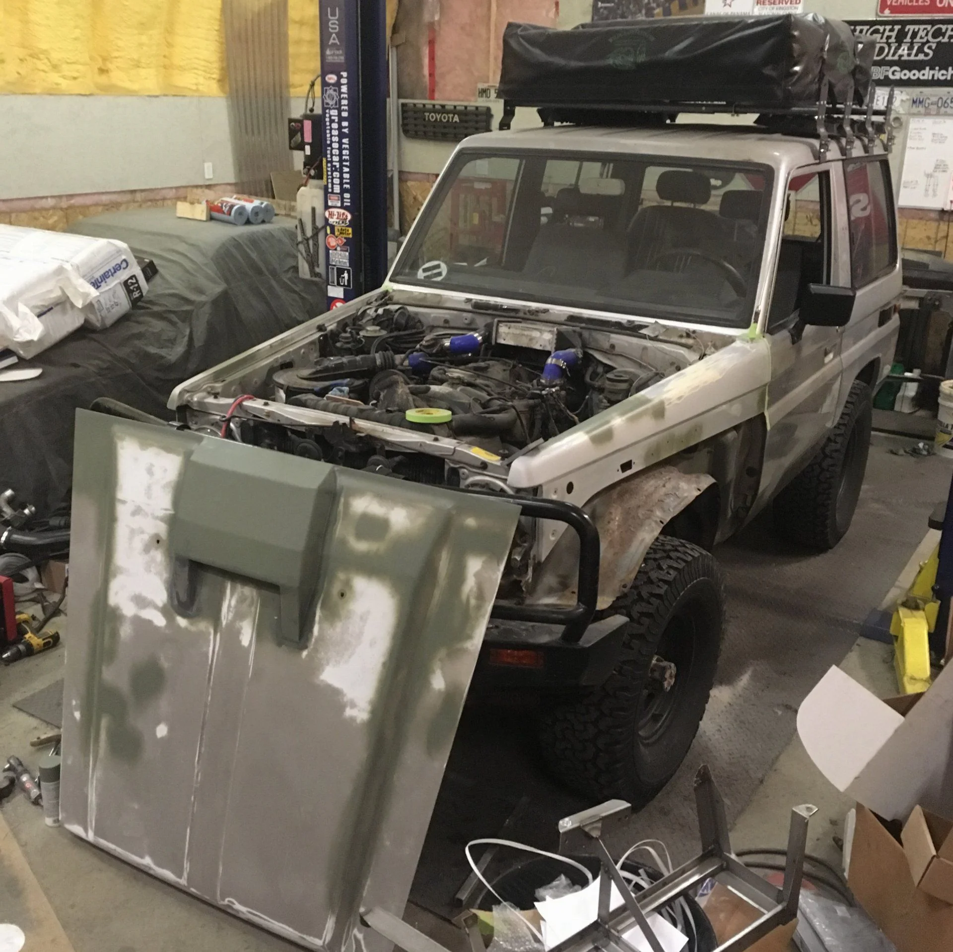

Well I got a start on the hood, first round of sanding and etch primer on. Need more sanding around the scoop, and there are 3 small dents in the front that I'll fill once the back end of the hood is done, and I re-mount the hood.
Little bit more progress. Hood scoop is starting to look like it belongs. Hood still needs more prep work though.

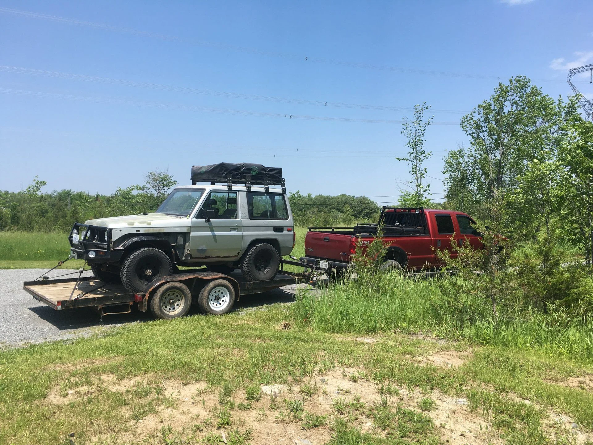

Loaded it up yesterday and took it to work with me. Unloaded it at lunch and drove it to the paint shop (yeah, no fenders on!)
Hopefully picking it up Thursday...

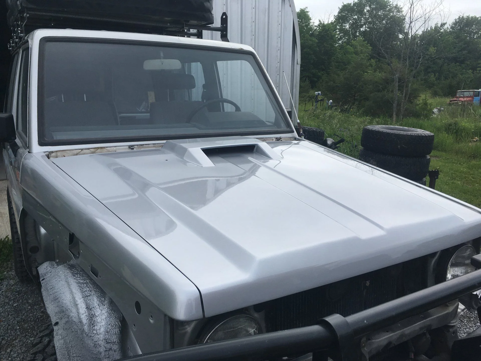

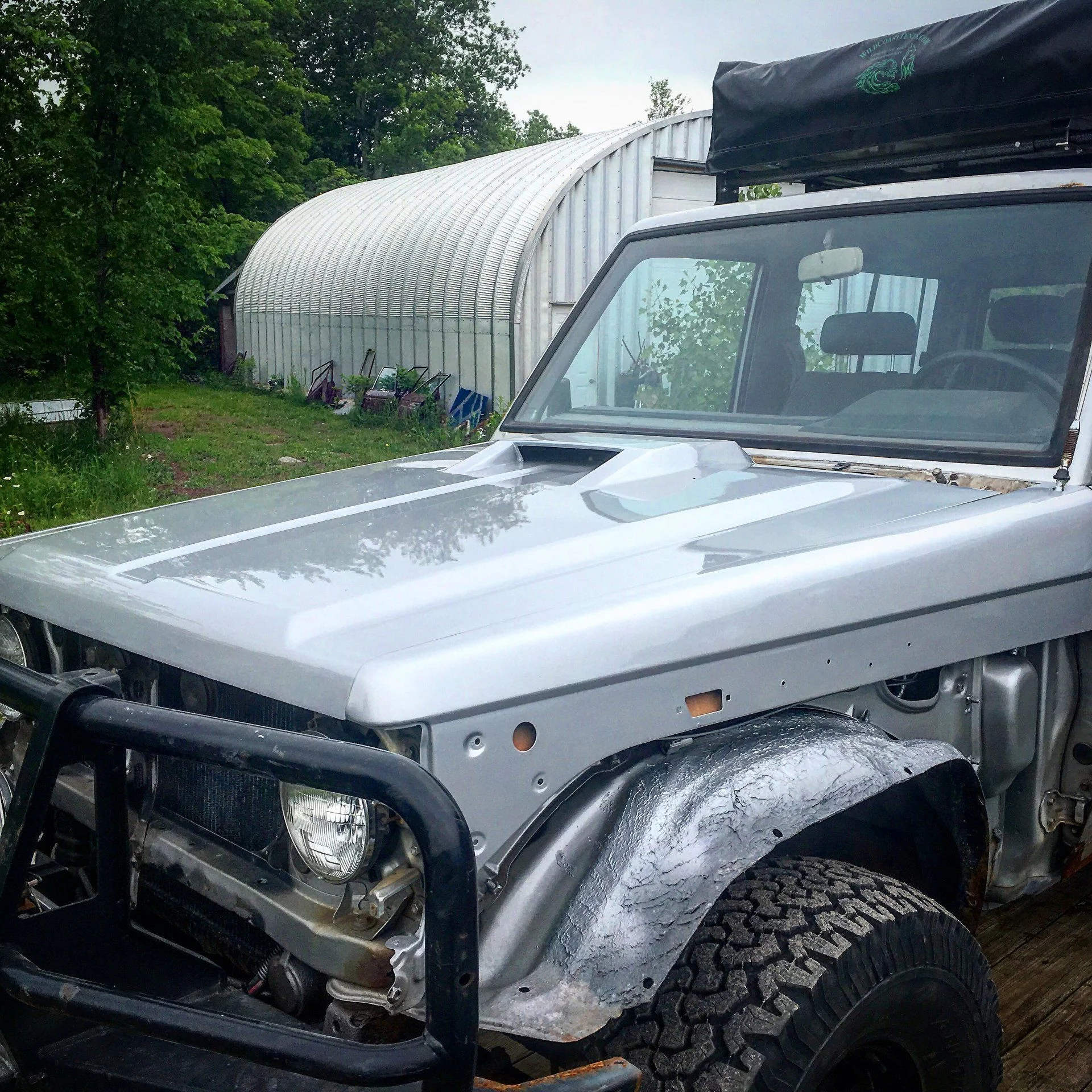

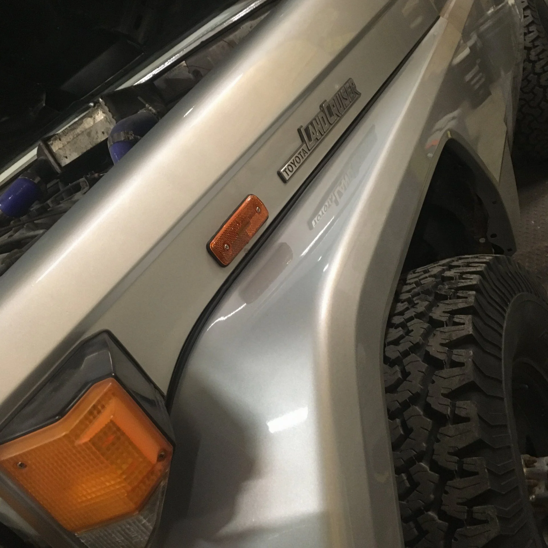

Woohoo! Back from paint today! Unloaded and got the signals and marker lights on, then the lower fenders. Only takes 9 extensions to reach the rear 3 bolts ;cD
Anyway - here are some pics.
(And FYI, I HIGHLY reccomend the $14 marker lights from Rock Auto. Absolute perfect fit. )
Wow! That came out great, looks nice and clean now!
