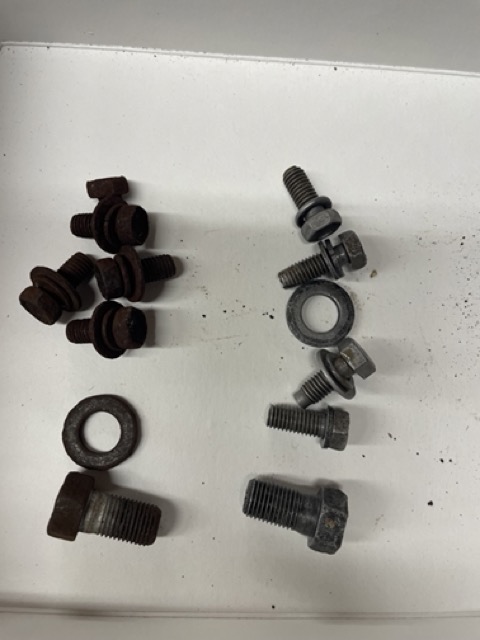

The fasteners on my burgundy FJ80 is VERY rusty. I have replaced some that were damaged and have rejuvenated ones with light surface rust on the wire wheel.
I then got the bright idea to see if I can use a tumbler. First try was with kitty litter as media (FAIL). Then I bought the HF resin media. It didn't do much and I considered it a bust. But as a last try, I just added a bit of soapy water to the media and sprayed some PB Blaster into it. Why you ask? Why not?
This is the result. Untreated on the left. Treated on the right. Thoughts?

Nice. Great results !
I'll have to try this. Can you share what tool you use to tumble them?

I used the 5lb tumbler from Harbor Freight and the resin media. Afterwards I lightly heated them up and dunked them in oil to preserve them. Will see.

evaporust works good too
My 3 step plan:
degrime with purple greaser (your choice)
dereust with Evaporust
wire wheel
Done.

Looks good, now you could heat them with a torch and drop them in some oil to give them some rust protection.
Can you say more about this? How hot, what kind of oil, etc? Does it make some changes to the metal structure?
I was taught to heat the metal unitl it just starts to turn red. I have always used whatever used motor oil I had at the time.
I probably wouldn't use this method on critical bolts that see high torque values like a brake caliper bolt for example. But for something like an alternator bracket, or a body bolt it works fine.

I use my ammo tumbler with the stainless pins. I add some citrus degreaser or dawn dish soap. They look brand new, even into the threads. BUT...they are bare metal after. I never tried the products out there to parkerize or gold cad them.
I find a two or three year soak in ATF does wonders...not that I've ever temporarily "lost" parts soaking in a container, or anything.
They look good ! But like mentioned above, they are bare metal now and will rust again quickly. That being said, I spent more money than I might like to admit on new Toyota fasteners and with only about 3,000 miles on the "rebuild" (and in the south, no road salt) some of the new stuff is already "corroding". I guess the new coatings are still not as good as the old poisonous cadmium stuff. The ones I cleaned up then painted seem to be holding up the best.

I heated mine up with a torch (not quite red hot) and then doused them in old engine oil.
