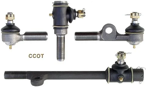

Ah yes, I see what you're saying. I forgot about the mini's being SOA from the factory, and that the HI-Steer kits move the steering above the springs. This is the tie rod I was talking about (upper right), but it wouldn't work because the link from the box would probably hit the bottom of the spring.
This is the type of setup I'm using on my 40. It's a mixture of mini, 40/60/Marlin components. BUT, it is SUA.
EDIT: It may still work, depending on how far the arm drops below the spring on the pass side.
EDIT Again: Probably wouldn't be able to turn tho.

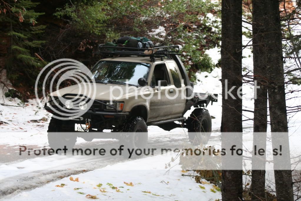

A low lift SAS is all about bumpstops. There is a build over on yotatech called the "great white shark build" or something similar, and the guy is running about 2-2.5" of lift with high steer. I spoke to the guy who did the work and after talking with him I am planning on using the FROR hanger kit ( seems to be the lowest at only 1" lift I think) and a set of 84-85 OME front springs which should net me about the same 2.5" which will sit nicely with a set of 33's. High steer will clear as long as I set the bumps up right. It will limit up travel to only a few inches, but honestly that is probably more than I have now with my IFS, and the droop will be much better.

That build was the first thing to come to mind when I read "low SAS". I believe his front springs were custom made by a blacksmith, so no real comparison there, but it works. If you want to base your build off of something, this would be a great start.
Photo by Toyospero
The Great White Shark attack SAS... - Page 14 - YotaTech Forums
Yep, thats the one. The guy who did that SAS has done a couple of rescue vehicles with similar setups and they all started with those custom leafs and the great white is the only one that is still on them. He said the others broke the springs, and they swapped them over to the OME packs with good success.
