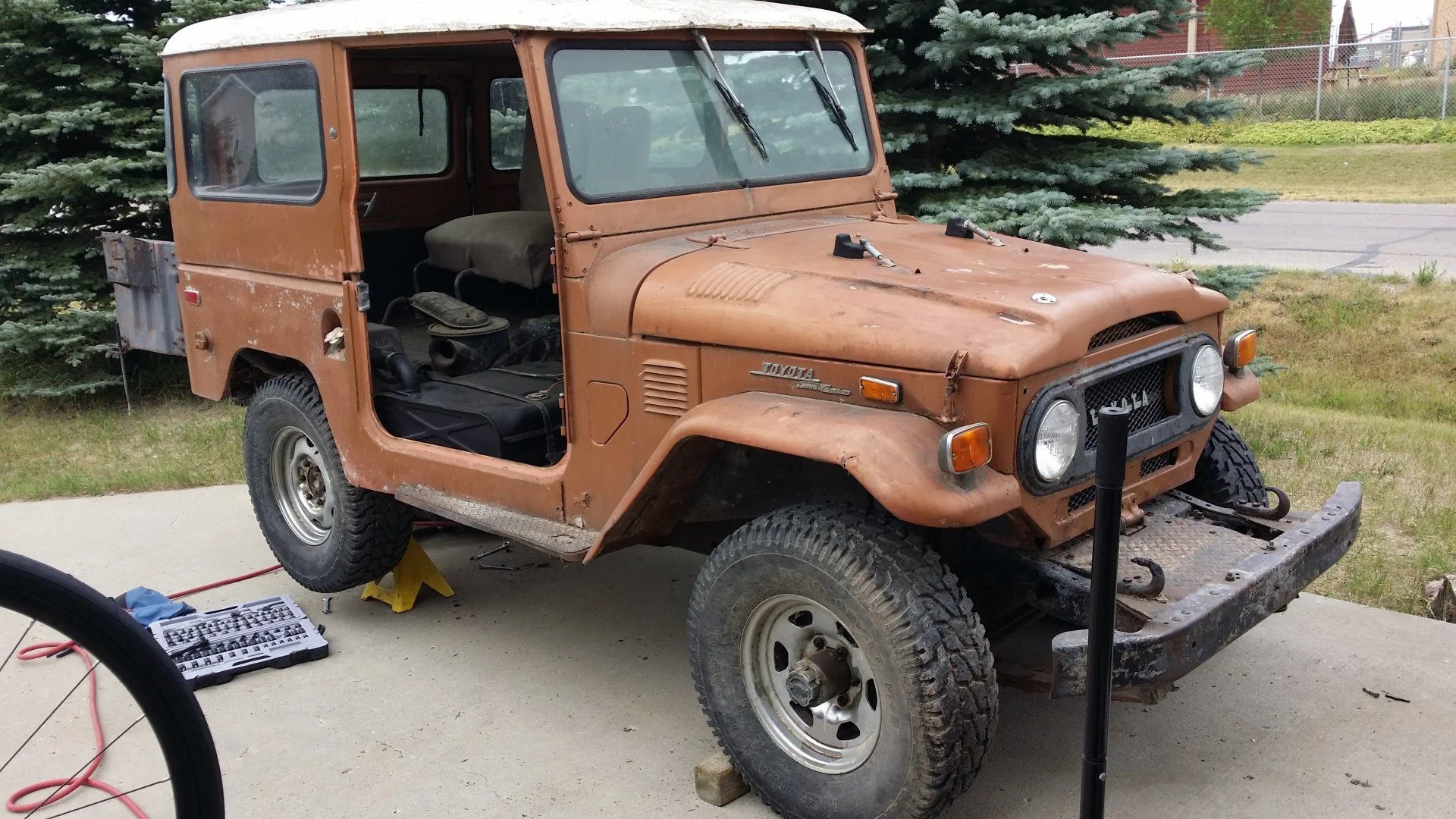

Anyway, after running my 40 to the BHCC my son couldn't wait to start working on his 72. When we got home we swapped on a distributor and carb (the PO fitted a GM carb and distributor) and got in running.
It hasn't run in 20 years or so. We then changed the oil and rebuilt the carb. As we were about to set the timing the motor stopped. And its seized. And its an F engine.
At this point I'm not sure what to do. The boy is outside right now getting the motor ready to pull but this old thing is tired and rusty. It does have a valid title and is currently road legal.

I am in Regina. The dizzy was stock toyota but I never checked how far he installed it. Dang. Bad dad! No oil pressure at the gauge but none of the gauges are working.
We need a motor now I guess.
Im in your neighbourhood haha. Id love to come by and check the 40 out! Ill bring my 42 over. Nice to meet more local cruiser guys there arent many
Just checked the distributor. The oring was well out of the block.
Dammit I'm a bad dad!

If it seized because of lack of oil pressure while idling, it is possible that you can rescue it by dropping the oil pan, removing the rod and main caps and checking the bearings for galling. For any bad bearings, you can polish the crank journals with 1000 grit silicon carbide paper to remove any stuck on Babbitt and then replace the bearings and torque the caps and replace the oil pan.
Once the motor is out we will see how bad it is. I fear the pistons are stuck.
I'd check on pin_head's advice first.
Second I'd track down a 2F... or a rusty BJ60. In 96 I swapped in a SBC when my 1.5 F died. I have no regrets, but these days I could've swapped in a 2F for pennies on the dollar or a 3B for 1/2 or less.

what pin head said.... drop the pan and look, might not be as bad as you think..

We are going to pull the pan and have a look once the motor is out. It seized while idling so maybe there is hope.
