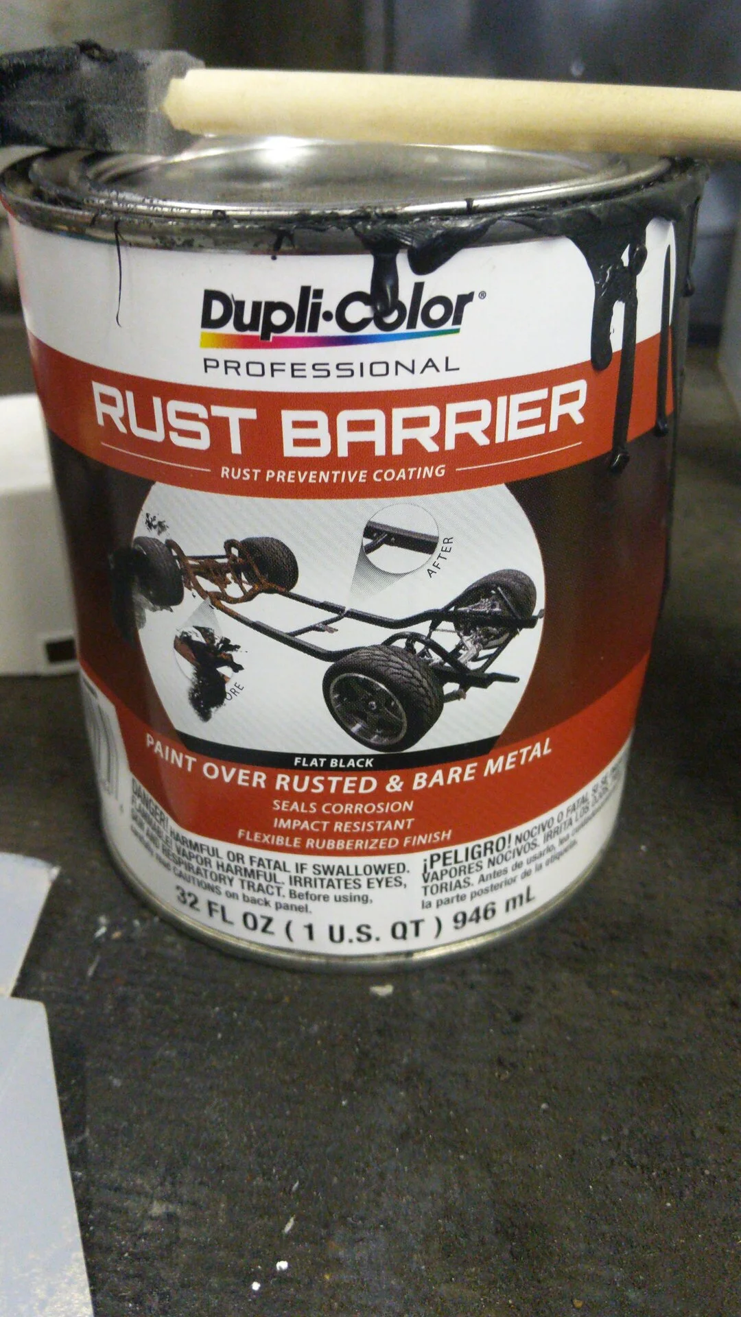

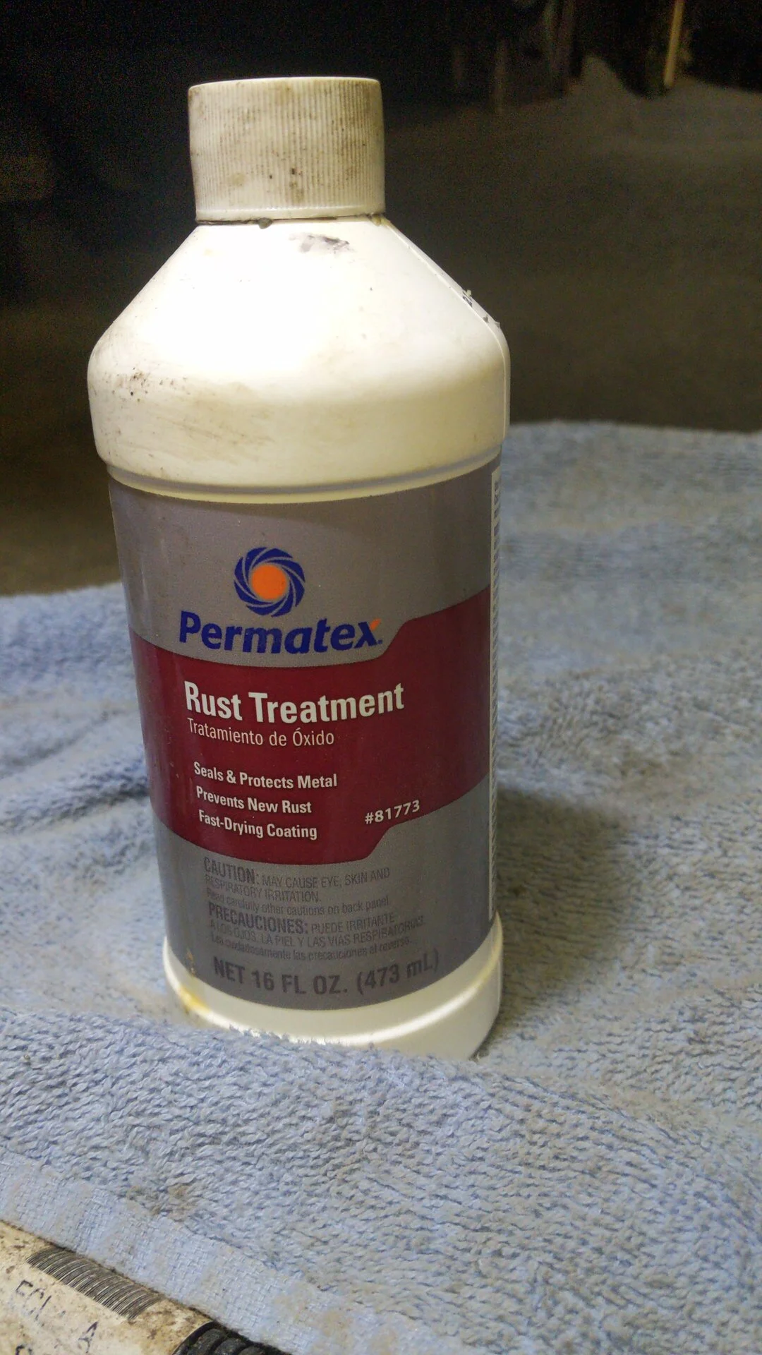

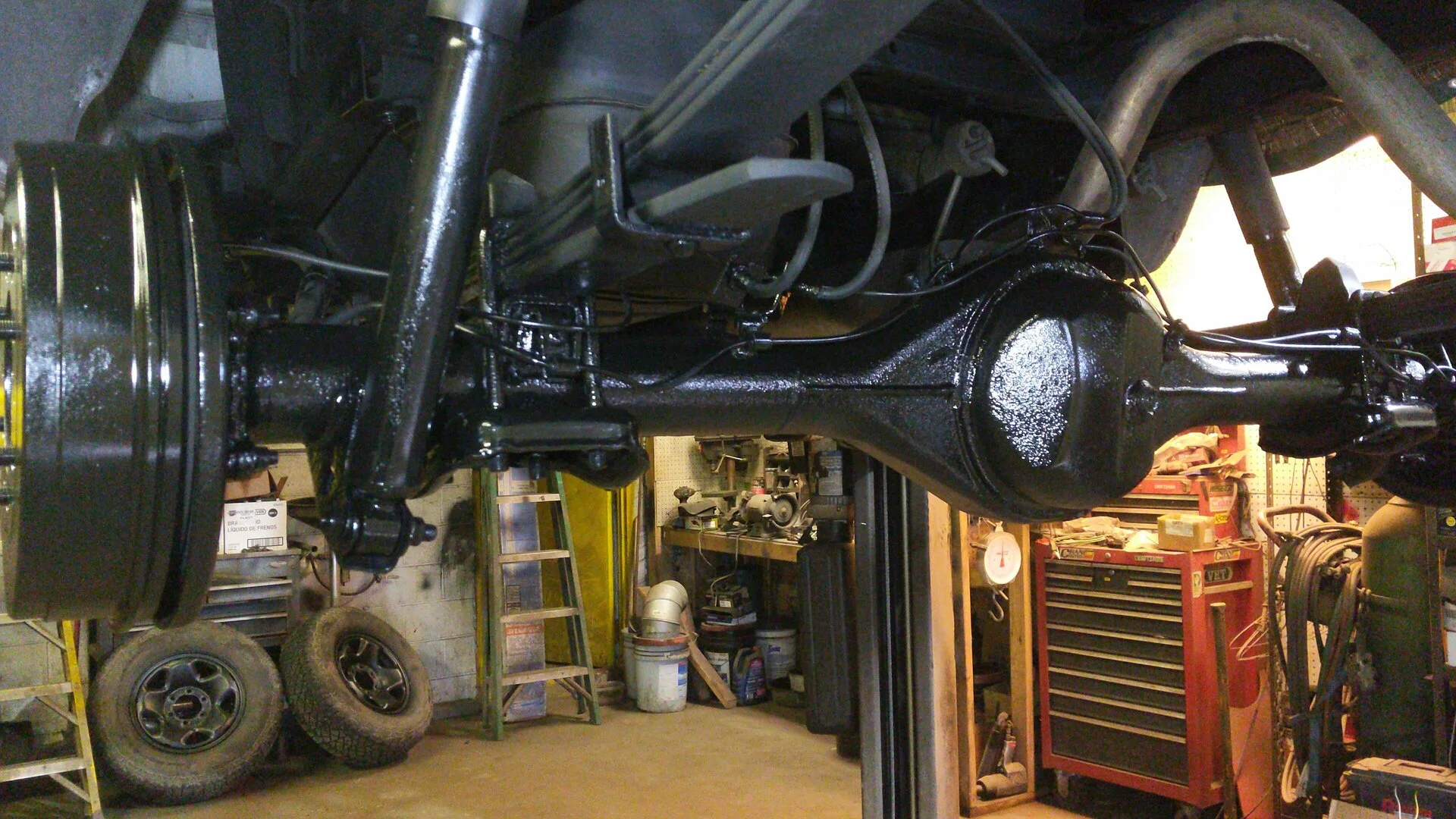

I do a fair amount of restoration type work and I've used a lot of Corroseal over the years with good results. I prefer the milky white type of rust converters. Permatex rust treatment is pretty good and you can buy it at Napa.
Not a fan of POR 15, it does work but only in the right situations. I do like dupli color rust barrier, although it's not cheap, but it can be sprayed over both rust and clean bare metal. Here's a Tacoma I'm working on for my wife, it had a new frame but had some other rust issues I had to fix. The frame is coated with the Rust Barrier, so is all the suspension but that got a top coat of gloss black. I use a 2 part tractor and implement paint from Tractor Supply for that.

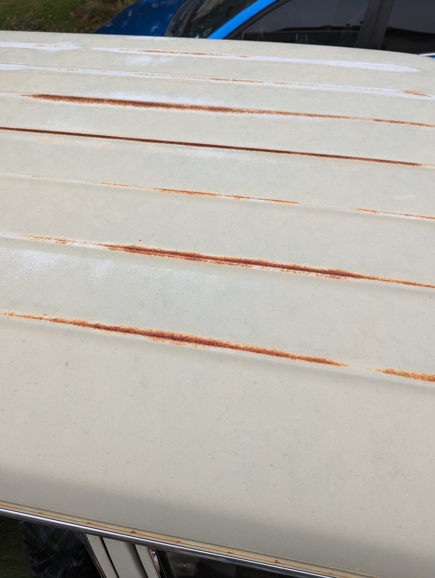

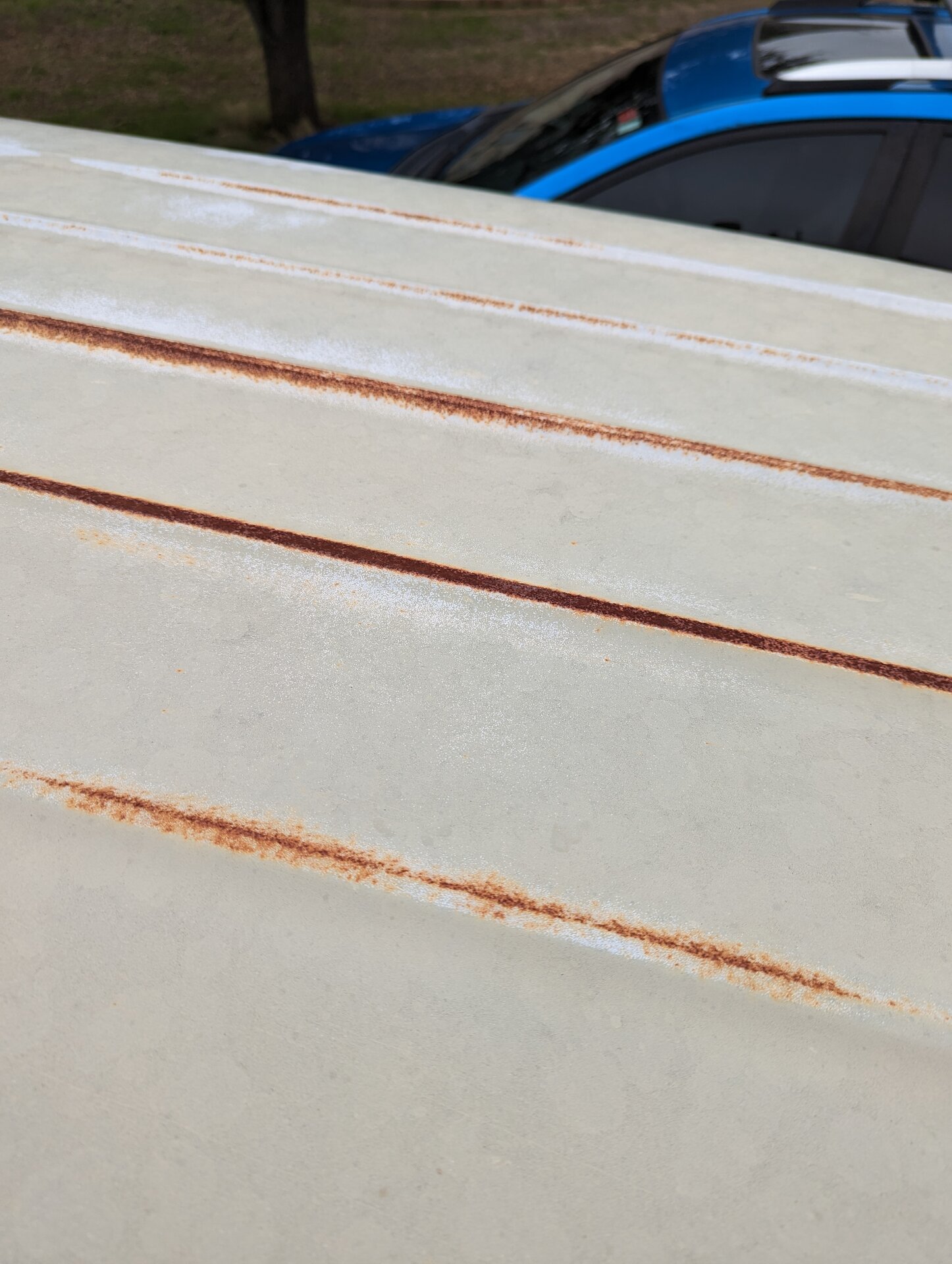

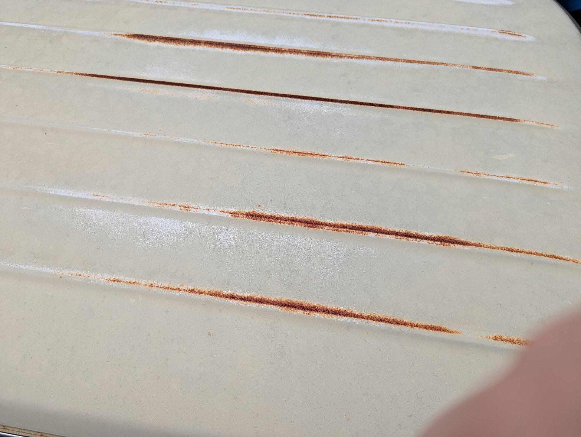

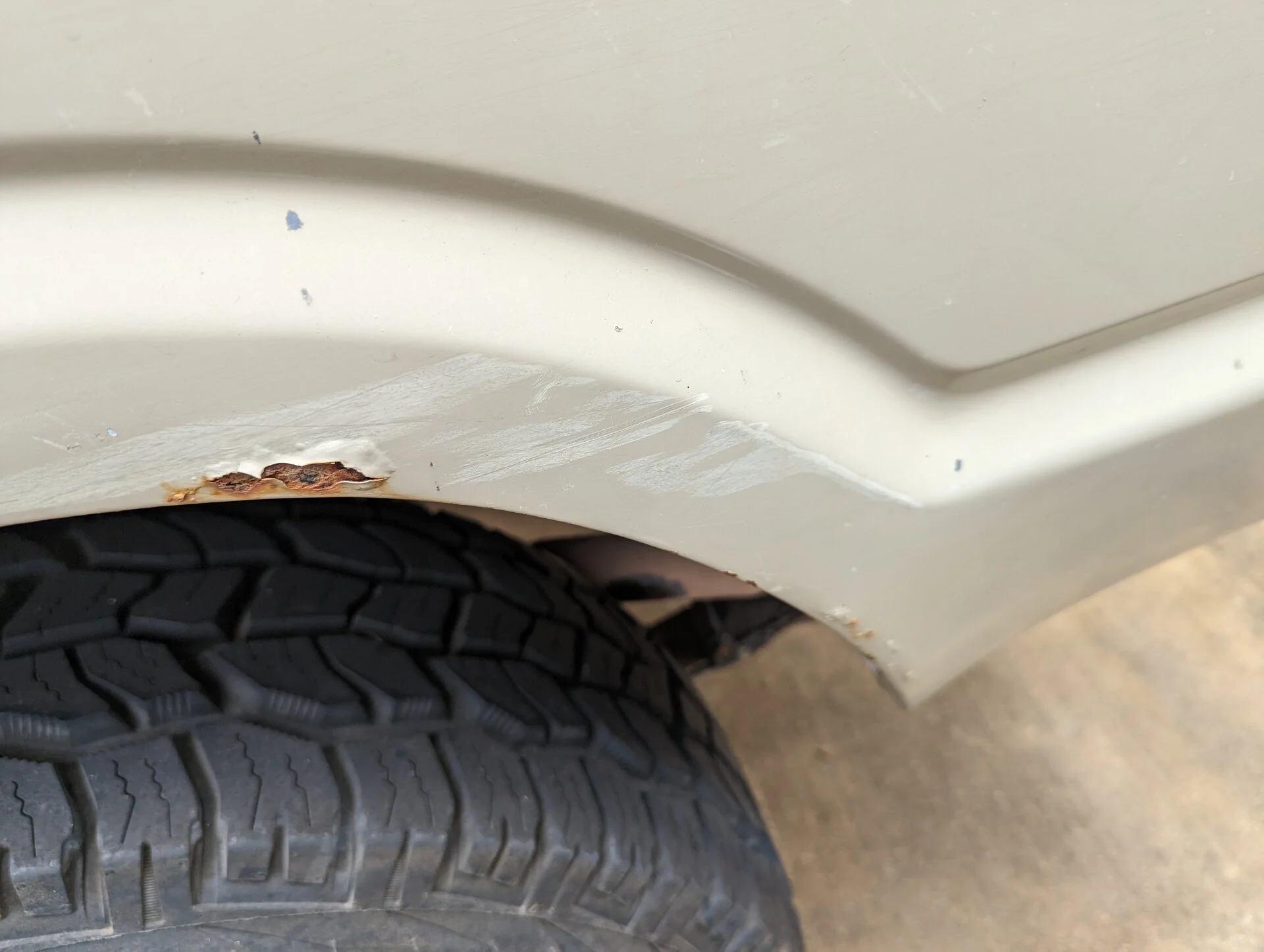

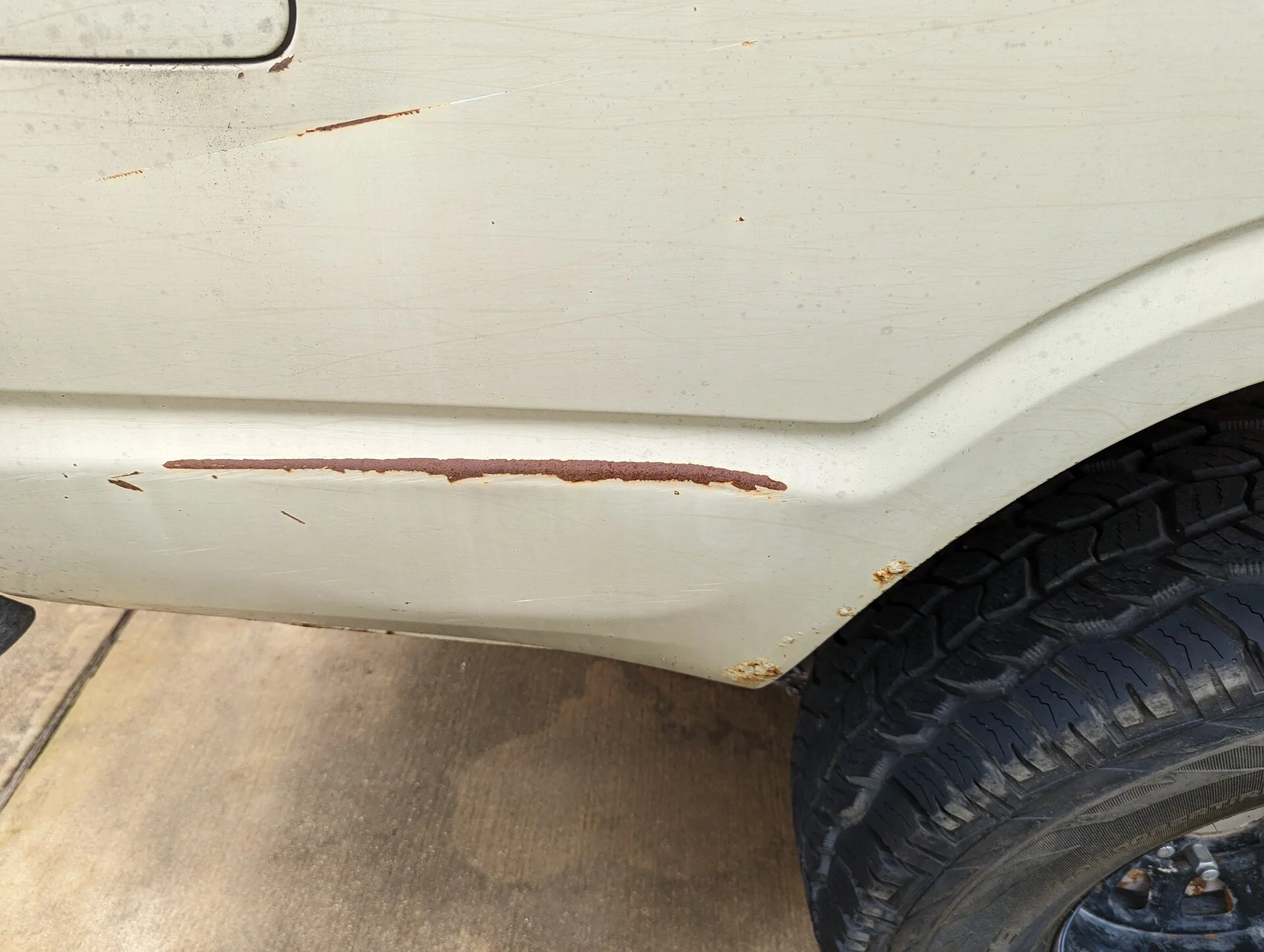

There are pics of the roof, I was discussing and the fenders I intend to tackle next.
The fender I'm going to grind out what I can and am expecting to have to weld in patch panels.
The roof I'm hoping to convert then prime and repaint with either a color match or paint the whole top of the roof white.

If it were me, I would go easy on the roof with abrasives. Maybe try an undraided wire wheel or steel brush first. If something more agressive is needed, creep up on it with the sand paper grits. That rust doesn't look too deep on the roof. That way you dont grind off the high points of the ribs.
