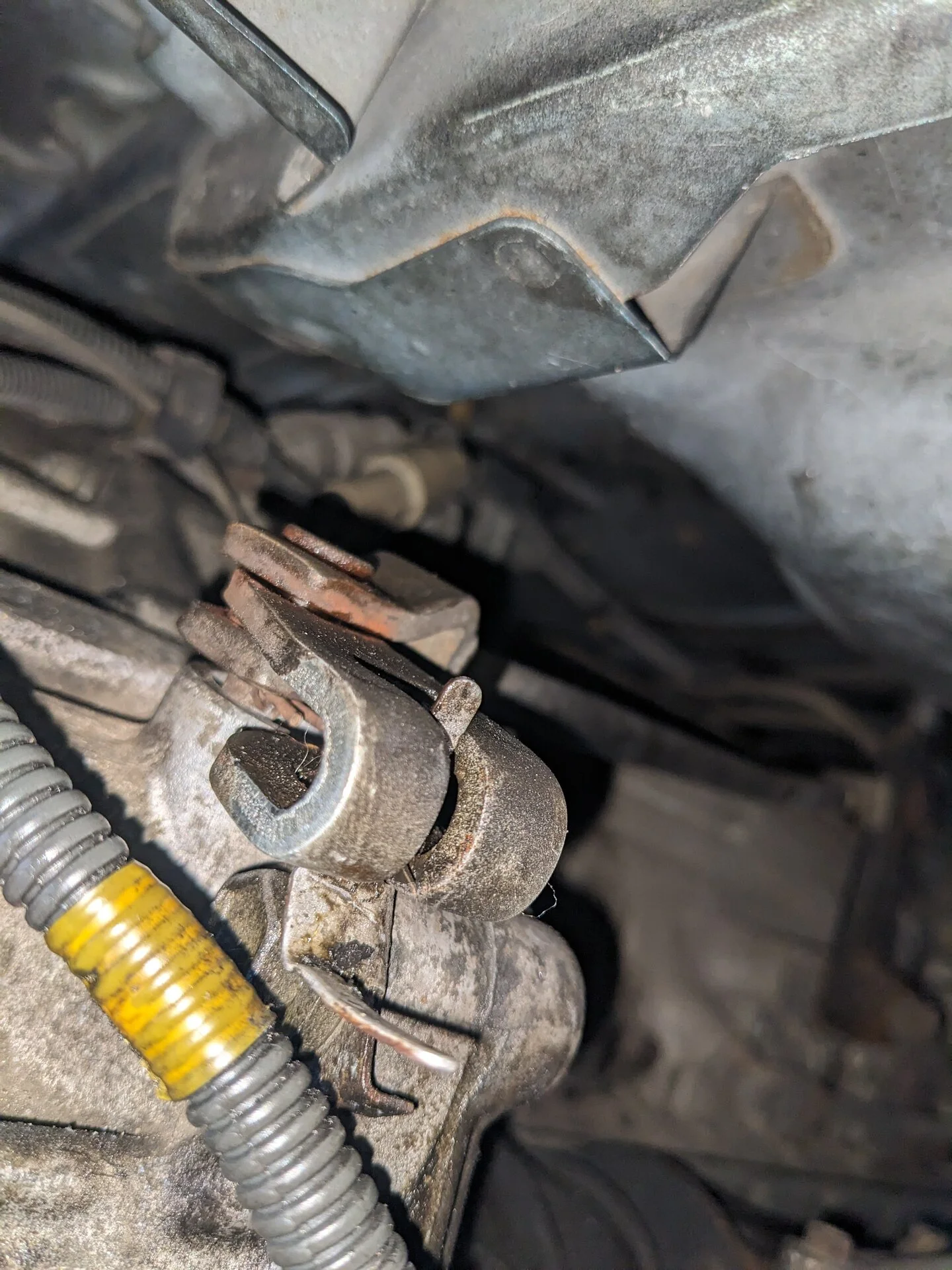

The linkage (behind the little yellow tape mark) being disconnected.
Closer look at the linkage. The shaft is just behind it in this picture.

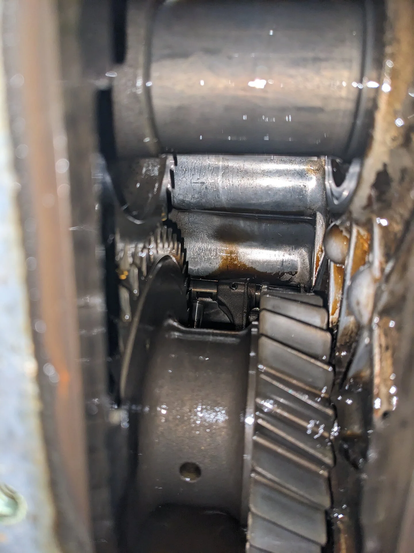

A look into the belly of the beast...
Took the PTO cover off. I think you can see the fork down there. I'm gonna try propping the shaft up with something. SMDH

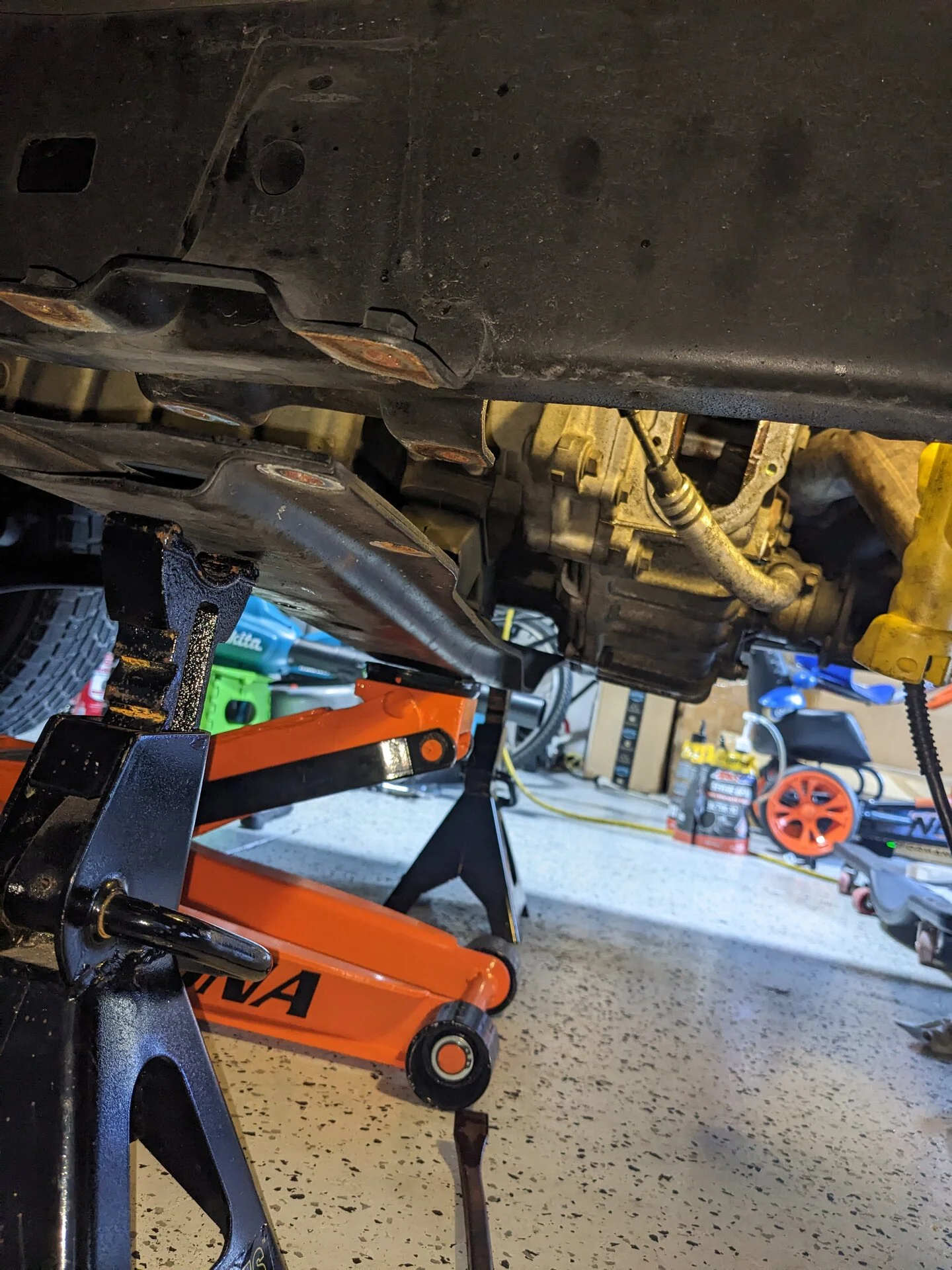

Cross member dropped 2"
That gave me a little better access in places and a little worse access in others. 😫
