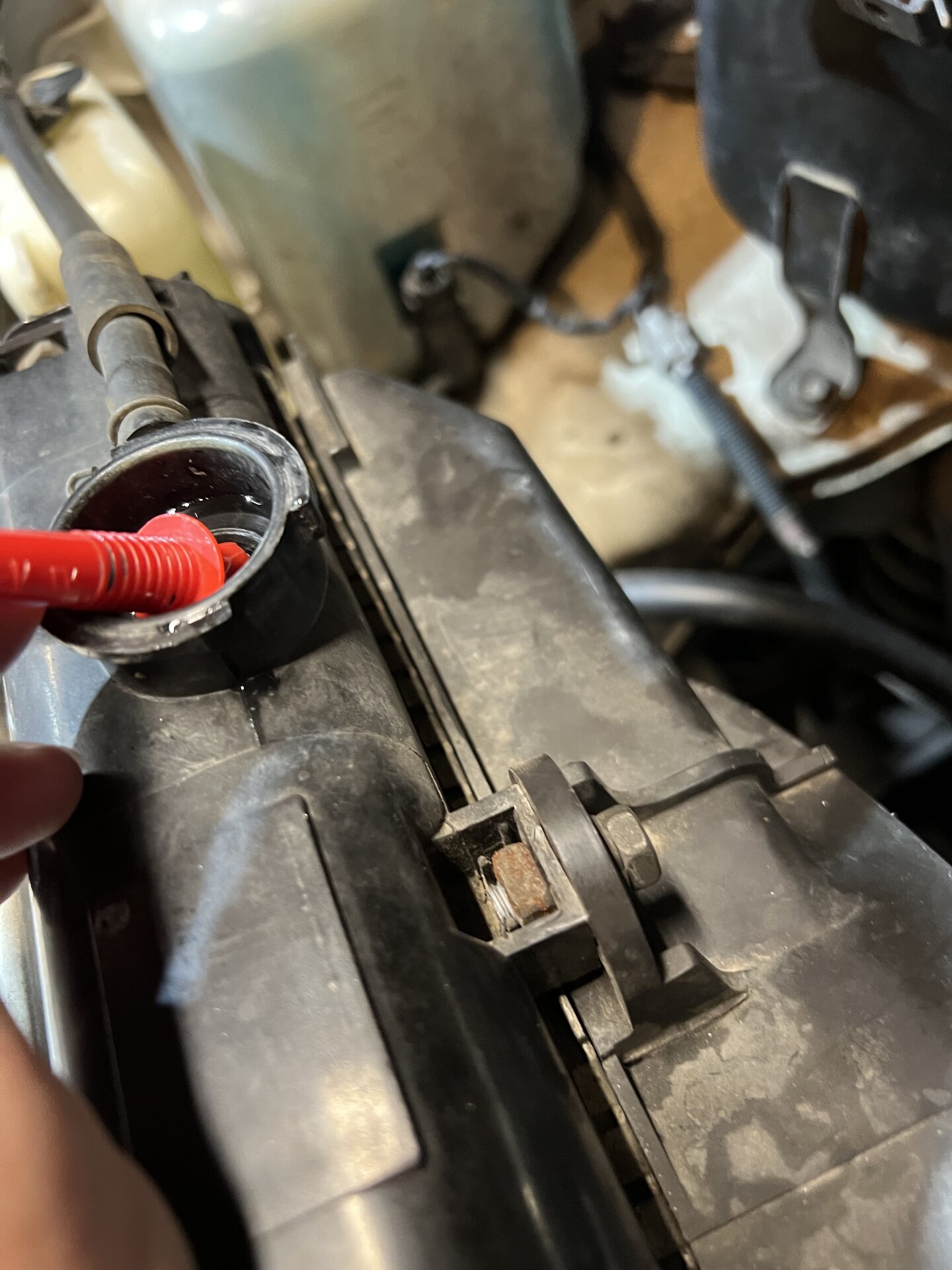

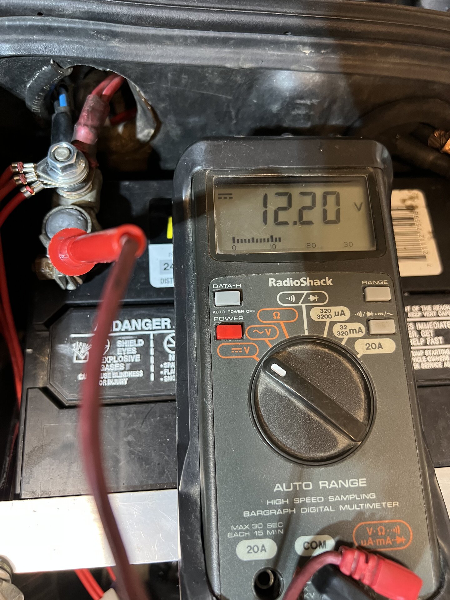

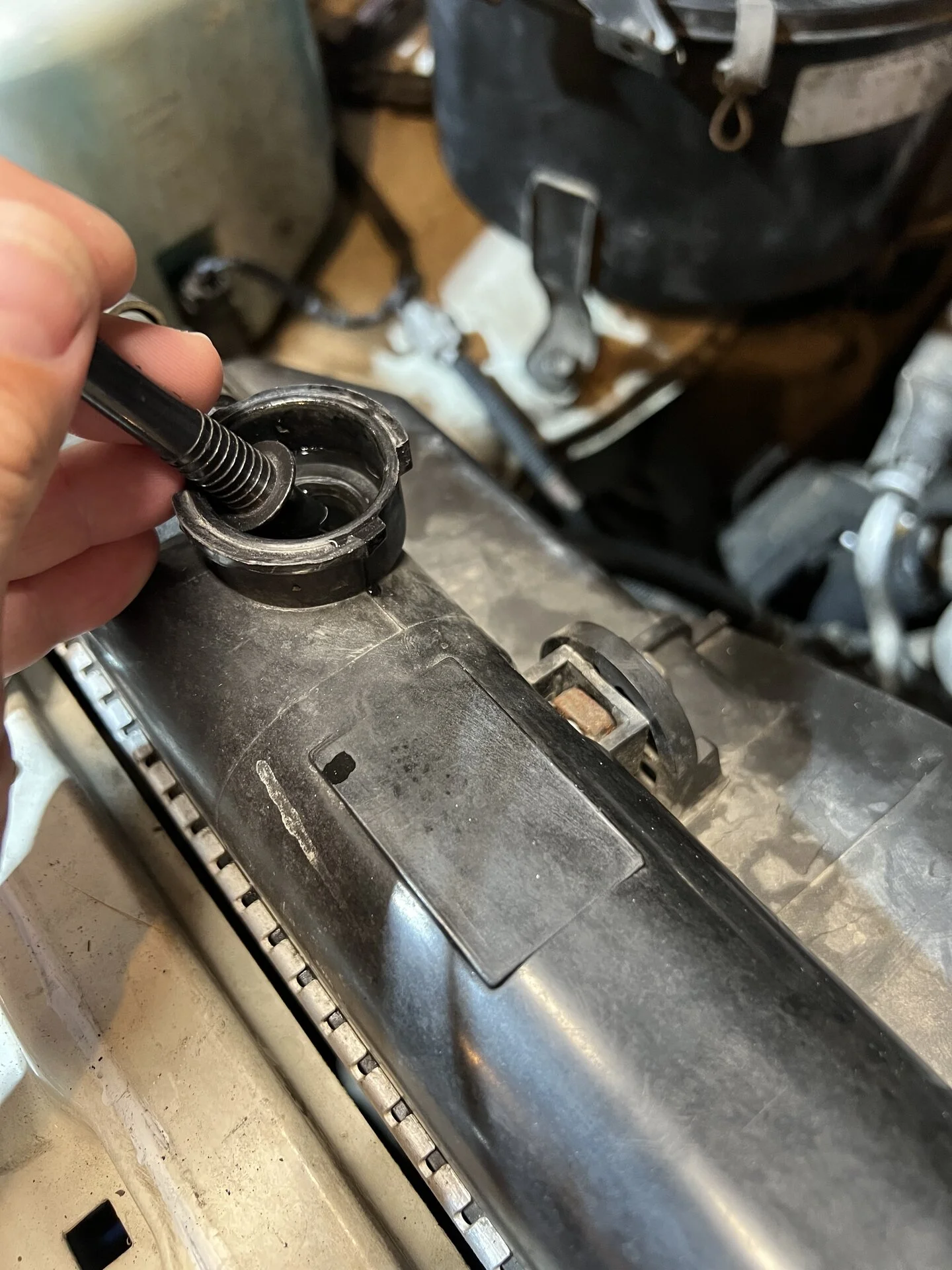

Ok, so I tried the first one - not running - and got ~ 12.20 volts dc.
I am running pure distilled water.

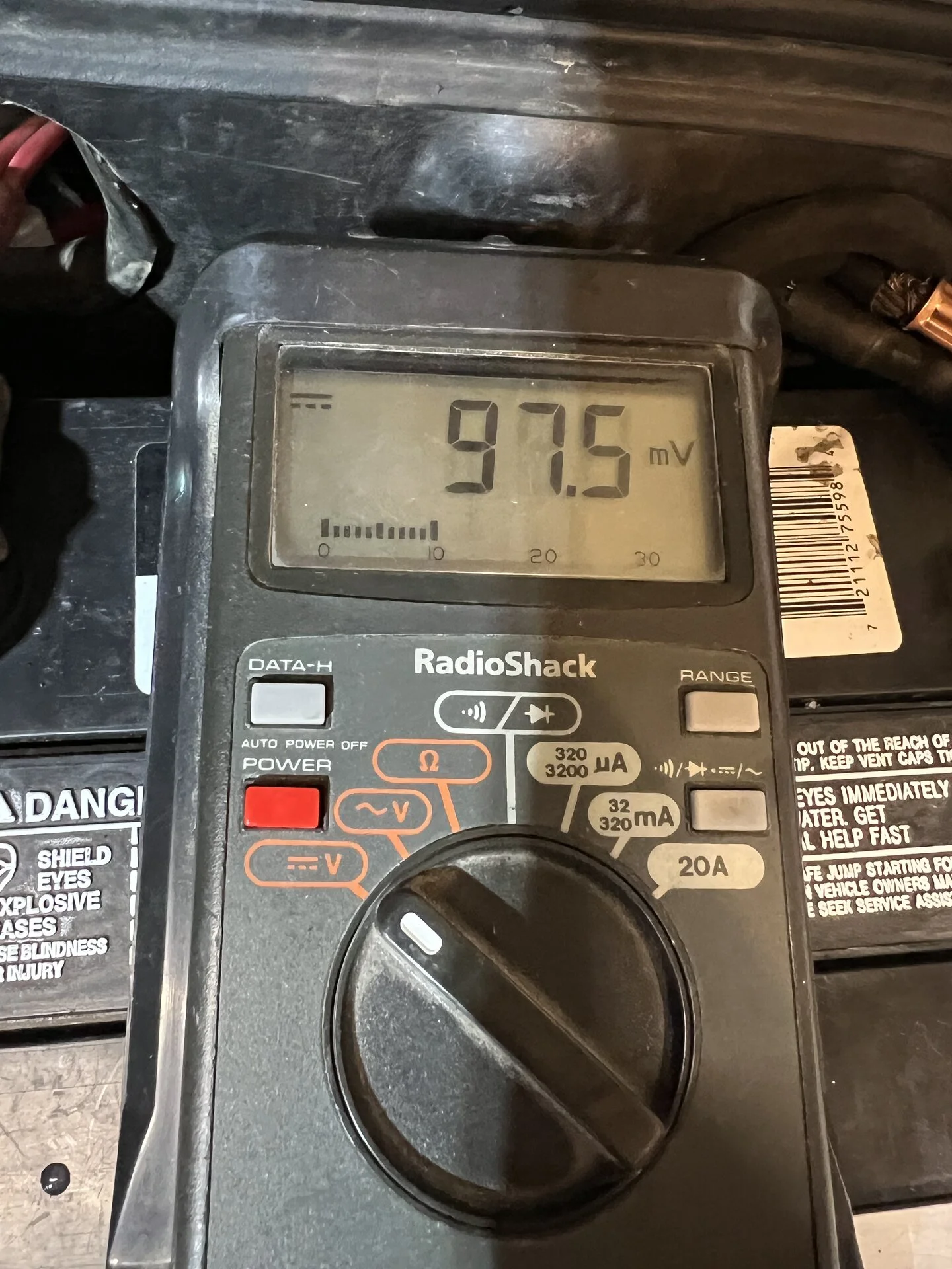

Go the other way.
Pos in coolant, neg at neg batt post/chassis.
Ok, you're good. (just under .1VDC for those not familiar)
Just my opinion, I don't feel that a ground issue is present.

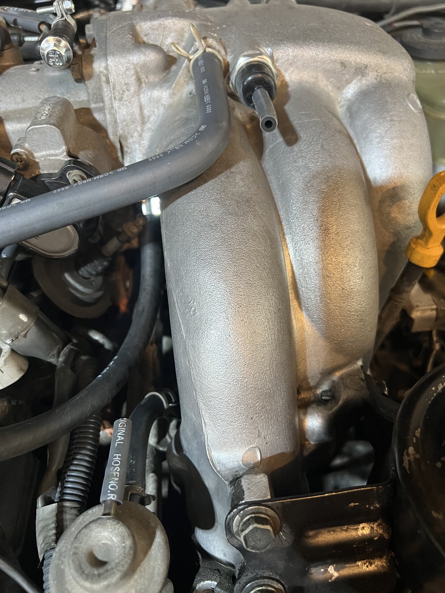

I’ve never deleted all that stuff, but it seems weird to apply constant engine vacuum to the fuel pressure regulator. If that’s typical for this mod, ignore me. But normally fuel pressure is controlled (more of like 2 steps) by a vsv that you removed.
Fair enough. I'll look this.
I had seen others here on 'mud run the line directly without a vsv and didn't read about any problems.
I removed that straight vacuum hose and plugged both the FPR and gas filter with a short section of new vacuum line with a bb in it. No change in behavior as far as I can tell, in a quick test in the garage (no driving).
To expand on that - There is a bb in both of those hose stubs so there is no vacuum leak at the intake, and there is no vacuum to the fuel pressure regulator. This is for testing purposes to eliminate a variable.

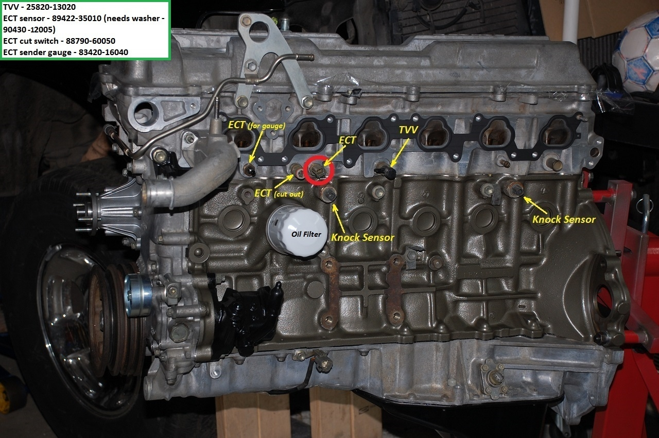

This diagram found on mud was super helpful - 1FZ-FE head sensor ID - https://forum.ih8mud.com/threads/1fz-fe-head-sensor-id.1276446/post-14296426
I (it sounds like incorrectly) assumed based on my research and the FSM, that the TVV was just a bimetalic valve that opened at temp and either allowed vacuum to pass or not, but the working end was submerged in coolant. I didn't think there would be any vacuum leak once the two lines were removed.
