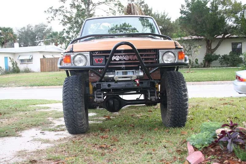

As my rig sits now.
1982 SOA with fj62 srpings
New Fj62 frame
Frame and body chopped 22"
Roof chopped and caged
37"MTRS
4 wheel disc, 4 runner calipers, brembos, rear GM discs and calipers
.250 track bar
Aussie locked front and rear
4.56
front and rear axles rebuilt
Marlin crawler hysteer, .250 drag-tie with fj80 tres,
hydro assist with 80 series PS box
Par-desmogged stock 2f/ H41/Splitcase
Tubing front and rear, Sliders, high clearence bumper, M8000 in cab controls
CB, hand throttle
10,000 other little doodads and upgrades...
Whats sitting in the shed/ what will be in the rig in the next 2 months.
Narrowed 14 bolt, spool and 4.11 gears, discs
Toybox and rebuilt h41
Narrowed D60 with 35 chromos, new brakes, 4.11s, spool,
8" ram , hysteer , 1 ton steering
.250 drive shafts
39.5 Iroks on 17" wheels
The above plans will be done before Tellico this May with any luck. I am also enclosing the cab right behind the front seat to make it more comfortable. Down the line I will prob completely lose the rear for tube and a 1/4 elliptical..

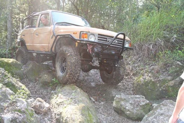

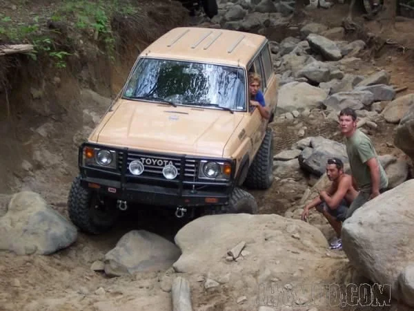

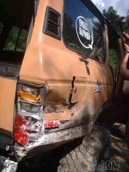

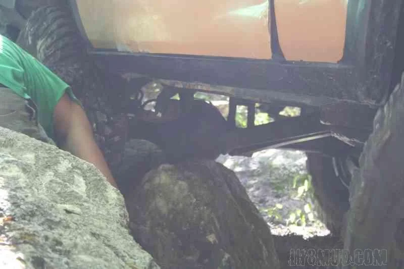

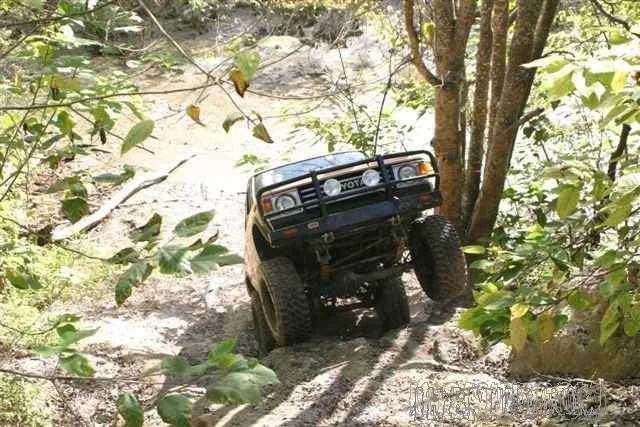

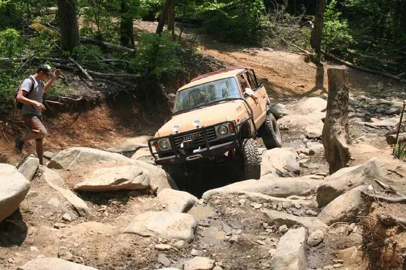

Here is a bunch of shots my from the past and I will throw some more up later of what the rig looks like now.
Peace, Love and Chicken Grease...
-Al
