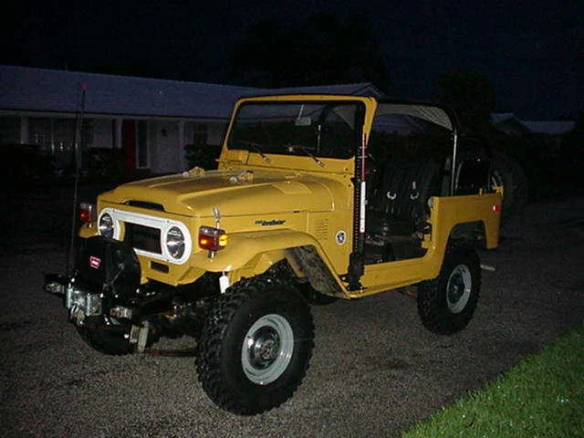

Here's a pic of where it kinda ended up in teh first few years:

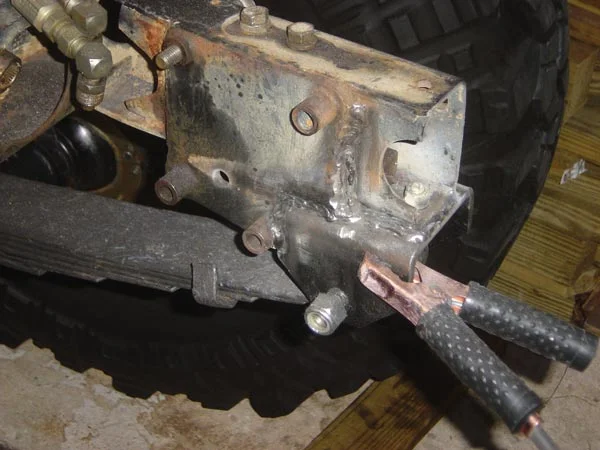

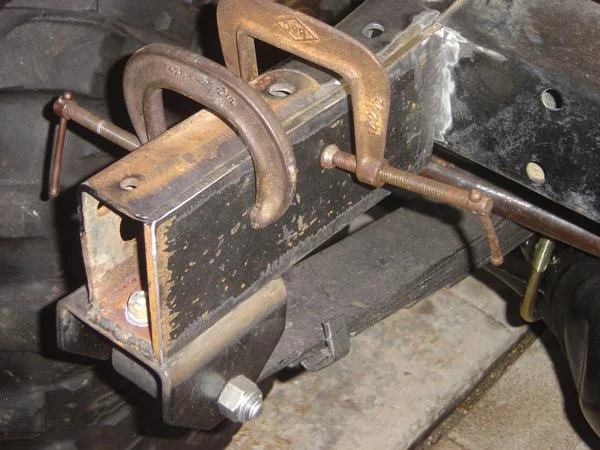

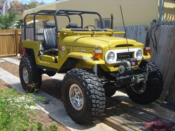

Currently: I've just added Polyperformance chromoly rear shafts - I'm in the process of fabbing up a beefy skidplate that I fabbed up with 1.25 x .125 square tubing and 5/16 plate, have fabbed up tract bar brackets to use a FJ80 front trailing arm as the traction bar with a shackle/heim to attach to the skidplate. Just got a set of 17" WE beadlocks and skored a set of 39" Red Label Krawlers. Tons more going on, just can't remember it all but I'll see if I can't find more pics, and wheeling pics to boot. So here's where I'm at this past week - with a serious need to put the cut off fenders back up front:
One of the nicer things I like about this is the fiberglass repro grill I got - I had a steel one I brought back in my surfboard bag years ago one a trip to CR or Panama, but I ended up trading that to someone for the glass version and $100 - which was a good deal to me at the time - and someone got a OEM grille that is in better hands than mine :D.
Also - has a 360 degree military pintle hook bolted into the rear cross member - kool touch if I only had the trailer to go with it.

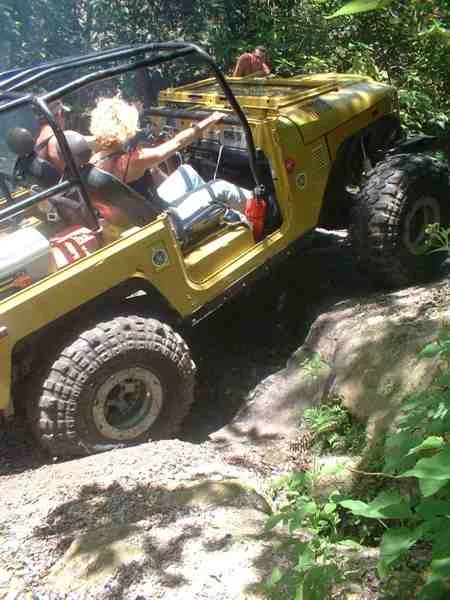

Right line on Slick Rock back when sprung under. Broke the right front frame horn forcing it into the rock trying to get a tyre up over - made it where a buddy with 40" MTR's and sprung over couldn't get traction :flipoff2:.
Great pics and build, Sputnik !! You've got a nice wheeler there. One question, in your pic of wheelin at Slickrock you mentioned making it up that spot sprung under where your buddy SOA didn't get enough traction. What differences have you noticed in both configurations? Thanks for the input, am enjoying your ROTW.:cheers:
