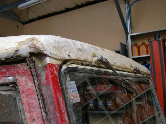

Sweet stuff. Can you snap a close up of your front roof lip removal. That makes a lot of sense. Can you still remove your top if you want to?
Rezarf <><
Rezarf <><
Yes - I cut the lip off flush to the metal part that bolts to the top of the screen. Then wrapped glass/kevlar over it to bond it in place, and strengthen it.
