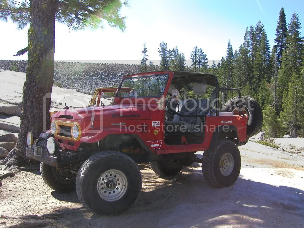

In June 2007, I went to Rubithon and just hiked along and took pictures of the rigs. I also took an off-road driving course on the Rubicon taught by Harald Pietschmann. Here is the Land Cruiser that I used for that course.

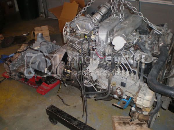

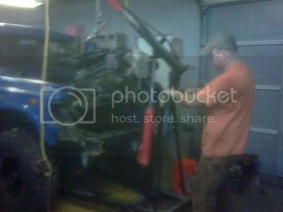

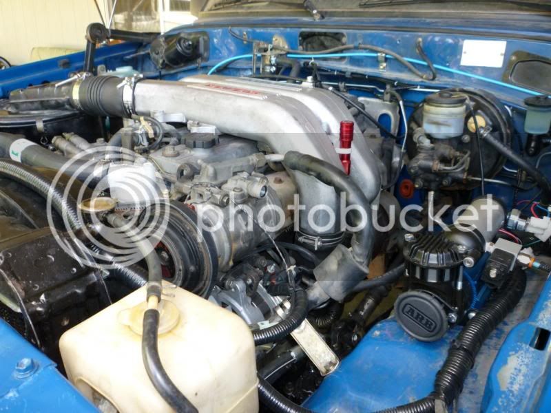

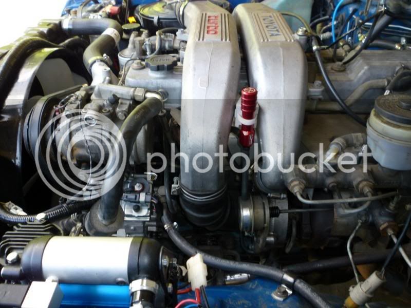

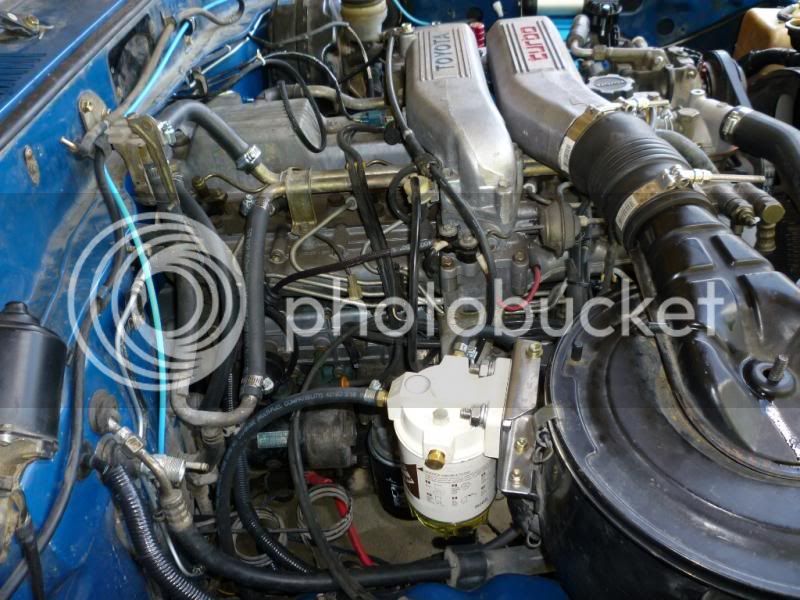

I guess the other thing that I am very excited about is the completion of my diesel swap. I got an amazing deal on a 12HT/h55/t-case. I did some finaggling and got a late-model manual t-case with the 2.32 gears since the t-case that came out of the New Zealand HJ61 was vacuum activated. My dad and I started the swap in June 2009 down in Davis, CA. We got the 2F pulled and the 12H-T partially prepped. The 12H-T was 24V and we converted it to 12V so that it would mesh with the rest of my 12V FJ60. It would have been nice to keep it 24V and have the 24v starter, which is supposed to be awesome but in the end it is simpler if we had both the engine and the body all one voltage. Here are some crappy cell phone pics of us pulling the engine.
And the 12H-T:
Here is the thread for the diesel swap -
https://forum.ih8mud.com/diesel-tech-24-volts-systems/285006-iron-mule-12ht-fj60.html

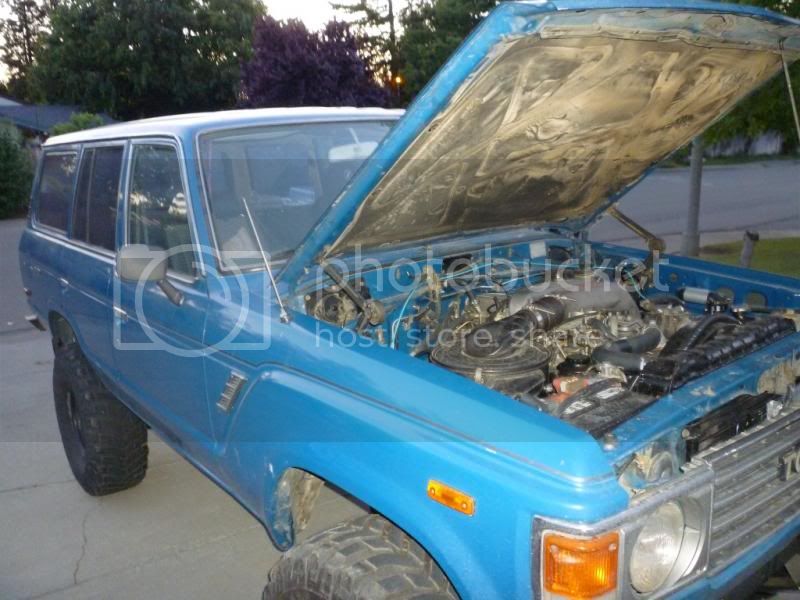

So after many delays and a couple of snafus, David (iron_giant) has finished the diesel swap that my dad and I started. He is driving it up to Oregon this next week and we are going to put on the rear bumper, sliders, and snorkel. He says that it hauls now. I didn't complain about the 2F that was in there before, although when we were driving in the mountians on the road on the way out of Death Valley, the 2F was having some major problems just trying to keep up with traffic. But overall, the 2F did fine. But the 12H-T with the turbo, now that is something I am looking forward to driving.
