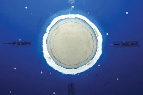

Hopefully these images show up. One of the images shows a standard honeycomb repair done in aviation. All if want to borrow is one of the layers (metal) and "paste" it on with adhesive, more permanent than silicone. The second picture (blue paint) is composite patch but I wanted you to get an idea of how flush it could be. The metal could be cut 1/2 -1 inch larger than the area that is damaged. I just need to find a good adhesive available to everyone. I am sure that someone has done something similar at least once.

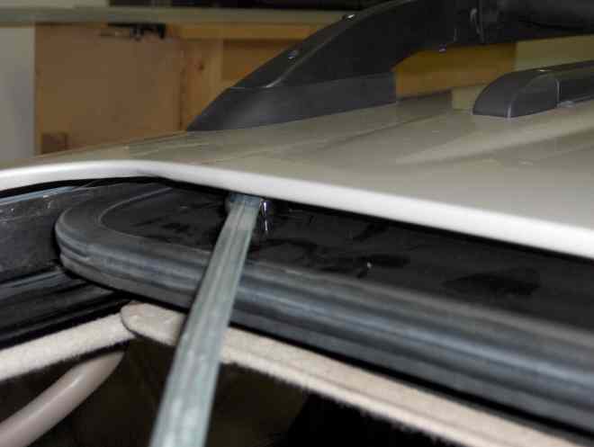

If you have 3rd row speakers, you can remove the plastic covers and get access to the roof rack holes. This opens up the possibility of adhering metal to the underside of the hole. You could JB Weld a quarter there and it would would probably last a lifetime.
The front holes are more of a challenge, but there is a path via the moonroof. You could perhaps fish some wire through the roof hole, along the moonroof, and through the center of a quarter (or other metal piece). Then pull the wire so the quarter is pulled tight against the underside of the hole. You would have to get some adhesive in there at some point.
This would really be bonding the metal patch panel to the paint on the underside of the roof, but if you can get the surfaces clean it should work.
