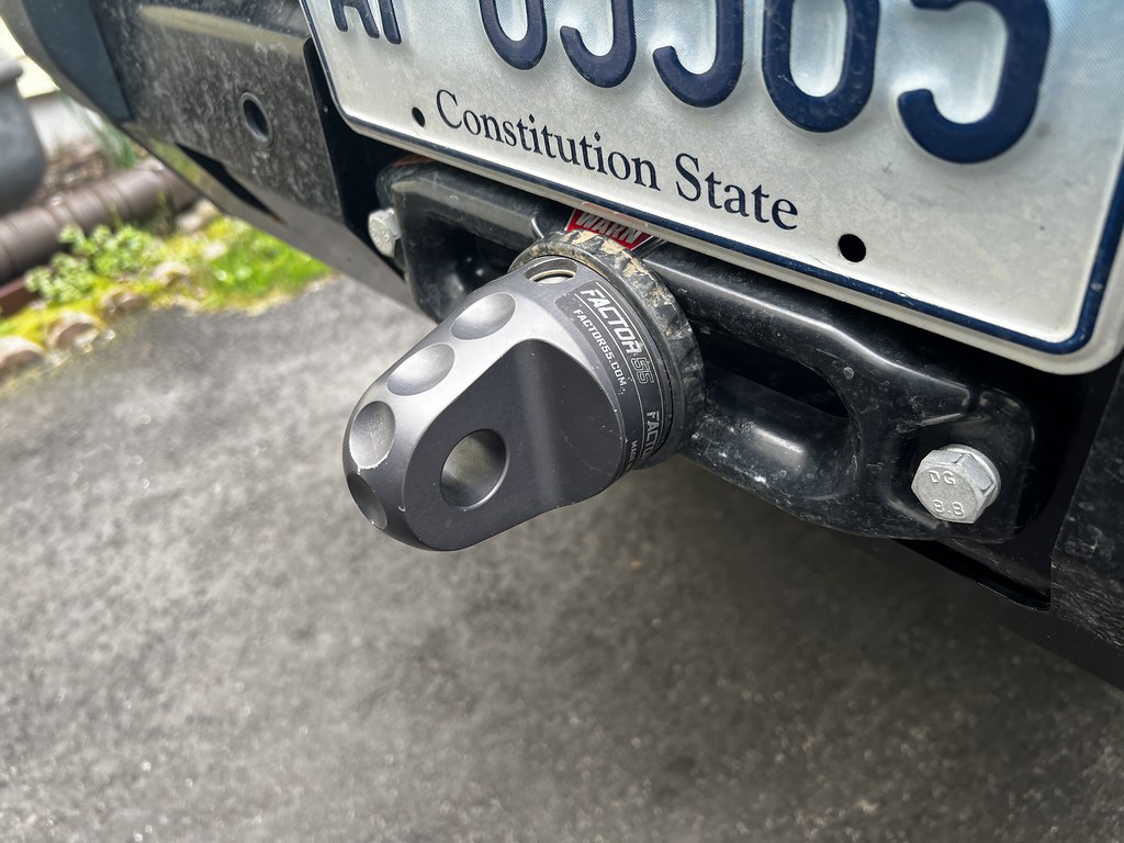

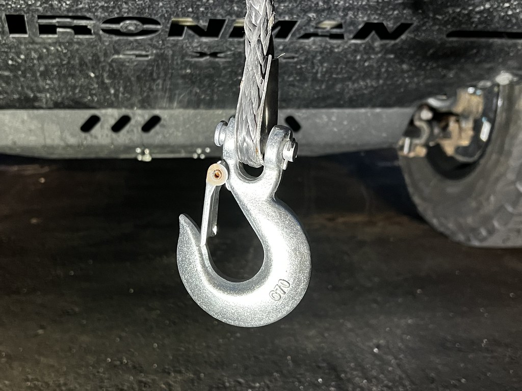

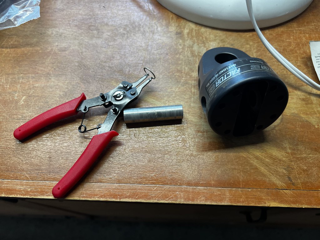

Swapped out the traditional metal winch hook for a Factor 55 Prolink. Super easy process, took less than 5 minutes (once the snap ring tool I had to order arrived).
Before:
Step 1: Remove the cotter pin from the metal hook, extract the pin, and remove the hook from the winch line
Step 2: Remove the snap ring from the Prolink and remove the metal pin
Step 3: Slide the looped winch line into the Prolink, reinsert the pin, and reinstall the snap ring

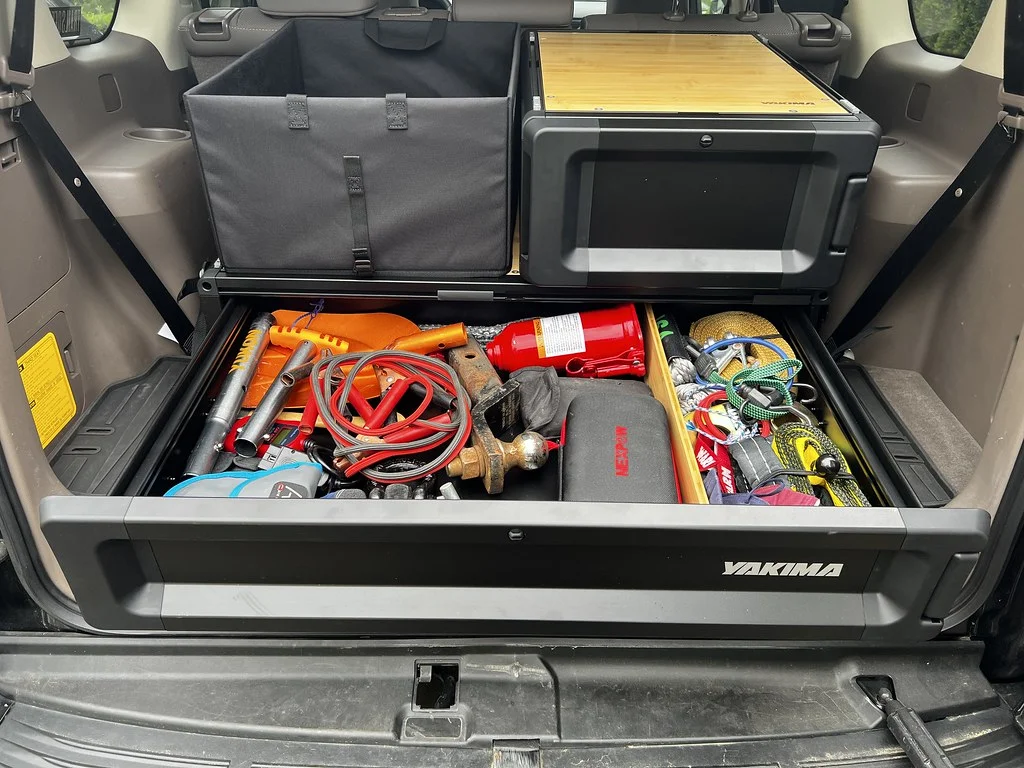

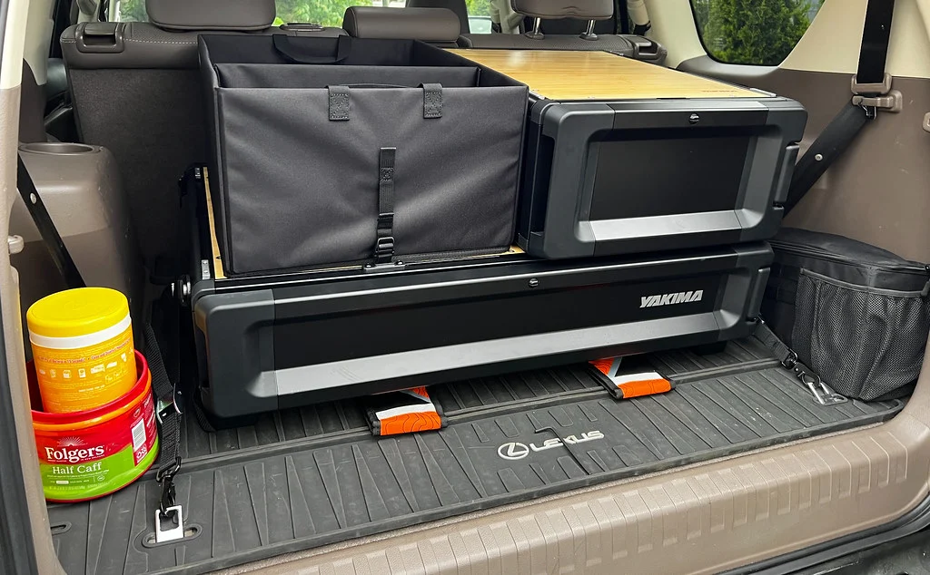

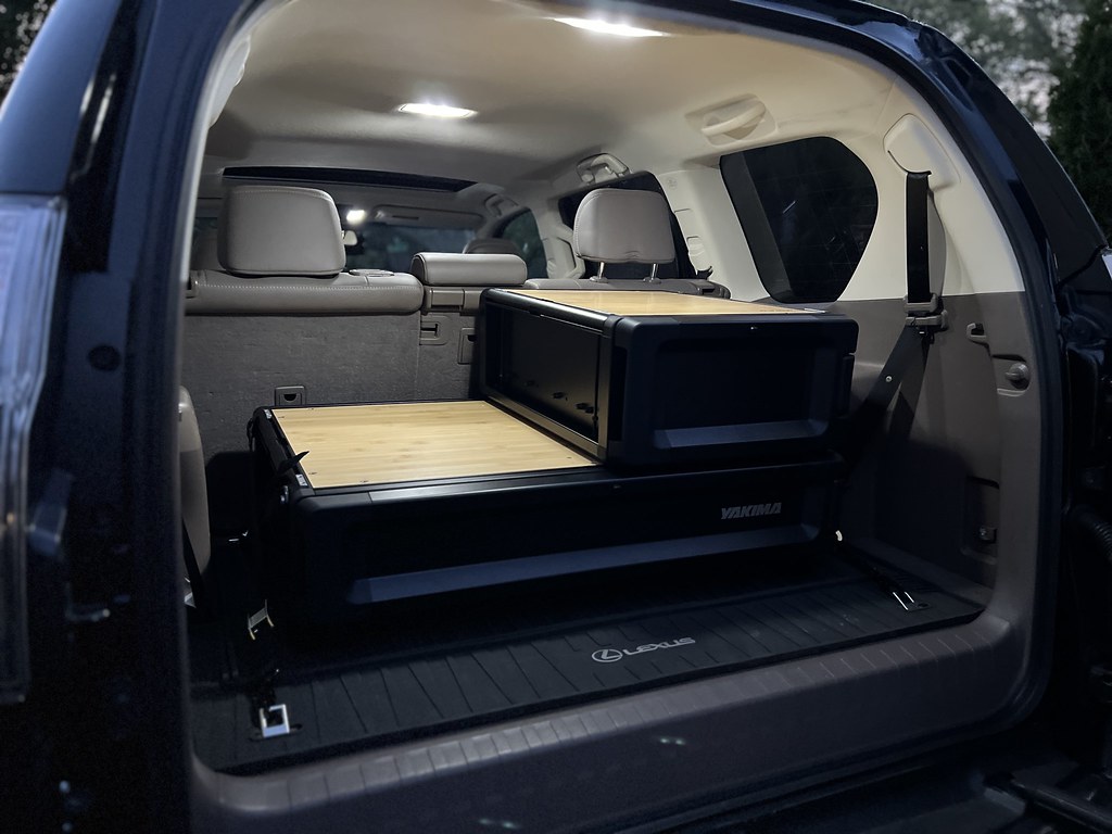

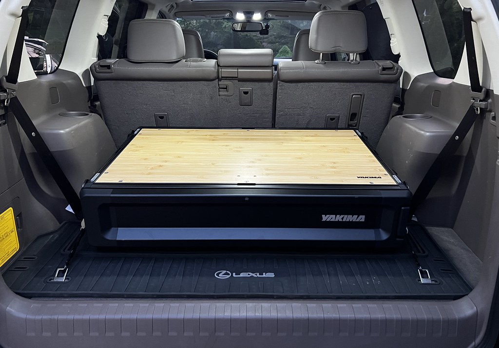

GX update. I'm testing Yakima's new MOD drawer/storage system which is new to the market. It's a neat piece of kit, with built-in ways to add extra drawers or other things (like the Gear Tote that's on the top left in the later photos here). I've been long looking for a modular setup for the GX trunk so that I can rearrange as wanted/needed and this is serving that purpose well. It can also be swapped from vehicle to vehicle relatively easy, since the HomeBase portion is "mounted" in place with straps that pull tight to the trunk's tie-down points.

That would be nice to kit bash into my 3rd row delete, if I ever get a rear tire mount.
Installing it so it was flush against the floor of the GX where the third row used to live would be pretty sweet. Functional and out of the way, etc.
[IMG]
Love it! Yeah, it's not as custom of fit for all the nooks and cranny's, but it's simple, solid and looks like it can be taken out on a whim if you need the full rear space. And it looks to fit over the the third seats with out removing.
What'd it cost ya??
What'd it cost ya??
It's definitely a modular system, which is a great thing for people who have multiple vehicles they use for adventures or those who swap vehicles somewhat often. Being able to reconfigure on a whim is nice, too. I currently have it set up in what I'm calling "sport mode," which means just the Topper as a standalone drawer with space to the left of it for my daughter's travel potty.

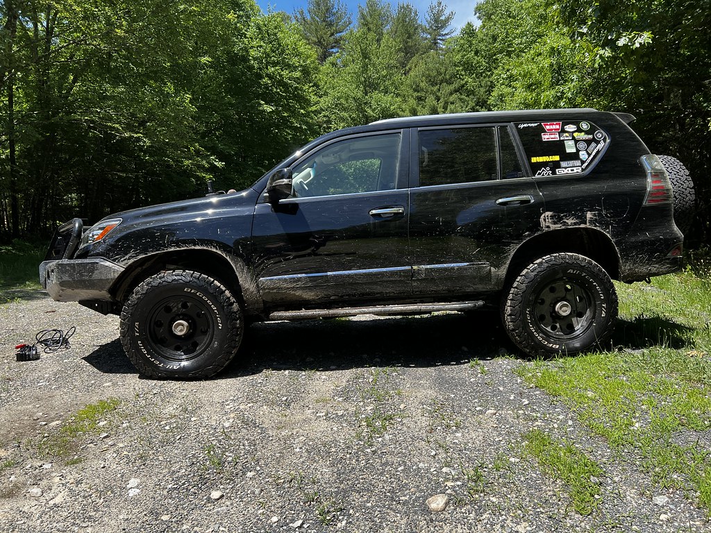

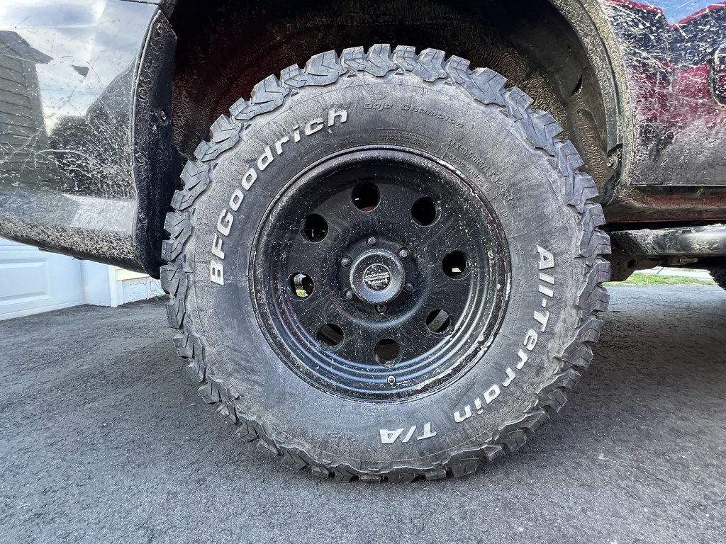

Impressions - BFGoodrich KO2 34x10.5R17, load D rating:
  • Looks great as it always has
  • Minimal to no decrease in acceleration in going from the 285s
  • Decreased rolling resistance versus 285s is noticeable when coasting and on the highway
  • Significantly better riding than the E-rated Toyos they replaced, presumably more the load rating than the difference in tires
  • More road noise and vibration than the Toyos
  • Very good off-road - not spectacular in mud, as they don't clean out all that well, but excellent on the rocks
  • Track true around town, on highways, and when aired down off-road
  • Less bead protection than the Open Country A/T IIIs but still sufficient for most applications
  • Great footprint off-road when aired down
  • An enjoyable tire to have on the vehicle
  • At the end of the day I probably prefer the Toyos on-road but the BFGs off-road. Overall, both are absolutely fantastic
  • I hope BFG releases the KO3 in this and other "pizza cutter" sizes as it's the best of both worlds
Also been running these American Racing AR172 Baja wheels in 17x8 size (optimal for the skinny KO2s), impressions below the pictures.
AR172 Baja impressions:
  • Classic 4WD look that's generally love-it-or-hate-it (I love it)
  • I don't love the center caps which stick out way to far... might have to modify this myself
  • The bead of the wheel has taken a bunch of impact on rocks and is holding up fine but definitely shows battle scars
  • Fairly light (25.31# each) and don't feel like it-- no worries about integrity whatsoever

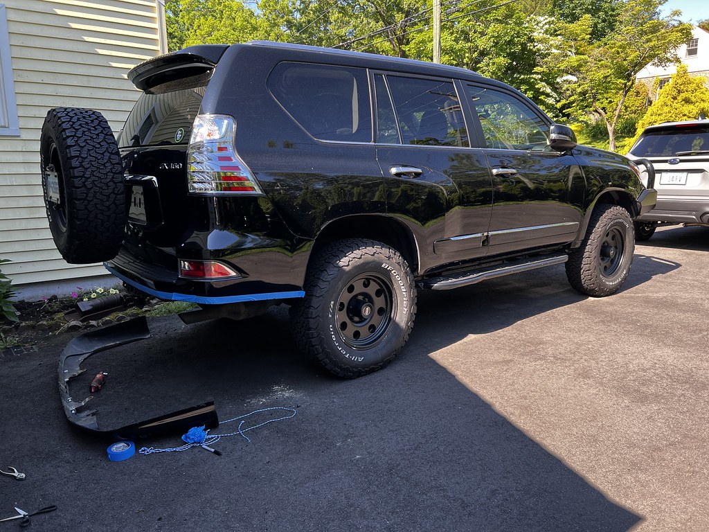

Last update for now: Trimmed the GX's rear bumper. It had taken some bashing already but figured before it became an issue on the trail I'd just go for it. Followed some "guides" (i.e., other 460 owners' methods), charged the Dremel, and lobbed a bunch of plastic off. Also added some door edge trim along the bottom for a clean-ish look; it's not even remotely professional looking but it's better than just a sawed off bumper look. More pictures to come.
