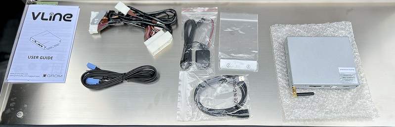

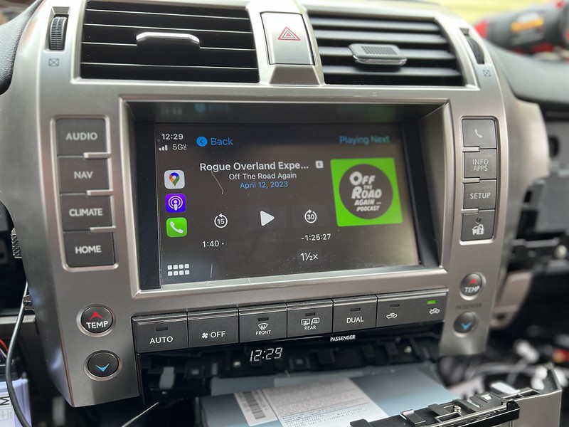

Lexus didn’t add Apple CarPlay/Android Auto to the GX460 until 2022. To modernize my 2018 GX’s infotainment, Grom kindly sent over their VLine VL2 infotainment upgrade unit for me to put to the test. The VLine VL2 system is an Android-based car infotainment add-on that integrates into your vehicle’s factory (OEM) stereo. It works seamlessly with the existing stereo screen/display, sound system, and buttons/controls. CarPlay can be used wired or wirelessly, and there’s Google-backed voice activation to further the safety factor. Once installed, the VLine2 can run apps like Google Maps, Spotify, Pandora, and so on, the former two of which were my main reasons for pursuing CarPlay in the first place.
Now, for the installation process. While the VLine2 is made for the GX460, I did run across some nuances in how the Grom unit isn’t perfectly tailored to all GX460s with differences in year, options, and so on. Likewise, while Grom recommends installing the “brain” in the glovebox, I did not deem that an efficient use of space and didn’t like the mounting options, so I opted to put it in the center console which is already partially-occupied by my Midland MXT500 GMRS radio. Overall, the installation process isn’t insurmountable but it isn’t the easiest thing in the world. Your results and experience very well may vary from mine, and keep in mind that this is more of an outline than a perfect step-by-step (with the included instructions being the best practice for following to install the unit). Note that my instructions vary slightly from Grom’s, and the pictures of the process included below aren't entirely in the perfect order.
Here’s my general walkthrough of installing the Grom VLine VL2:
  • Read the user manual (Sounds silly but just do it… there’s some helpful, can’t-miss steps in there)
  • Disconnect the negative terminal from the battery
  • Put the parking brake on
  • Pull off the panels that cover either side of the center tunnel from the bottom of the center stack to the center console (Note: All panels can be removed with a trim removal tool or by hand if you can get the right leverage)
  • Remove the trim panel above the glovebox
  • Remove the three metal screws on each side of radio that hold it in (They’re all 10mm bolts)
  • Undo the Start/Stop ignition button (You can leave it hanging so the wires from the button are still connected)
  • Unscrew and remove the shifter
  • Remove the plastic tab that covers the shift release button (You can use a pry tool or a small flathead screwdriver; I used the latter)
  • Push down on the button and put the truck in Neutral (If the vehicle isn’t on a perfectly flat surface you’ll also quickly find out if your parking brake is working)
  • Lift up and back on the area that surrounds the shifter and nearby switches. It should separate from the cupholder, which should be left in place. Undo the connectors for the 4LO and DAC switches, and any others if you have them (I had heated/cooled seat controls to unclip; others may have MTS switches to disconnect).
  • Remove the small rectangular plastic panel above the little cubby/lid by pulling backwards

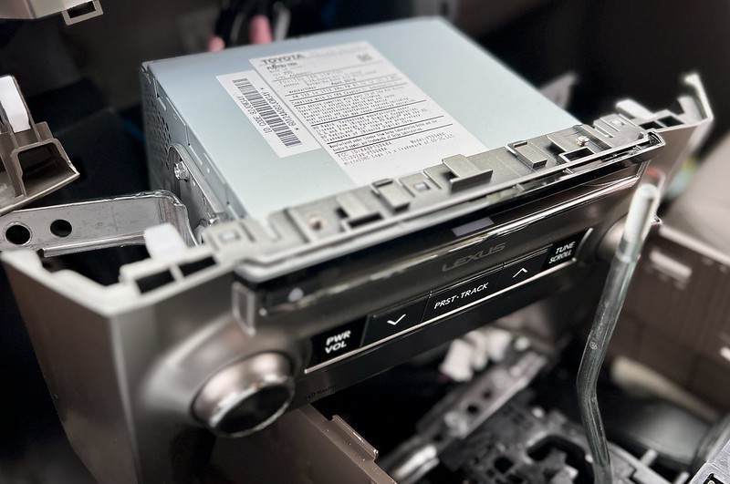

  • Pull outward on the radio to remove it, then undo the connectors (I recommend keeping these connectors together with a rubber band or some sort of zip-tie)

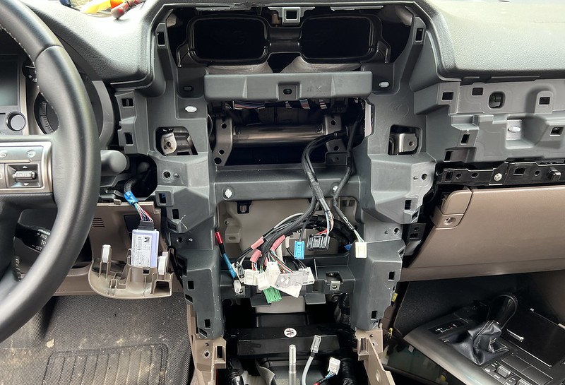

  • Pull outward on the plastic that surrounds the center screen to remove this panel, then undo the connectors
  • Find the provided antenna. Use the tape on the bottom of the antenna to stick it to the top side of the passenger-side vent that sits atop the center stack. Make sure it’s far enough back that it won’t interfere with reinstallation of the vent housing when you put the screen assembly back in. Push down on the antenna and hold for thirty seconds so the tape sticks well.
  • Run the wire for the antenna through the dashboard into the glovebox (Or wherever you choose to mount the metal box. This is where I diverted from the instructions and chose to put it in the center console, which in turn affected all of the install steps that follow).
  • Take the other provided wires-- USB, video, harnesses, etc-- and run one end out of the middle of the center stack, and the other end to wherever you’ll be mounting the “brain." I first tried it in the glovebox, but didn't like it there. Images reflect this later.
  • Connect the Grom VLine VL2’s “brain” to the radio and the screen. Match up the wires to the correct plugs/connectors and snap them into place. Make sure to plug the male end of the blue plug into the female end of the Grom line (blue). Push the screen section back into the dashboard.
  • Test the unit. To do so, you need to make the vehicle aware of the module. The process is to first reconnect the battery. Then, push ON/ACC (without starting the vehicle), count to five, shut the power back off, wait one minute, then put the vehicle back into ON/ACC mode.
  • Access the VLine by going to the audio source menu and selecting AUX. Go through the setup process as the Grom unit and the vehicle’s computer become friends.
  • If it all works, proceed to the next steps. If not, make sure everything is properly connected (Consult the Installation Manual if required).
  • Mount the module. Grom’s recommends doing so in the glovebox, but I put my VL2 in the center console. It has to be at a slightly awkward angle, but it's still better than the glovebox in my opinion.

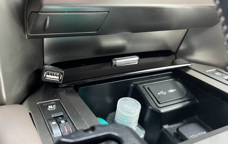

  • Run the wires in a way that you can keep the wires out of the way and logically sorted. Should you want, find a place to run the end of the USB that is used for wired CarPlay so that it’s easily accessible (I ran it between the radio and the little cubby that’s in front of the shifter)
  • Work backwards to reinstall the screen, radio, and panels in reverse order
  • Download apps by using WiFi if so desired
  • Enjoy that your vehicle’s infotainment is no longer in the technological stone age

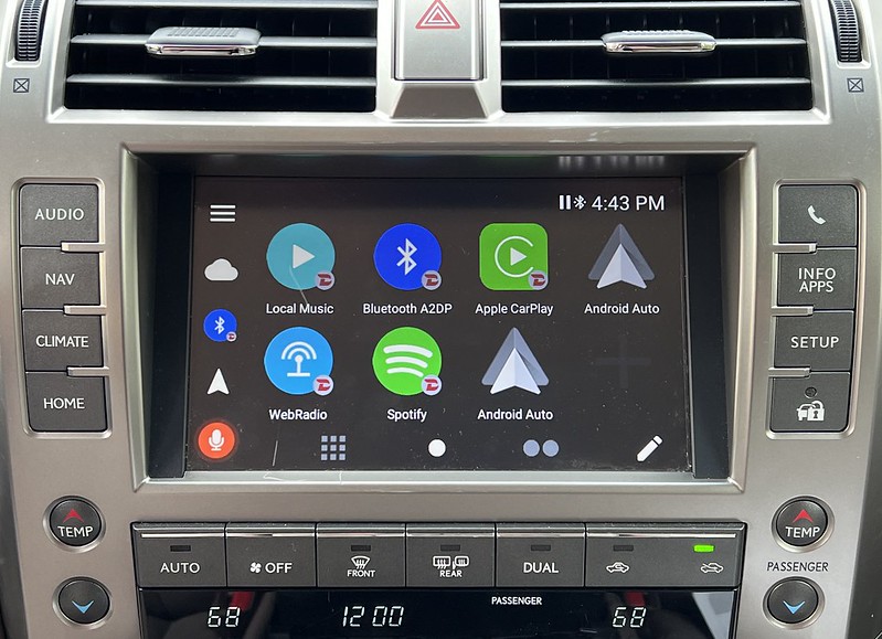

Once installed, I played around with the interface to get a sense of it. The limitation is clearly in the Lexus’ outdated screen, which isn’t nearly as responsive to touches as more modern vehicles. It makes things slightly clunky, but you’ll only notice it if you spend a lot of time in new cars. Otherwise, the system now works just as CarPlay should. At the time of this writing I had yet to try the wireless functionality but I’m happy to report that when using wired CarPlay, it does the job just fine. I’ve used Google Maps, Spotify, and Apple Podcasts already, and love that my phone is mirrored on the main screen. It immediately makes the GX’s interior feel more of-the-times, and the vehicle safer to operate, too.
That said, it’s not perfect. I don’t have wireless CarPlay set up not for a lack of effort but because the process to do so is not intuitive. I’ll revisit this when time allows. Other frustrations are that the system needs to be connected to WiFi in order to download the actual Google Maps app onto the unit itself. In my opinion, Google Maps should just be on there in the first place, and if you don’t have good WiFi at your house then you will need to set up a hotspot and pair it with the Grom unit to make things work (I used my iPhone to do so). Entering the lengthy password took countless tries as the sensitivity of the screen was not cooperating with my inputs. Other issues are from the installation itself. Running the wires from the screen and radio to wherever you mount the module can be difficult, and the extra harnesses shoved behind the radio makes reinstalling the radio itself a brutal process of finding the right space, correct angle, and seemingly making the stars align. Given, someone better equipped to do an install like this (i.e., more skilled and experienced) probably wouldn’t run into this issue. I’m just passing along the troubles I had, which at the end of the day didn’t prevent me from driving or using the vehicle in any way while the project was ongoing.
What I really like most about the Grom VLine VL2 is that it uses the OEM screen to mirror cell phone operations rather than requiring the addition of a supplemental screen. It retains the steering wheel controls, too, and CarPlay is a natural fit for a vehicle even as relatively (mechanically) ancient as my Lexus. Grom’s VLine VL2 retails for $679.95, and it’s a reasonable price to pay for a unit that transforms the modernity of a vehicle’s infotainment system, which you interact with (or at least I do) every time I’m in the vehicle. While the installation process was a bear, adding CarPlay to a pre-2022 GX460 comes in a lot less expensive than upgrading to a newer vehicle just to get newer infotainment. And for that reason alone, it’s worth its weight in gold.

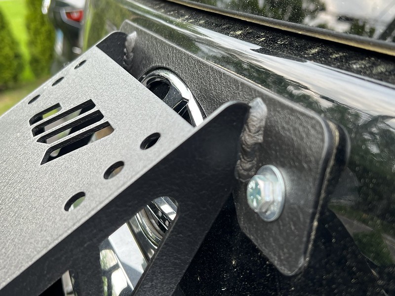

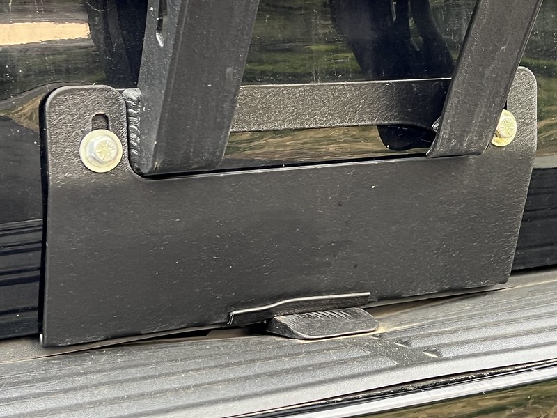

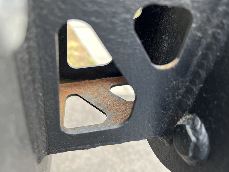

Pulled the spare tire off for a rotation so wanted to post some pictures of the JW Offroad tire carrier and provide an update on it since it's a frequently discussed product on here. For reference, this was installed 1/2022 at around 29,000 miles (current mileage is around 33,000). The truck has been off road a few times since the JW carrier was installed, it's been driven near-daily around town on the awful CT/NY roads, and I do open/close the tailgate with regularity. The wheel/tire combo that lives on it is an E-rated 285/70/17 Toyo Open Country A/T III wrapped around a 17" Motegi Trailite, which my math puts at around 79 pounds combined.
Happy to report that the tailgate itself appears, at least from the outside, to still be completely intact. The actual tire bracket, too, is in excellent shape. The JW-supplied hardware (nuts and bolts used to hold the reverse camera and backup light in place) aren't doing as well, with rust definitely being a factor here. Same goes for the studs the lug nuts bolt onto, and there's a bit of surface rust inside the carrier's opening between the main part that bolts to the door and the mount for the wheel itself (this appears to be surface rust from water collecting on the flat surface). None of this surface rust hampers how the carrier functions. As for the tailgate's ability to swing open/closed, it's clear that the plate/stopper used to keep the door off the bumper is getting a workout, but it doesn't seem to be to any real detriment. I do also appreciate the quick-disconnect wires that JW chose to use for the reverse light and camera extension.
Overall I'm satisfied with how the JW Offroad tire carrier setup is holding up. It's not perfect by any means, but it's a decent-enough solution until a better one comes along or until I have the time/skills to fabricate something a bit more stout that remains integrated into the door (swingouts are a PITA). If anyone has questions about it, fire away.
[Limited to 5 pictures/post but can add others if anyone wants to see anything specific]
Looks like just a little wire brush and bit of black Rust-Oleum, then some WD-40 on the bolts when you bolt it all back on. It looked like they couldn't get the inside of the bracket well enough with the powder coating.
Suggest every month or so to reapply WD-40 on trouble spots..
That's the plan. Clean up the threads and do some preventative spray-painting, then back on with the spare.
I will say that when I reached out to JW regarding the rusted hardware for the reverse light and they sent me replacements. Not a major issue to have by any means, but glad they were willing to help remedy it.
I'm glad it's working out well - there's a lot of comments online about the longevity of these (all anecdotal) but doesn't seem like the actual owners have any issues. I'm still waffling between this and a separate carrier, as I agree that having a separate unit you need to unlatch is annoying. It just needs to become another maintenance item when you do oil changes/rotations and it seems like it'll be fine.
100% true. Most of the people commenting on the JW kit don't have actual experience with it, but are rather speculating about how their GX's tailgate will/won't hold up with the carrier installed. I'm only at ~16 months with it on my 460 but so far so good. Actuality is the only thing that matters.

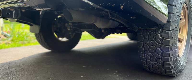

Good thing to trim those mud flaps now, you'd eventually wind up tearing them off later.
I hope you kept the running boards. If/when you put sliders on, chopping the boards up like a set of Parado covers looks really nice. Nice looking rig!
