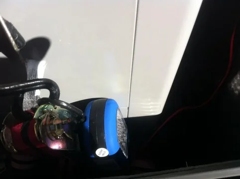

Another low tech mod for fridge lighting, I picked up a cheap harbor freight LED light for a $3. It has a main light and a light that shines out the bottom when hanging. It hangs on my tie down strap when not in use, and I can grab it easy for other things. Last couple things I've bought from HF came with batteries!
http://t.harborfreight.com/27-led-p...227.html?utm_referrer=https://www.google.com/
http://t.harborfreight.com/27-led-portable-worklight-flashlight-67227.html?utm_referrer=https%3A%2F%2Fwww.google.com%2F
I was thinking about rigging up something like this with a pin switch to turn it on when the lid is open.
