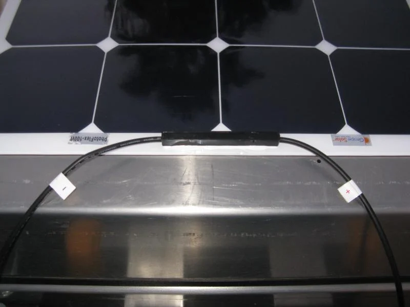

I do not use a Renogy panel. Presently I using a super thin (.12") panel from grape solar we have been using there panels (mostly frame mounted) for a few years now with excellent results.
I have several controllers now Im on the Morningstar but I think Im going back to a Xantrex C12 due to the ability to adjust each of the 3 stages of charging. Most of the 100 watt system I have set up uses the Sunforce 60031 10 Amp Digital Charge Controller, inexpensive with a good track record.

Mono crystalline only.
Mostly 100W
I like Grape Solar out of Oregon for me they have been great to work with.
32 or 36 cell in the 100w? Looking at GS now, since you have had good luck with them I wanted to replicate the "Phil" setup!
