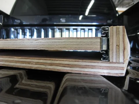

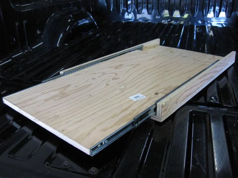

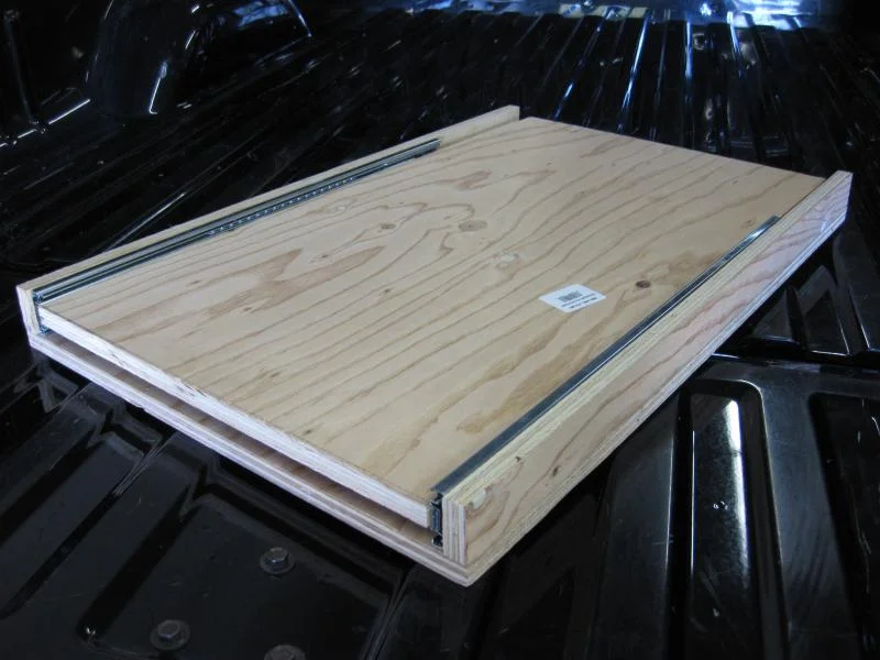

There is a link to my DIY slide build in an earlier post to this thread. I used 24" 100lb slides, but the fridge has the tailgate below it when extended. I would recommend much heavier slides for those without a fold down tailgate. And use the highest grade wood you can buy, if you decide to use wood. I think my build cost around $100 including wood, slides, and hardware... It fits my 63 quart near exact.

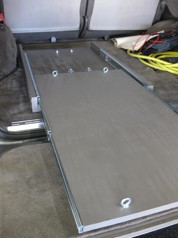

I read TXLX100's thread for ideas and modified it a bit for myself. I have no shelf and made it as low as possible. I purchased longer bolts to secure the slide. They bolt into where the four factory holes are for the seat brackets.
Still wrapping it up. I'm spraying them the bronze color that matches the brown interior trim....
Here are a few pics:

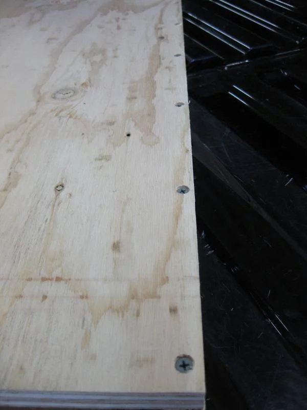

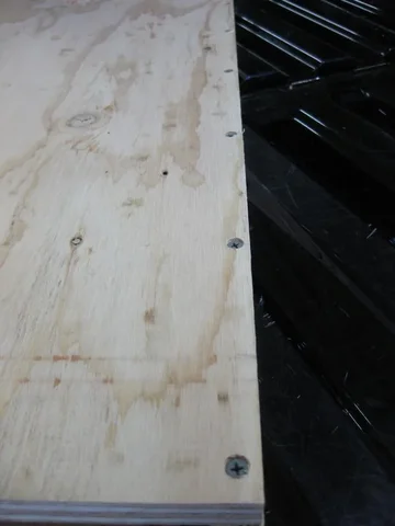

Holes pre-drilled with screws every 5 inches.

Looks good TYM. How do you plan to keep it locked when closed? Mine slide is setup a little different, I used an Allen wrench through the side to lock it.

Finished painting and adding hardware.
TYM, you might be able to go straight through the side with a small locking pin. Going through top to bottom might have a lot of slop (in my experience). Just thinking out loud, you could pull the slide all the way out and drill, from the inner, through one of the forward blank holes in the slide. And then drill from the outside using that pilot hole, through the base and slide to create the lock hole. I used a small Allen wrench as my locking pin.

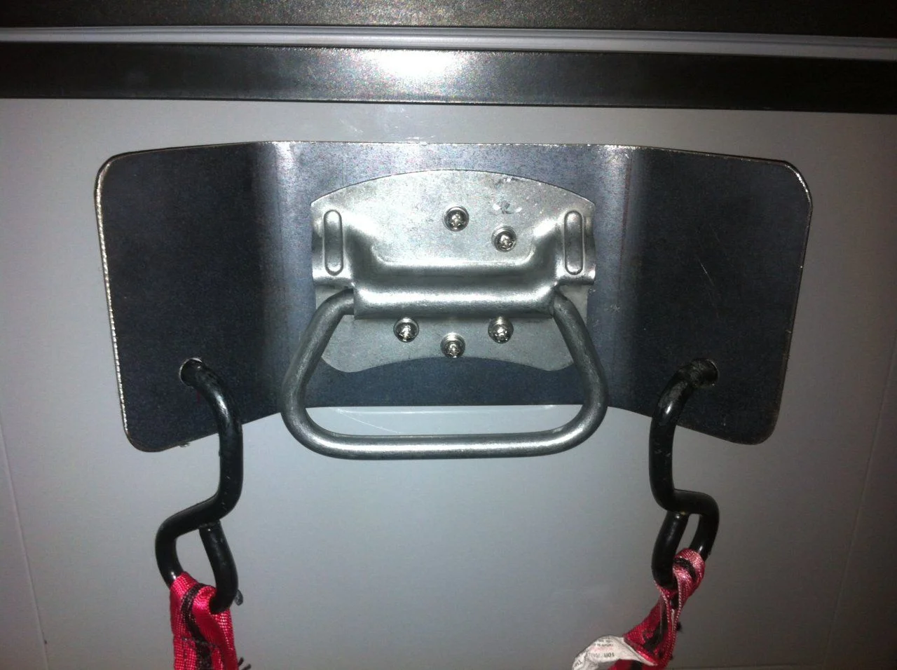

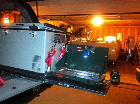

I received my new chest handles from Zoro Tools today (idea courtesy of warezdog). I bought them direct from Zoro Tools because F ebay. It was truly a 1 beer job in the dark. I did not paint them and don't know if I will (I think I have an aversion to painting coming from a long line of house painters). I may be able to ditch the plate steel now that I have the metal handles... Right now, I have the handles zip tied to my tie down hooks to keep them from bouncing around since they are not sprung. My sweet wife commented on the unsightlyness of 4 tie down straps to secure the fridge to the slide and I agree, so I will try to track down 4 turn buckles with hooks, or if someone has a better suggestion.... I have the two original edgestar handles if anyone wants them.

I had not tested out my Coleman stove to determine if it would fit on the sliding table. It fits, but just barely, the bottle is hanging on by about a half inch. 28" slides should be about perfect for a Edgestar 63 quart and a standard Coleman 2 burner stove with small bottle (I used 24" slides from Lowes or HD). The cheapo HF light I got for the fridge light will also hang off the stove in case I ever need to cook at night. (They are free right now if you receive HF coupons in the mail)
Coming from a guy that doesn't necessarily "wheel" or go on camping trips with just the truck, this fridge and slide setup has been a great addtion to my LX470. It performs well for grocery trips, trips to the lake, etc... And REALLY like not having to rush home after getting groceries. So buy one if you have the chance! (Buy 2)
