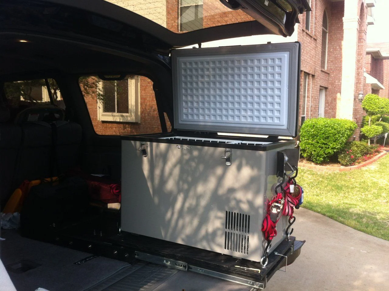

I frigging love that slide out, it turned out really nice and the stove fits perfect!
How much room you got to open the lid? With my drawer build complete I think I've screwed myself getting room to get into it but I haven't had the time to get the fridge back in the truck yet so I guess I'll find out this weekend.
The lid barely brushes the top weather strip when open and the rests on the d pillar, it opens about 97% of full, but enough to stay vertical on its own.

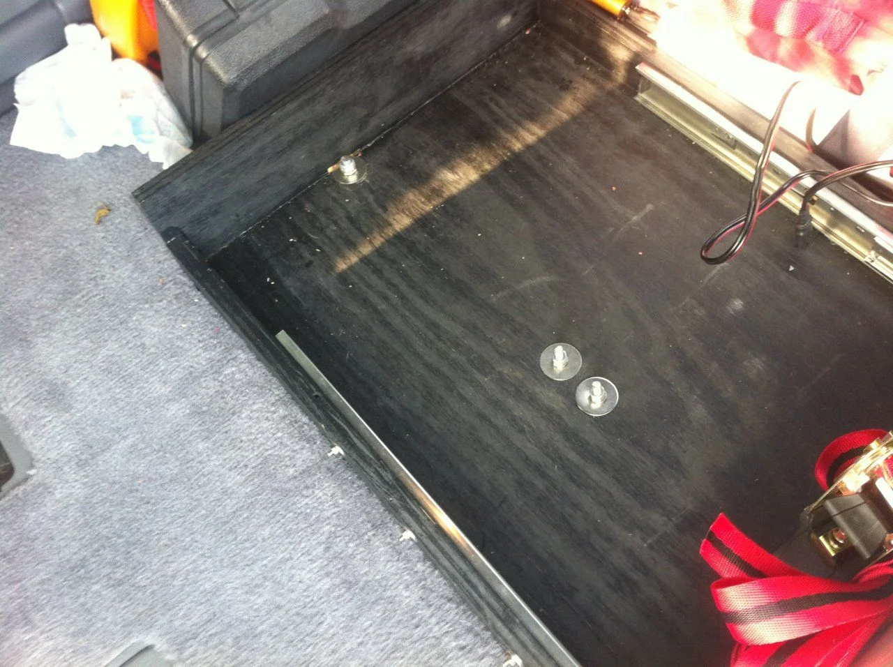

I wanted to keep my third seat mounts, so I had to use a J-bolt on the fore mount in order to make it work, because the slide base is just barely long enough to reach when I have to pulled towards the back of the truck.
Basically, the tolerances are completely maxed out with the mounting to the truck, the fridge sliding out and opening the lid, and putting a stove on the table. So if you are going to do a slide like mine, I highly recommend using at least 28" slides and going a little longer on the unit. I think I can switch to 28" slides in the future, but it's working right now.

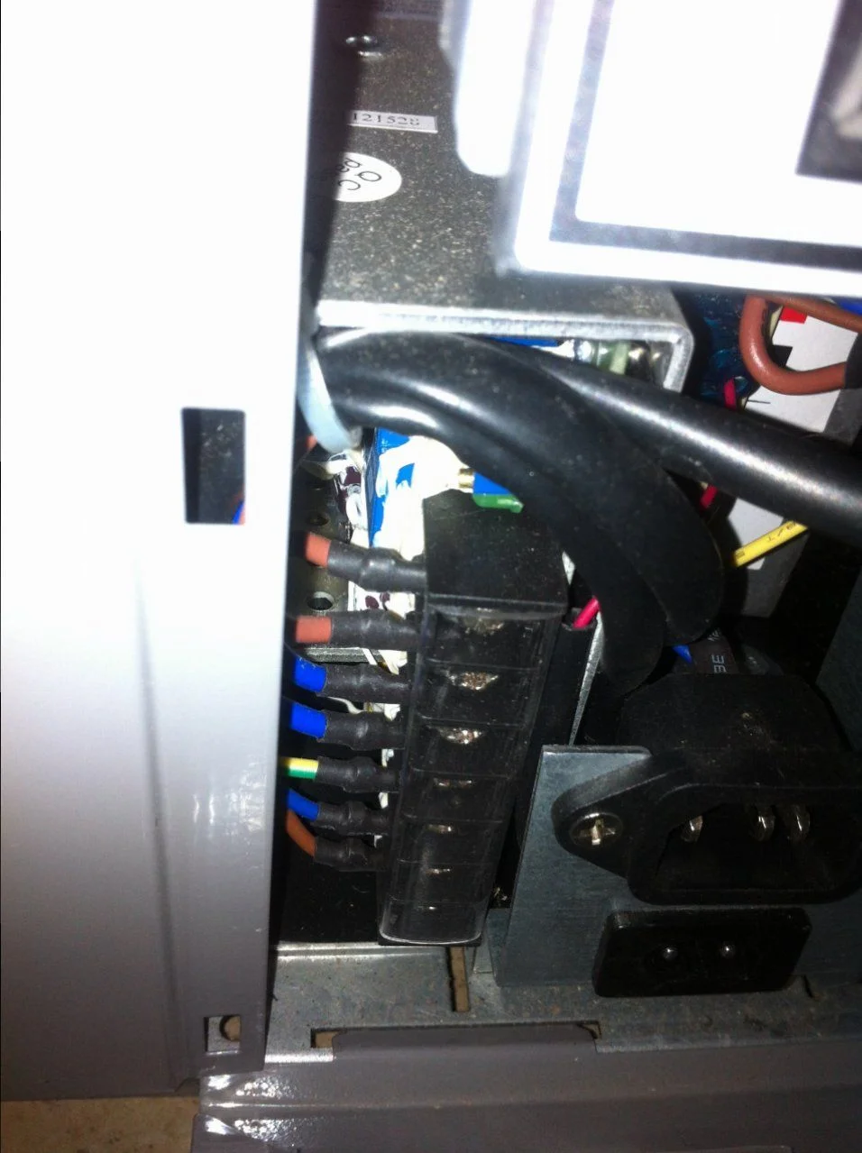

First fridge I received....

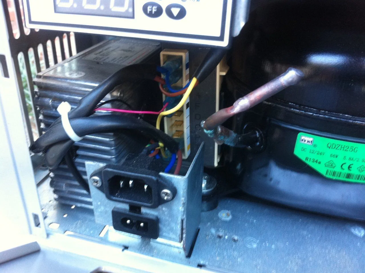

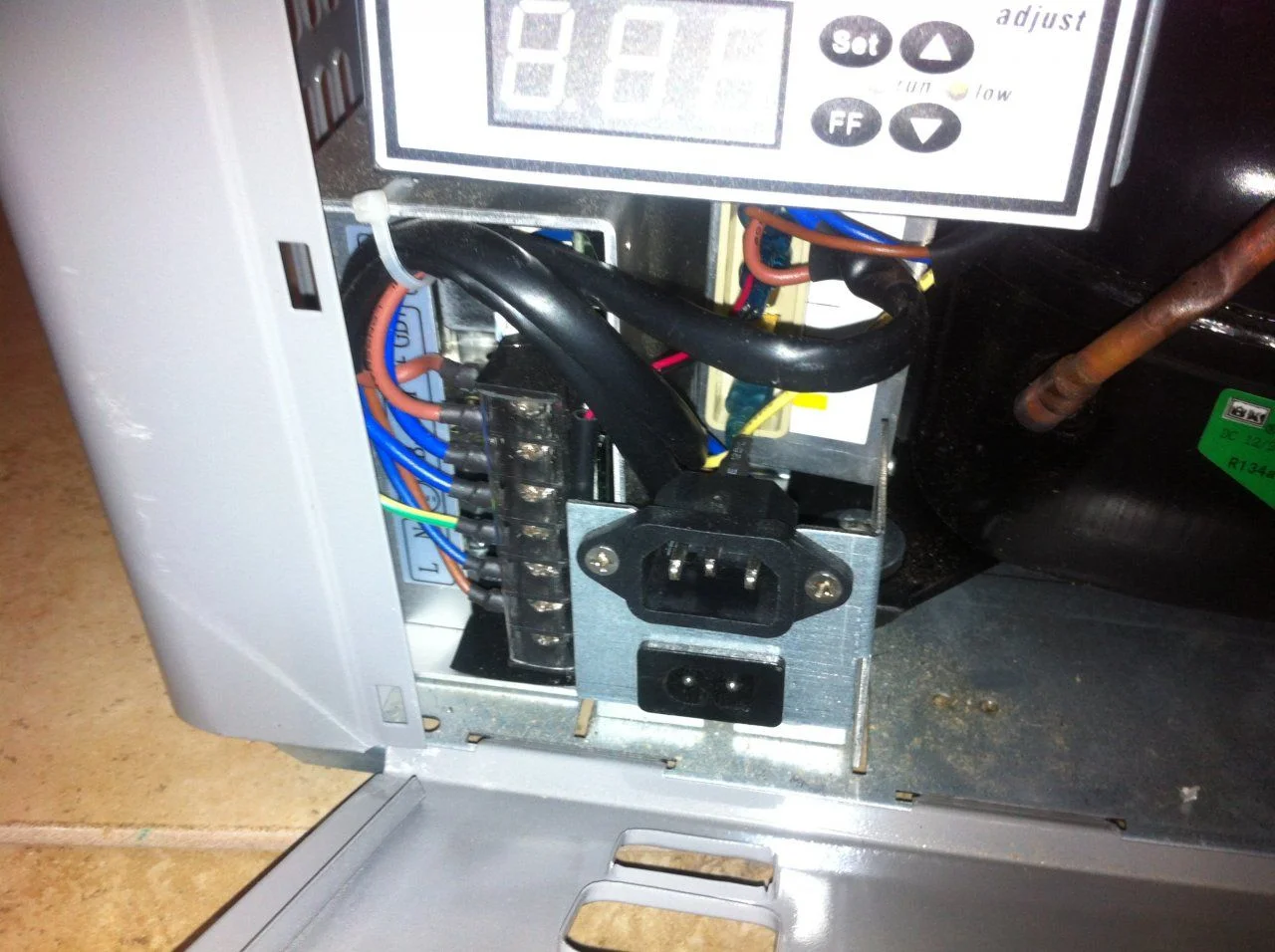

Second fridge I received has a different style power supply. There was some white goop on it, so I wonder if it was replaced after manufacture. The only other difference was the hinges were a white/gray color... And the seal on the door sticks to the fridge badly.
I've seen 3 edgestar fridges and the fitment of the outlets to the service panel door were not uniform, like the mounting is a little bent.
