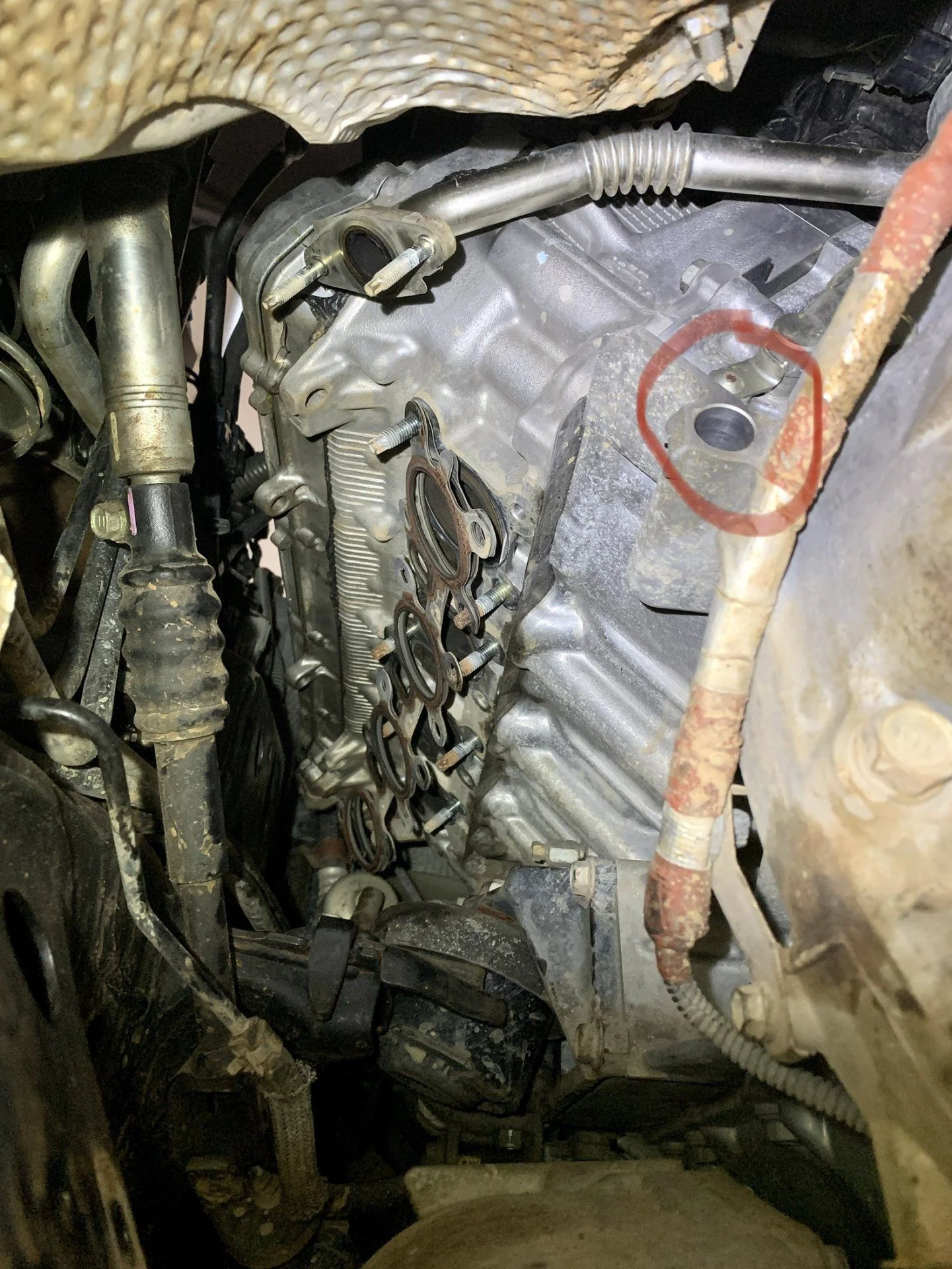

In case anyone was wondering. See that smooth hole by the wiring loom? That’s where you stick a block heater if you are feeling frisky.
Warning though. There is normally headers and a front prop shaft in the way, so it’s gonna suck.

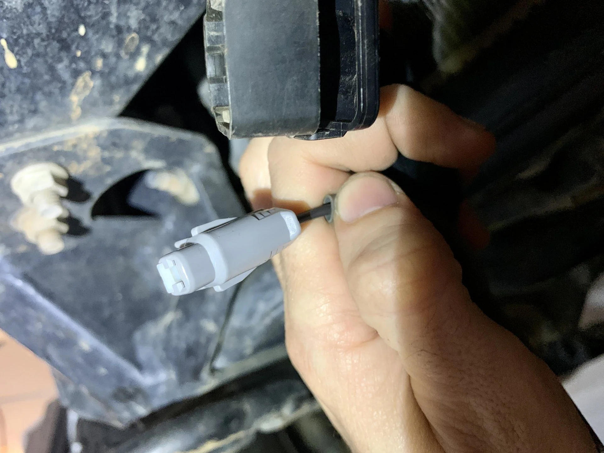

Also, the little clip that retains the starter electrical plug broke. As they always do. It’s the same part number since the 80 series. 90980-11400. If you plan to swap your starter, just have one of the clips on hand, it’s only $6 and plastic doesn’t like the heat of sitting between the block and the header.
Just use a tiny flat head to release the wire from the plug. Side note, see the black positive cable clamp? To get that out of the way when removing the cable in the first place is by releasing those tiny tabs, then push the lid back 90°. Then there is already another tab that will hold the lid out of the way for you to unscrew the nut. It’s the little things Toyota... thank you.
And plug the new plug in. Easy

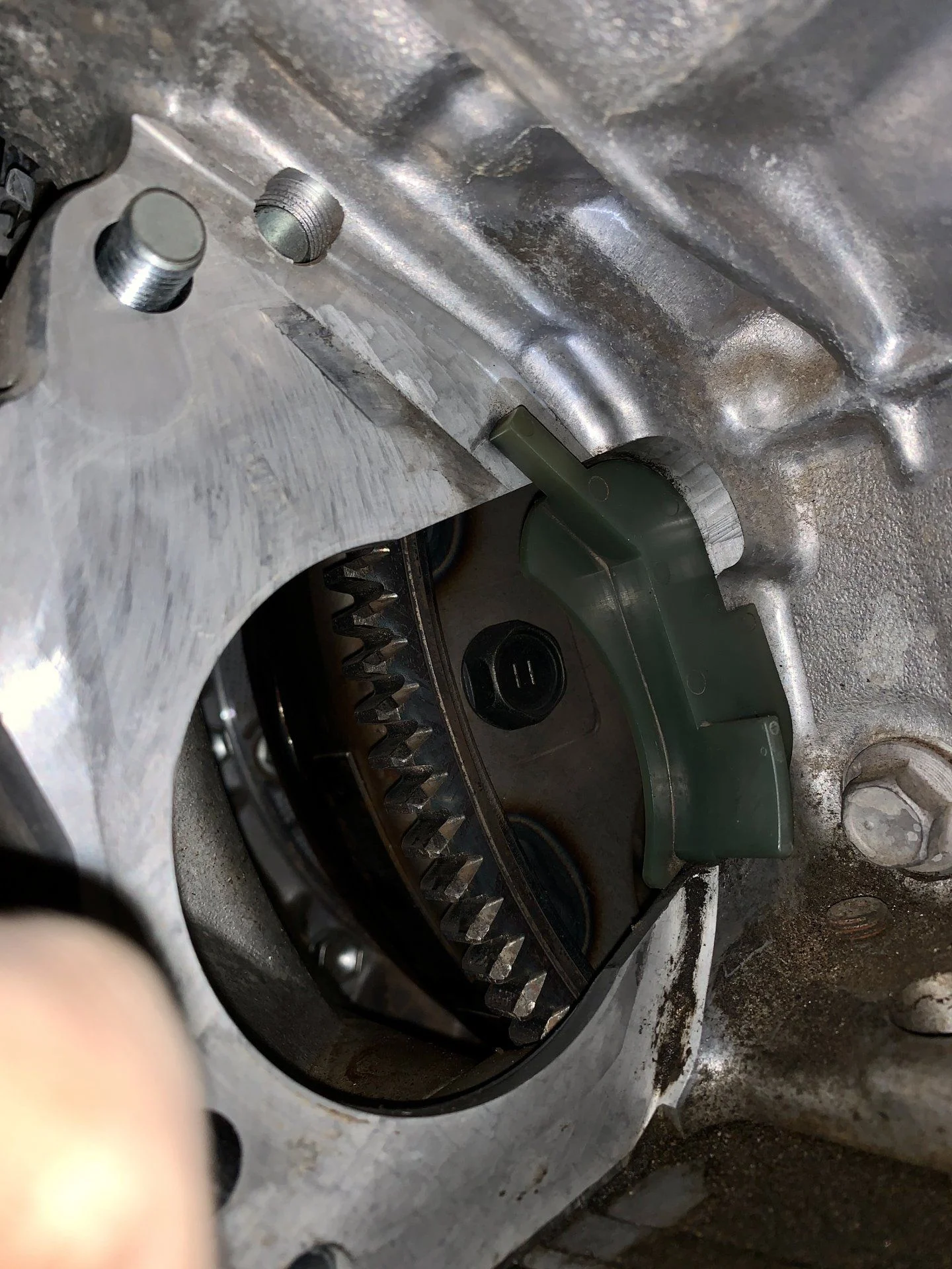

Along with a gratuitous picture of the flywheel.

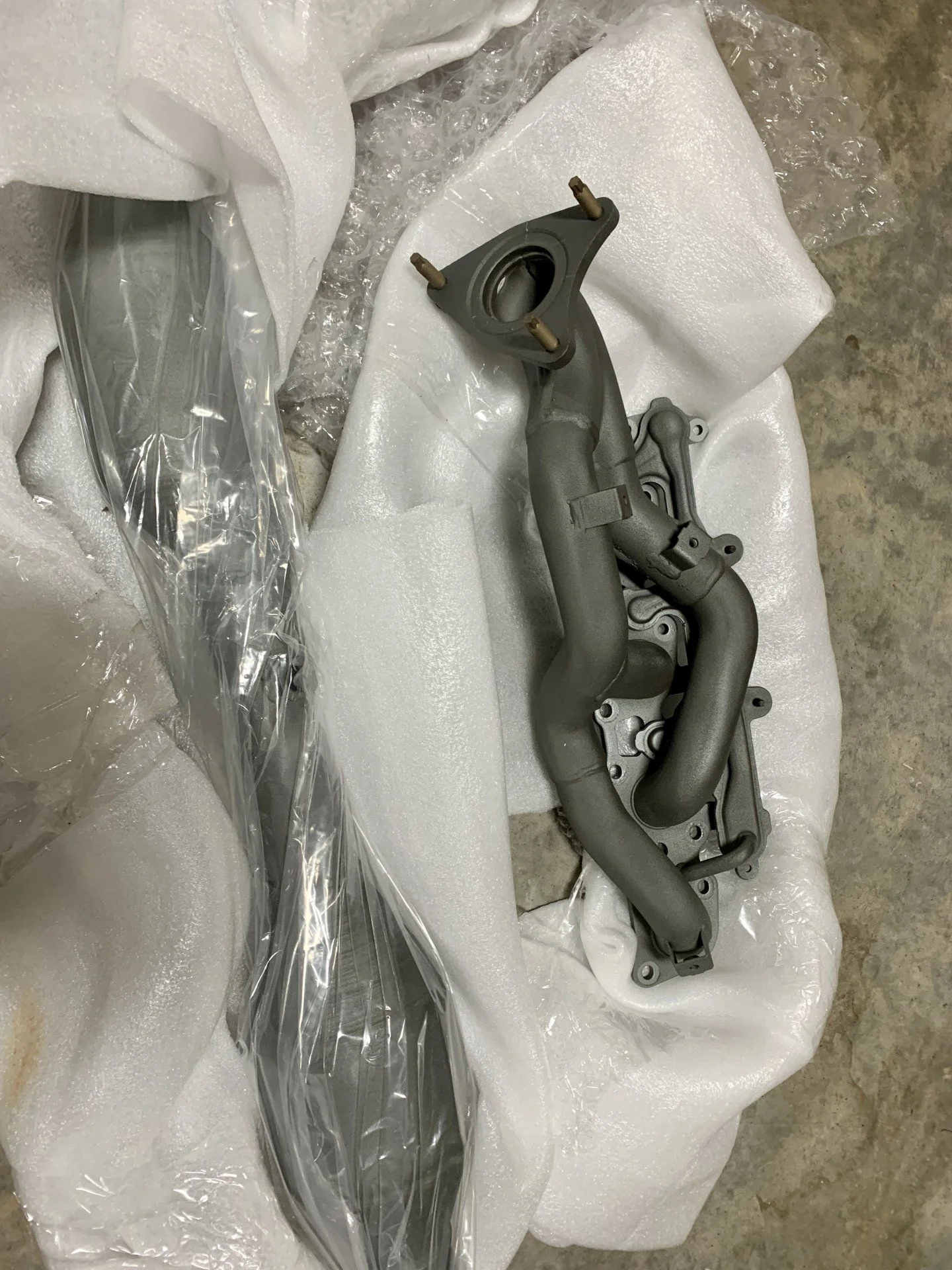

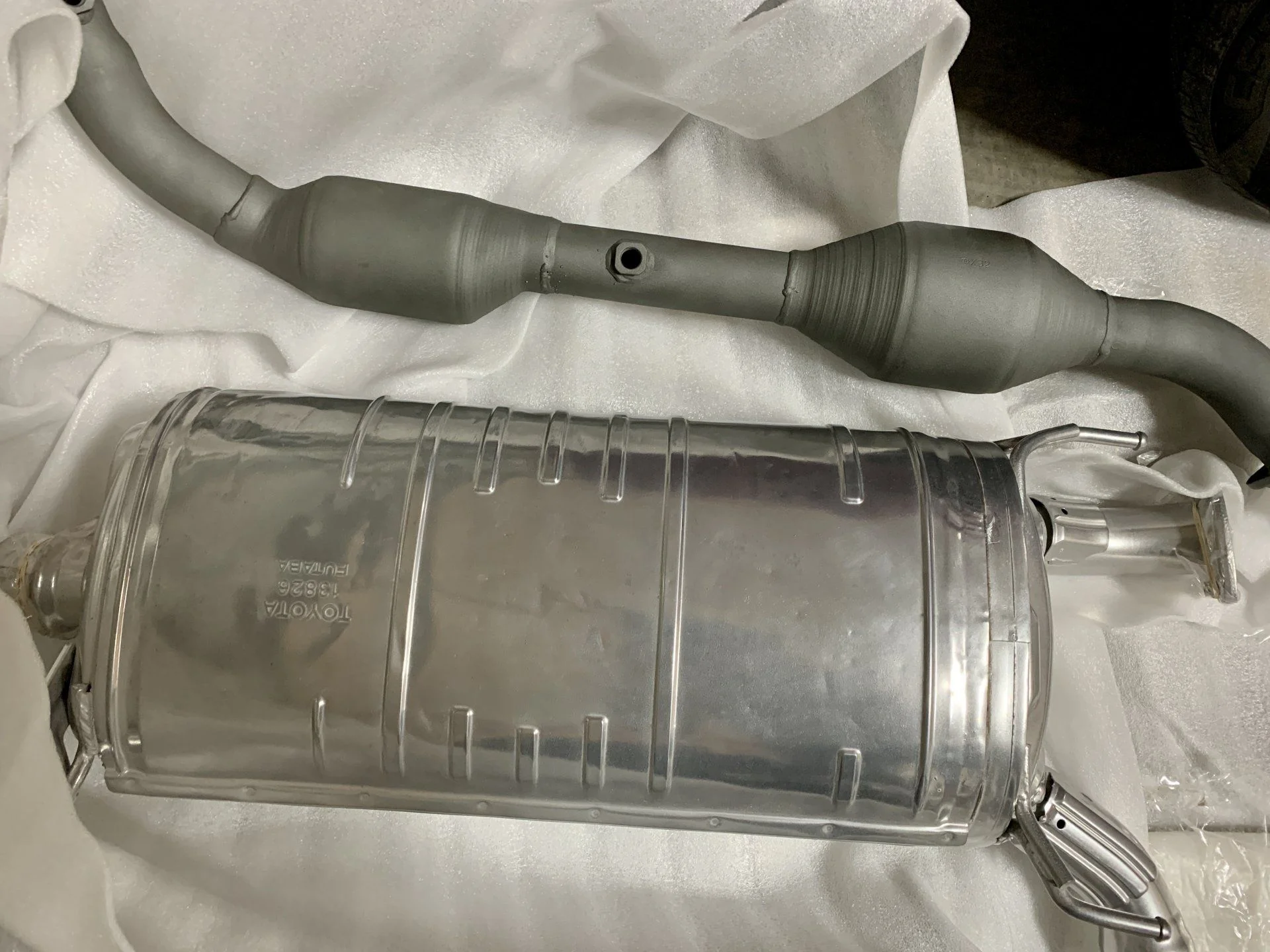

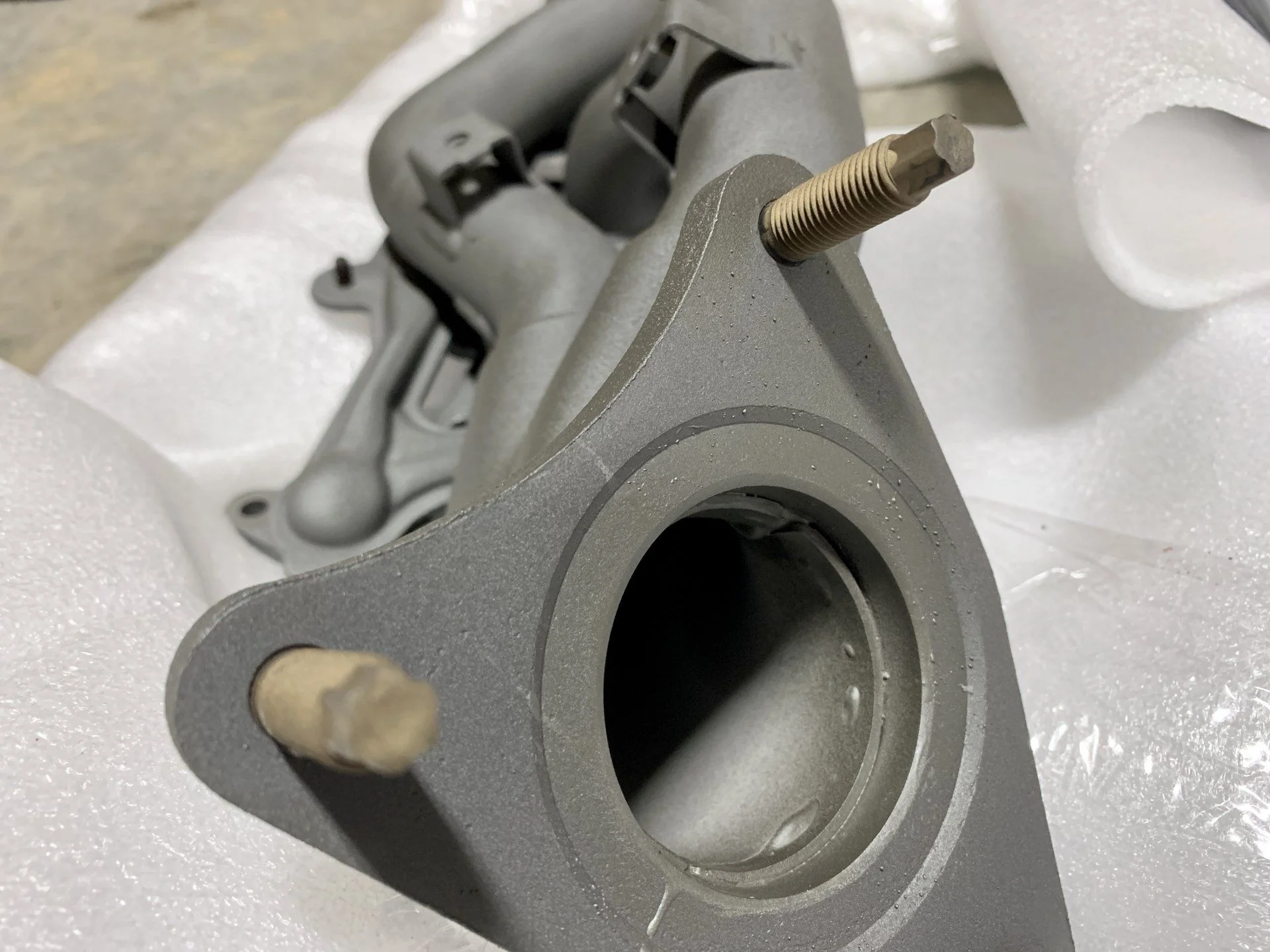

Couple things came together for this little project... I am building a high HP 200 for someone and knew that heat was going to be an issue. Plus, BudBuilt is creating a new product for the Tacoma and 4Runner world. So I had the opportunity to get a little bit of a reduced price on some stuff for myself because of volume at work heading to get some stuff done.
There is lots of talk about how to keep our 200s running long as possible. Well, rust, oil, and heat. There yeah go, help those items and your truck will last longer. For the heat part. I sent the exhaust off to Jet-Hot for coating. I put the headers and mid pipes in their 2500° and the muffler in their original finish which handles 1350° and holds heat in the best. I would of liked to done the whole exhaust in the 1350°, but the cats really push a bit past that temperate.
Since I had ton of data from when Bud tested heat under my 200 for the skid plates that are now super popular, I’ll be able to see if this even did anything for real. Jet hot says there is about a 55-65% reduction in direct heat on the outside of the pipe. The big take away from Bud’s testing is that you can’t beat thermal dynamics, heat rises, to radiant heat between factory, BB, and no skids at all was always so close it could not of be quantified. So... what if the heat never could be emitted in the first place, but go out the tail pipe. Well, not all of the heat, but more than half? Sounds good to me. @TeCKis300, you’re probable the one who will geek out with me the best on this one, so I wanted to give you heads up. TESTING TIME !!!
Here’s some marketing. I’ll see if it’s true or not, I have thermals too.
Those parts look better than new and will probably last a lifetime. Good stuff!
Yeah, this is probably the best way to get effective long term thermal protection as it coats the inside (I believe?), protecting the exhaust substrate itself. I see many use heat wraps on street cars, and that's a sure fire way to accelerated wear and corrosion as it increases peak temps on the parts themselves, but also traps moisture against the surface on cool down.
Curious if you know whether the 5.7L headers are prone to exhaust leaks over time like the older Yota 4.7L was? This might also be a way to protect from that long term.
