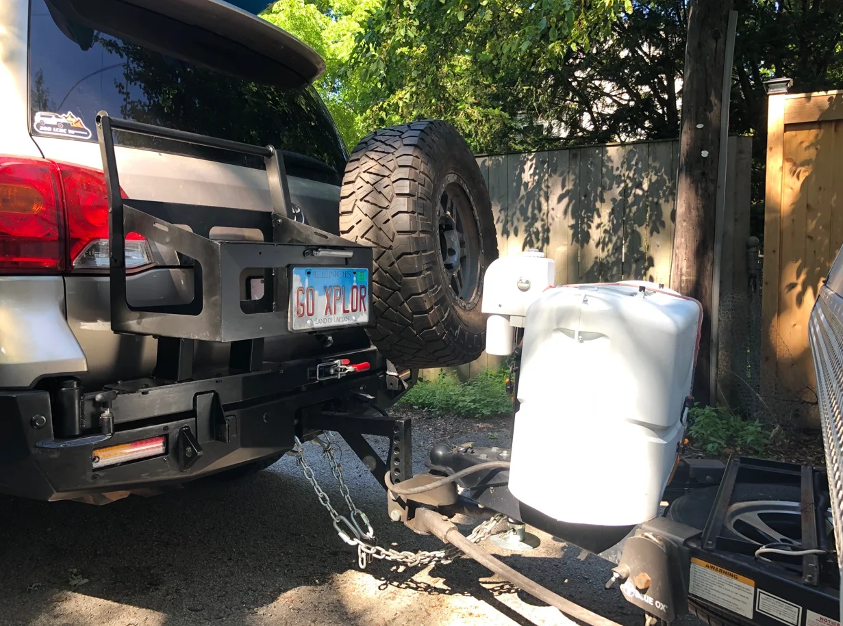

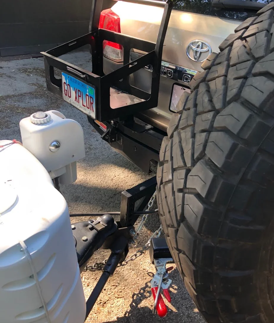

Yes I towed 6000# with it recently, Chicago to Colorado and back. It's heavy. My trailer tongue is about 900# but for reference unloaded my truck is 3540/3700# F/R but loaded I'm 3300/5420. Towed fine at 75mph. Biggest issue is making sure the trailer weight is balanced, but I've had to pay attention to that even before the bumper.
I did upgrade my rear springs as part of this project. Heavier springs is a necessity.

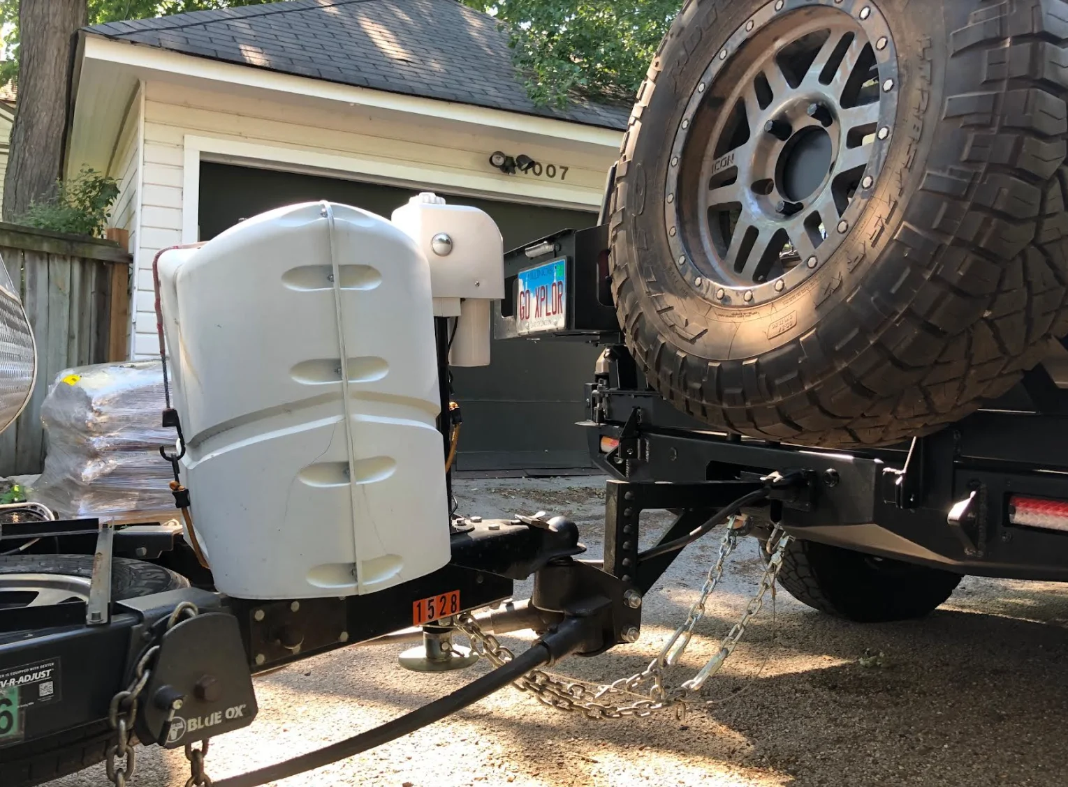

I needed a longer drop shank for my tow ball as the older one was too close. Even with this setup, on a hard right turn the tire will contact the propane cylinders and push them a bit, so I need to relocate them further back on the trailer frame by a couple inches. Also you may need to lengthen your trailer chains and extend the wiring if you use a longer shank.
Weight loaded for travel:
Camping north of Steamboat Springs. I tend to leave the swingarms open when at camp as I keep the cooler in the truck and we go in/out too often.
Setup with extended chains and longer hitch shank (Curt 17122, IIRC). I needed to extend my safety chains. With the 7-pin plug in the normal spot it would pull out on a left turn, but once I relocated it to near the center my trailer wiring plug fits fine and stays in without issue.
Reasonable clearance to open the swingarms, though in part that's because my arms were made to be equal length instead of the normal offset.

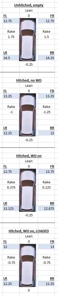

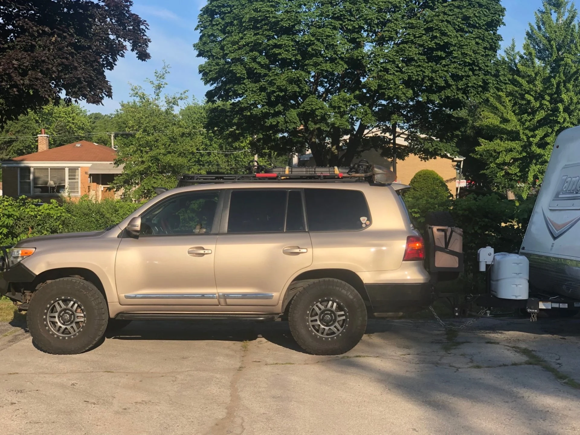

Not the best comparison photos but here's what it looks like with the trailer hitched up with one person in the truck, vs the rake I get when it's not. In this photo the truck is level or maybe 1/4" low in the rear. Add 3 kids and a dog and it will sit about 0.5 to 0.75" lower in the rear. However there's plenty of suspension travel available with this setup - it's definitely not sitting on the bump stops or anything.
If you plan to tow regularly, outside of a proper WD hitch setup and correct TW/weight distribution inside the trailer, the biggest thing you can do to help handling is to get a custom alignment. Have the shop set caster at the high end of the range at 3 to 3.5 degrees, and have them set camber to be neutral-to-slightly negative (around -0.1 to -0.2 degrees). Your caster will reduce a tiny bit when the front end lifts up due to the weight on the rear causing the front wheels to shift towards the driver's seat (plus more caster adds more highway stability in the steering wheel), and camber will increase as the weight lifts off the front and the bottom of the tires pull inward. Camber changes more than caster and your slightly negative camber will end up being somewhere around 0.1 to 0.5 degree positive when hitched.
I actually have some measurements I took along with the CAT scale weights for "unhitched, empty" (except 300# of front passengers plus a full tank of gas) and "hitched, WD on, LOADED" (TRUCK: 300# in the front row, 200# in the middle row, 200# in the rear row, full tank of gas, full rotopax on roof, 5 gallons of water. TRAILER: 900# TW approx including about 15 gallons of fresh water and 2 propane cylinders).

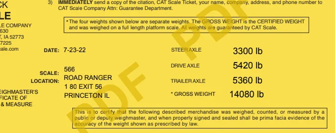

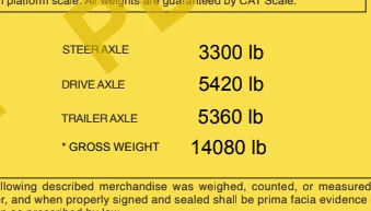

So the obvious question I have is when laden, your drive axle is heavy, What have you done to offset that? Do you have heavier springs or what else to compensate for that?
I have Ironman 220-880# medium duty springs in the rear. Ironman rates them at 286#/in however they are the same coil thickness, turns, etc as the OME 2723 which is 340#/in. I considered a GVM upgrade kit but I don't really want the stiffness of ~450#/in springs normally. I might put Timbren SES bumps on in the future, but I need to read more about the impact to axle travel when not towing...
My wheels are rated at 2750#. I run 45 psi in my rear tires which roughly maps the RCTIP to 2800# per tire of load. Fronts run 38psi which is the RCTIP equivalent for my tire size.
I have the 45mm ToughDog shocks, which I run at +5 stiffness now. That seems to handle side-to-side shaking better than the lower settings I used to use.
I regeared last year and run 4.88s now. That helps with towing though it generates more heat. I do front and rear diff, transfer case, and A/T fluid changes every 30k miles.
I typically run my RedArc set around 5-6 but will turn it up when going down mountain passes to ensure the trailer brakes a tad harder than the truck and thus stays nicely under control.
Aside from all of that... yes I'm way over GAWR in the rear. It probably means things like bearings will wear faster particularly in the rear. If I bent a rear diff housing or broke a shock/LCA mount or something I would look to swap mine with a 6600# rear diff housing at that point. That said fully armored (bulletproof) cruisers in the middle east can weigh 10k # or more, and while they do other upgrades (brakes, wheels) I don't think they're swapping out the diffs so overall I feel OK with my setup. I'm at 131k now (bought the truck with 50k miles) and while I've slowly added weight over time I've always been over when towing.

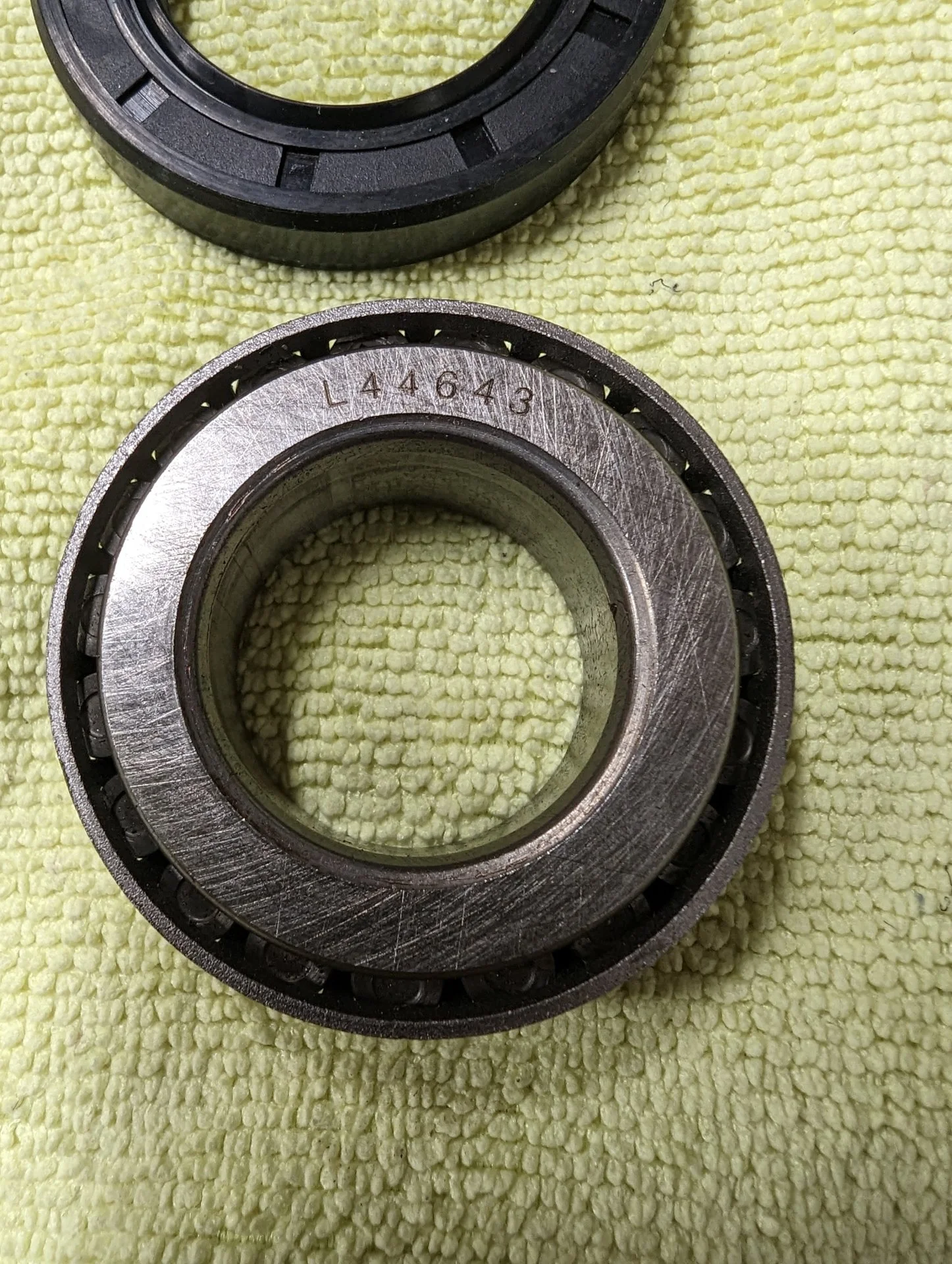

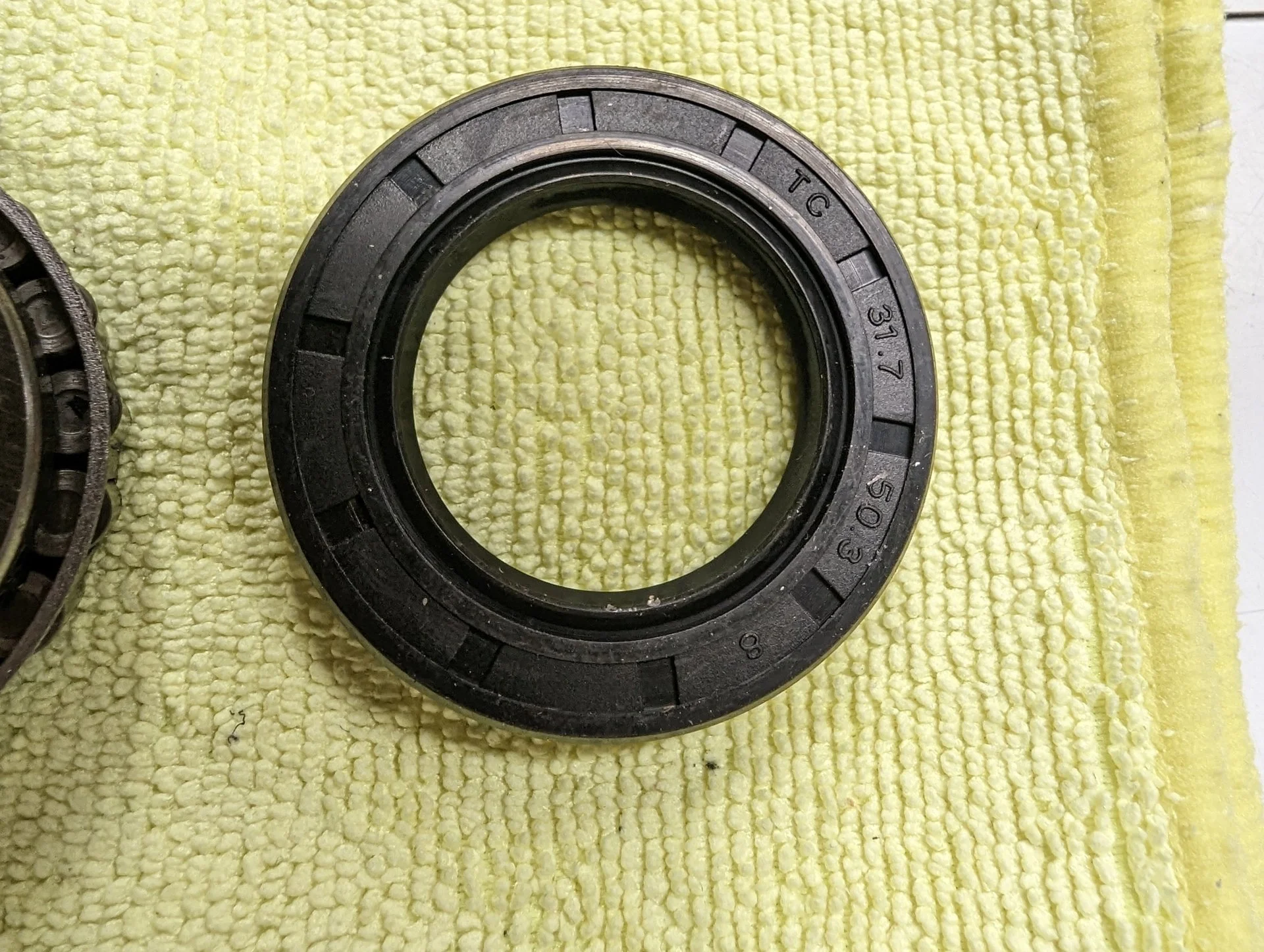

Does anyone have a part number for the bearings that come with the kit by chance? I left mine outside prior to finding time to do the install and the corrosion is too much to read the part numbers. James did not know since he just buys a tire carrier kit thought another retailer.

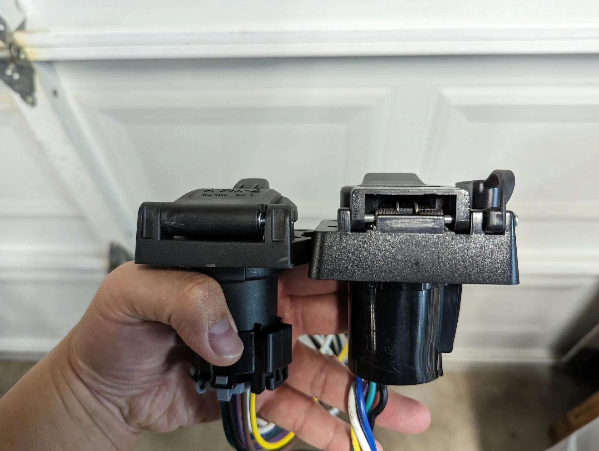

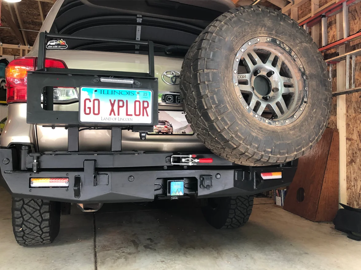

This is the trailer plug I added, just to the right of the receiver hitch opening
I used this plug for the bumper and just made a 2" hole, then drilled the 4 bolt holes separately. I went with this model because it's much less deep than a standard plug, so I had no issues fitting it or worrying about the back of the 7-pin plug hitting the frame hitch cross-member.
Amazon product ASIN B075ZZJSW6
Downside is that the above uses a USCAR plug, so I had to buy one of those, along with a normal 7-pin socket for the other end so I can plug it into the OEM harness. But the total depth inside the bumper is maybe 3"
Amazon product ASIN B00MV0FG9W
https://www.amazon.com/dp/B001EOWPOA?tag=ihco-20
I may hard-wire the socket in the future but for now I like this as it allows me to unplug that socket and use the OEM one if I have an issue with the plug. I ended up moving the factory harness way up underneath so no risk of knocking it off now.
Pure genius! I've checked measurements numerous times behind my bumper and nowhere has even close to enough space to fit the factory plug. I just ended up tucking mine way up higher but i have to lay on the ground to plug/unplug. I actually like your solution even better than the hard wired option. Cool that if the Amazon plugs give any trouble can just switch back. Love it!

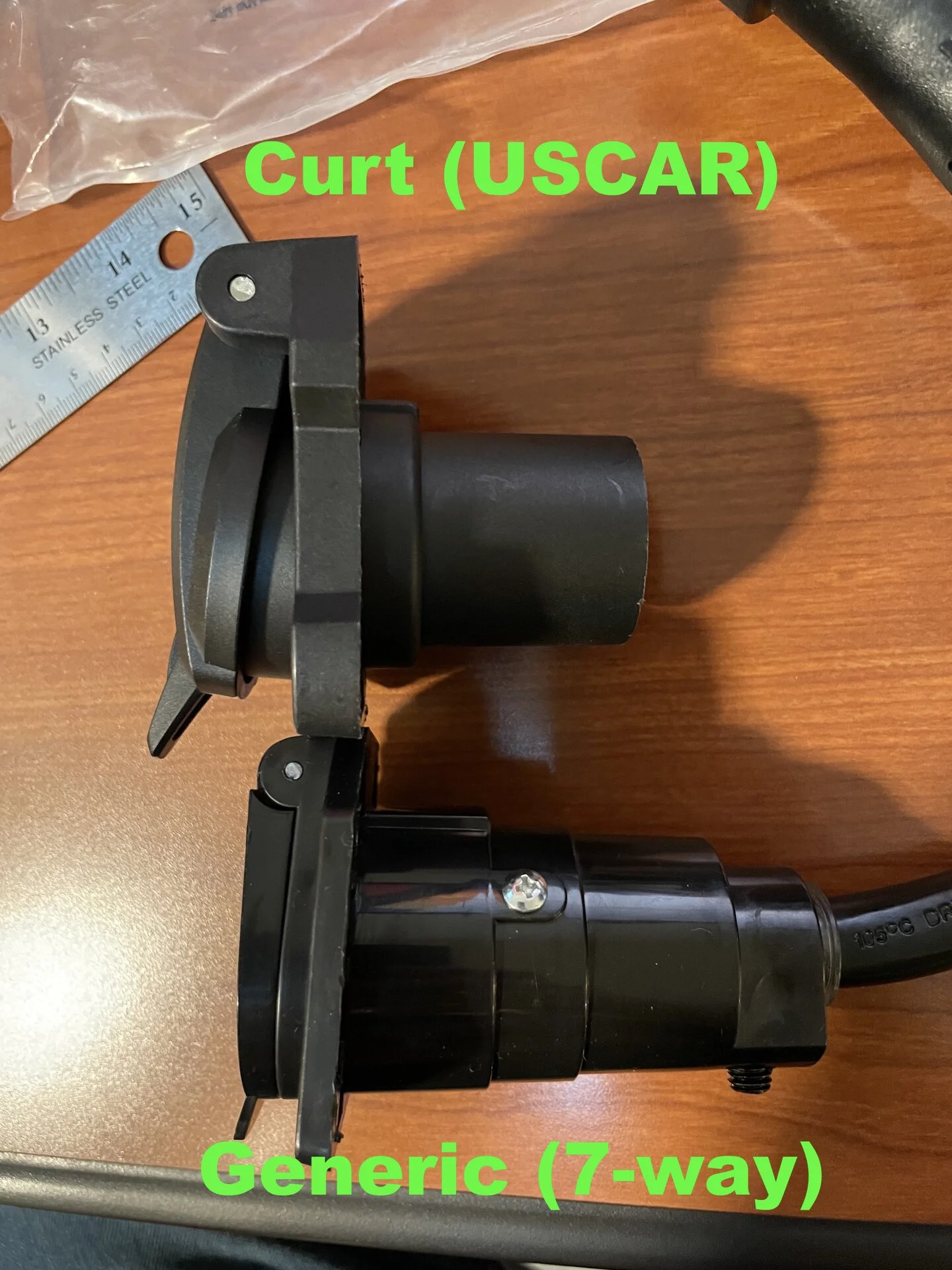

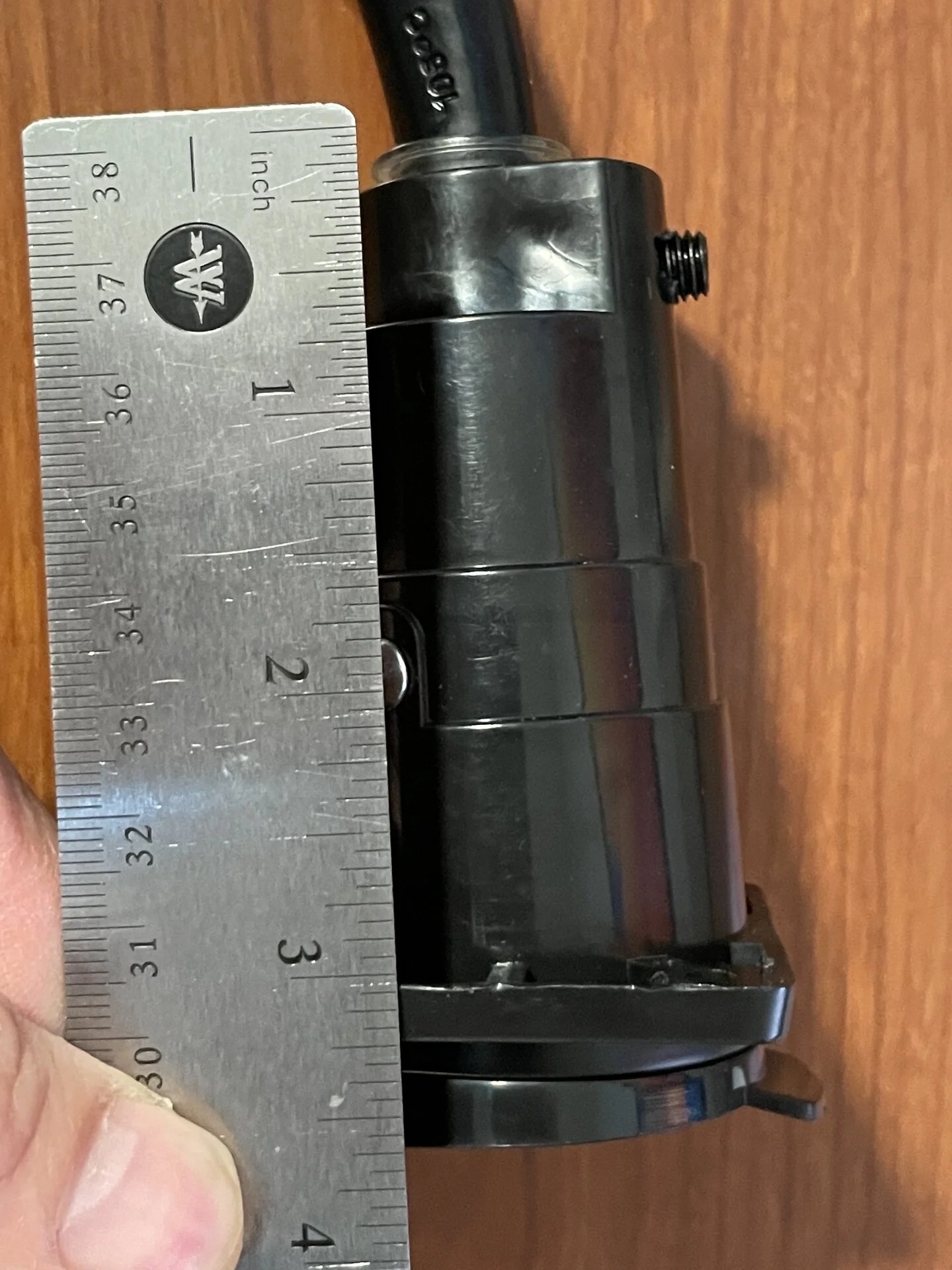

View attachment 3199526View attachment 3199527View attachment 3199528
I have the Curt setup handy. I'm not sure if I'll use it and might just stick with the Hopkins one I have. My LX didn't come with the OEM trailer plug, so the Hopkins plugs into the OEM plugs on the driver side.
The Curt extends about 2.5" from the surface mount until the where the wires come out.

I ordered both figured I could then compare in person see if the Curt route saves me that 1/2-1" that may make the difference. Spacing looks tight no matter where I measure on mine at least. I'm trying to see if i go up high enough if the cord can clear the part of the hitch receiver that sticks out. I can't do the exact spot as yours as your swing arm latch is on the arms where as mine latches to the face of the bumper. Also a bit jealous your T-pins are on the outside on your bumper, was that James that made that way or something you did on your own?

Just so we're on the same page, I ordered the Curt 55416 7-pin receiver which I installed in the bumper. That has a USCAR plug on the back side. The Curt 56229 USCAR harness plugs into that, and then you have to wire up the Curt 58140 7-pin plug to that. If I understand the question correctly you're asking about the last step... The USCAR wiring harness comes with a diagram which maps pins to wire colors. You'll have to google for the 7-pin wiring diagram for the normal connector. Be aware that the USCAR wire colors do NOT necessarily match the normal 7-pin wire colors.
