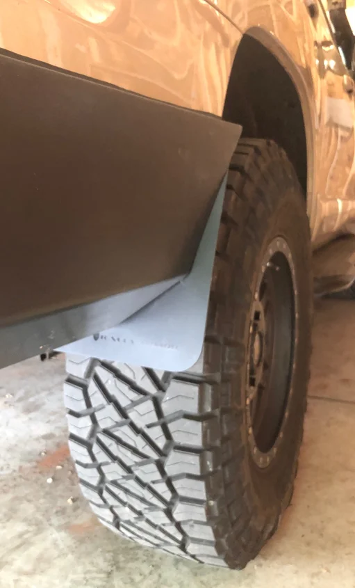

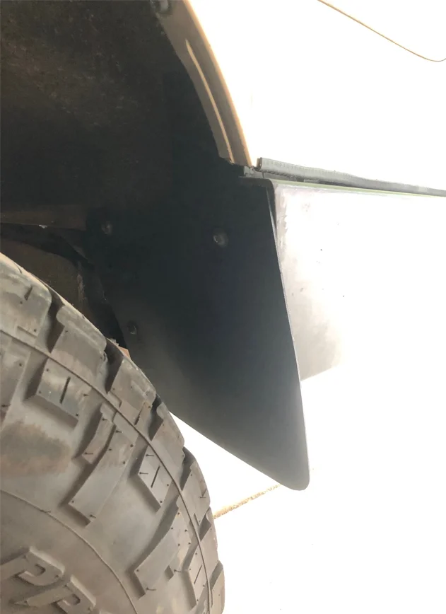

Have any pics of your mudflap setup? Or just using the piece that RLC provides?
Here are some pics of the Rally Armor flaps.

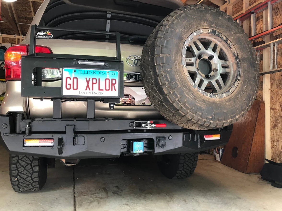

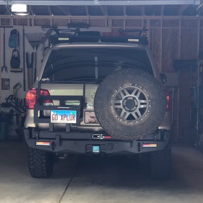

Final photo. In the garage and complete... more or less.
I still need to track down the source of my groan/creak when the vehicle comes to a stop. Swing arms are tight and it does not sound like something clunking. I could try to get an iphone video but those never turn out IMO. I deflated the airbags so we'll see if that matters as I can hear them squeak a bit when I bounce on the bumper... but I don't think that's the sound I hear inside. I can also see that the passenger's side bumper may just *barely* touch whatever the black plastic thing is behind the bumper underneath the gas tank filler. On the driver's side I'm pretty sure it's fresh air for the A/C but I'm not sure what it is on the passenger's side. TBH any contact is likely my "fault" as I spaced the bumper down about 3/4" or maybe 1" at the rear wings as that looked more level to me... but perhaps slight body movement is the culprit there (though I'm surprised I don't hear anything when turning)
It's minor but one thing that annoys me is that I can see into the area behind the swing arm spindles. I bought a piece of 12x12 aluminum and I'm going to cut and bend that into 3-sides of a box (well a "bottom" and 2 sides) and paint black and then drill 2 small holes and mount those to the bumper behind the spindle. If I had a black or dark gray vehicle you probably couldn't even notice it.

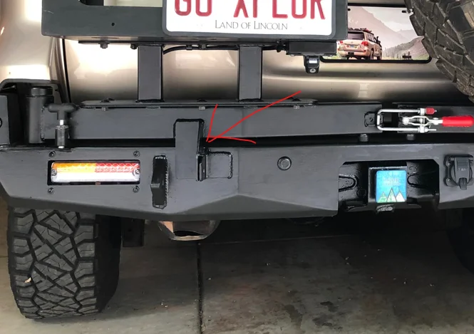

Other random small upgrades I did...
I used some UHMW tape on the semi-circle wings where the t-handles for the swingouts lock in place, so that the T-handles don't drag across the paint. It seems to help them swing more smoothly as well. I might get some black UHMW in the future, instead of the opaque stuff which shows a bit. I also used a bit of it where the stops for the arms contact the bumper, to try and protect the paint from abuse
I added a couple 5/8" tall rubber feet to the swingout arms, just under the latch. 3/4" would've been perfect but I couldn't find the right height so I ended up just adding a washer as a spacer. I thought this would help reduce any flex the arms might encounter when they are locked together. For $5 I figured it wouldn't hurt
I also ended up replacing most of the 3/8" bolts with some 3/8" hex head ("socket button") black stainless steel bolts, along with the washers and nuts. 3/4" length was sufficient everywhere that James supplied 3/8" bolts, except the 4 bumper-to-wing bolts where 3/4" would've been sufficient but I needed ones that were a bit longer because I used some spacers. This wasn't strictly required but I preferred the "all black" look as opposed to the zinc-coated bolts.

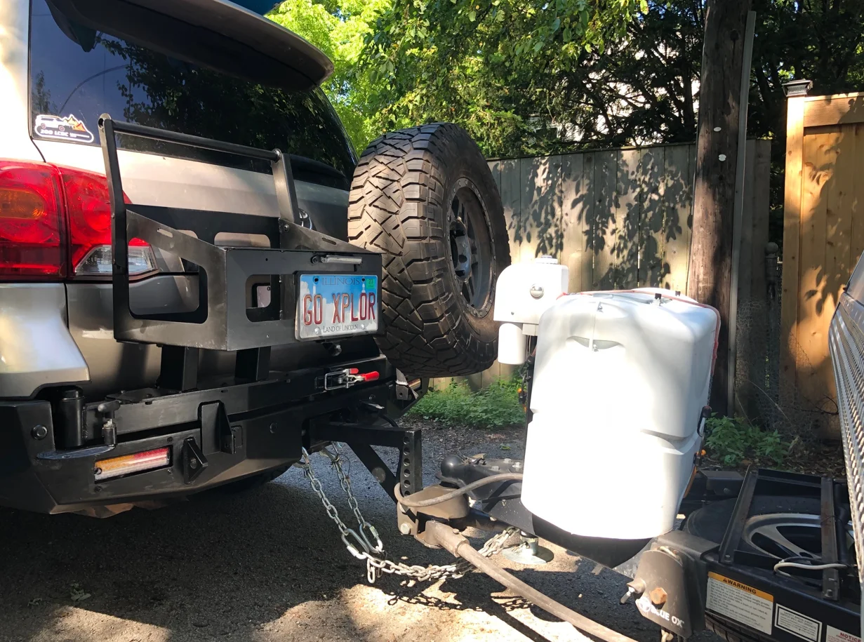

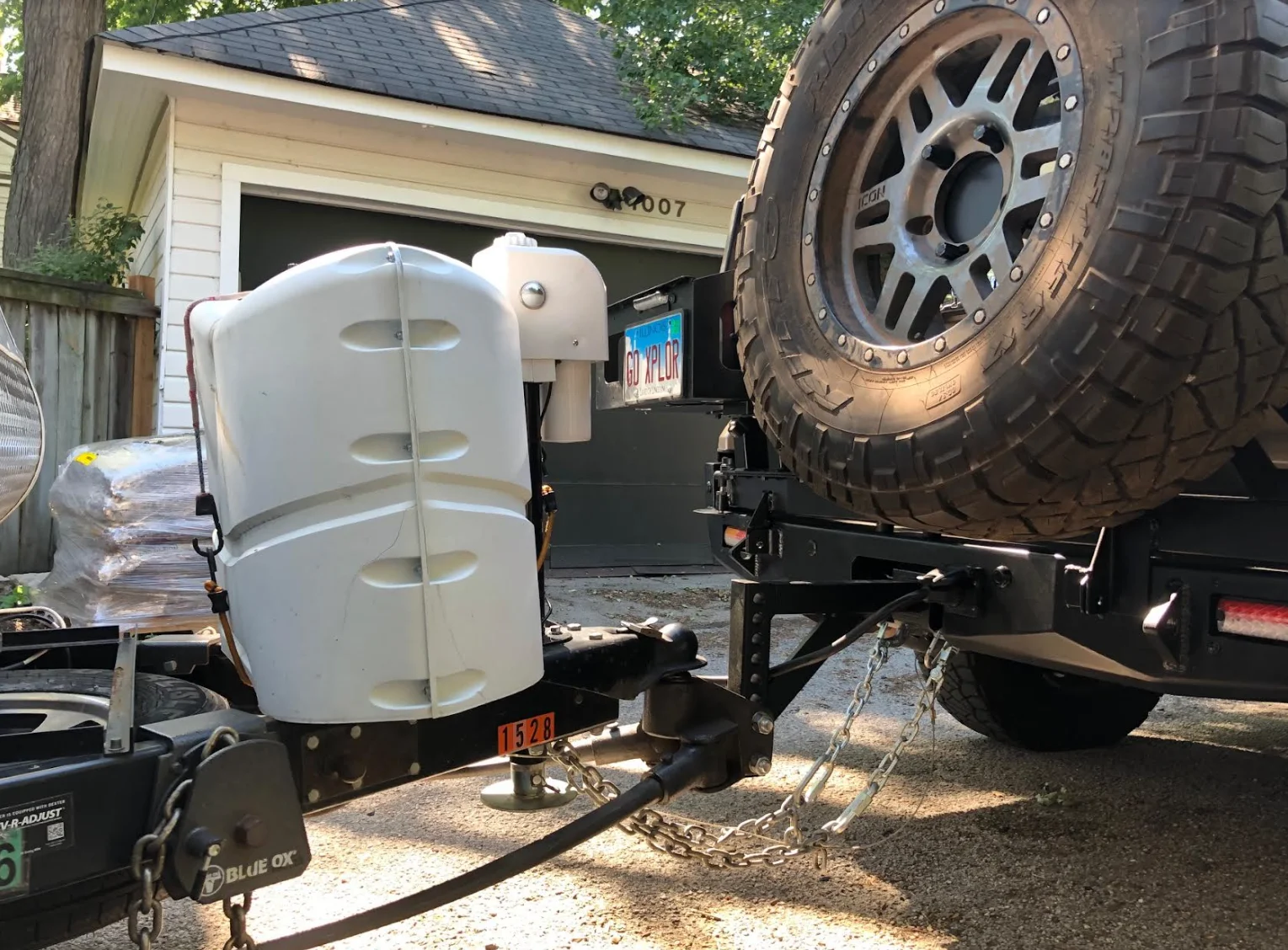

Yes I towed 6000# with it recently, Chicago to Colorado and back. It's heavy. My trailer tongue is about 900# but for reference unloaded my truck is 3540/3700# F/R but loaded I'm 3300/5420. Towed fine at 75mph. Biggest issue is making sure the trailer weight is balanced, but I've had to pay attention to that even before the bumper.
I did upgrade my rear springs as part of this project. Heavier springs is a necessity.
I needed a longer drop shank for my tow ball as the older one was too close. Even with this setup, on a hard right turn the tire will contact the propane cylinders and push them a bit, so I need to relocate them further back on the trailer frame by a couple inches. Also you may need to lengthen your trailer chains and extend the wiring if you use a longer shank.
Weight loaded for travel:
Camping north of Steamboat Springs. I tend to leave the swingarms open when at camp as I keep the cooler in the truck and we go in/out too often.
Setup with extended chains and longer hitch shank (Curt 17122, IIRC). I needed to extend my safety chains. With the 7-pin plug in the normal spot it would pull out on a left turn, but once I relocated it to near the center my trailer wiring plug fits fine and stays in without issue.
Reasonable clearance to open the swingarms, though in part that's because my arms were made to be equal length instead of the normal offset.
