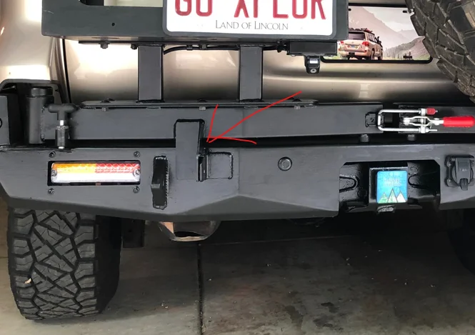

Anyone have a recommendation for a highly durable (and ideally self-sticky) "pad" to put between the "stop" for the arms and the bumper base? I had stuck some UHMW tape in between but vibration from the arms seemed to rub off the top coat of the paint. I tried some (very) sticky foam which compressed but that seems to have mostly rubbed away and taken some of the paint with it. I'll sand and repaint but before doing so I'd like to find a durable solution for this.
(BTW I put rubber feet on the bottom of the arms by the latch to reduce flex, though even there I found the paint slowly wearing away due to the constant rubbing of the rubber. The tire and jerry carrier (when full of water) still vibrate over bumps in the road. I put some UHMW tape in that spot but I assume that will wear pretty quickly. I could try some thicker UHMW I have but being plastic I assume it'll eventually wear regardless)
I'm still just using a couple pieces of thin, durable plastic which I essentially just glued to the bumper. It's only ben a few months but so far they're holding up. I don't love the look, but since I painted my bumper with POR15 it's easy enough to remove, sand, and repaint those 2x2 spots once winter is over if anyone has a better recommendation.

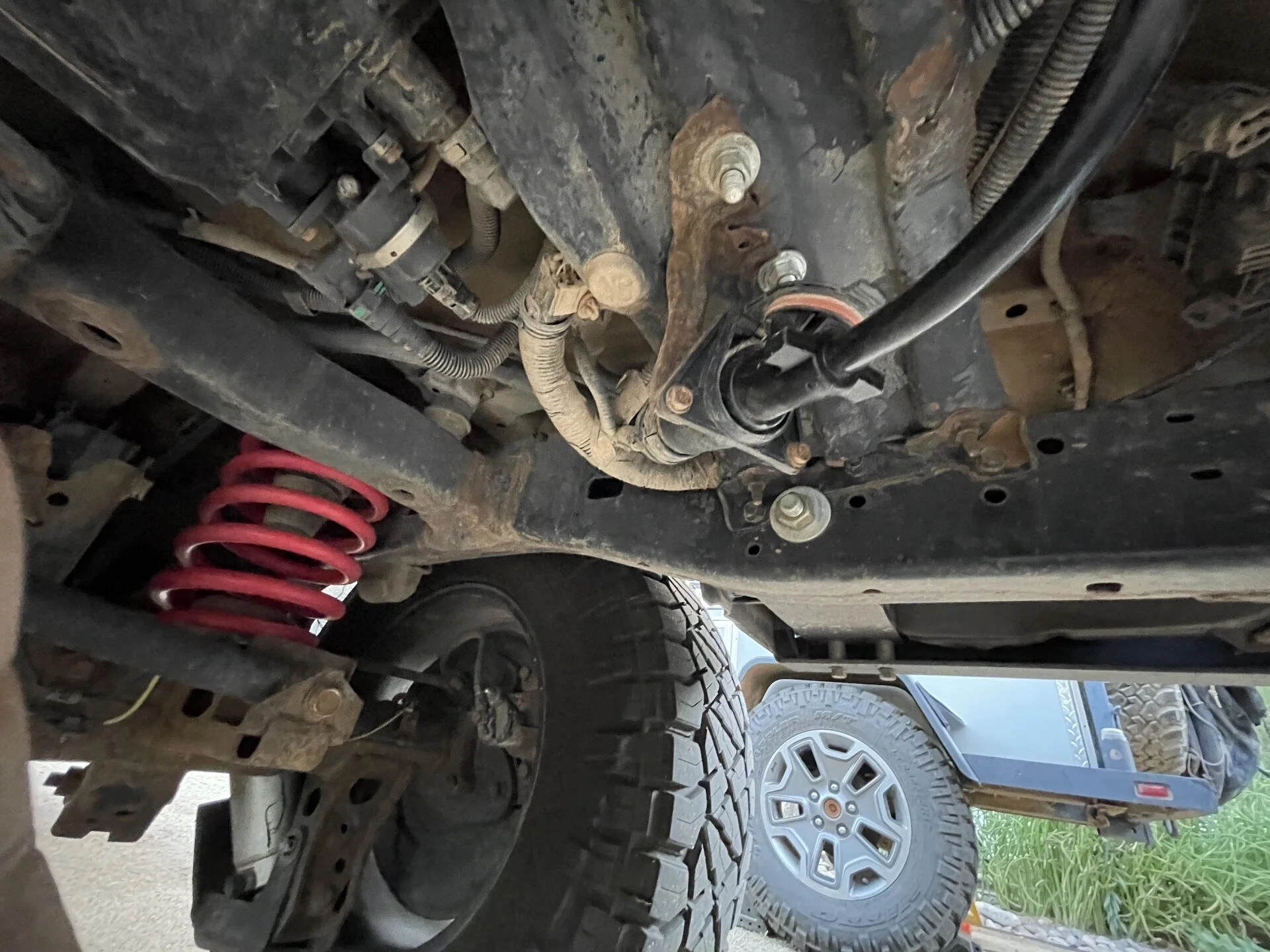

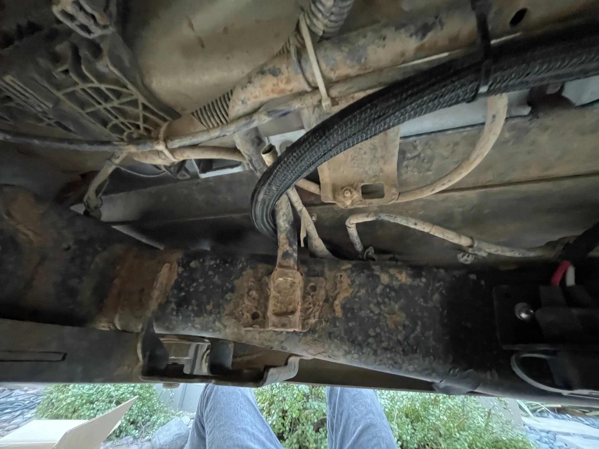

Hello Bumper Battallion. Does anyone have the specs on the bolts that fastern the main RLC brackets to the underside of the frame? I'm cleaing up a poorly installed PO job in which those forward extensions were cut off, and all four bolts on the underside of the frame are missing. (pictured slightly out of focus, top, center of this image). Thank you.

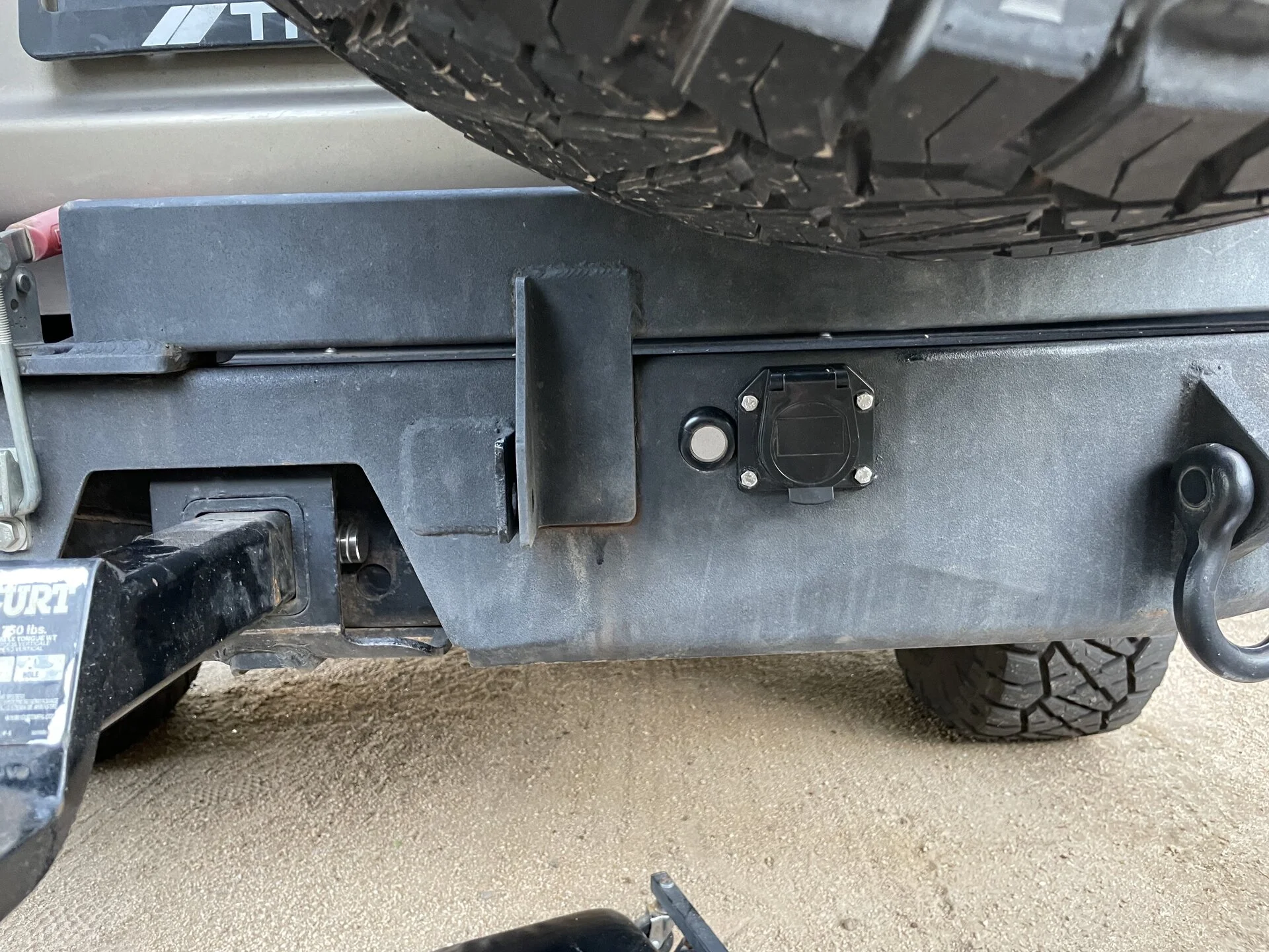

I ended up finding an alternative to the Curt 7-way hitch plug that I'm happy with so far. Last weekend I cut the hole (2") in the bumper and installed the Curt 7-way plug 1st. I went very high up on the bumper to make sure the wires coming out the back could go over the hitch reciever without a sharp bend. My 1st attempt was every so slightly crooked, and it looked a little more bulky/noticeable than I liked. I didn't do the wiring yet, just the connector in the bumper. I then saw my buddy's new Dissent bumpers he just got installed and his came with a more minimal connector which I like better. The hole I had cut was up so high I decided to try this alternative connector I'd bought on amazon. It is just regular 7-way extension both ends, so no wiring or cable sleeve or anything else needed for the install. Only things I had to buy was the 2" hole bit, and just 4 stainless bolts/nuts/flat and split washers. It worked great. Cleared the hitch receiver no problem and had more than enough length to attach to my existing truck 7-way which i had bolted higher up and back previously.

If anybody is wondering why I crammed it right next to the parking sensor, I wanted to preserve that flat area to the right to eventually install my WitsEnd Anderson/air chuck bracket, and thats the only spot that'll fit. Currently I have it attached to the inside of the hitch receiver. It's tucked up and out of the way, but the part I don't like is if I'm towing my power cable would still go out from under the bumper risking a cable pinch (as me how i know)
They are the factory bolts, so check the partsouq diagrams and I bet there's a part #.
