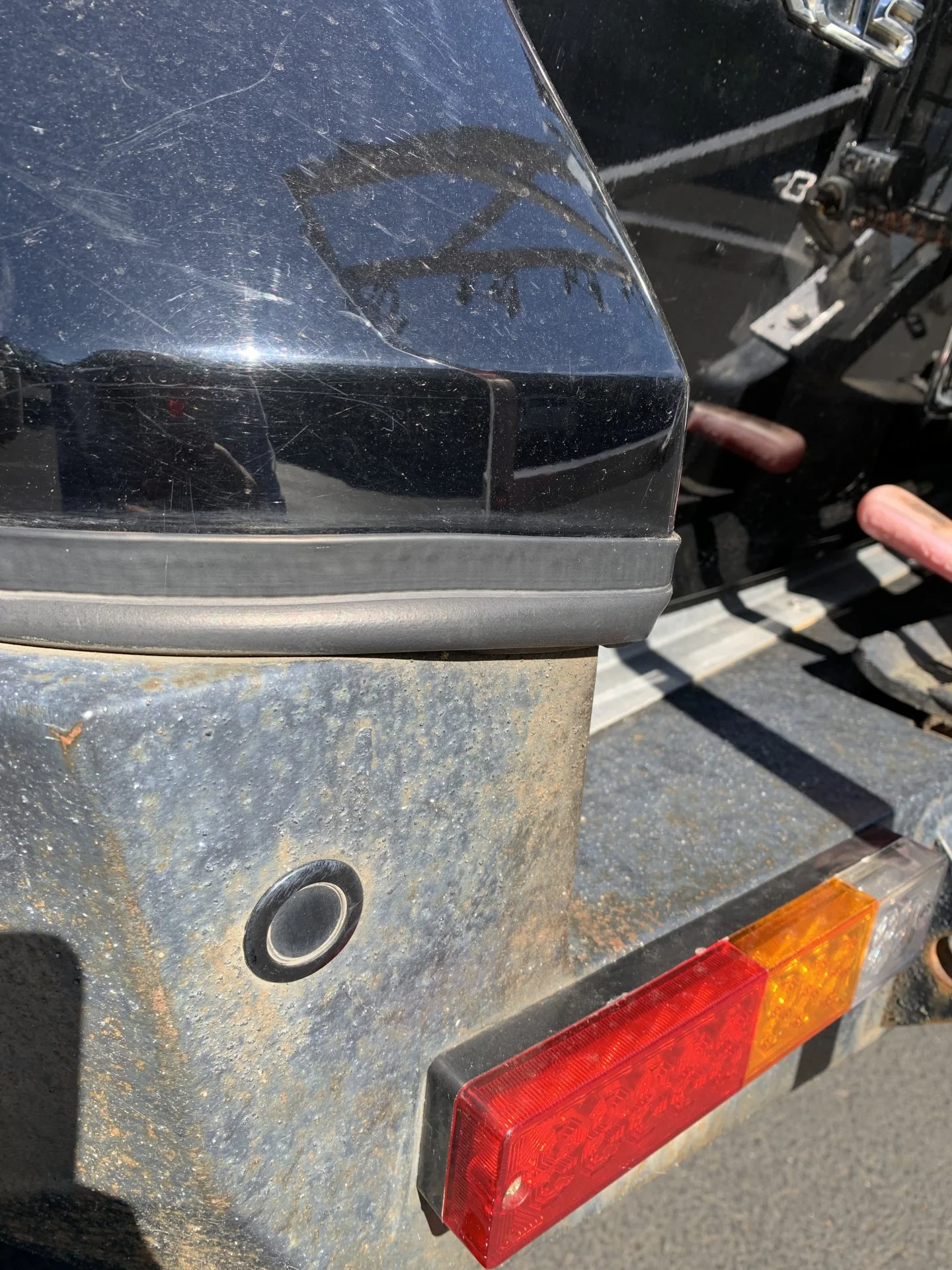

I did this for the AHC pump.
Here’s what I mean @kwelhand .
If the bumper back was 1” longer, it would go past this bumper cover wing. It would also allow more clearance between the swing and hatch for a table. And the rotopax mount James made me would have enough space for a rotopax.
the mod would be to make the wings 1” longer and push the spindle back 1” as well.
I have a gen 1 lx, so it might look different on others.
Drawback would be the hitch would be recessed 1”, and the swingarm/tire weight would be 1” further back.

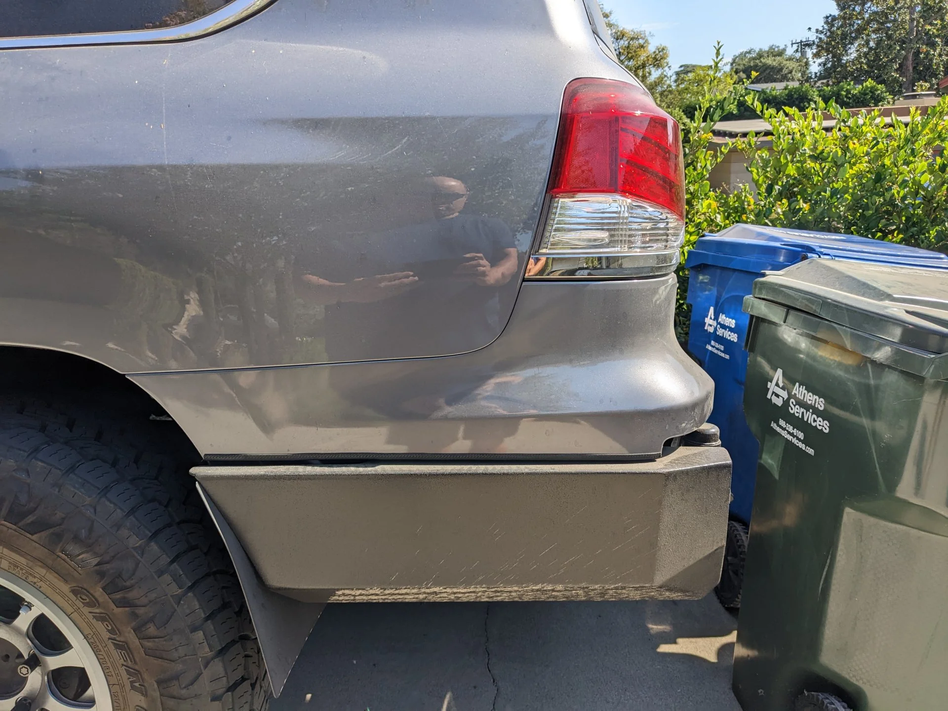

Mine is 1” longer. Or maybe I mounted it slightly differently or it’s an LC difference. (Not sure if it’s visible in the photo) but mine sticks further past that reflector area than yours.
Note I spaced my wing down about 1” at the wheel well. I think 1.5” would be the “correct” angle to match the crease in the plastic bumper but any further will hit the black plastic roof vent which sits behind that part of the bumper.

Could be. My tailgate still contacted the bumper like yours did but that might be because I pushed it as high as the rear would go when I mounted it

Where the heck did you find the worlds largest edge trim? That looks like 1-2" black trim. I cut my plastic when my bumper was mounted crooked, so once i corrected the bumper fit my plastic line is no longer parallel to the bumper anymore. Drives me nuts, but not worth the $$ for new plastic and the having to paint, just to toss out 80% of the plastic. My only solution I could think of would be to cut my plastic in a straight line, but this would leave a big gap between the plastic and the bumper. I've looked hi and low for years now for large edge trim like yours. Most I ever found was like 1/2". Where did you source your trim, that may be the solution to all my problems in life ;)
I’ll go look for Amazon link
