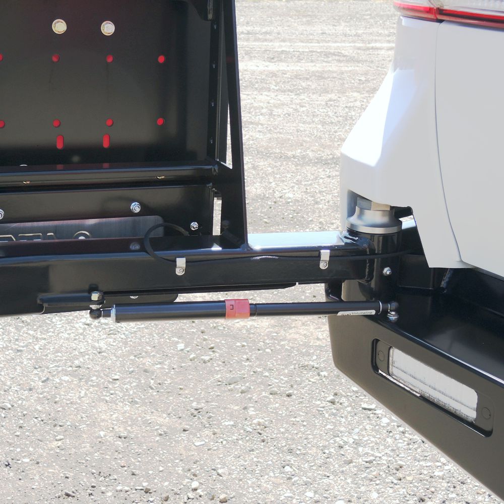

Yep same boat here. I've already broken 2 of the T-pins over the years. 1 is just missing at this point so my tire side arm doesn't lock open at all. I'd love a clean simple strut setup I could retrofit mine with
Thank you all for the recommendations - James is going to cut out the 7 way for me.
On the gas struts here was his update:
"We were going to try for gas struts but it looks like my swingouts are too close to the top of the bumper to make them work. We did make the t handles work a bit better though"
I think there's a creative option likely available, but it's too damn cold right now for me to mock something up in the garage. I might try order a few inexpensive gas strut options from amazon in the spring and see if I can make something work
Something like this attached to the top of the bumper and the inside part of the swingarm might work so long as there's clearance between the swingout arm and the lower tailgate when everything is closed. However clearance might be tight as you wouldn't want the tailgate to contact the top of the strut when it's lowered
Anyway it's essentially what the Slee design uses, I'm just imagining the end that connects to the arm to be rotated 90* and mounted into/through the arm rather than to a plate welded to the bottom like their design uses.
Also essentially same setup at Dissent. The dissent has two mounting holes on the arms because at one point they switch suppliers and dimentions on struts where different—but you can also move around the limiting stops to allow the arm to open wider.
