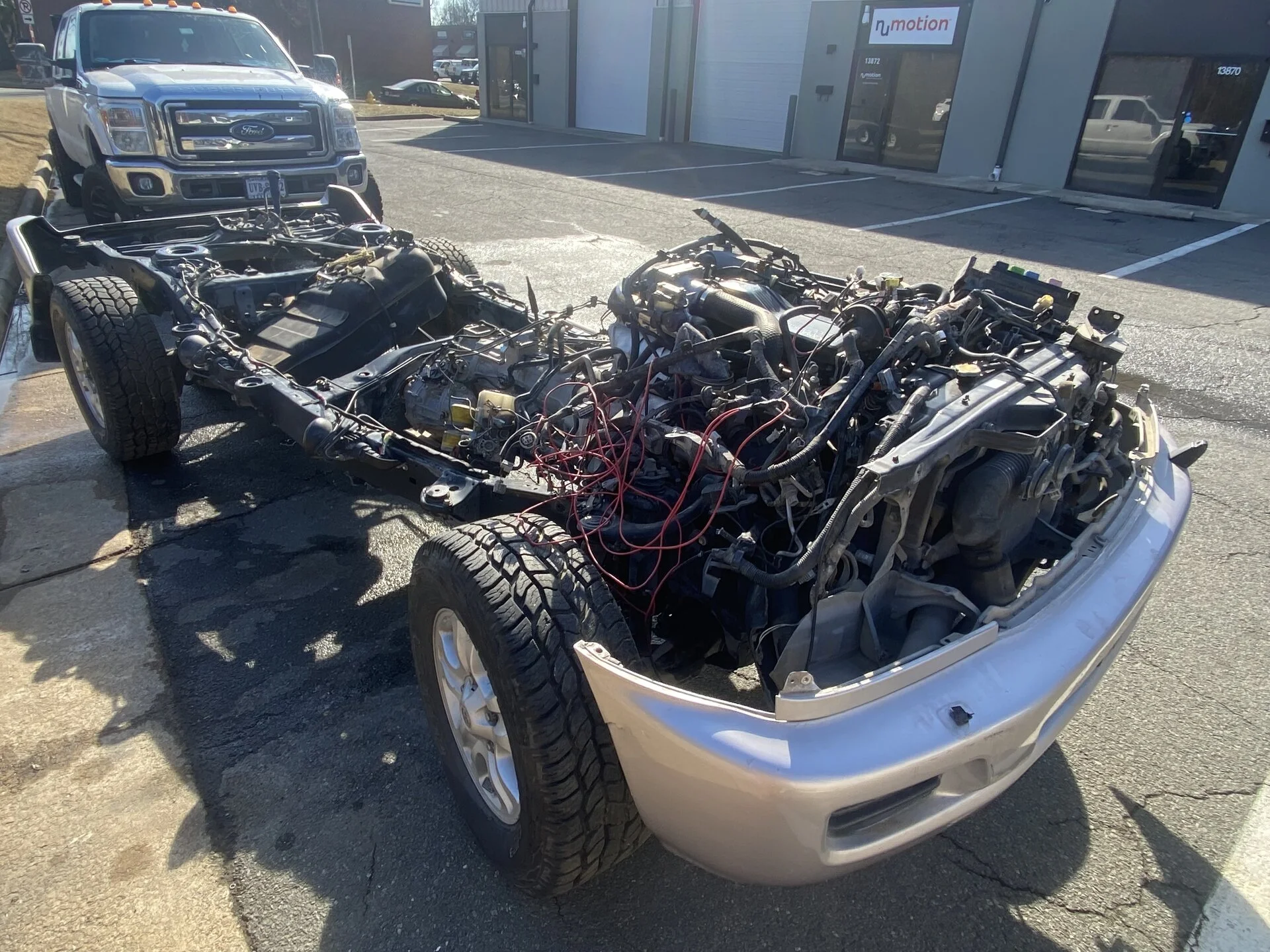

I have done the conversion of the 1hd-fte engine into the 1997 FZJ80 myself, here are my answers:
  1. Obviously a custom wiring loom is required as the FTE is electronically fuel-injected and the -T is not - I've read on here that a company in Australia can produce these? Does anyone know if they're still in business and if so how I can get in touch with them. If not does anyone have a wiring diagram for such a loom?
    [JS] There are couple of options in Australia as regarding the looms. Mostly used is Jonathan ( thraslux ) from the 1hd-fte conversion facebook page. I would strongly suggest that you connect to that group on Facebook as that group is solely dedicated to the conversion of 1hd-fte into 80. Wiring diagram of the 1hd-fte is available on the internets with a bit of searching. Regarding the loom, prepare to send both the 1fz and 1hd-fte looms to Australia together with the ecu as the immo needs to be disabled.
  2. How difficult is the packaging of the intercooler in the 80-Series shell? Most of the engines I'm seeing for sale in the UK are from HDJ100 models which I believe came with the intercooler so this would have to be retained for the swap.
    [JS] There are intercoolers available as third parties addons, most of us use PDI perfrormance intercooler for 80. If I did all again I would just go without the intercooler as the 1hd-fte on 79 series did not have the intercooler anyway. Keeping it simple might be way forward.
  3. Would it be best to retain the original 4-speed auto OR use the newer A750E from a 100 Series, in either case which modifications are required to get the whole assembly to fit together?
    [JS] I would strongly recommend to go with the pre-facelift hdj100 , mean a442f transmission which is stronger then the a750. Also you can re-use the shifter from the current 4-speed in fzj80. Otherwise you would have to modify the shifter mounting plate, cross-member and other stuff. In my case I had 1998 hdj100. The transmission mounting was simple without any modifications.
  4. Are there any specific hurdles in installing a RHD engine/trans combo into a LHD vehicle?
    [JS] I had engine from RHD going to LHD, no issues , just mention it and the wires would be extended.
  5. Does anyone know of shops in either the UK or France which have done or would be capable of this kind of swap?
    [JS] The conversion can be done pretty easily with couple good friends. I don't have any extensive mechanical experience and did it on parking lot.
  6. For anyone who's swapped an FTE into an 80-series, has it been worth it? have the performance/economy gains been worth it? Has there realistically been any step-down in reliability?
    [JS] It's worthy, I went almost all in and have bigger turbo ( gturbo green wheel, pdi intercooler, pdi airbox, 3'' manta exhaust etc). This can be done just without any of these addons. In fact if I would do it again, I would just keep it simple.
Forgot to mention that there are many other things which needs to be taken care, the fact that you have 1hd-t makes it easier:
* 1hd-t airbox can be used with fte without any modifications
* oil pan needs to be swapped from 1hd-t to fte
* the right hand side engine mount needs to be reused
* you need to source bigger feed line then 1hd-t 10mm , 1hd-fte uses 12mm. Some guys just leave it and use pickup pump
* in my case i had transfer case without viscous coupler so had to extend the rear drive shaft ( kardan )
* the aircon compressor needs to be taken care off ( still missing in my case ), the upper housing needs to be changed from 1hd-t to 1hd-fte compressor
* speedo meter needs to be modified and one transistor needs to be re-soldered
