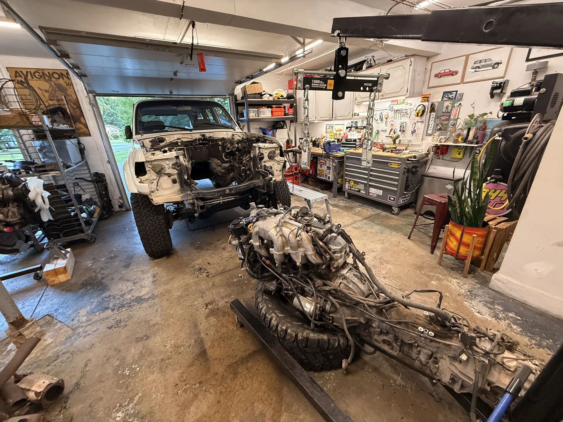

1HD-FTE Conversion - Creating my perfect 80 Series
This is a HUGE help in making sure I’m not missing anything before putting the hoist on the motor and yanking. I really should have started by looking at the FSM.
1FZ is out! Thankful for good help.

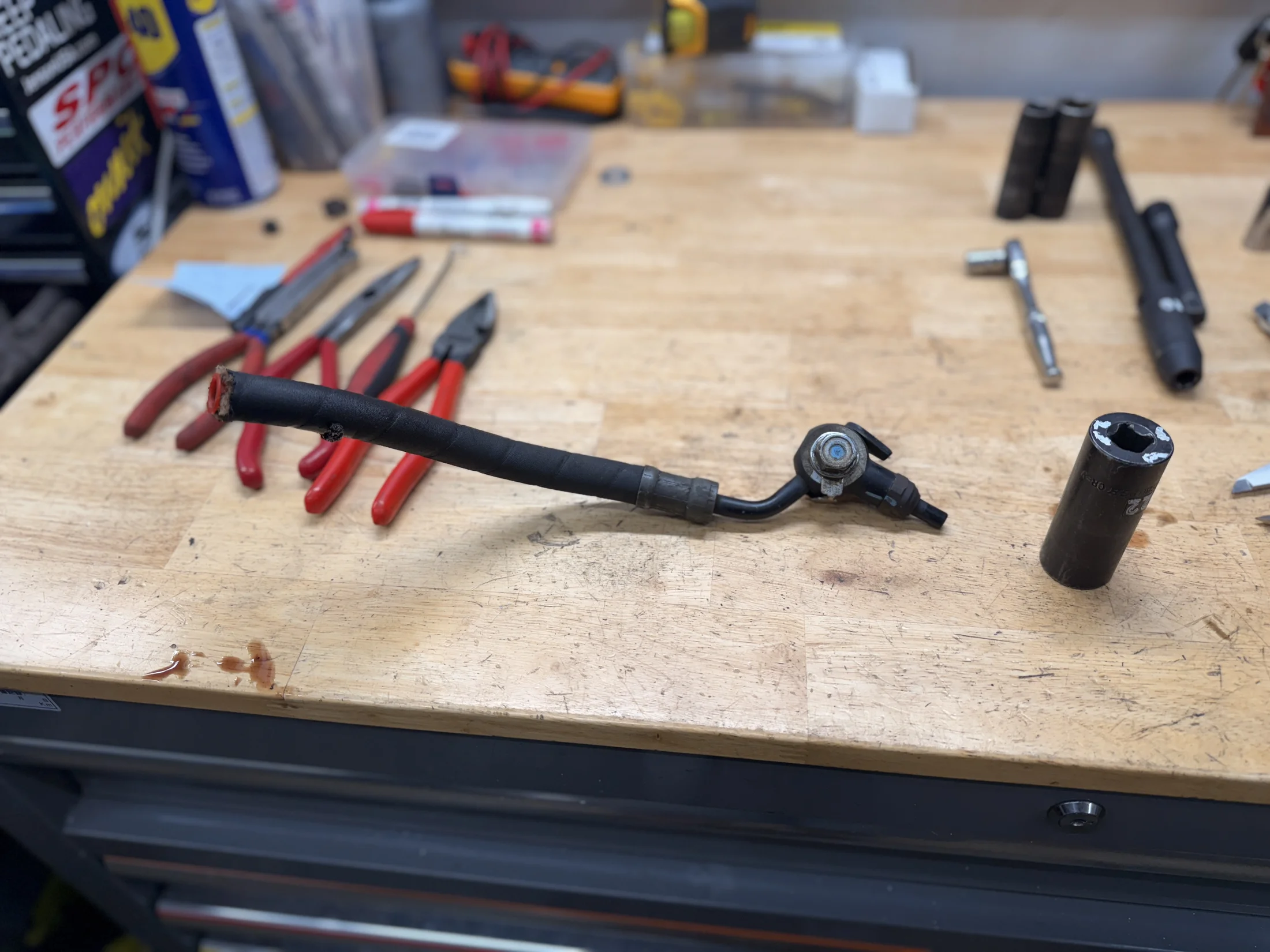

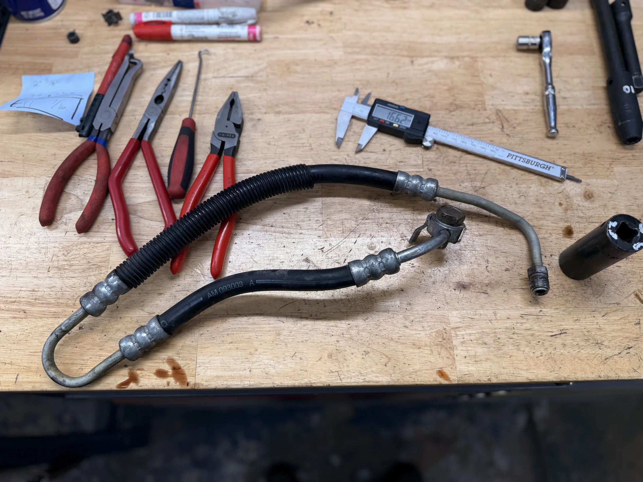

Was unsure about the PS setup and what parts I would need to get for the FTE PS pump to run the 80 series steering gear, so I got to looking. Pulled the whole high pressure hose assembly from the 1FZ and it was a direct fit to the FTE PS pump, but you must bring the banjo bolt from the 1FZ over with the 1FZ hi-P line, due to the difference in thickness of the coupling.
FTE line, or what the salvage yard left of it:
1FZ line:
The rest of the PS system (original to the 1FZ chassis) should fit right up to my eye.

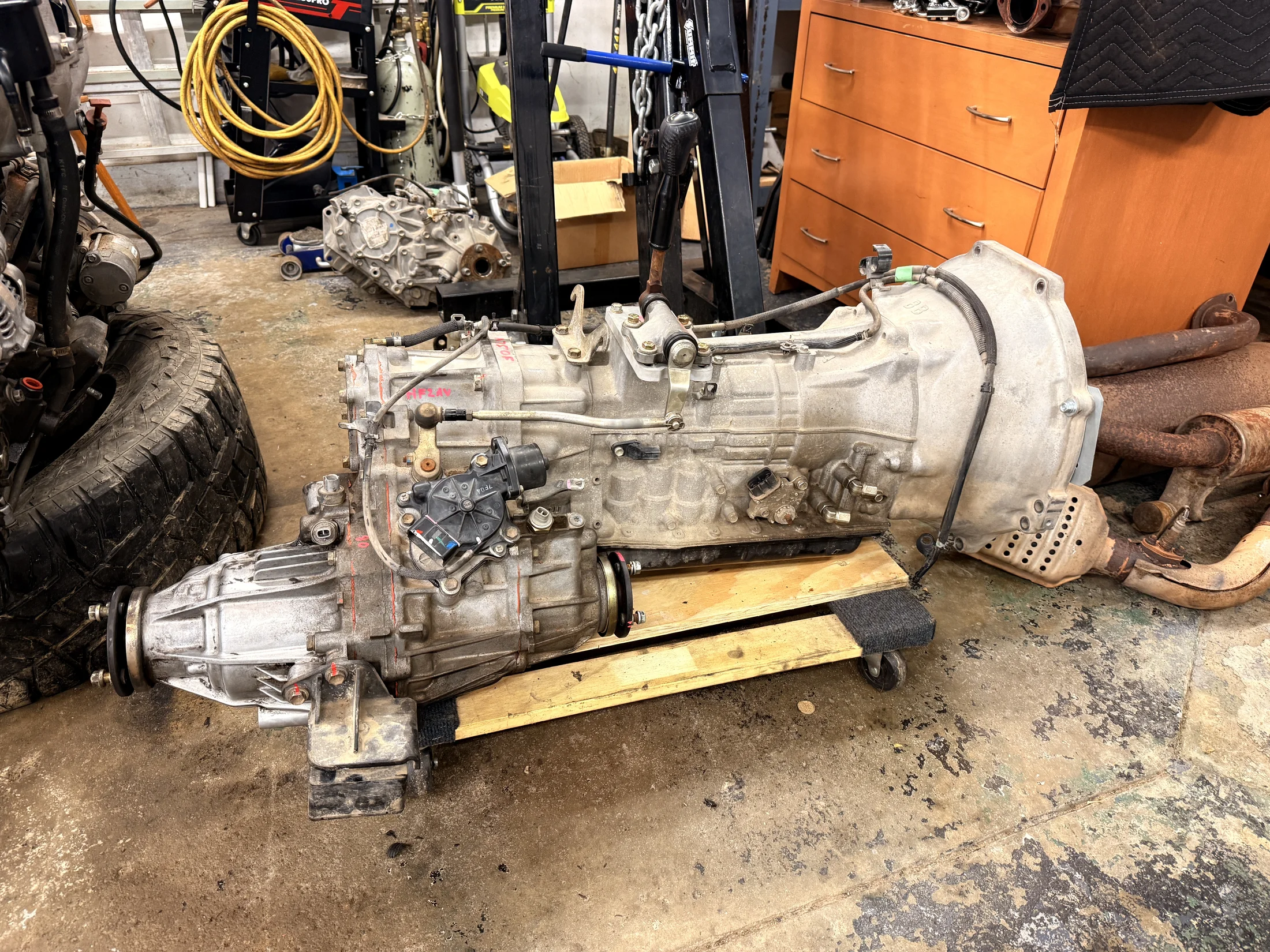

Separated both transfer cases from their respective transmissions so I can bolt the 80 series t-case to the A750F after cleaning it up. They are heavy. The trans did not come with the hardlines that route to the front to the trans cooler, partsouq doesn’t have them so am going to look for other sources. I’m trying to use OE parts as much as I can.

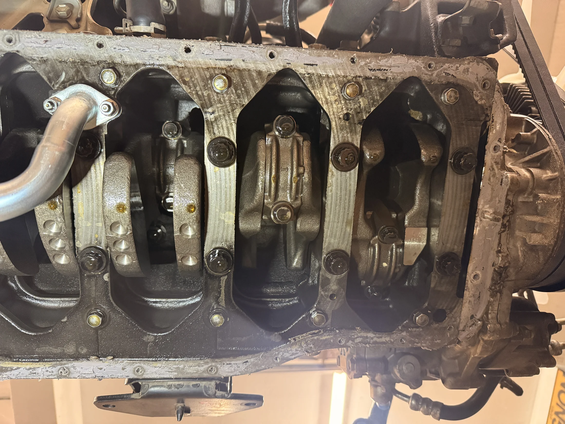

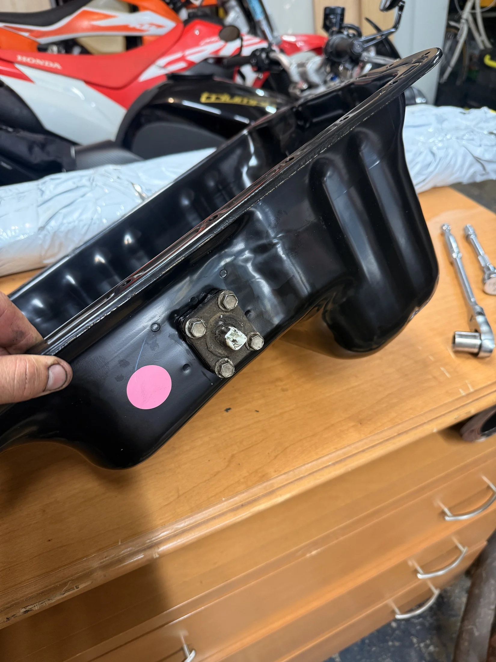

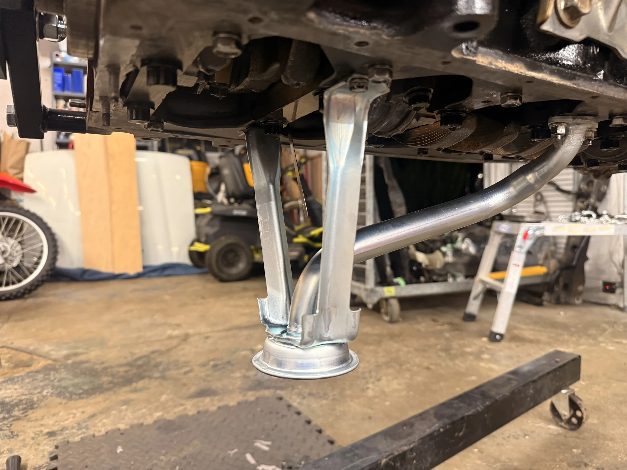

1HZ oil pan, oil pickup and gasket fit up to the FTE block really nicely, and the FTE oil level sensor was a direct fit. Man was that a whole lot of little bolts to torque up, and a whole lot of FIPG to razor blade off.
The low oil marker on the FTE dipstick is well above the top of the oil pickup, and the high marker on the dipstick is below the low point on the lobes of the crank, so it looks like the FTE dip stick and tube will be ok.
I was happy with how clean the rotating assembly looked. I cleaned up all of the gasket maker after installing the new pickup because I didn’t want to risk getting some small piece of RTV in the pickup channel. It seemed the factory absolutely hogged RTV on there, or that the pan had been off before.
The difference in profile of the 1HZ pan vs the FTE pan from the 100 series was dramatic. This means total oil volume is lower so I’ll be sticking to old school 5k mile oil changes once it’s sorted and running. :hmm:

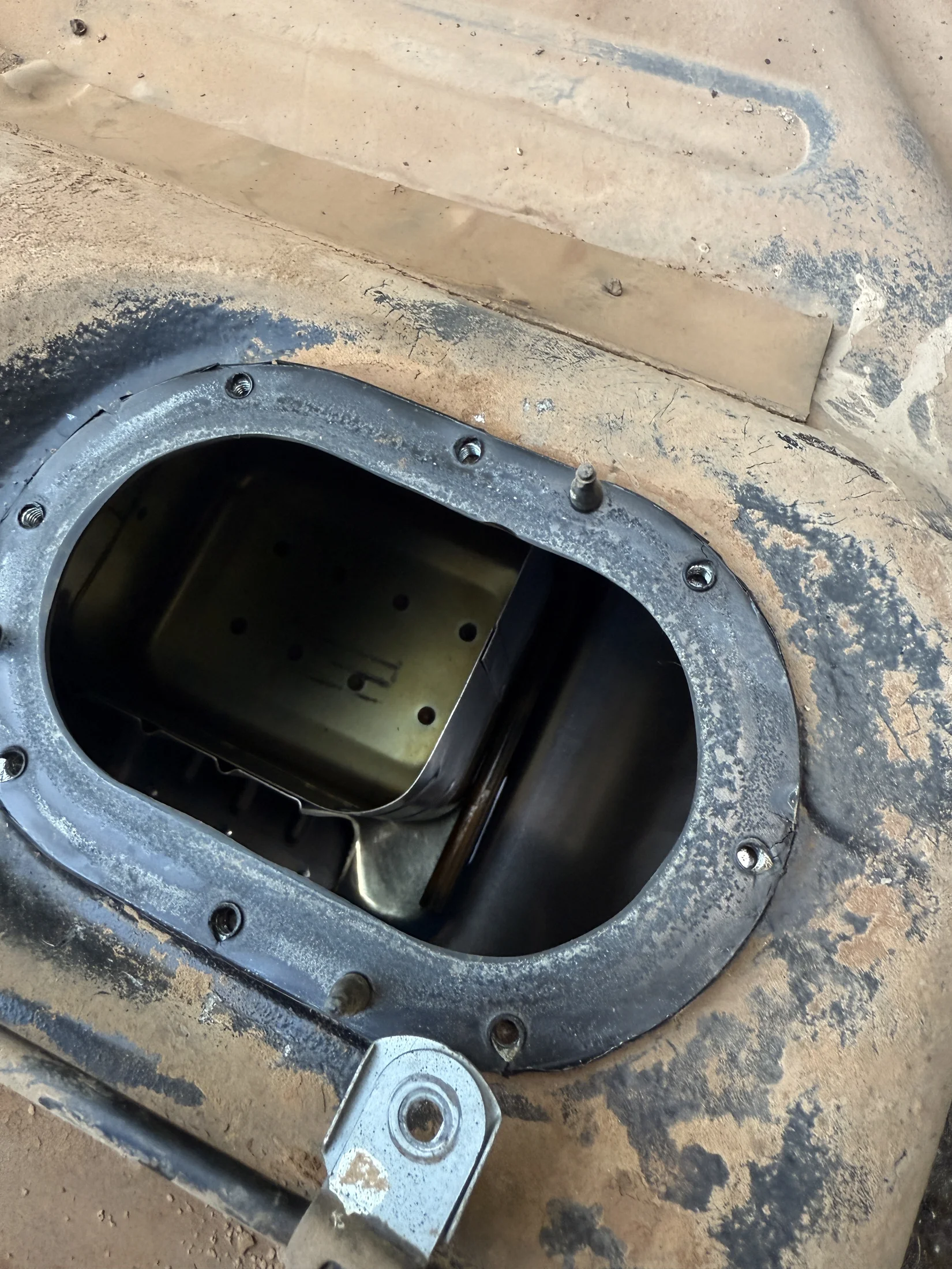

Some small updates, I pulled the tank, removed all gas, and swished with fresh diesel. Not a whole lot of varnish in the tank which was nice.
Swapped the fuel level sender to the diesel pickup and installed in the tank.

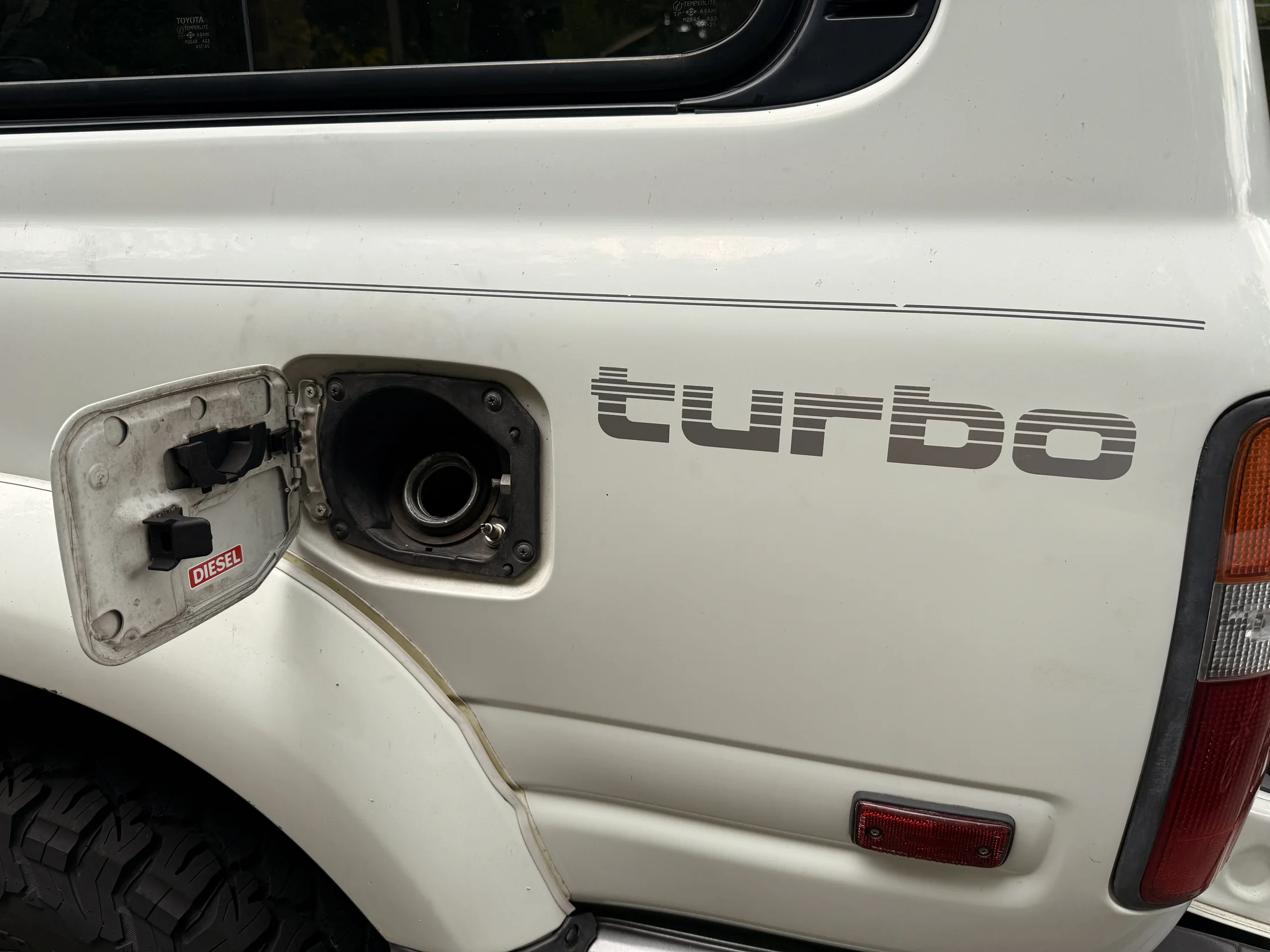

Removed the flap from the filler neck - I had never felt like a dentist until this, with picks, a light, and a dremel all on one small place.
Applied stickers because I couldn’t help myself. I need to get that fender flare re-attached.

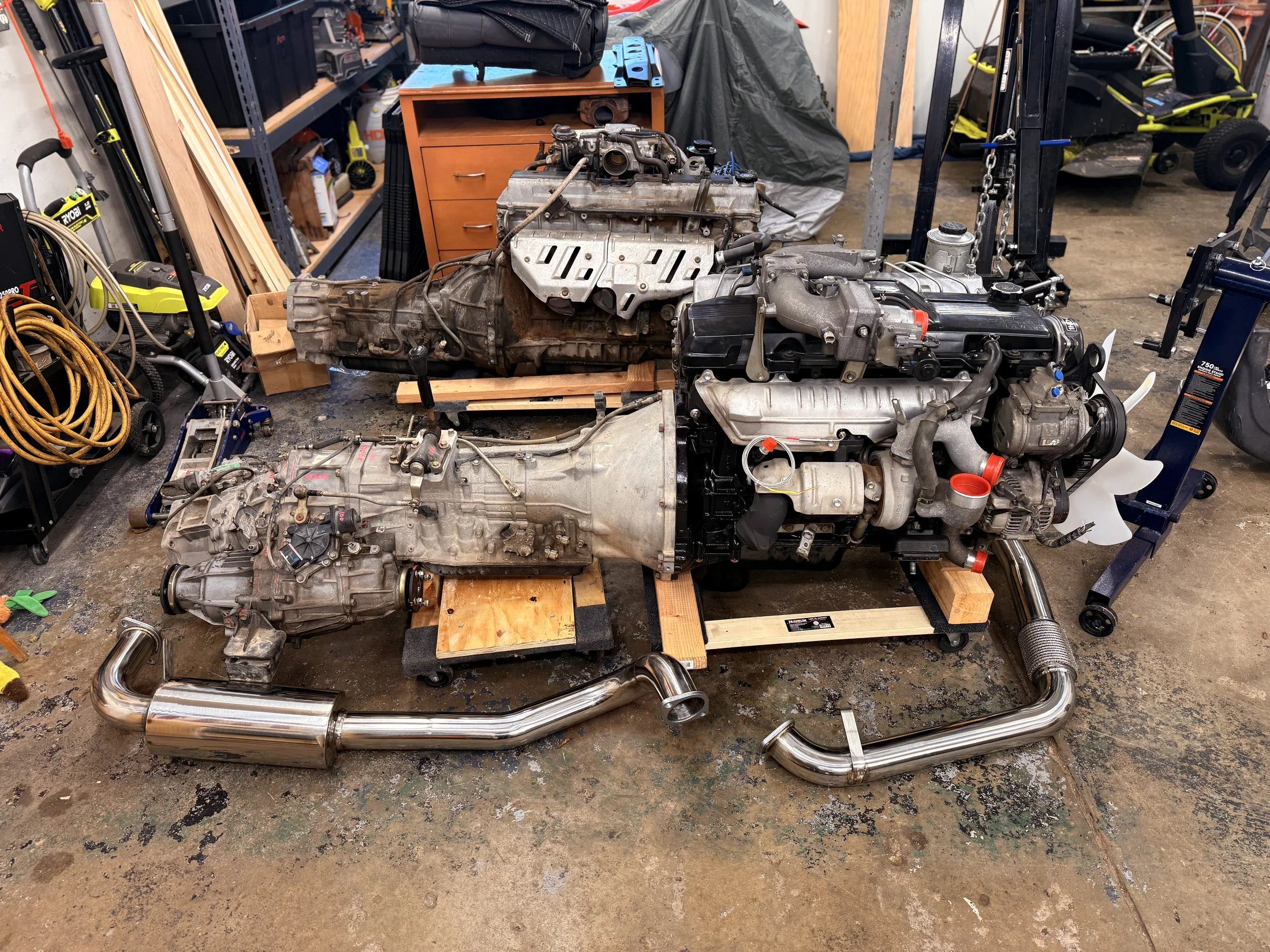

My garage is feeling very small and is Land Cruiser mania at the moment - 2 engines, 2 transmissions, and 2 transfer cases, and a huge shelf full of parts.
I moved the 100 series center diff lock actuator motor over to the 80 series t-case, as this is what the connectors on the harness Jonathan will provide will connect to; it was a direct fit to the 80 series HF2AV case. With a bit of heat and leverage, I tossed a slight "s" curve in the t-case shifter linkage.

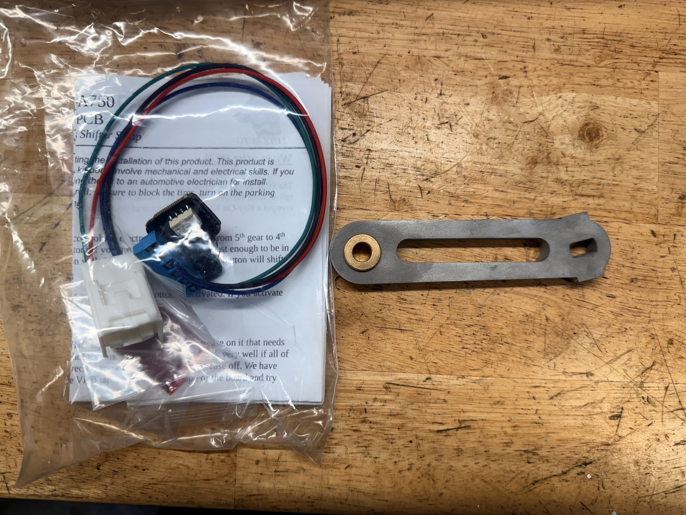

-Shift gate signal converter for the A750F
-Transfer case adapter plate
-Signal converter for dash lights
-EGT thermocouple and 80 series clock multi-gauge a while back
Pretty nice kit here with the inclusion of a roll pin to fix the lever, a bushing in the lever, and well thought out instructions

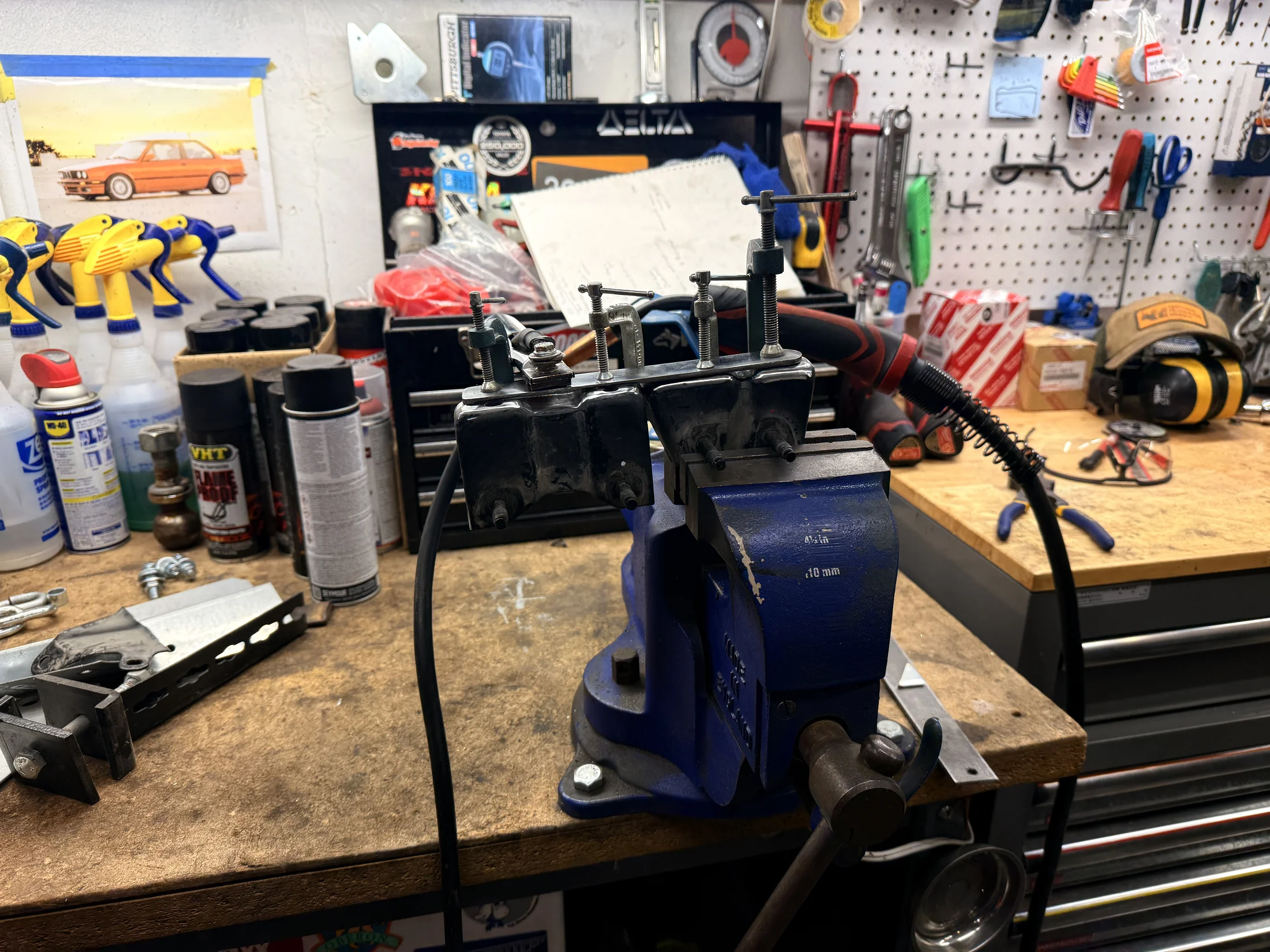

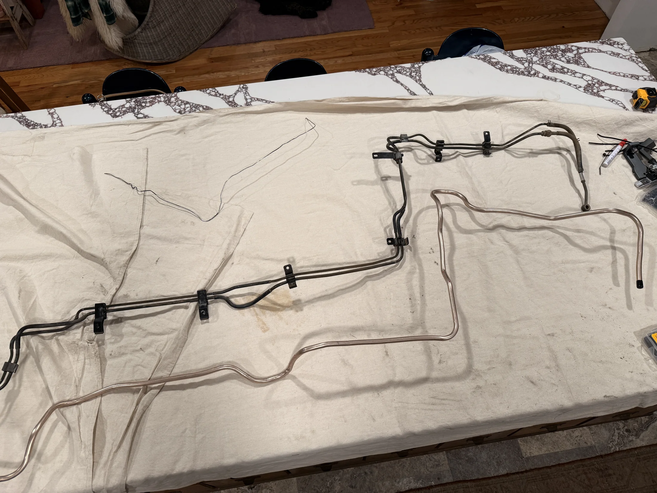

Forgot to mention, I was able to make the original .025" wall NiCopp fuel supply line work. Bending by hand was just not working, so I picked up this Doyle tubing bender from Harbor Freight. With a tape measure, a coat hanger to mimic complex bends and a hell of a lot of eyeballing, I was able to get a result I could live with. It took a little bit of fine tuning, but this is now installed, following the factory line routing. Anywhere where this line contacts something - at the mounting brackets for example, I have adhesive lined heat shrink on the line to prevent it from rubbing through in the future.
I didn't have a surface large enough to bend this in the garage without doing this on this ground, so I did this in my kitchen of all places :steer:

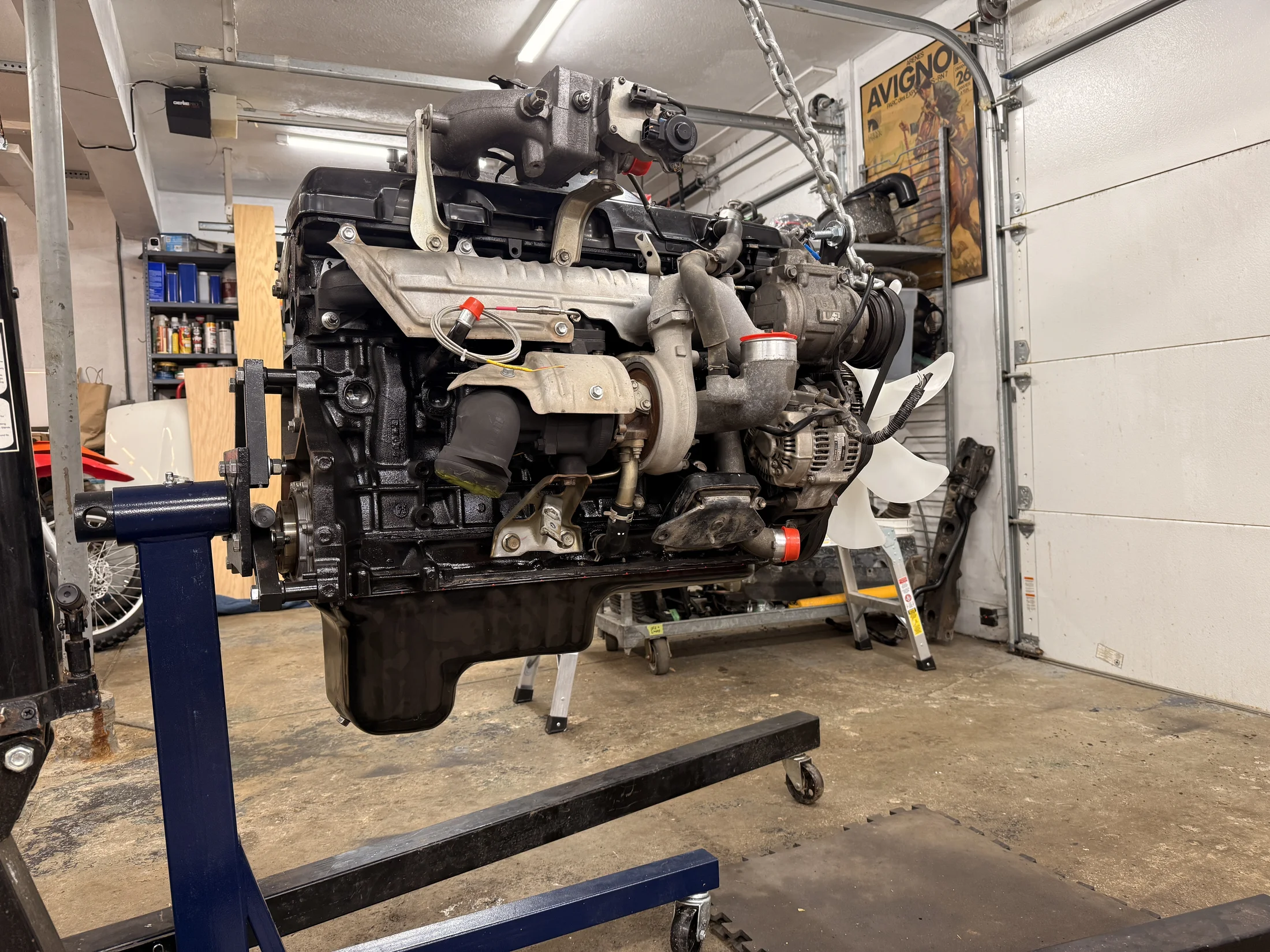

Did the rear main seal - the original looked great, but after seeing some comments, I agree that I'd rather just do it now vs pulling the drivetrain again.
With the rear main done, I mated the transmission and engine back up. I found it easiest to torque the drive-plate-to-torque-converter bolts with the lower "ear" on the right hand side removed. Had a helper in the garage tonight (big FTE fan) ensuring I was torquing things to spec. 🐕

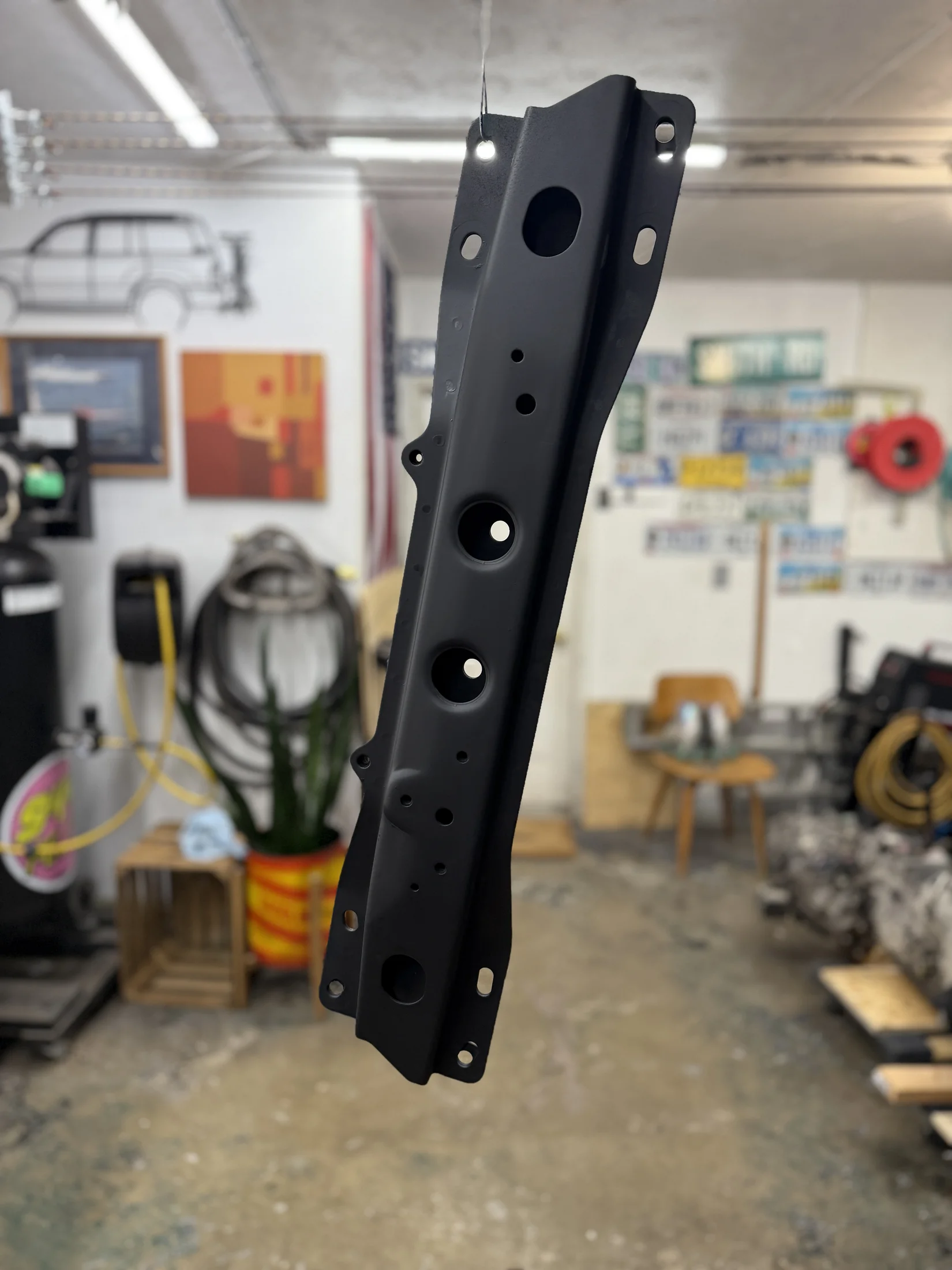

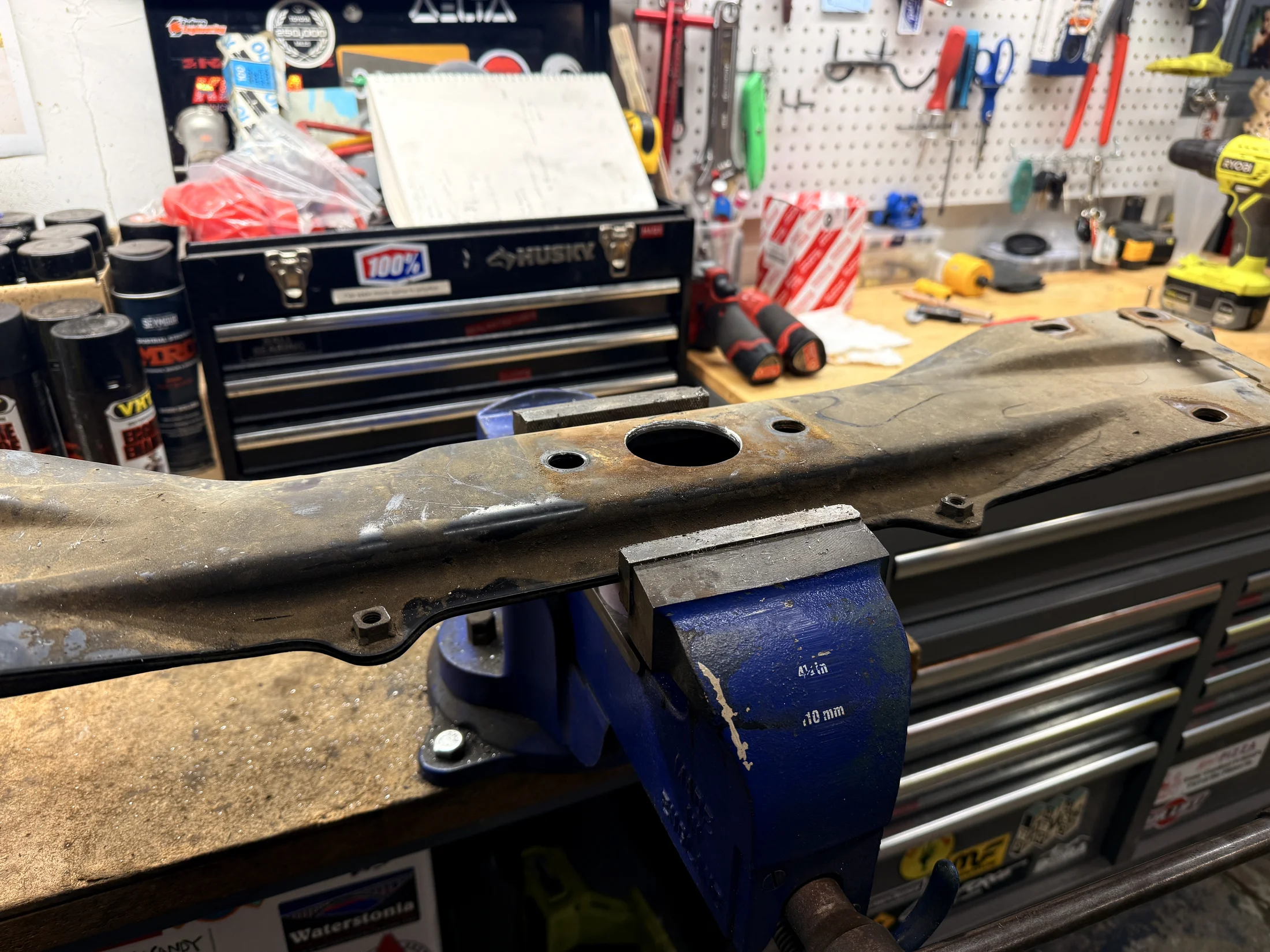

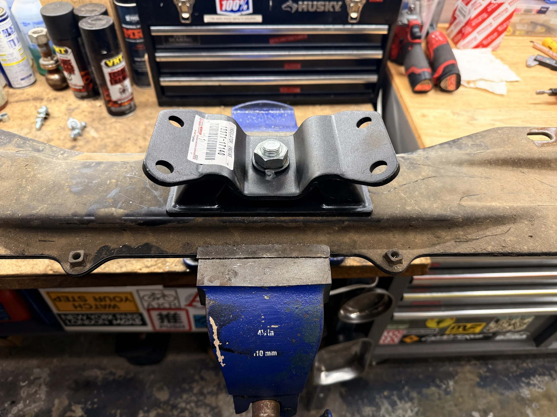

Modified the cross member to accept the 100 series transmission mount. 2 1/8” hole saw, cleaned up with a burr grinder.
No rush while I’m waiting on the harness so cleaning and painting it is.
Eastwood rust encapsulator as a preventative measure, then top coated with MRO flat flack. There’s something nice about cleaning up and painting an original part to look like new.

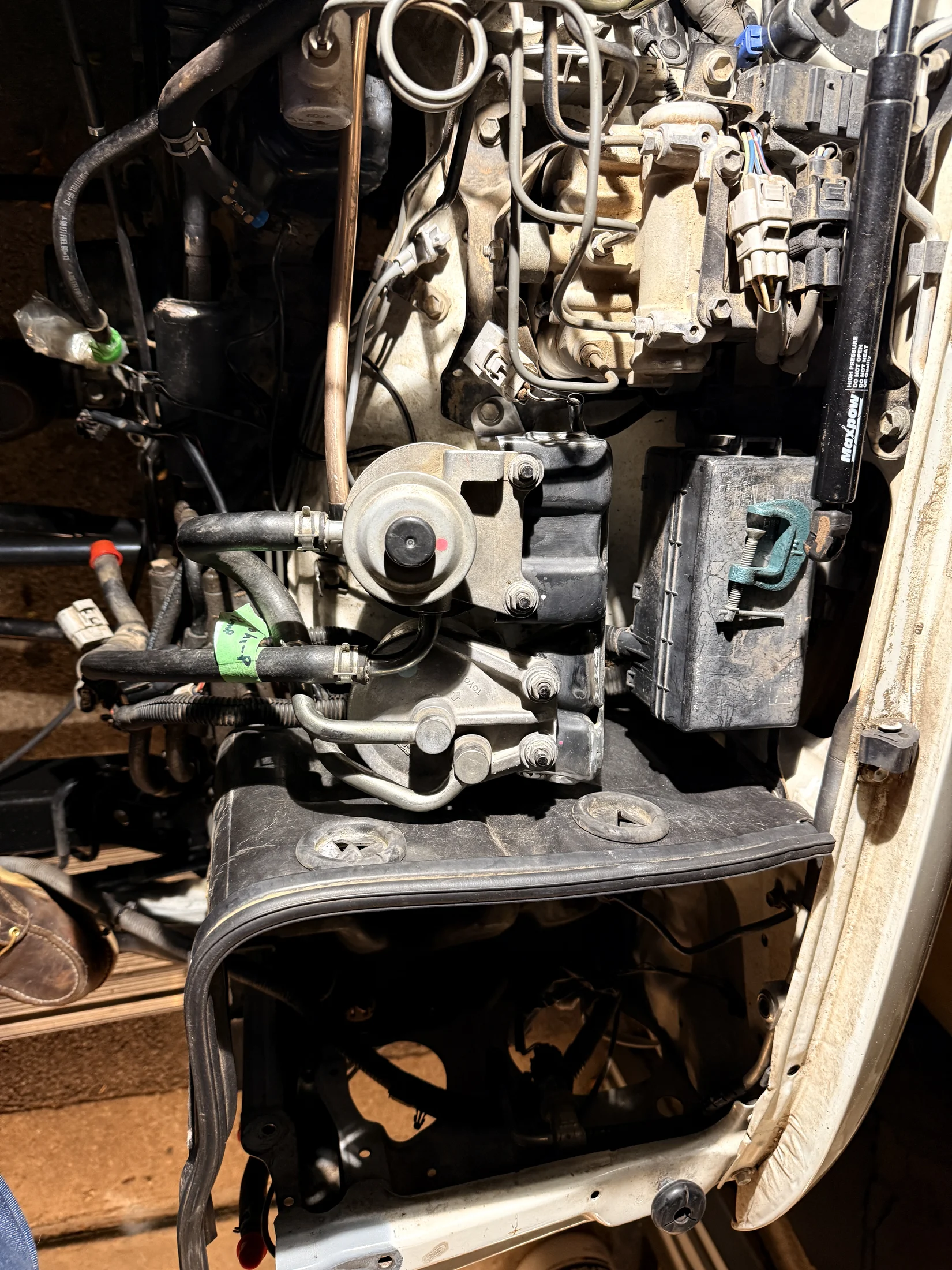

Dug into the bracket for the fuel filters. I chose to place them where the 1FZ charcoal filter was located so needed to fab up a bracket.
Primed with weld thru primer just in case, and will get the same treatment as the cross member.

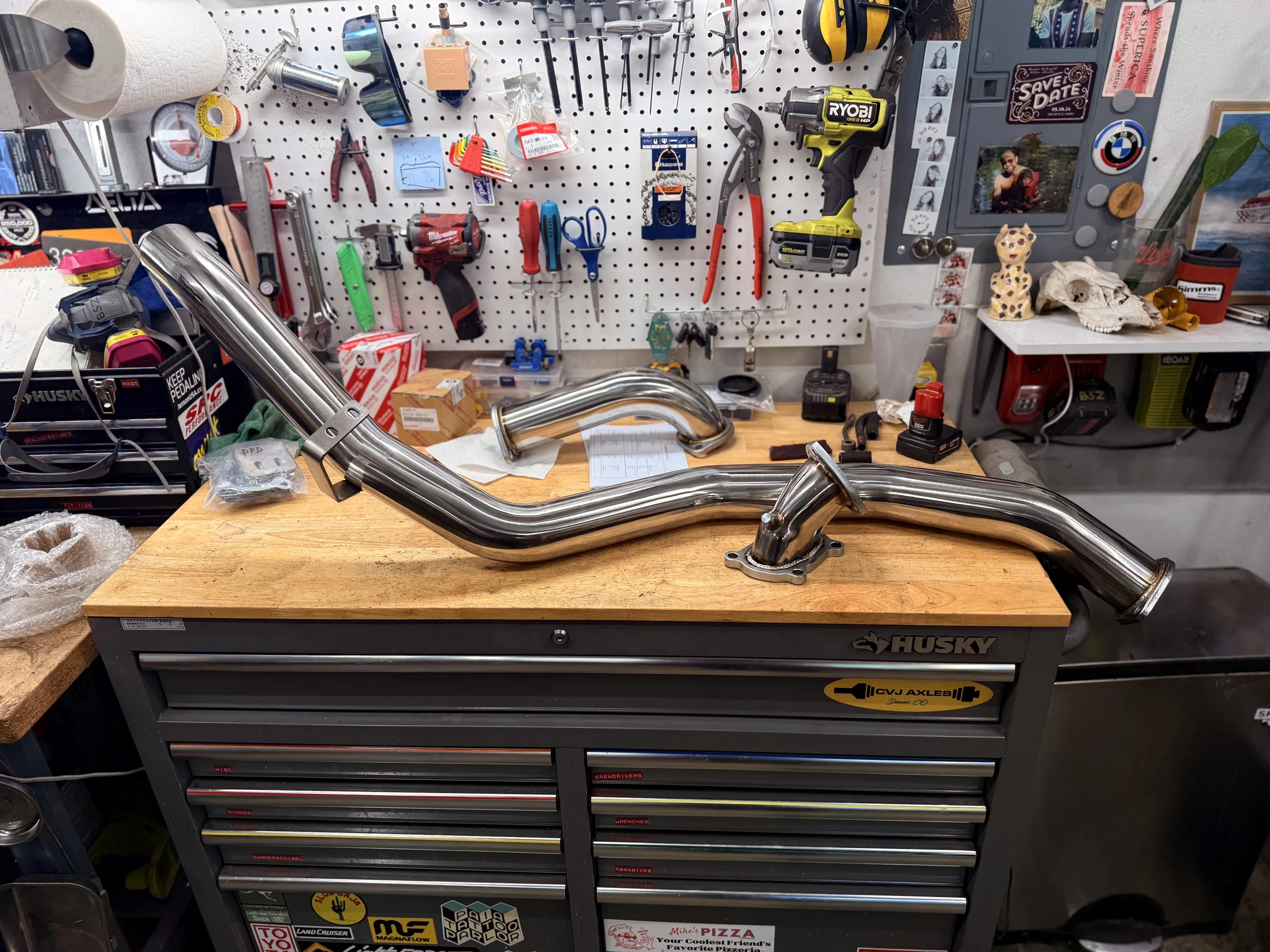

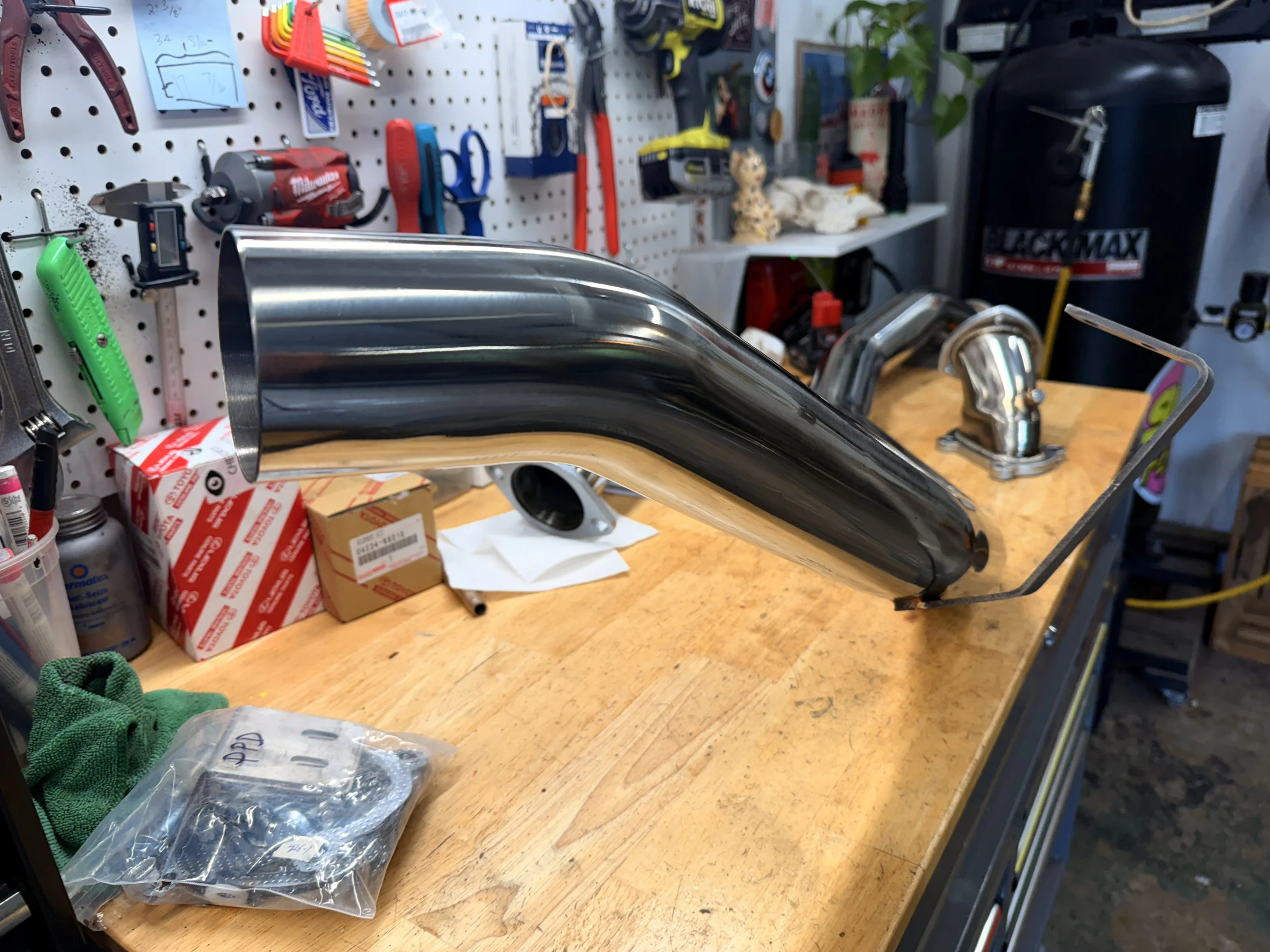

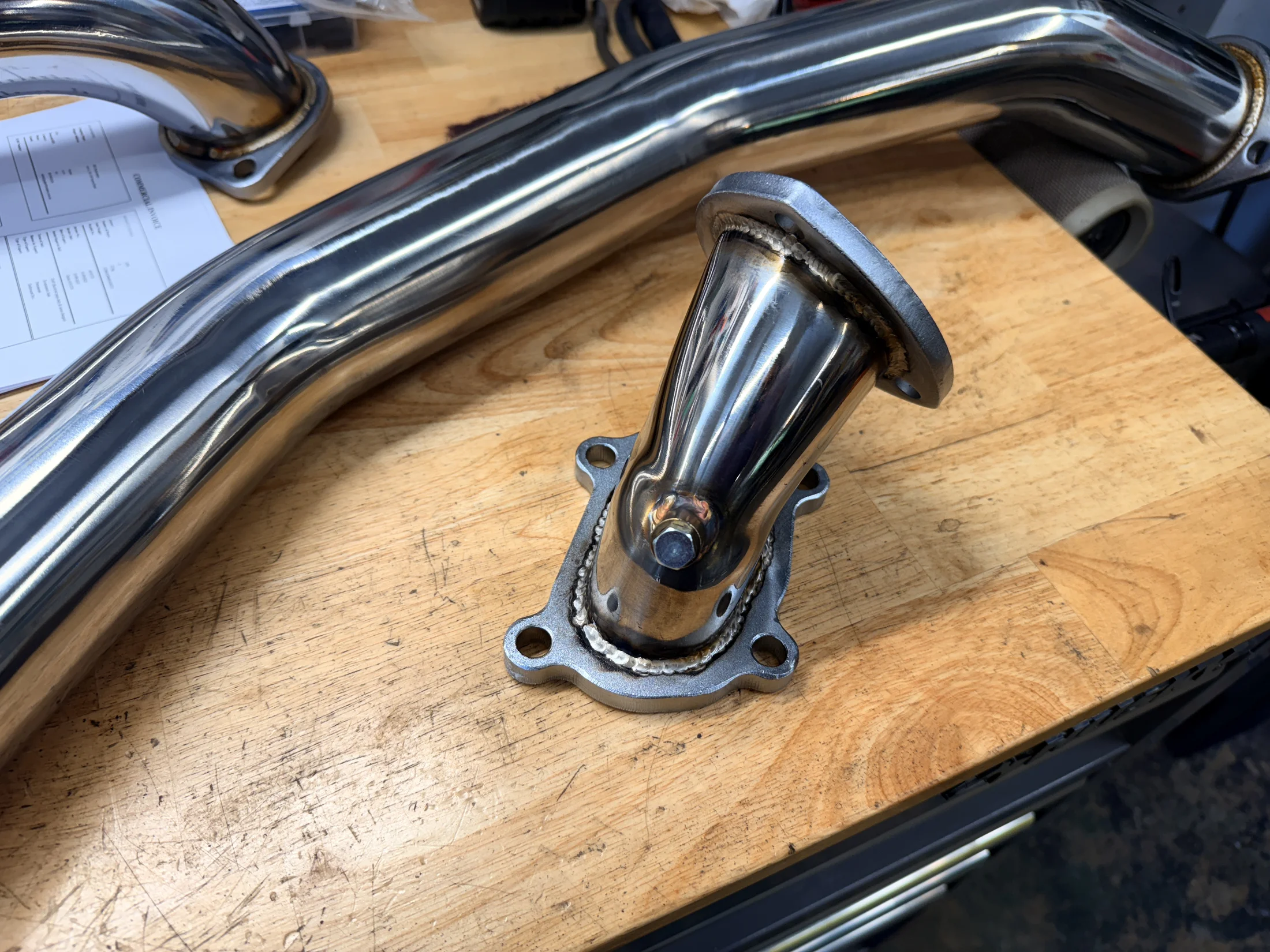

Also, PPD stainless 3” exhaust with muffler should be here tomorrow. Tariffs are eating my lunch on this one. 😐
Side note - does anyone think the original 1FZ exhaust is worth anything? It was an Arizona car so it’s not rotted out, cats were good, o2’s also good, no codes.
I would feel bad scrapping it.
I feel this, I got hit for 500ish in tarrifs on my PDI intercooler kit.....

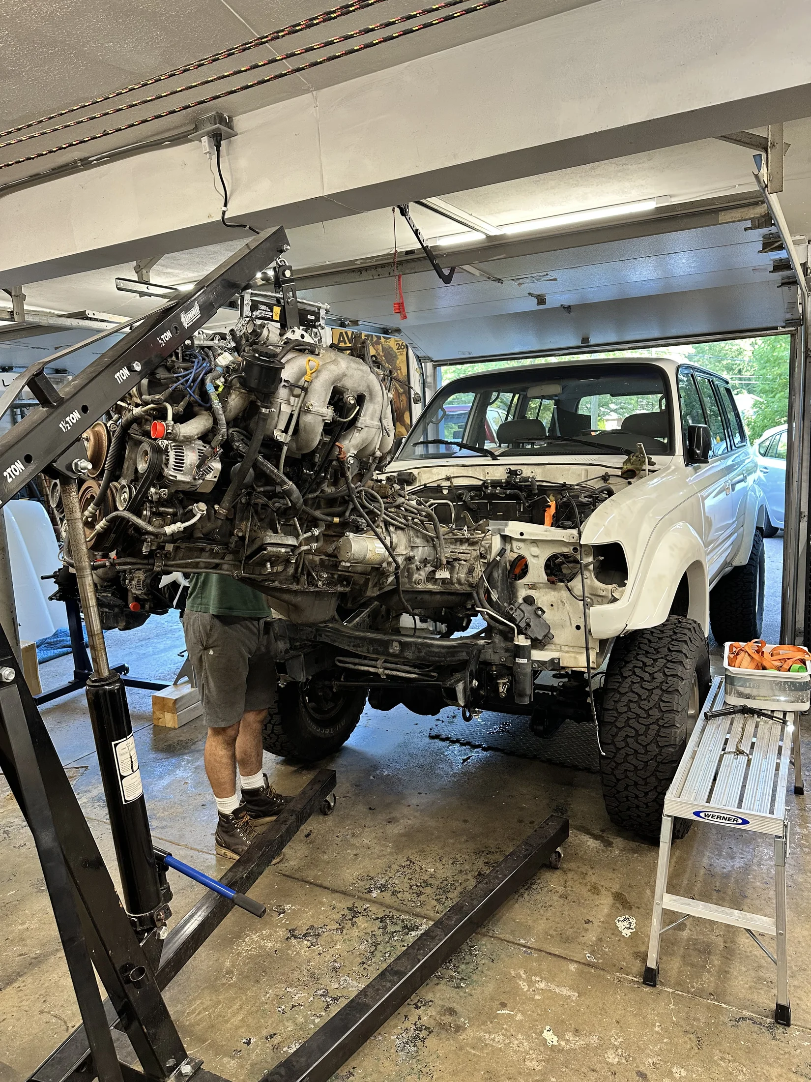

Well lets get her in there!!!
That's my sentiment too, but there are a few things that will be easier to sort out while the drivetrain is still out:
