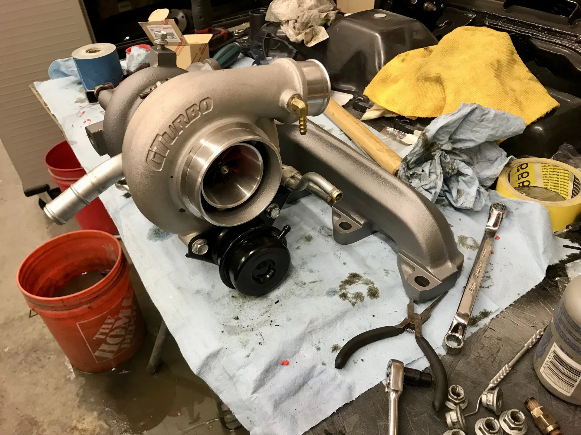

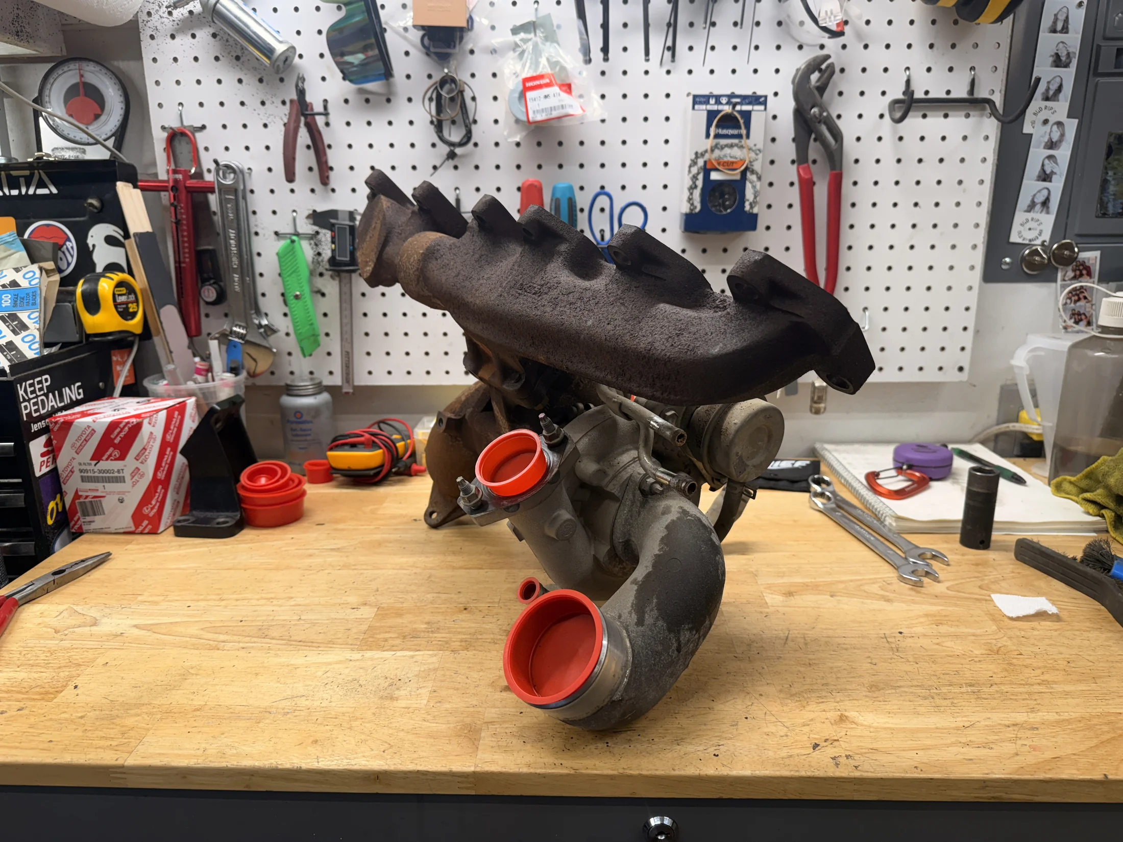

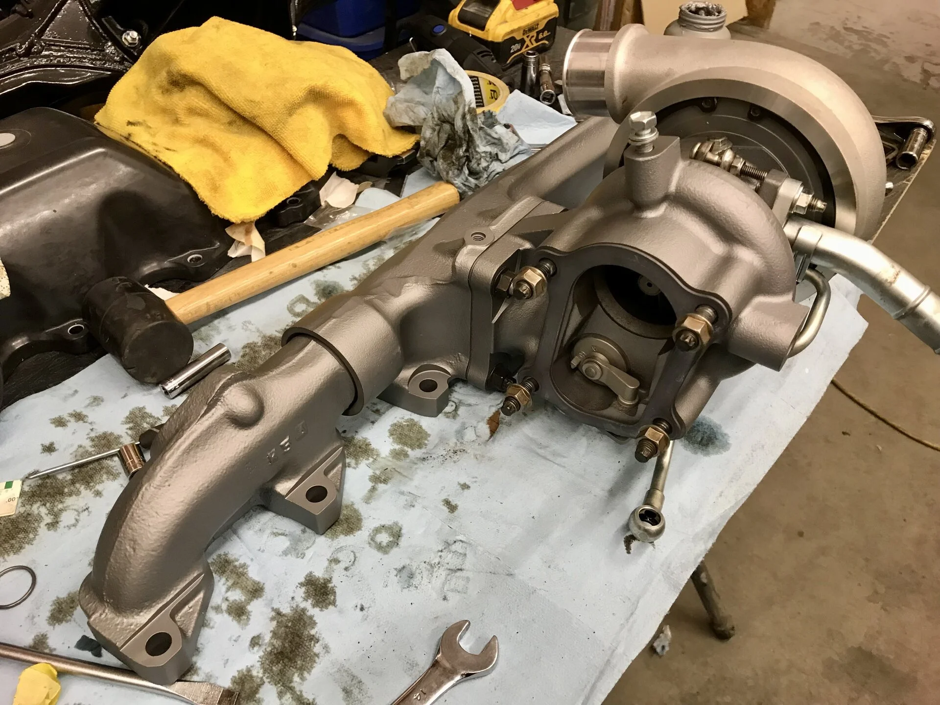

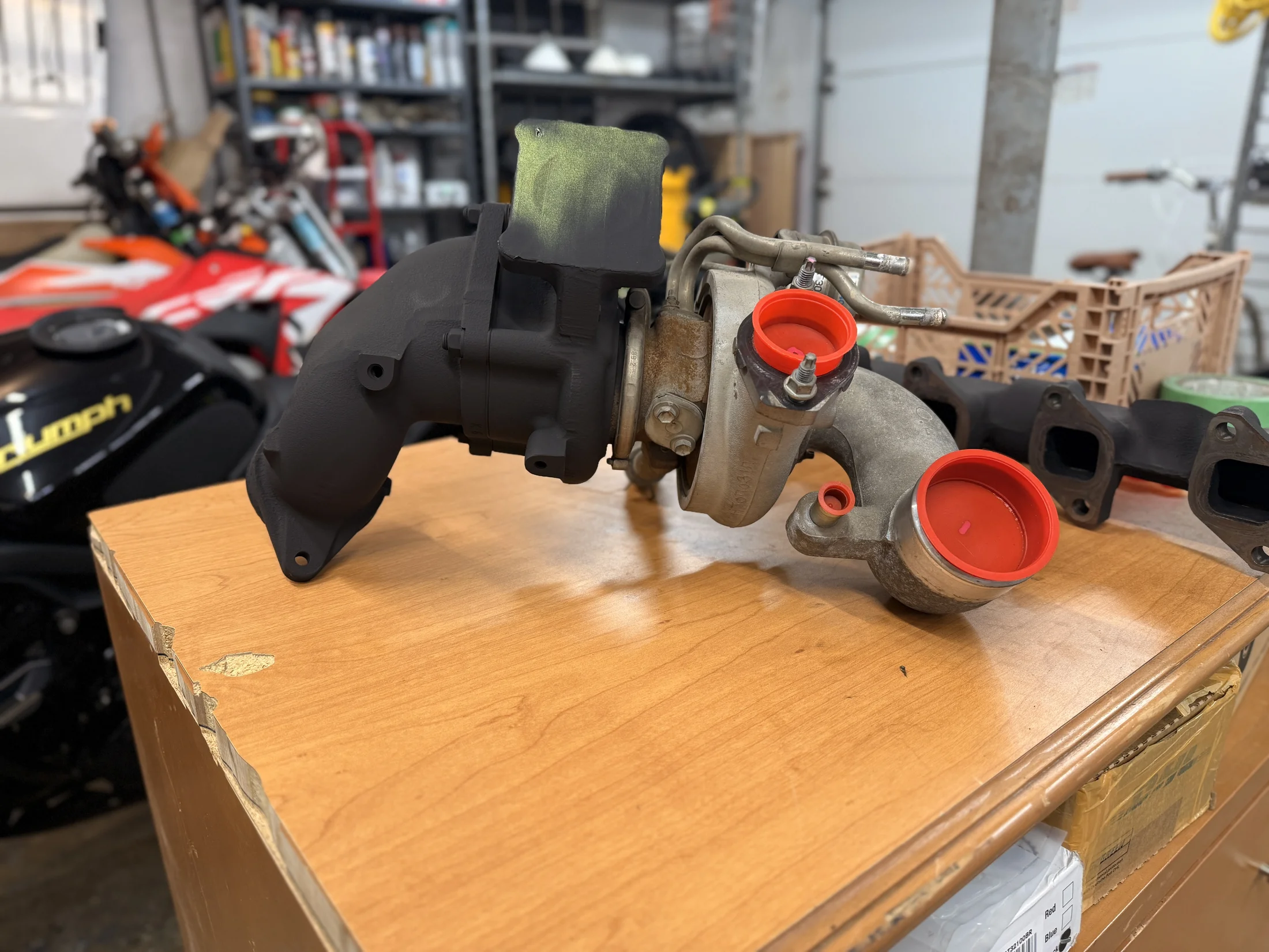

Snuck in a little bit of time in the garage tonight. Pulled the exhuast mani and turbo assembly. I'll need to have the manifold off to drill and tap for the EGT sensor, so I figured I'd clean it up and paint while I'm waiting for parts to arrive.
I've been putting bolts/hardware that I remove in labeled bags so there's no question when I go to put it all back together:

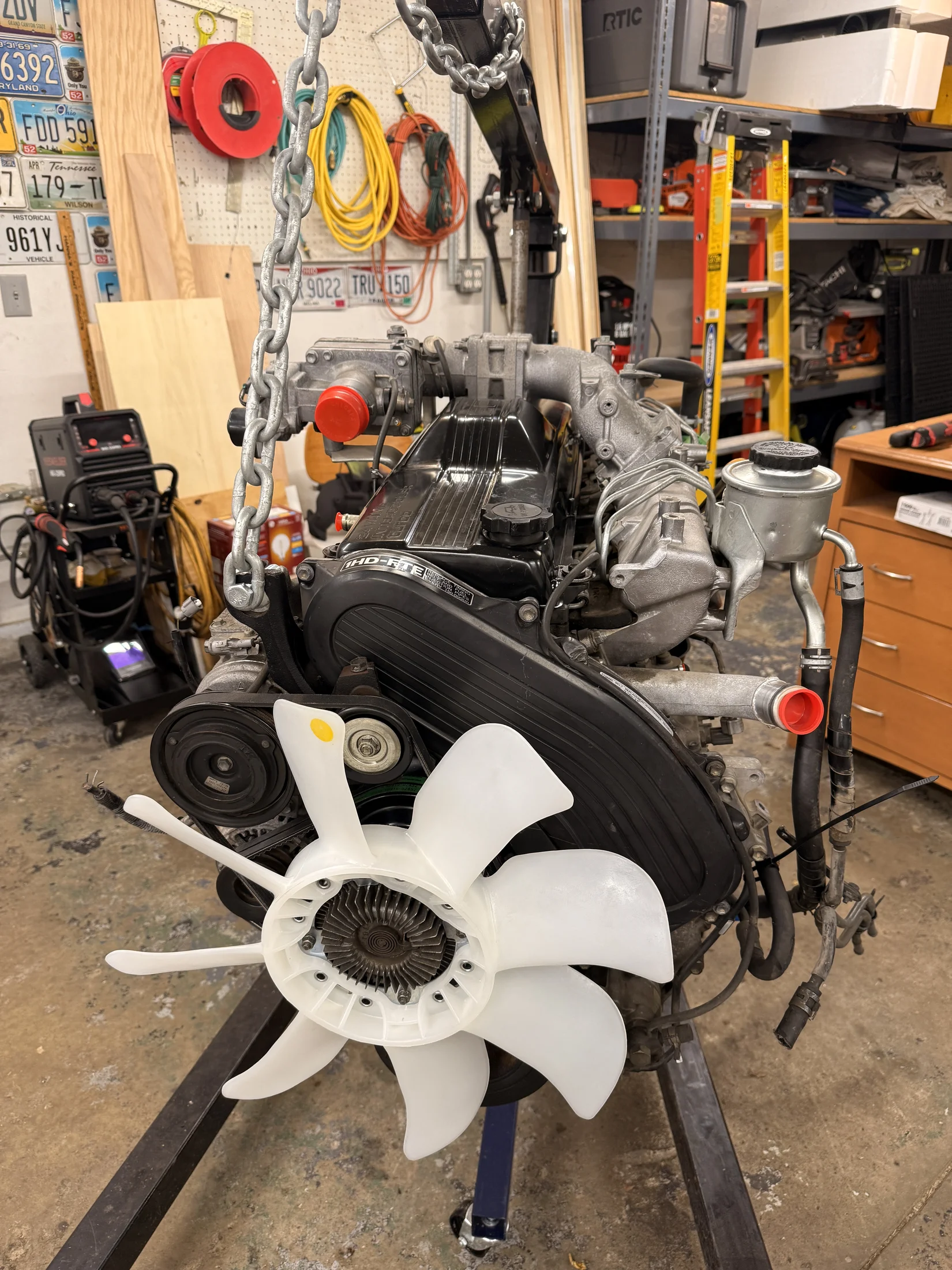

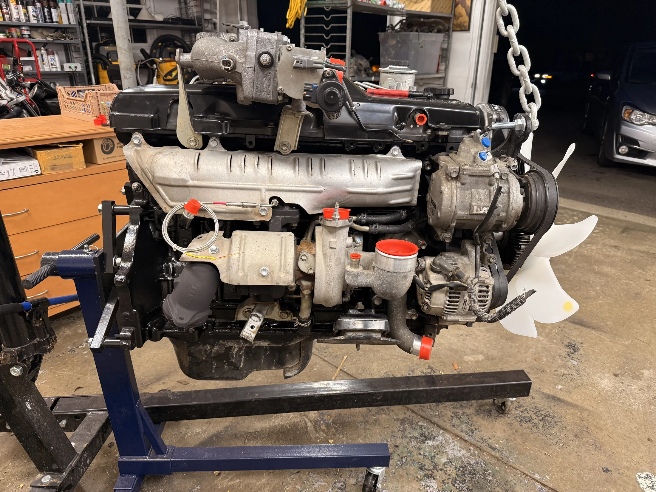

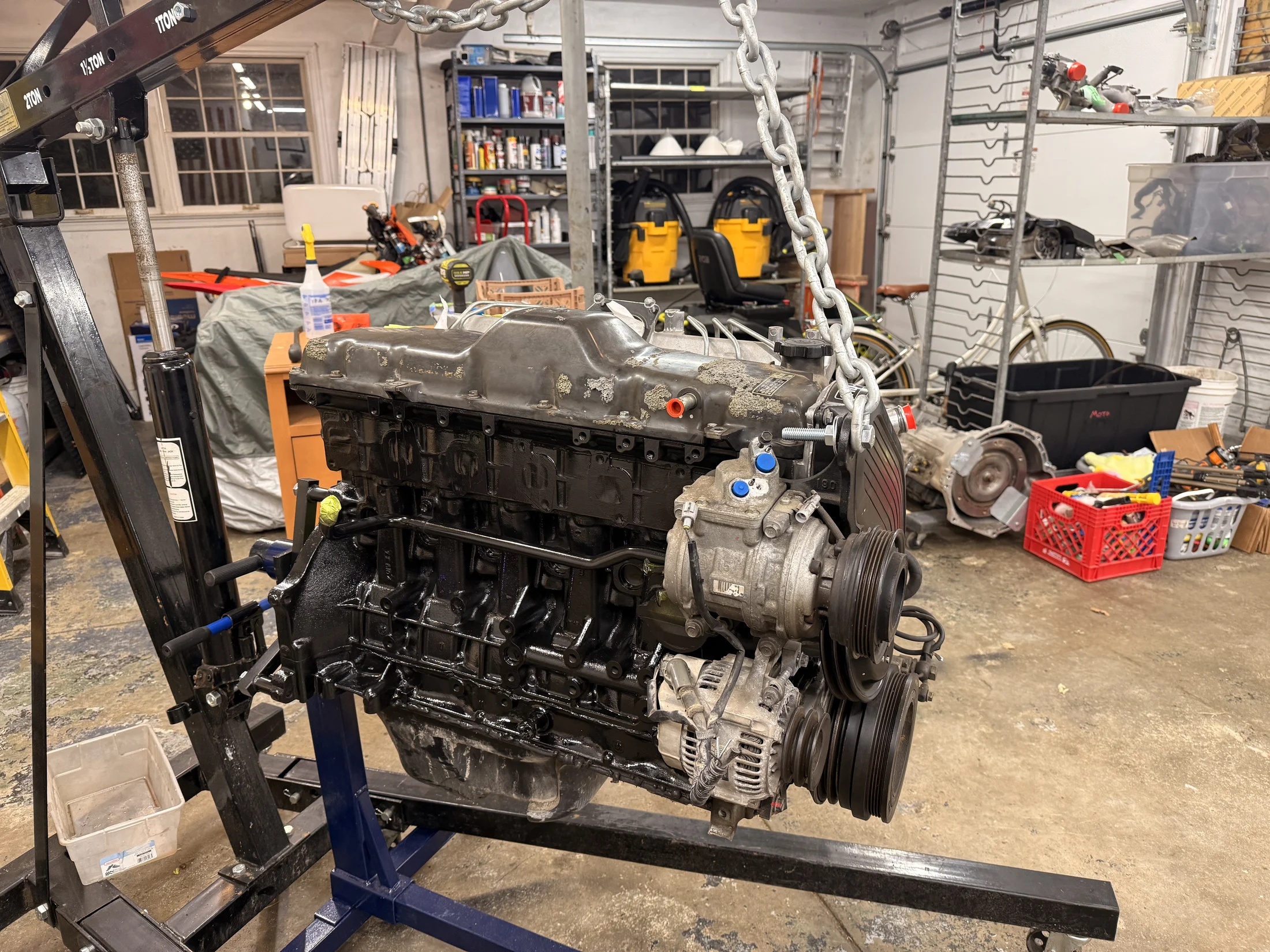

And then with the manifold off, I figured why not just keep going and paint the block, we're already here. Sometimes I can't stop myself. Here is where it will sit for the night to cure, then I'll redress this side of the engine, and do the same on the other side.
I'm fairly sure this won't bee seen by many, if anyone at all, but it sure looks fresher in the stand with some paint.
Snuck in a little bit of time in the garage tonight. Pulled the exhuast mani and turbo assembly. I'll need to have the manifold off to drill and tap for the EGT sensor.
Looking good! Where are you going to mount it?
I'm going to mount it pre-turbo, where all of the headers collect, just before the flange where the turbo bolts up on exterior side of the mani.

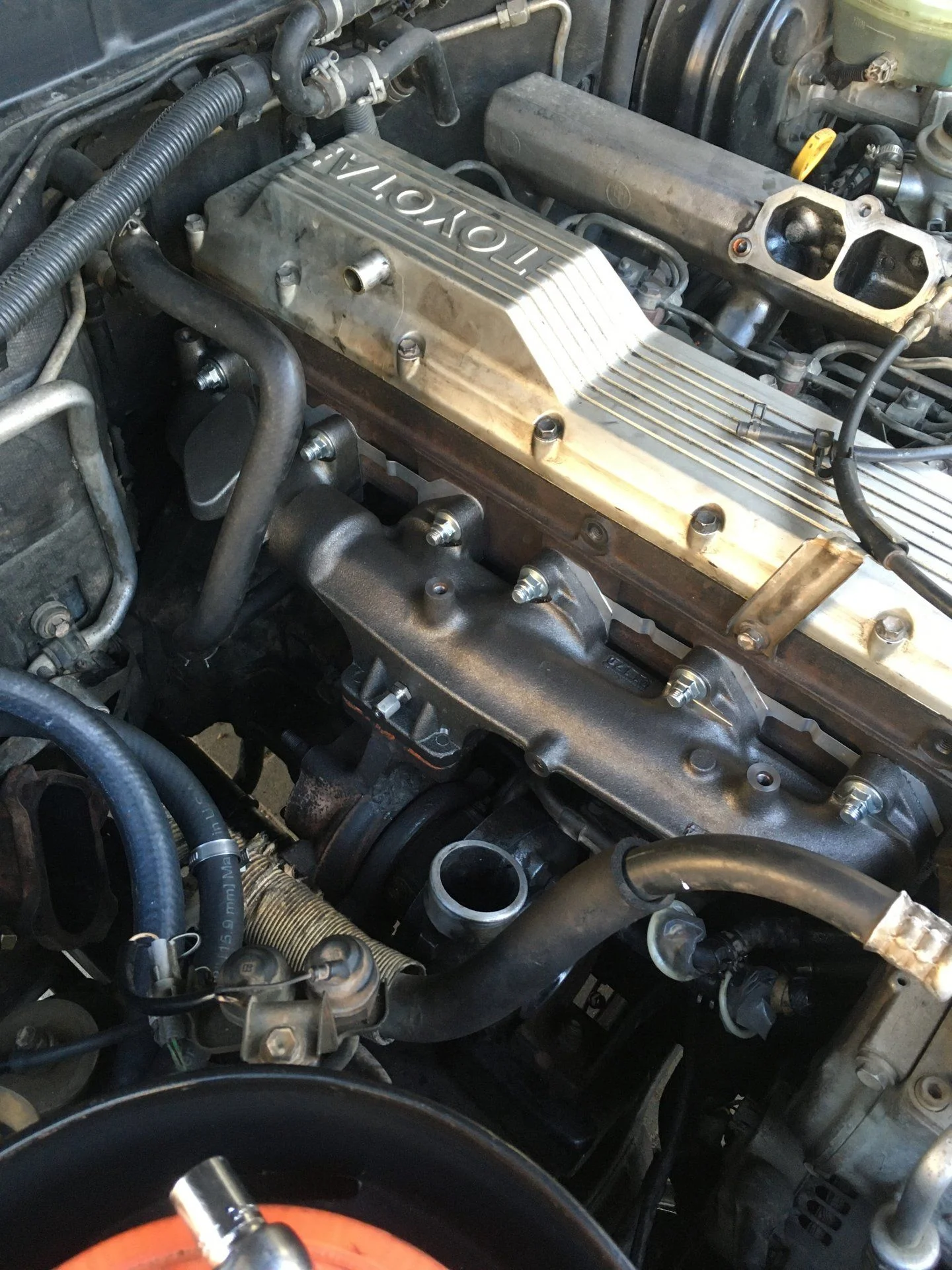

80-Series Style Icon @bryce0225 took some really nice photos of his EGT sensor install - I plan to do something like this:

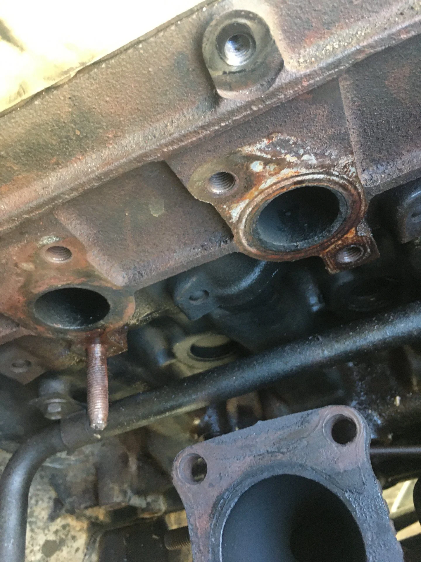

What a job this turned out to be... 😑😬🙄

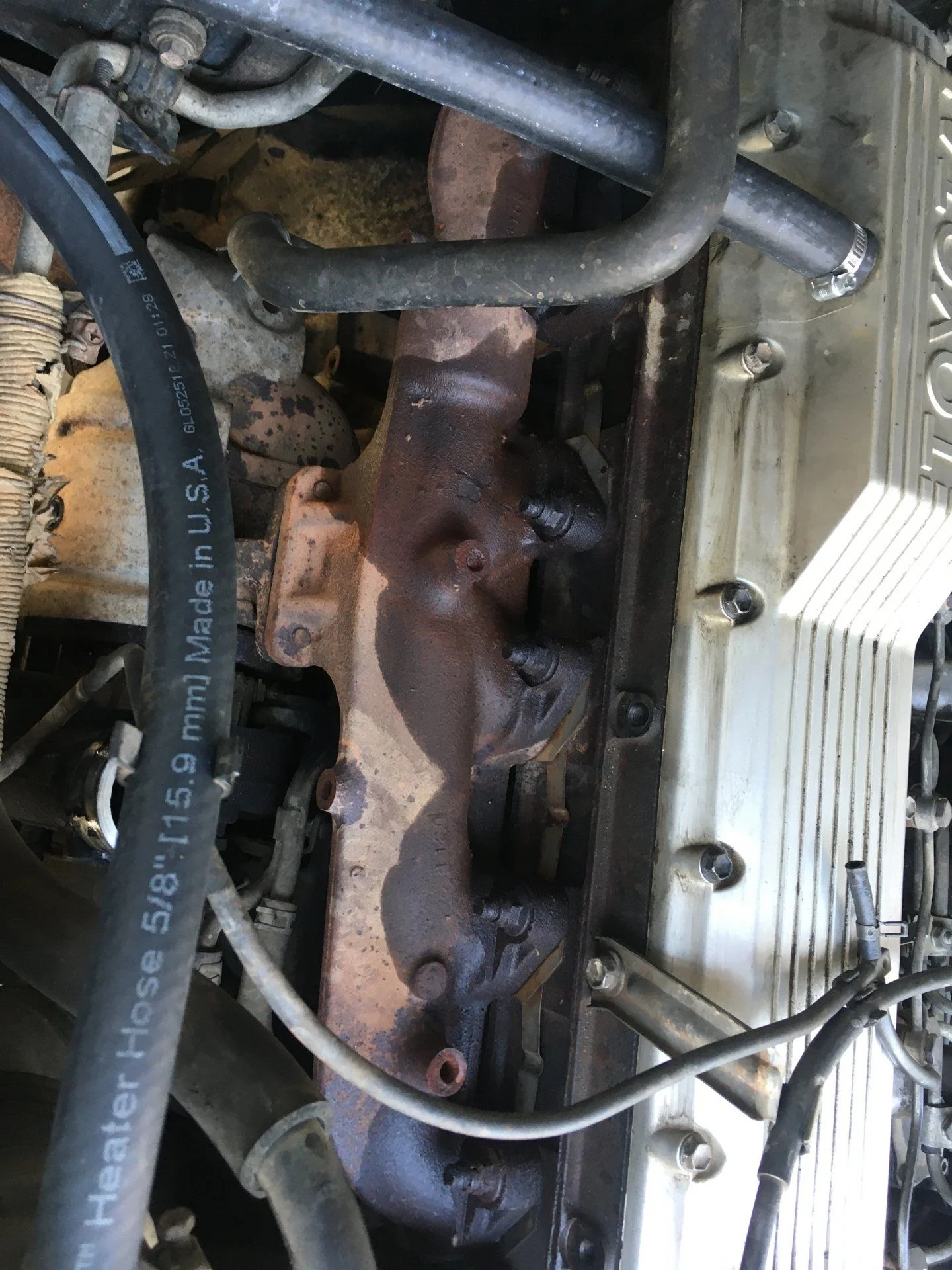

I went to instal an EGT gauge and found a crack in my exhaust manifold... I ordered new studs, gaskets, manifold... the works. Wasn’t too pricey from partsouq. I think the total was around $500.
The old:
Removing the damn things was real pain... I ended up having to take part the exaust to the Cat and removing al brackets and hoses leading to the turbo. Two studs were stuck and i could not get to them with the manifold in the way.
I tapped the new manifold and ceramic coated the heat shields.
After wiggling and forcing the old manifold off, putting the new one on was just as annoying, but bolt after bolt, i did it. I ended up having to take out all of the studs leading in the block, then fitting the manifold to the turbo, THEN adding all of the studs back into the block through the manifold. Things were not lining up if i tried the other way around.

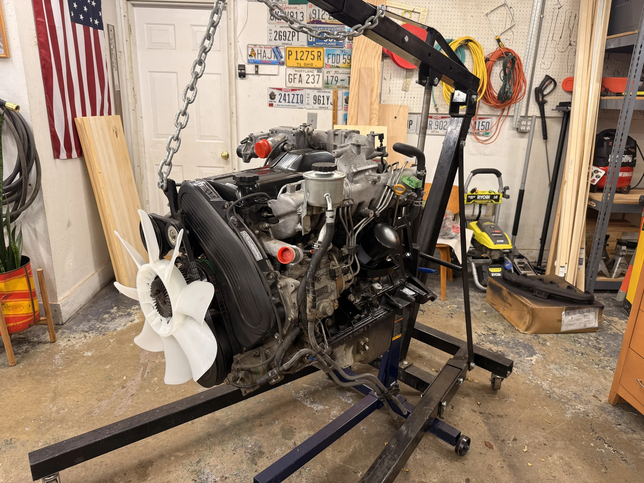

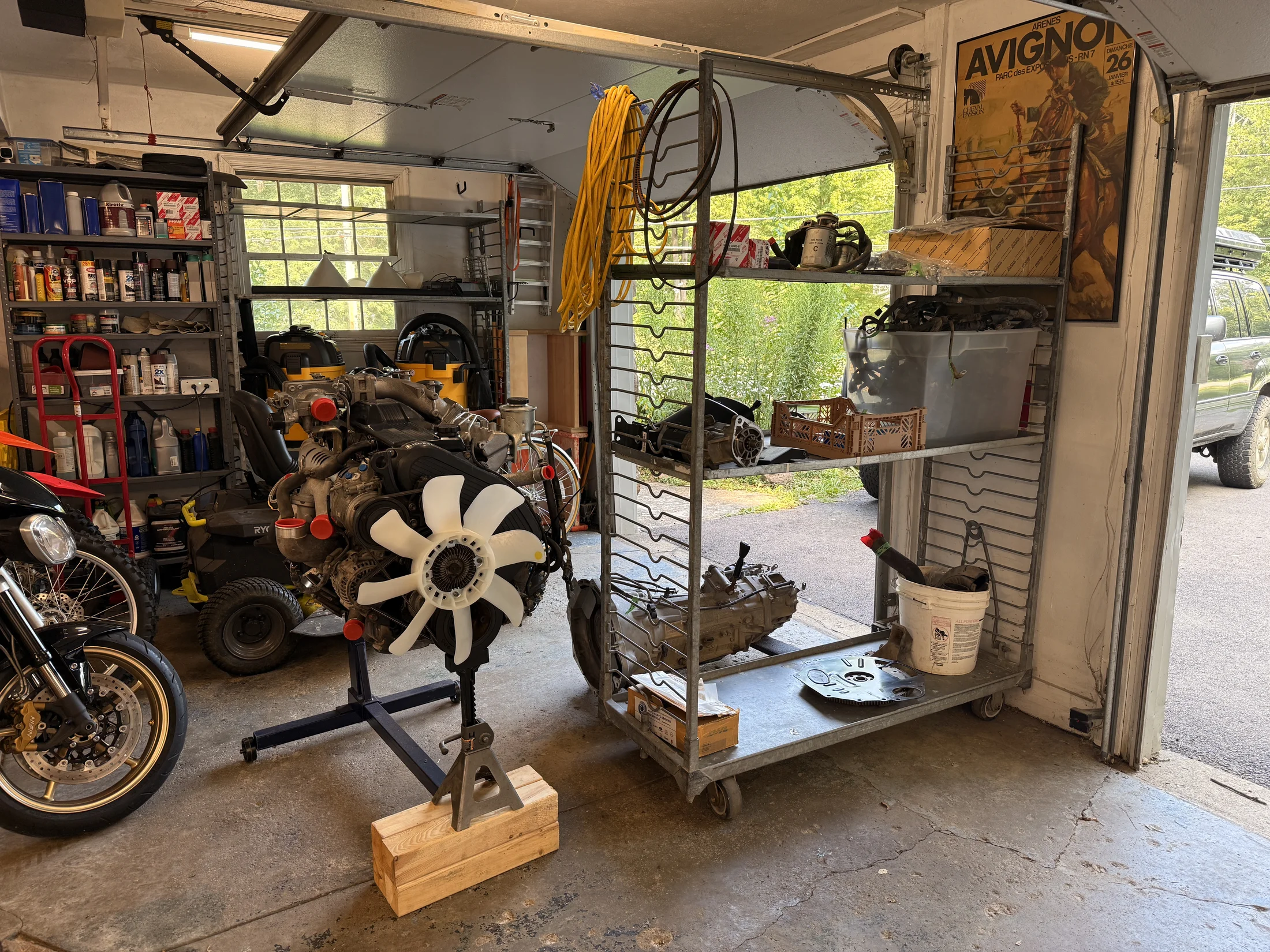

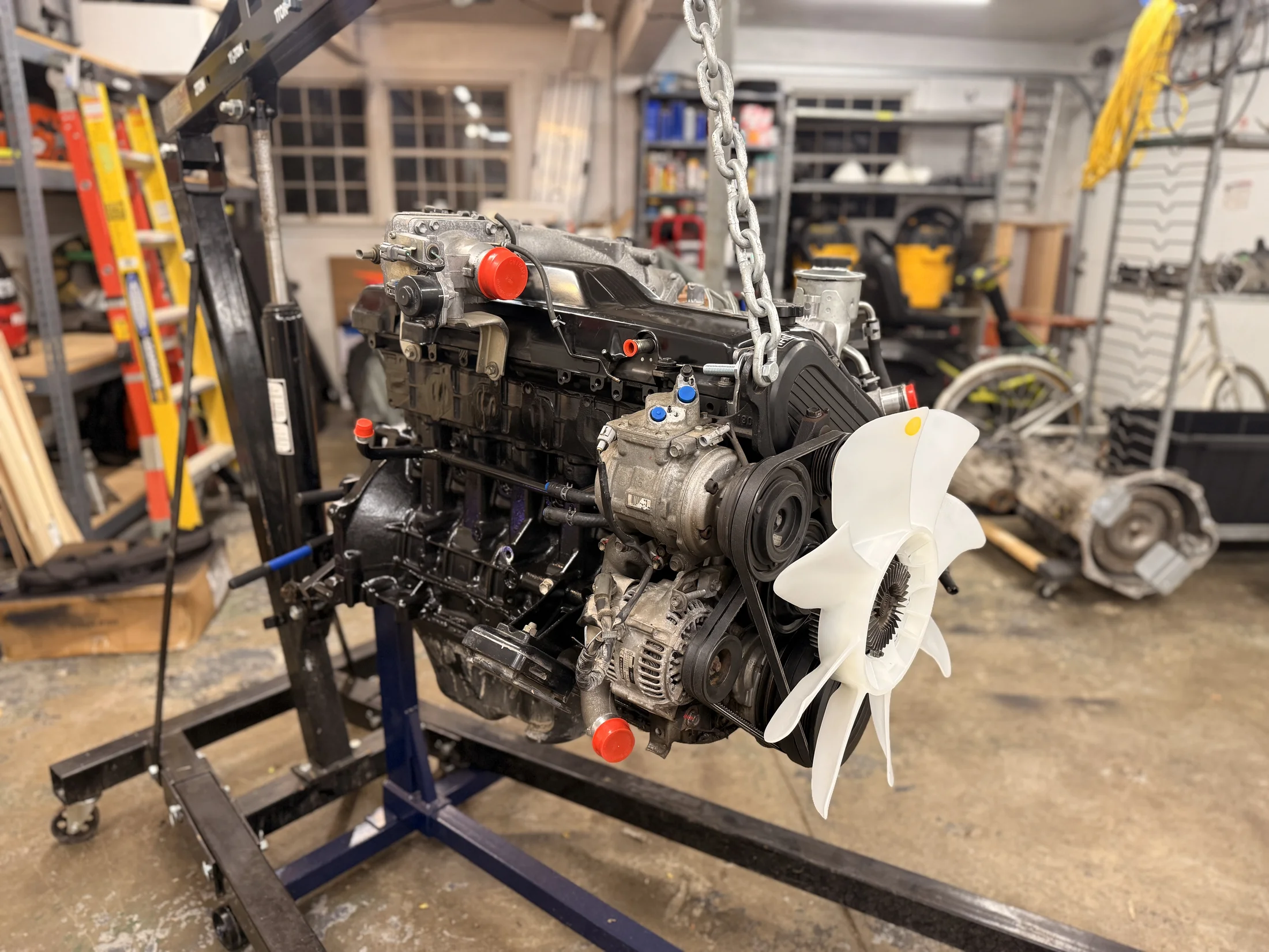

Continued cleaning up the engine and painting things. Waiting on a response for shipping quote from japan4x4 for the oil pan and pickup. Started bolting accessories back on.
Also waiting on exhaust mani + turbo studs/nuts and and some other small items to do while I had the assembly off to come in.
A few photos because it’s a pretty cool hunk of steel

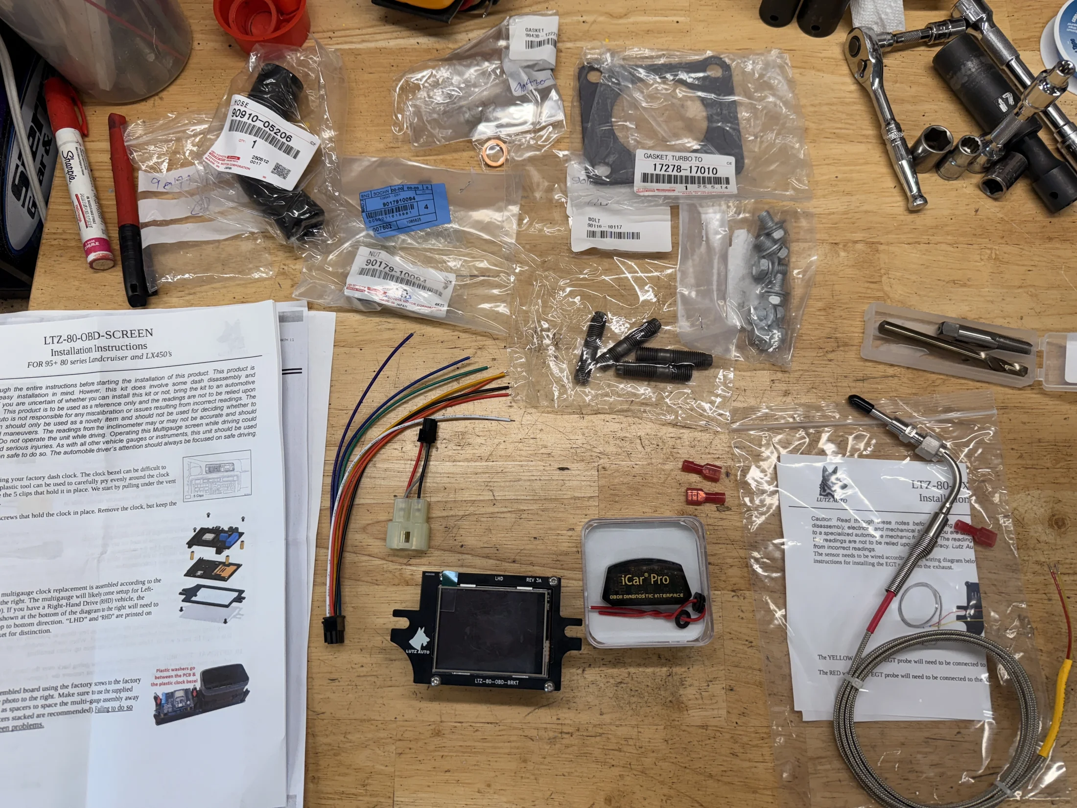

Small update - the conversation has been started with Jonathan and he’s willing to build me a harness. Stoked.
Have some parts on order from Lutz Auto, along with a 1/8-27 NPT tap for the EGT thermocouple.

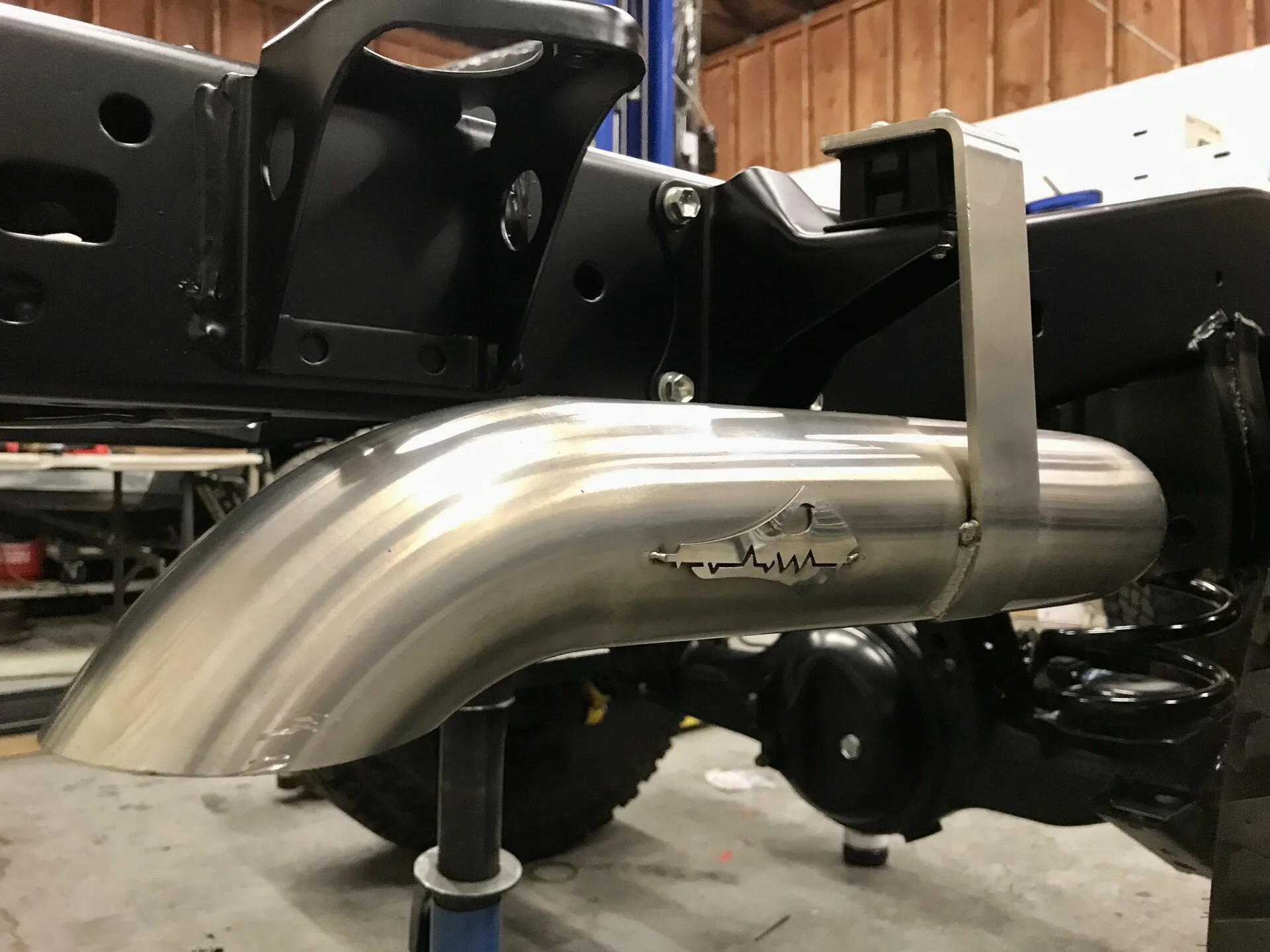

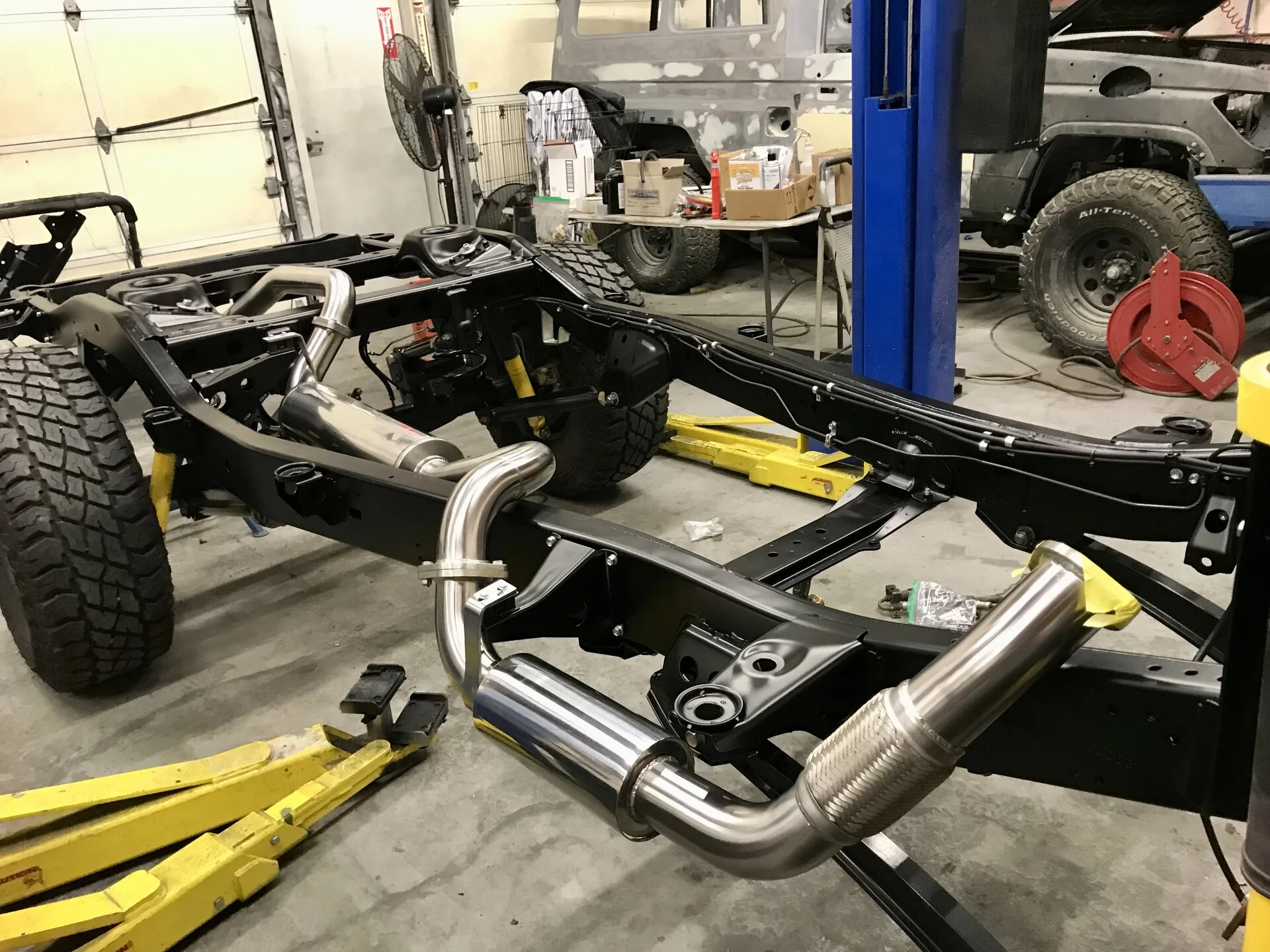

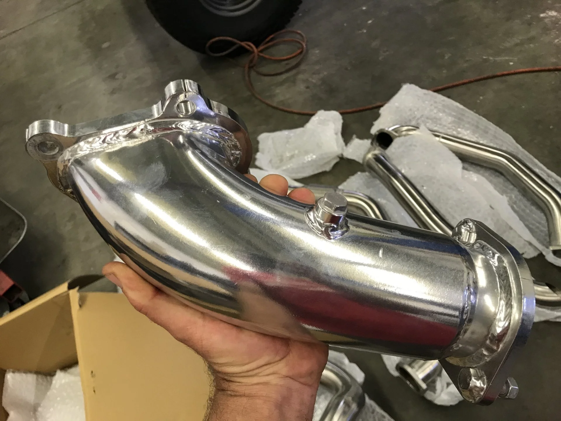

I’ve been considering exhaust options and think 3” is the route, and I believe an HDJ80 exhaust would fit routing-wise, but am unsure if it will bolt up to the “ball joint” connection on the dump pipe on the back of the FTE turbo. Anyone have any experience here?
I considered ordering a dump pipe for an HDJ100 and the rest of the exhaust for an HDJ80 - even asked this question to PPD support and they said maybe it would work.
I'm like 99% sure you can just put an 80 series/ 1HD-T or 1HD-FT exhaust on there. You would buy the full system with a new dump pipe and it should bolt on.. I think they're all CT-26.

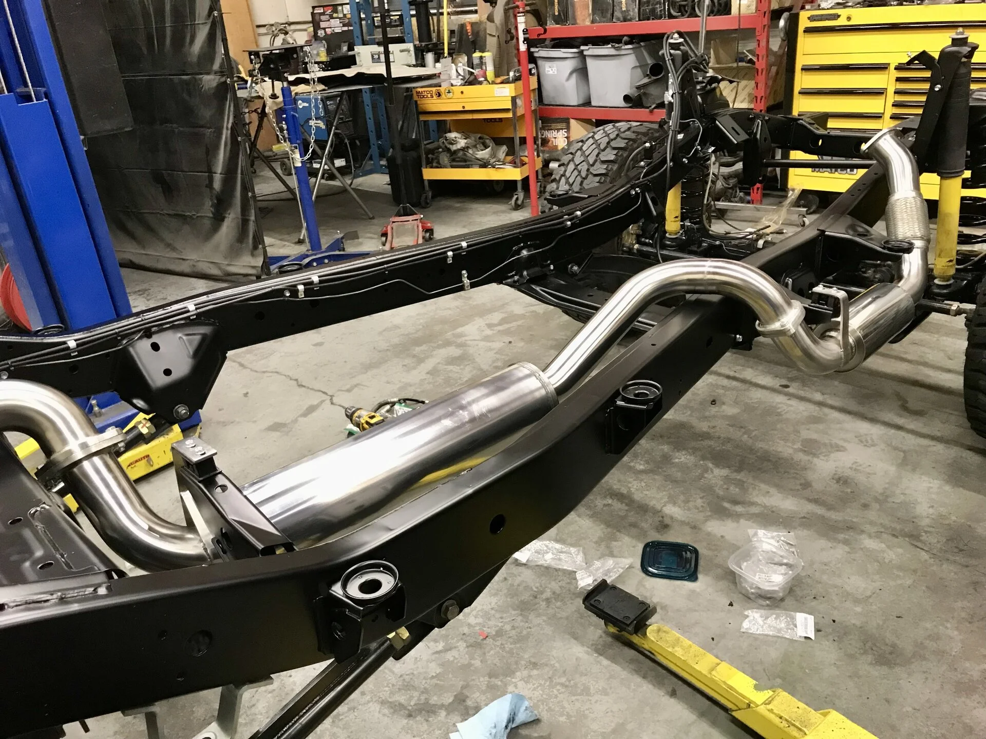

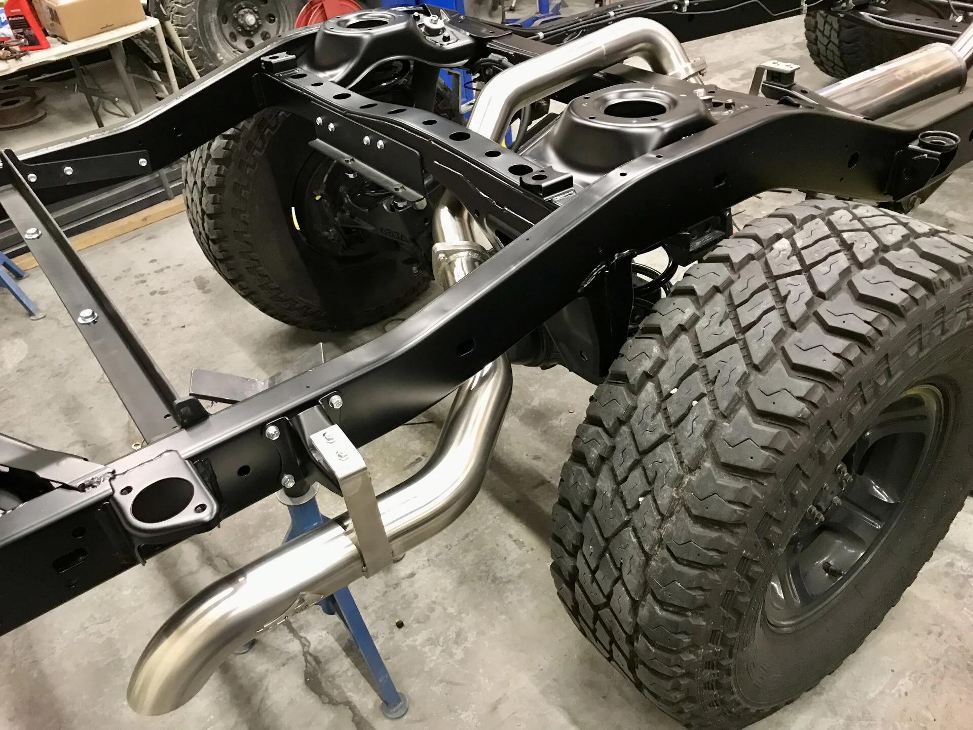

You have the option to go straight back next to the trans which is a little more difficult routing wise, but seems to be a more ideal setup. I think Manta might make one of those. Or you can go the stock route where it kicks out over the frame on the right hand side and then back inside the frame. Beaudesert, Torqit, PPD, LegendX, Redback etc.
Here's a Beaudesert going on an FTE 80 in one of SNLC's build threads
Here's a little explanation of the more direct routing:
This is a lovely bit of information! I think you're right, If they're all CT26, then the bolt patterns should be the same at the hot side dump. So then I'll need to decide whether to go inside the frame vs outside. Looks like there are some nice options out there. That Beaudesert system in polished SS is beautiful.

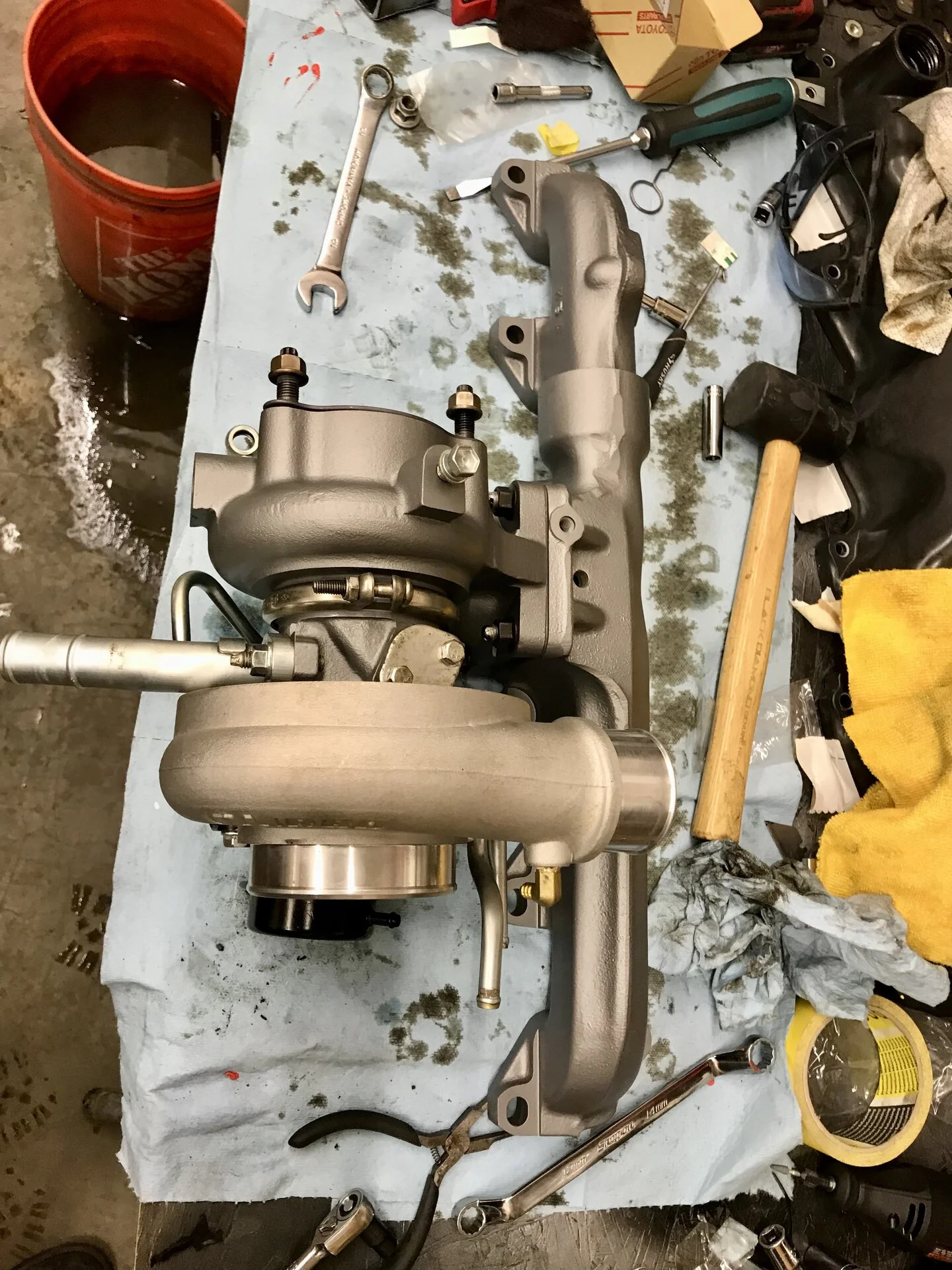

New parts on deck! Will do some drilling/tapping for the EGT thermocouple, then get the whole 45 lb mani/turbo assembly back on.
Fully torqued. Got a little loose with my guess on where to cut the heat shield for the EGT probe, but it works for now.
For the probe, I set the depth to the center of the flow, made a mark, and took it out to install. If i ever need to remove it, I'll mark it again so I know the depth it needs to go back to.
The sensor connection recommended tightening to finger tight, then 3/4 turn more so as not to crush the housing.

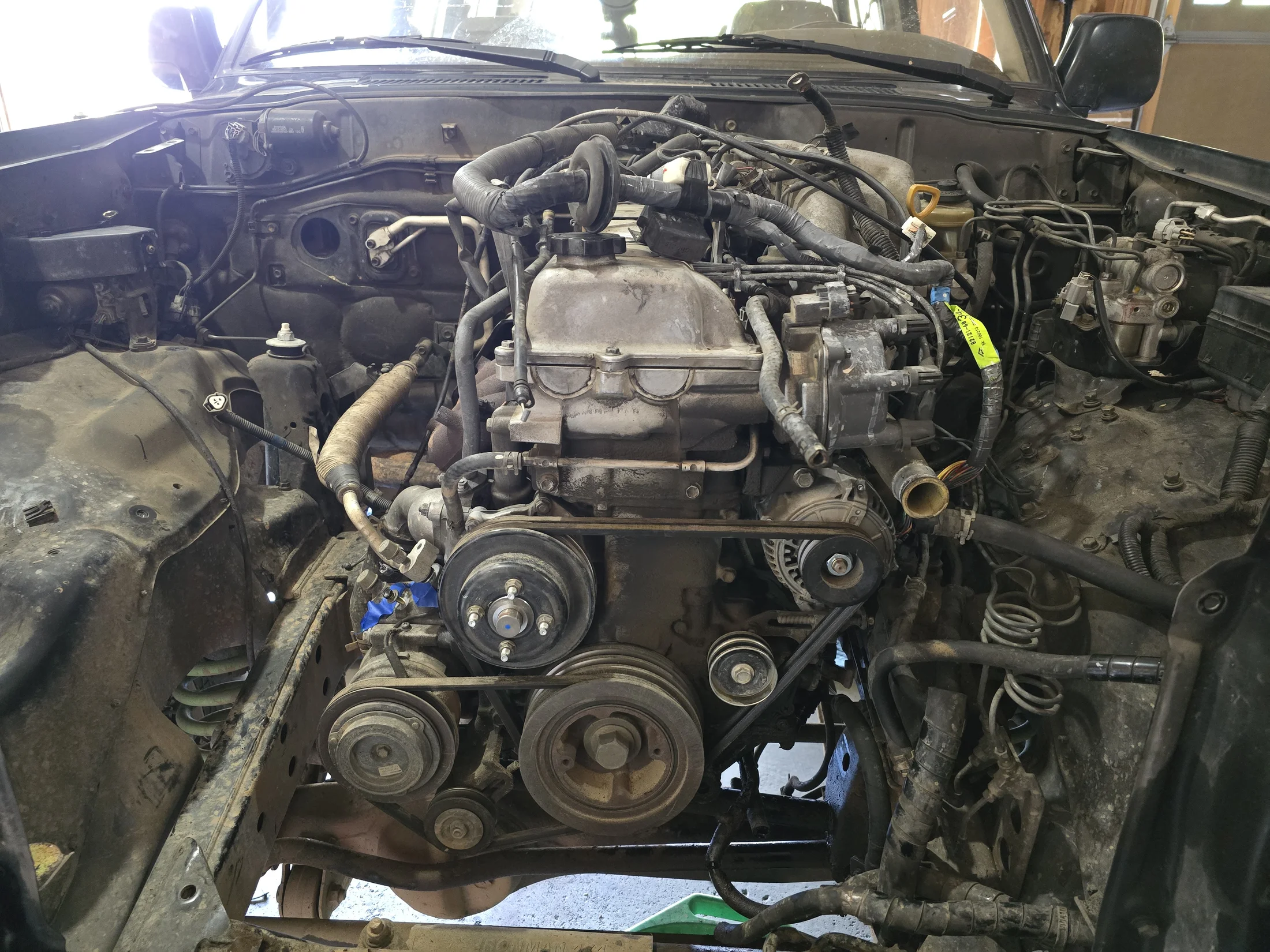

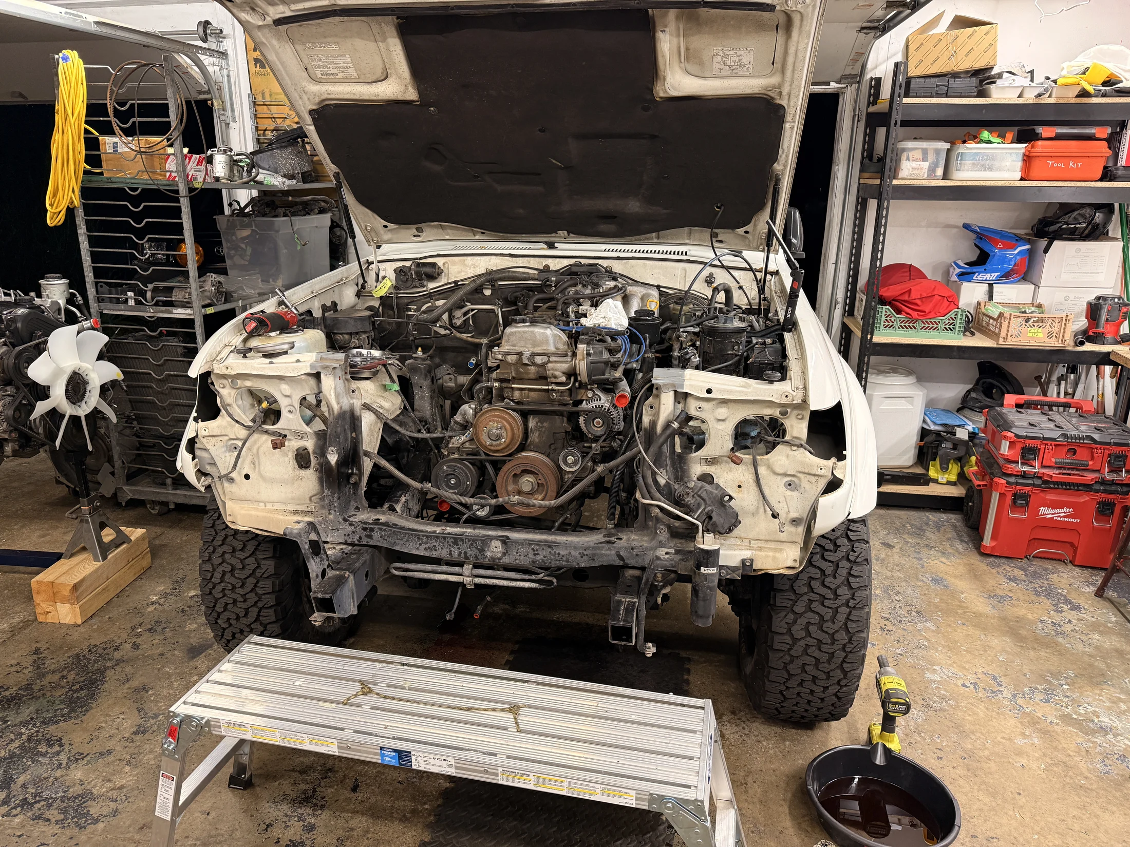

My humble 2 car garage is really getting worked lately. I need to ship my 1FZ engine harness out, and to get to it, I figured best path was to just start pulling the 1FZ, since it needs to find another home anyways. Pulled the whole front clip, labeled and organized parts onto a cart. Pulled the exhaust - all bolts came out with no fuss, I couldn’t believe it. Pulled driveshafts, and started removing the harness.
Likely the last time I see the mighty 1FZ run, thank you 1FZ for your service. 🫡
If anyone is in the market for a nice 1FZ, I am here. Will clean it up and post in the classifieds.
I’ve been wrestling with getting to the parts of the harness under the throttle body - got to those after pulling the throttle body, and am still wrestling with reaching the harness connections below the intake mani. I had the thought - why not just disconnect the engine harness from the body, and remove the harness, eng, and trans all together, then remove the rest of the harness. Anyone have experience here?
1HZ oil pan, pickup, and gasket will be here tomorrow from Japan4x4. I was considering the difference between the FTE 100 series oil pan and 1HZ oil pan and my lizard brain is thinking maybe I need to get the 1HZ dipstick/tube also. My thought was that I’d hate to not be adding/checking against the correct oil volume because I made a mistake with the wrong dipstick. Any input here would be helpful also.
For the engine harness, unplug at ECU, pull the connectors through the firewall, drape over the engine, there are a connectors from the body harness you do need to disconnect. If i recall there is 2-3 around the AC compressor, 2-3 at the starter, and maybe a few sensor wires.
Ill take some pics of the service manual in the morning. Following it made it super easy, there are a lot of engine and trans connectors you won't be able to reach while its in the cruiser.
This is exactly what I was thinking! Thanks for the confirmation.
