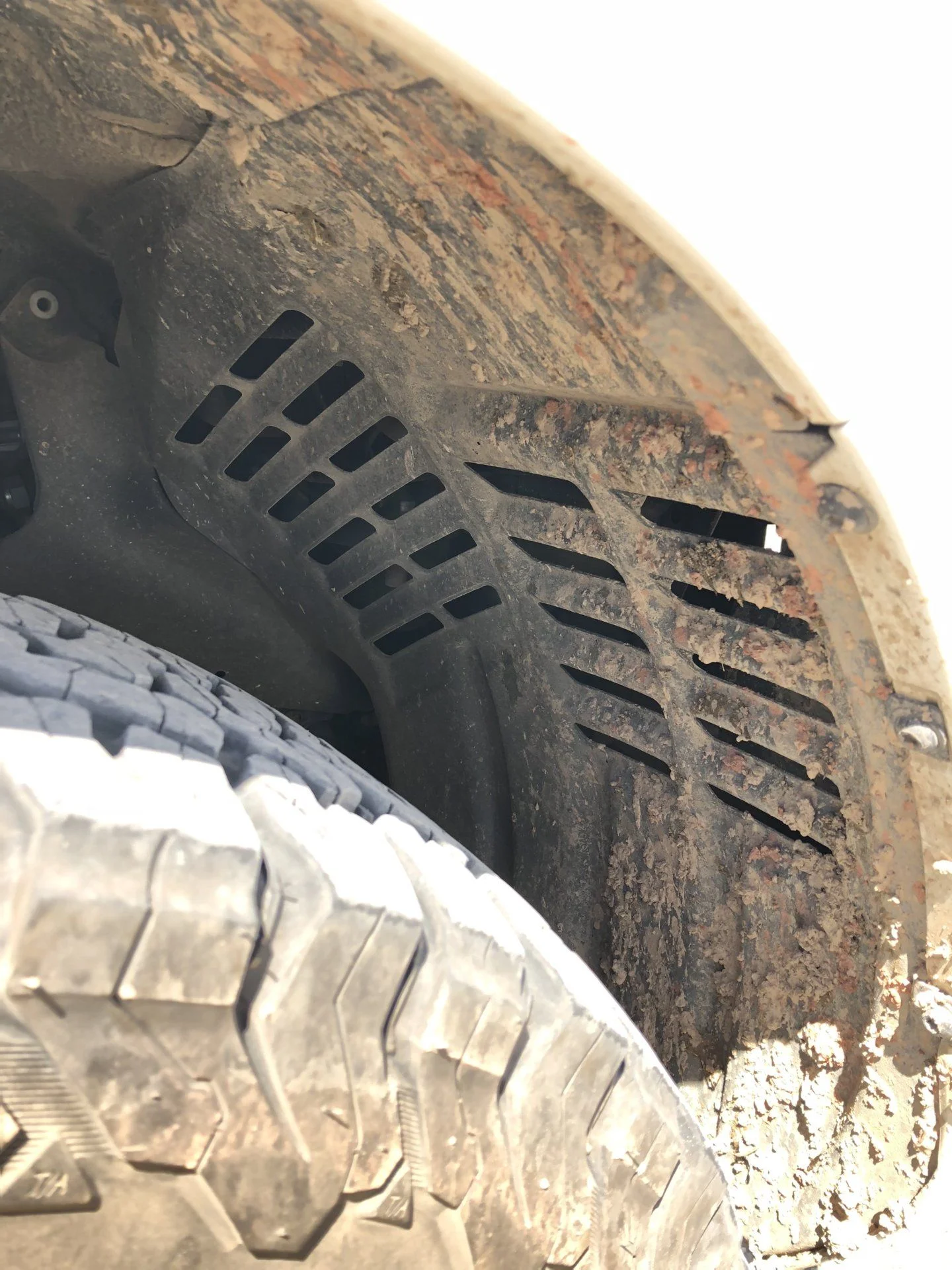

Here is the area where the panel is missing under the right front wheel well. This is on the upper, front portion of the wheel well. Without the panel you can clearly see the some exposed vents or something.

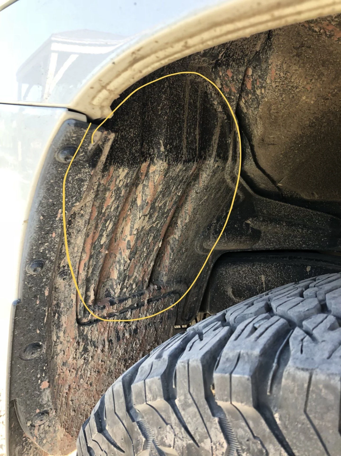

And here is the missing plastic panel from the left rear wheel well. This picture is of the upper rear portion of the wheel well.

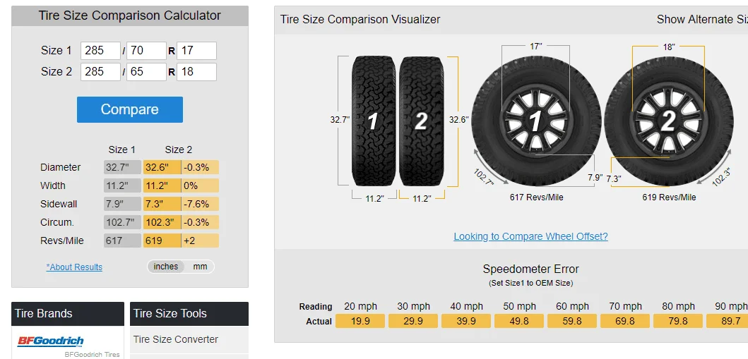

285/65 R18 KO2s? I’ve had them for nearly 2 years with no issues. Plenty of others seem to be running with these. Could it also be because of my lift? Cloud this happen from bouncing it too hard? I don’t remember anything sounding like it came off.

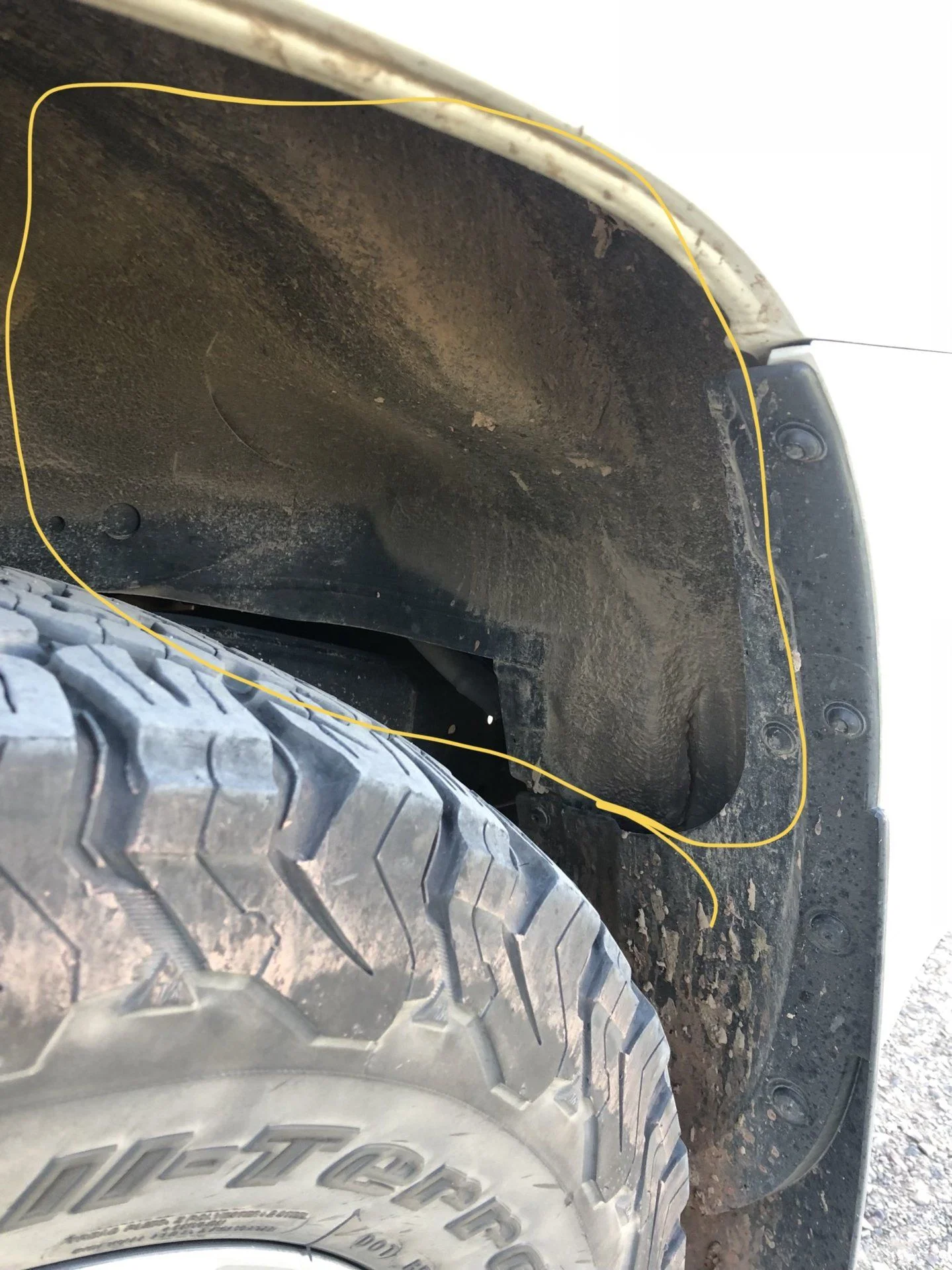

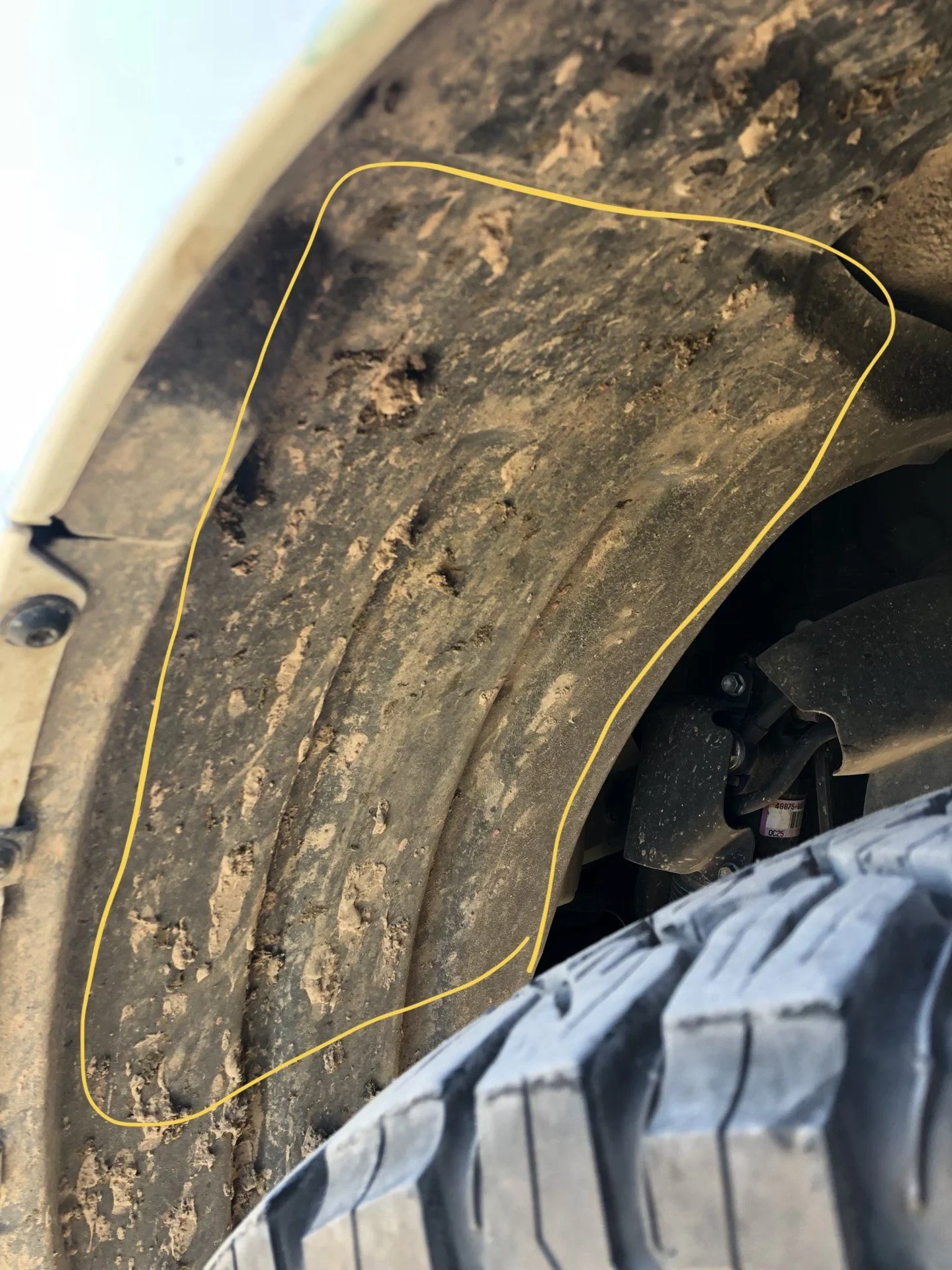

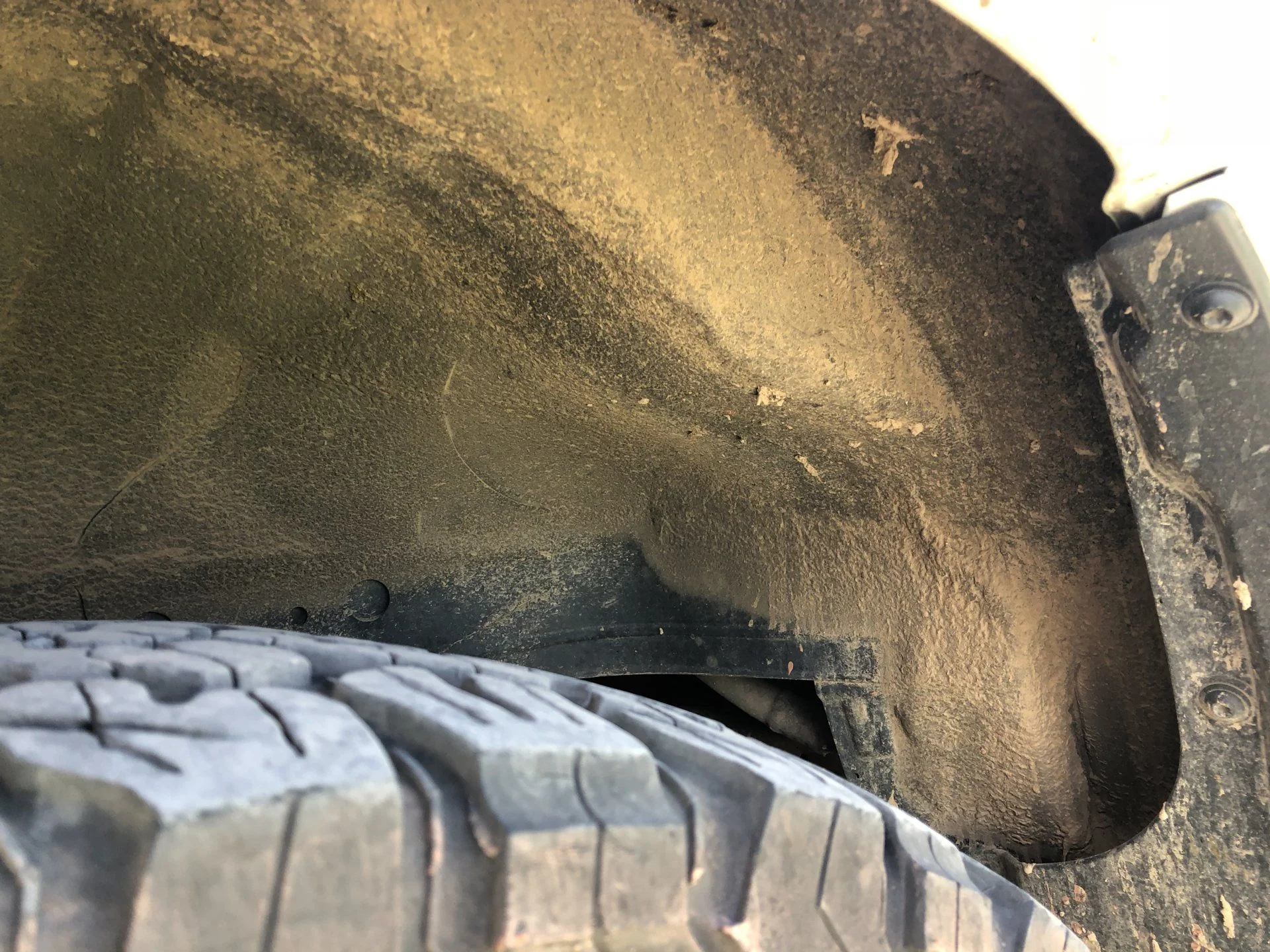

If they are supposed to be “the same”, mine aren’t. So here are side by side pics:
Front Left. This is the one I assume is correct.
Front Right. Vents on this side but not on the other?
Rear Right (the one I assume is “OK”)
Rear Left. Looks very different than rear right.

Everything is correct Dan. The fender wells are not symmetrical and you're not missing anything. That's how all 200s are.
There is a pump thing behind the front passenger side vents that needs those vents for heat reasons. There is the fuel fill neck that needs to be accessed behind the rear passenger side panels. The 200 is an expensive, purpose built vehicle. Toyota designs it to exactly what it needs, and only where it needs it. Unlike cheaper vehicles that make more universal and symmetrical parts in an effort to reduce build costs.
