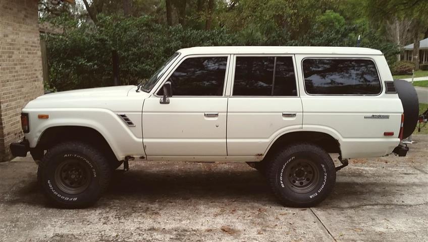

Made a little more progress...
Got the windows tinted. I didn't want anything dark, just some sun / UV protection. Chose a 40% 'carbon' tint.
Good friend of mine does window tinting and vinyl wraps (Mike Body (@iconwrapz) • Instagram photos and videos)...
This crappy pic doesn't do it justice - It's far lighter than what it appears to be here:
Close-up pic:
Window tint is a must here in Florida, so I'm happy that it's done (and it should help save the interior a little, too!).

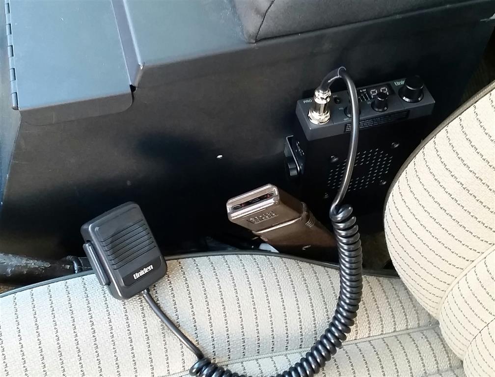

Also got my CB installed, and it's working great (Uniden 510XL / Firestick mount + HD spring + Firestick 4' antenna). Installed it on the drivers side of my locking center console, towards the rear (so I don't hit it when I buckle the seatbelt).
Ran the coax under the console and then down through the rubber body plug that's under the passenger seat. It then runs along the frame (with the fuel lines) and to the pass. side rear of the rear bumper.

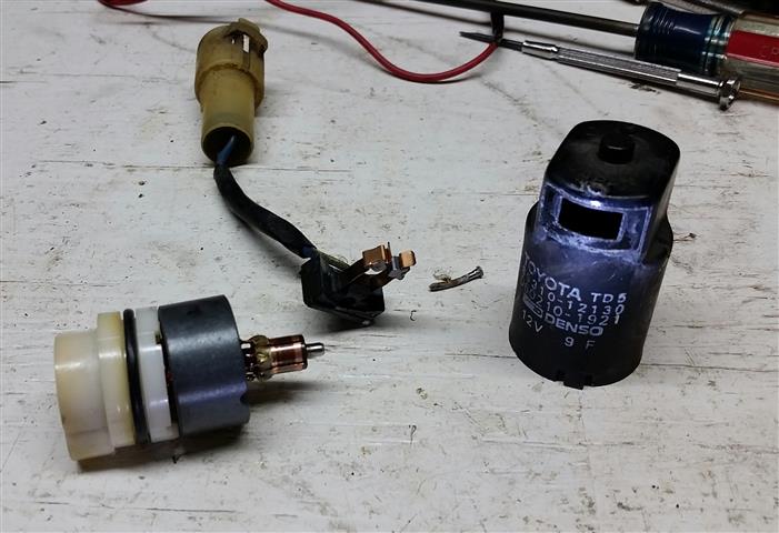

Last night, I decided it would be best to have working windshield washer / squirters. My reservoir holds water, but it does not spray.
I pulled the pump, and hooked it straight to the battery...and nothing. I assumed it was frozen / seized (water intrusion?), so I pulled it apart to investigate. Seems like everything on these trucks is serviceable anyway!
It's just 3 metal tabs that can be pried back, and that lets you pull the motor out of the housing -->
My motor looked pristine inside...
You can see the tabs better here:
...as well as the gears that provide the fluid pressure. Mine were corroded, but with a little work...they free'd up, and I could spin the motor! I believe the ~7 years this truck spent sitting in a garage with boxes stacked on it allowed things like these gears, the rear door lock, etc...all to sit and corrode. I've been able to pull lots of things apart, clean 'em up, and they work good as new.
Anyway, the trick to reassembling is to get the motor back in the housing, THEN put the electrical leads back on the other end of the motor. Look closely at the first pic above, and you can see the spring loaded tabs that contact the tail end of the motor to provide the "juice".
The electrical connector is held in place by a small pin that you can drive out from the inside:
Pull that pin, and the connector pops right out.
Here are all the parts:
To complete the reassembly - Slide the motor/gear assembly back into the housing, pop the electrical leads back in place, reinsert the retaining pin, and VOILA!...working windshield squirters.

I didn't post a pic of my CB install - Nothing much to report, other than it's in and working well -->
(the location is actually really convenient)

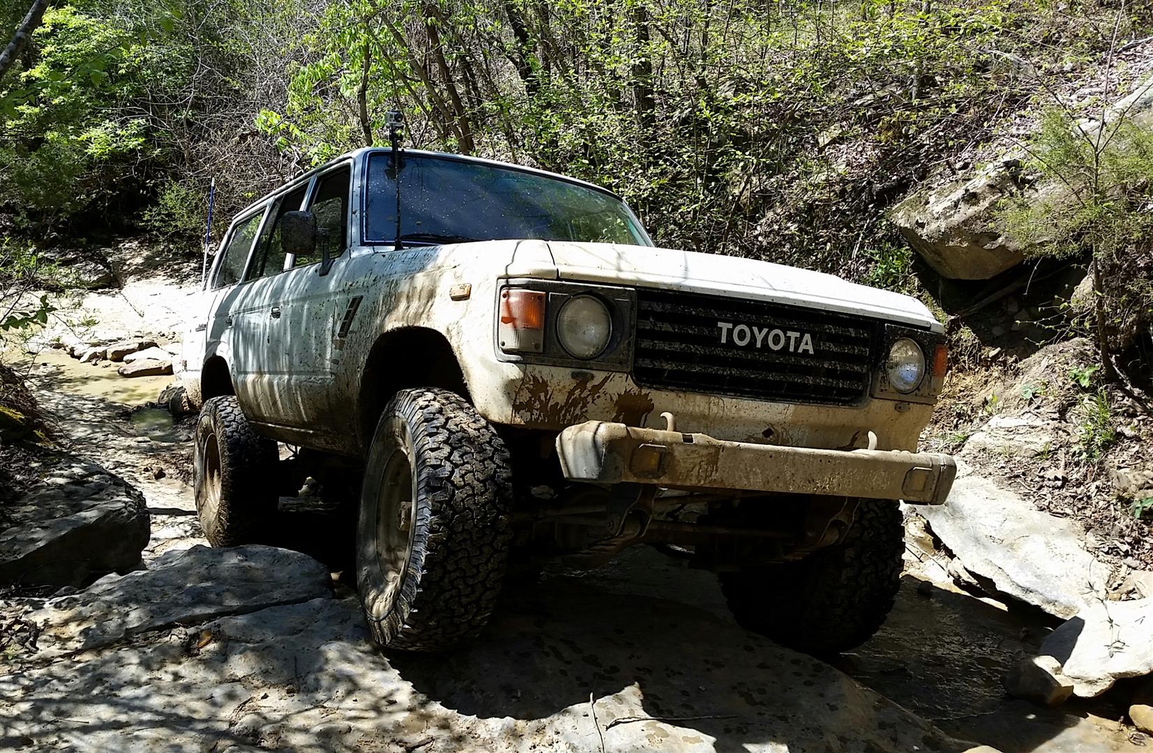

As promised, action pics:
This ledge wasn't too big...but it leaned the truck enough to the drivers side to flood the engine (stupid F'ing Edelbrock carb!)
I thought I was going to have stalling problems on downhill sections (as I did when I was at Hard Rock in Ocala)...but it was the opposite. Anything that was really off camber, or really steep uphill...the fuel dumped from the bowls, and flooded the engine. Couldn't restart until I was on level ground (and then had to floor it and burn off all the fuel that dumped in...rinse and repeat).
But other than that, the truck did great. Had to really romp up some steep stuff (going way too fast for conditions) to keep the engine from flooding/stalling...and it took the beatings like a champ!
Mardi Krawl was a great event...the weather was damn near perfect...and my friends and brothers made wheeling all weekend just awesome.

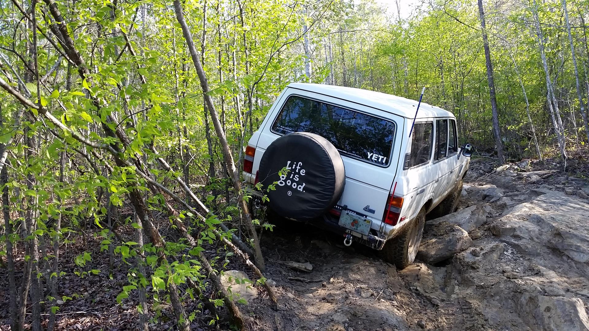

Got here by the motor stumbling and dying. I was off to the right, but it stalled...I got it to restart, hammered on it, and slipped a little to the left. Started, spun, died, slipped left. Etc, etc..
Had to get winched out of the hole the pass. front got in to. Here's where I discovered the drivers side motor mount pulled through the bottom of the frame bracket - Motor was hitting the hood any time I applied power!
Fixed it later that night....no harm, sans a small dent on the underhood bracing.
