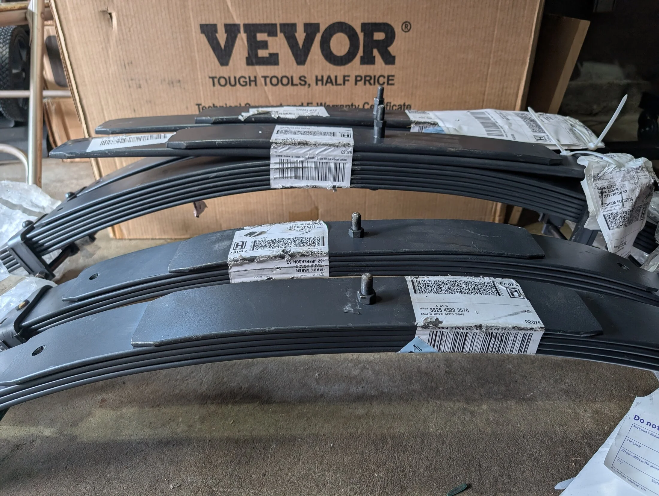

I received all of my parts for the 2" lift but I'm a bit nervous to start the project. I'm concerned about a stinkbug stance which I'm not a fan of and looking for a nice level profile. I order the 2" Lifted Leaf Spring CS003F (Stock/Light Load) for the front and 2" Lifted Leaf Spring CS017RB (Stock/Light Load).
I basically just order what was on CruiserCorps website to save moneya nd do it myself. But when I got the leafs tehre is a three inch differnce between springs.
1. Is this normal?
2. Will this result in a stinkbug stance?
3. Should I remove a leaf or two in the rears springs?
4. Should I buy a different set of springs for the rears to achieve the level stance?
Any advice or insight would be great appreciated.
OME has manufactured countless spring packs for the FJ60 over the decades. They definitely know what they are doing.
Install the new springs and take the vehicle - loaded down over lots of big bumps to exercise & break them in.
If a vehicle sits perfectly level when unloaded, its going to have a rear end sag once you put any weight in it.
Thank you! I'll install as is and let it break in.
