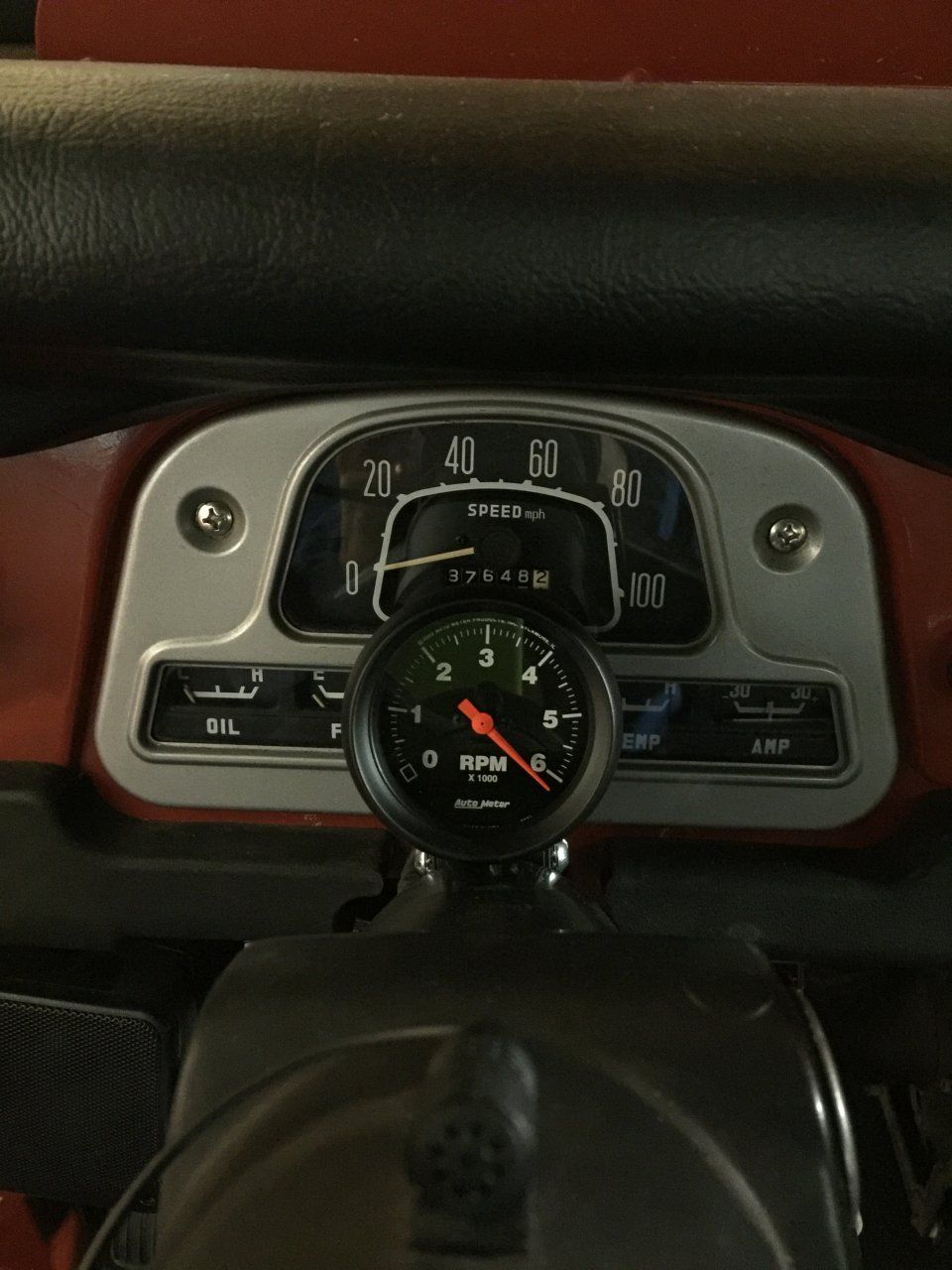

Here's mine - it is small and only goes to 6K! I have since relocated it to the side as well, didn't like that it blocked some of the gauges/high beam indicator.
Here is the link to the product on Auto Meter's site: 2-5/8" PEDESTAL TACHOMETER, 0-6,000 RPM, Z-SERIES.
They also make a 4K version too! 2-5/8" PEDESTAL TACHOMETER, 0-4,000 RPM, Z-SERIES
