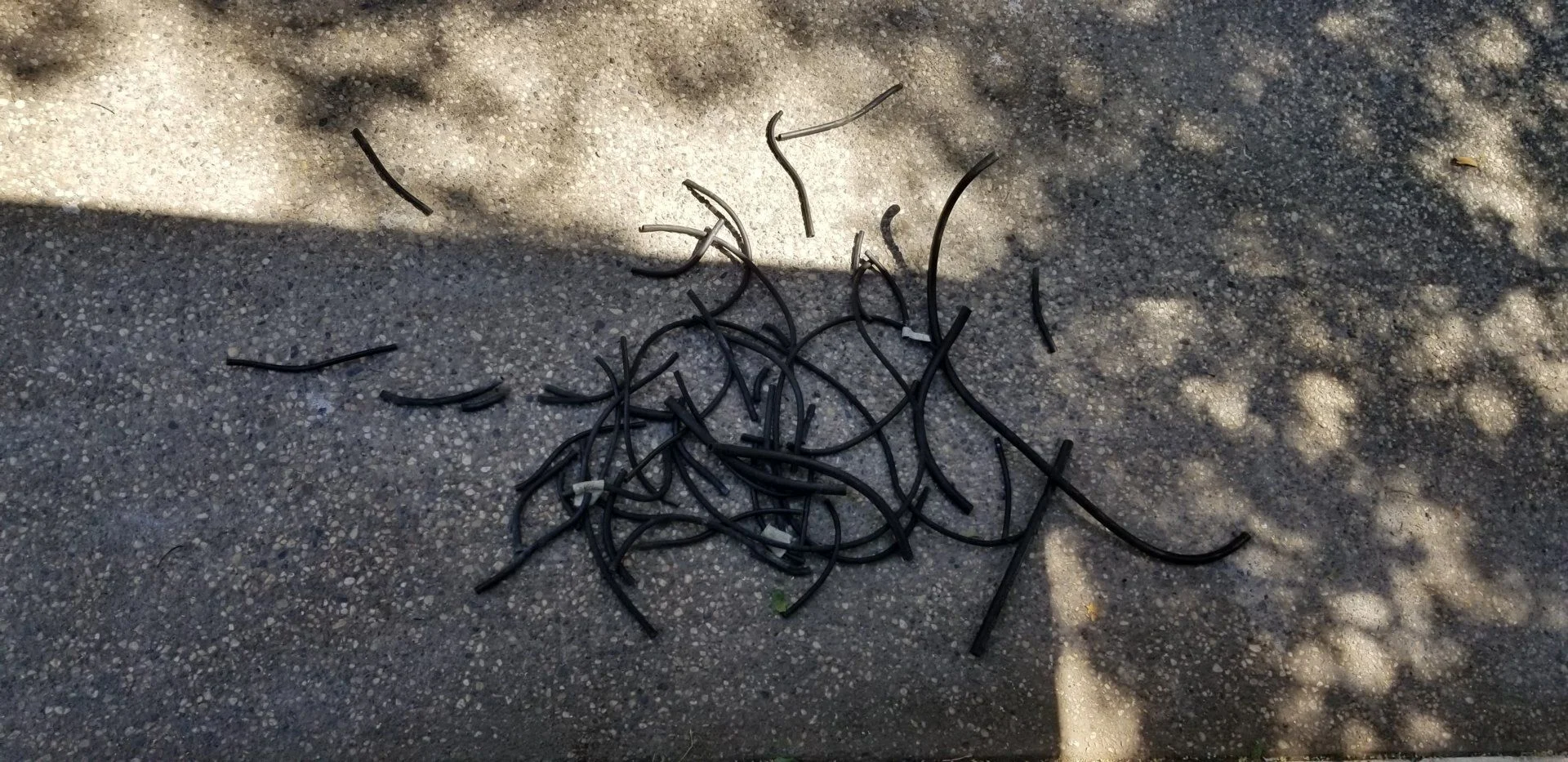

So I finally got my silicon vacuum hose in the mail this week, and spent time ripping out old hose.

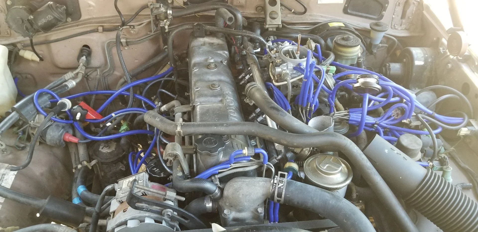

All new silicone hose:
Alas, this did not fix my issue:

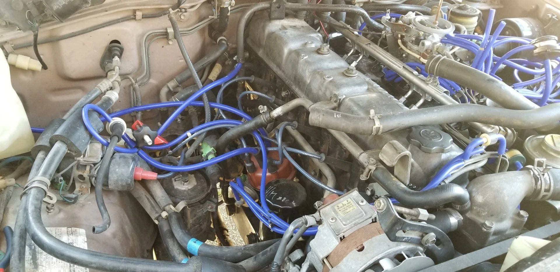

It could be the angle but I see a couple hoses routed wrong. I don’t know if correcting them will fix your problem but they should be fixed.
Edit: it’s just the angle

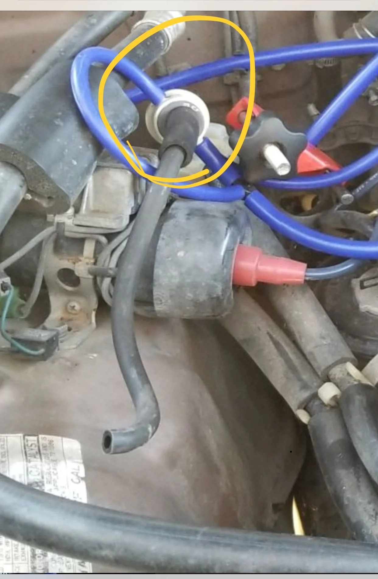

This vcv and the other one on the driver’s side go bad and can be vacuum leaks. Test it per he FSM. If it’s bad it will only account for a small leak but everything adds up.
See the valve circled in yellow.

Also, do you have to be smogged cuz all that hose is insane. I’m out after really zooming in. Holy cluster fawk!
My truck runs so much better, faster, more power, quicker, and best of all I don’t have to look at the spaghetti nonsense anymore. If you can get rid of it, you’ll be very happy.
