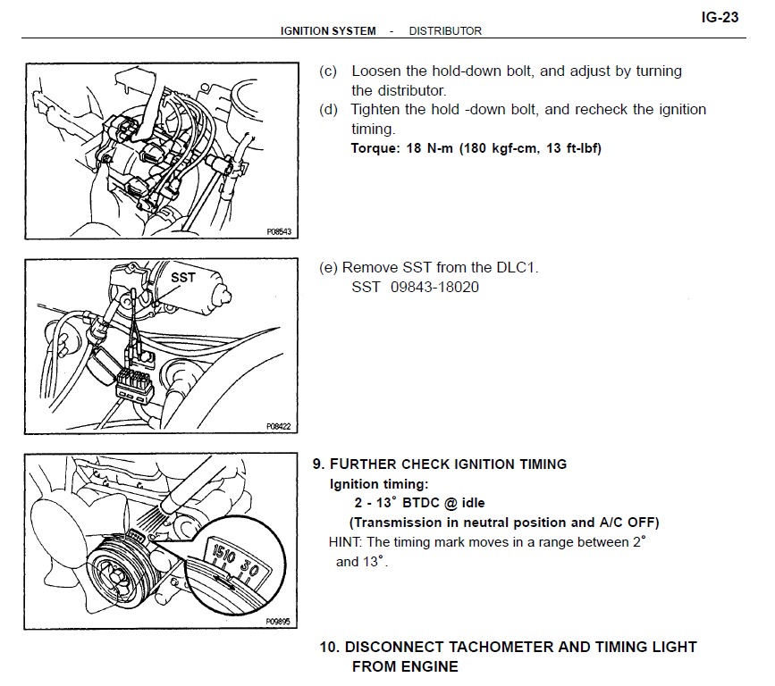

just noticed the FSM also says to connect a Tachometer... do I really need to do this just to read and set ignition timing?
Anyone know whether there's a way I can test the original ECU while it's out of the vehicle? I'm wondering why he replaced it. Maybe the 2nd hand one that went in isn't operating 100% either, despite no error codes. etc. I'm still fixated on why I'm not getting different timing values between diagnostic and normal modes.

Swapped the ecu over today with the other one dad had lying around (the original)..and it made no difference. I rechecked timing and it's still the same whether in diagnostic or normal Mode and jumps around in both modes when I rev the vehicle. I think I'm just about out of ideas here. The next step would be to take it to an auto electrician to start diagnostics. Car is still running like crap, very rich and gutless...has about 50% the power it should.
