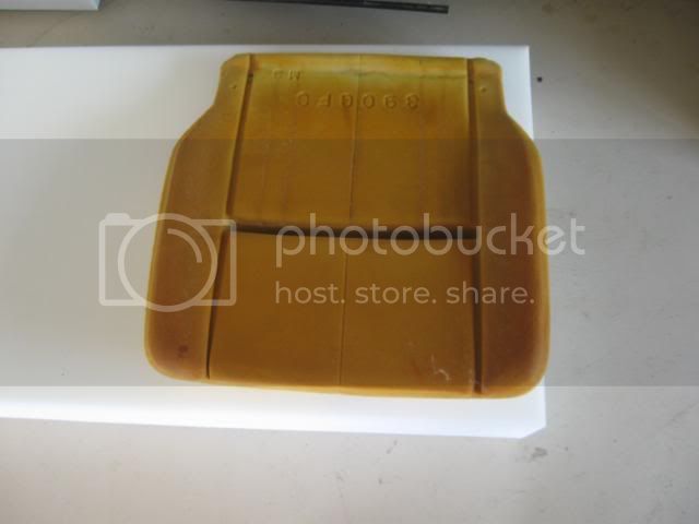

Here's what the sheet of foam looked like:

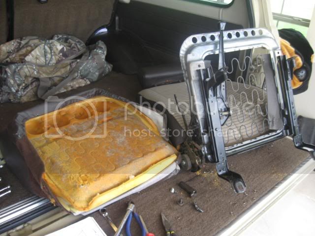

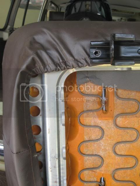

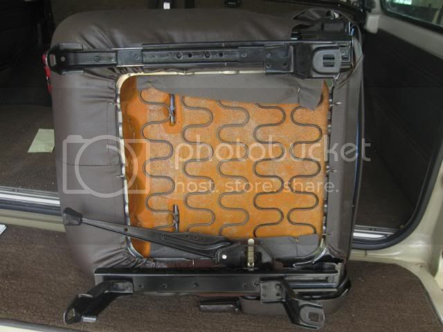

The first step in this process was to remove the old seat foam.

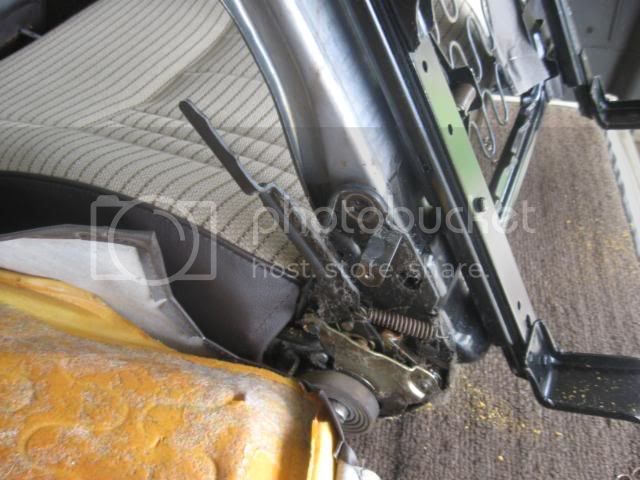

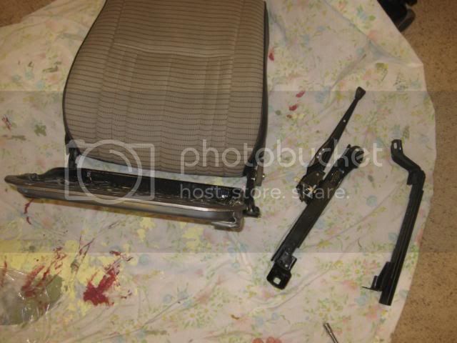

1. Remove the seat from the 4 brackets on the floor.
2. Remove the sliding portion of the brackets- the are 2 bolts on each one, accessed from underneath.

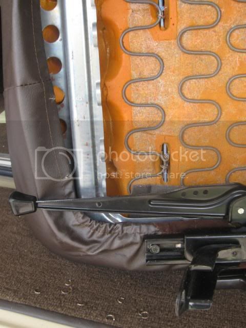

3. Remove the plastic cover over the reclining handle. Use a Phillips screwdriver. The handle slides off.
4. There are 2 or 3 bolts that go through the seat bottom cover that need to be removed.

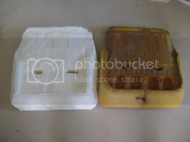

5. Using sharp wire cutters, cut and remove the hog rings. There are 2 connected to a depression in the middle of the seat.
6. The cover and foam should slip off.
If you're smart and you ordered the SOR seat bottom foam, place it on the seat, put the cover over it, use the hog rings to secure it to the seat, and install in the reverse order of disassembly. Then spend the rest of the day wheelin.

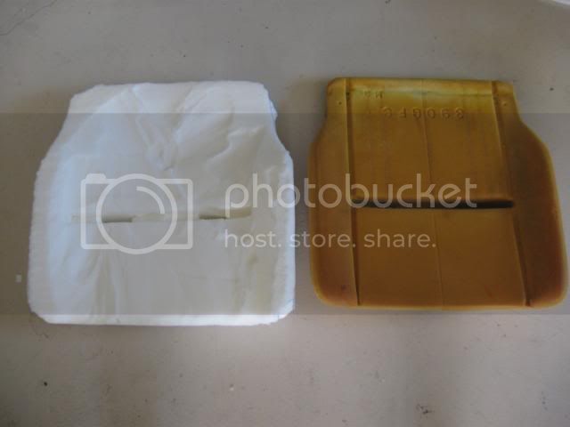

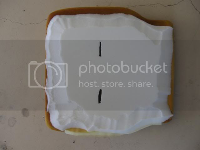

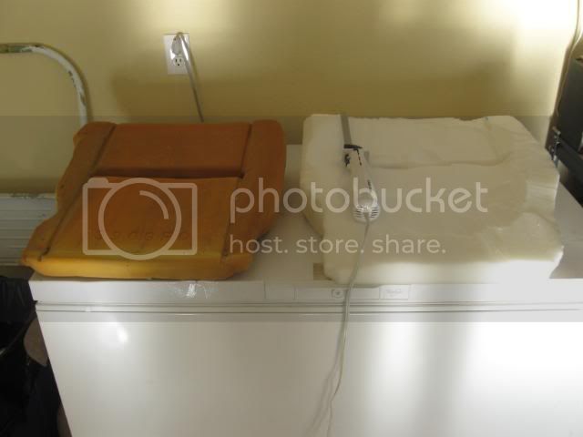

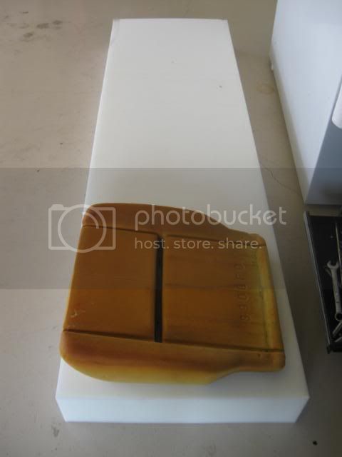

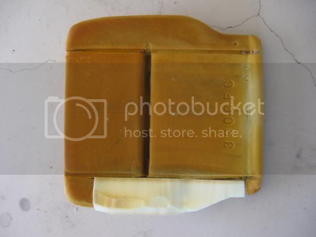

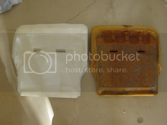

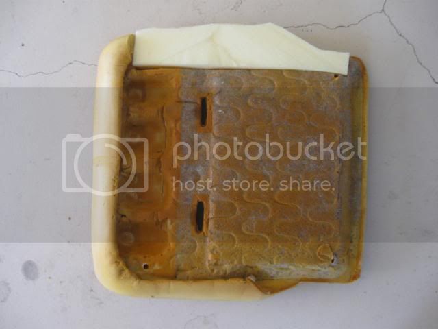

If you decide against this, the cut out some foam. I placed the old foam next to the new foam, traced the general dimensions, and then cut it with the knife. Go slow and do small sections at a time.
This foam is soft and has very good cushion and bounce. If you want a firmer seat, get the 50 pound superfoam. The 50 pound foam is easier to cut with the electric knife as well.
The minimum size to order for one seat bottom would be 24x24x6 inches, but I wanted a little extra to allow for errors.
The factory foam has a wire that runs inside it for extra support. I did not try to replicate that.

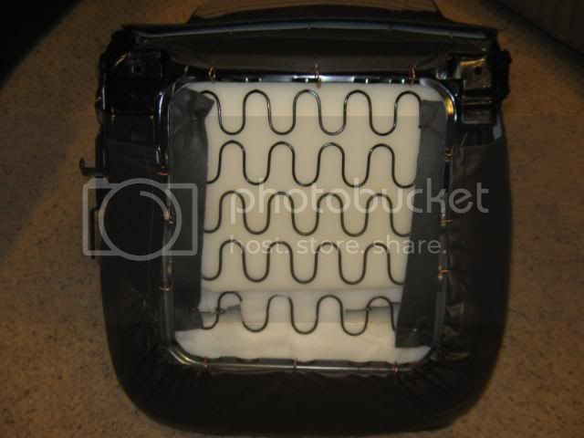

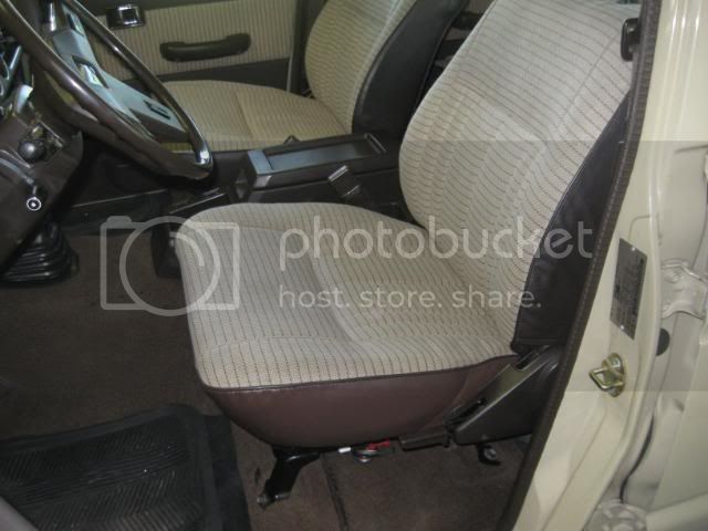

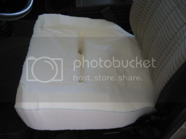

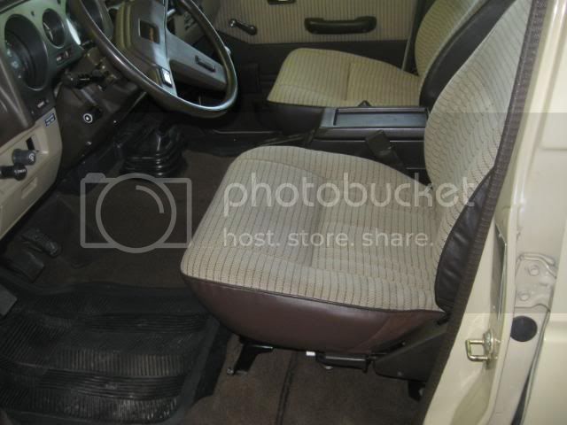

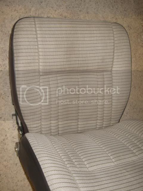

Here's what the seat looks like installed. As everyone else that has replaced their foam has said- I should have done this the day after I bought my cruiser. Night and day difference in comfort.
Notice the non-torn driver's side. The upholstery shop had a leftover piece of brown vinyl to use. Not a 100% match, but close. Charged $50.00 to replace the vinyl.
As an alternative, the upholstery shop showed me how they trim out worn pieces of foam and replace them with new. I did this on my DS to see how it would turn out. Use 3M spray adhesive or equivalent to glue the foam in place.
I also cut a piece of the firm 1" thick foam to place on top of the old seat. It is noticeably more comfortable- even on the non-worn PS.
