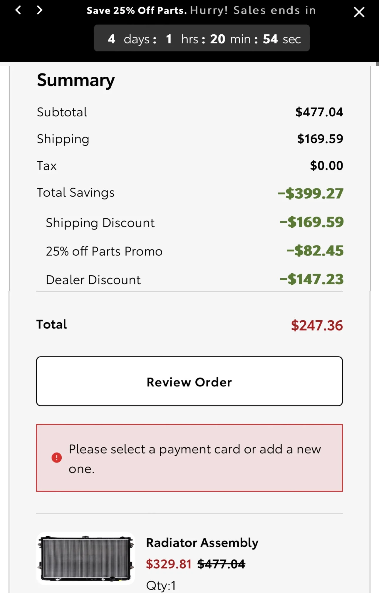

I just checked Toyota Decatur’s online shop now, it’s Go Time.

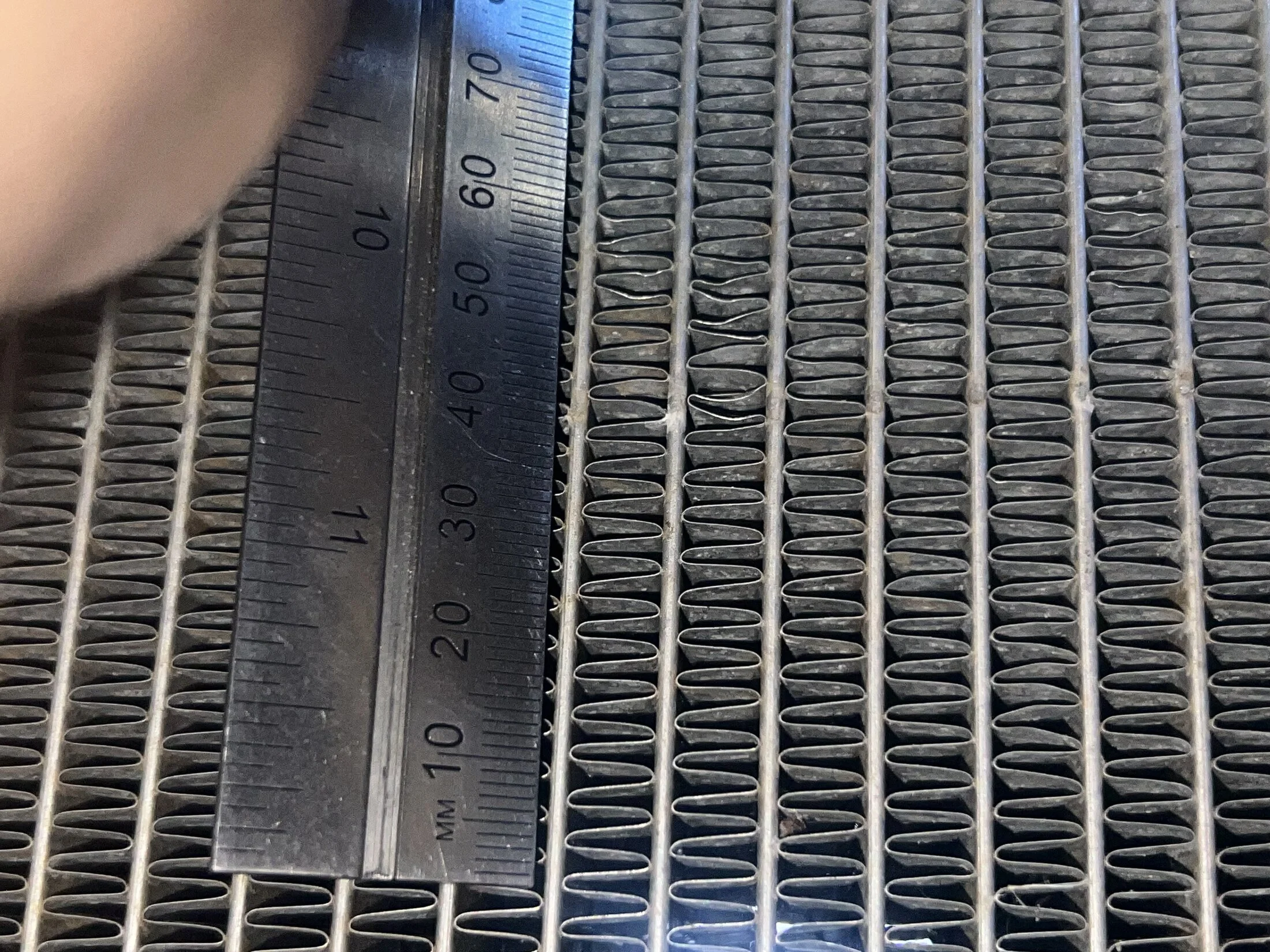

50290 has a different fin pitch. I have both in my garage. I will grab a pic for comparison. The fin pitch and spacing on 50290 is tighter.

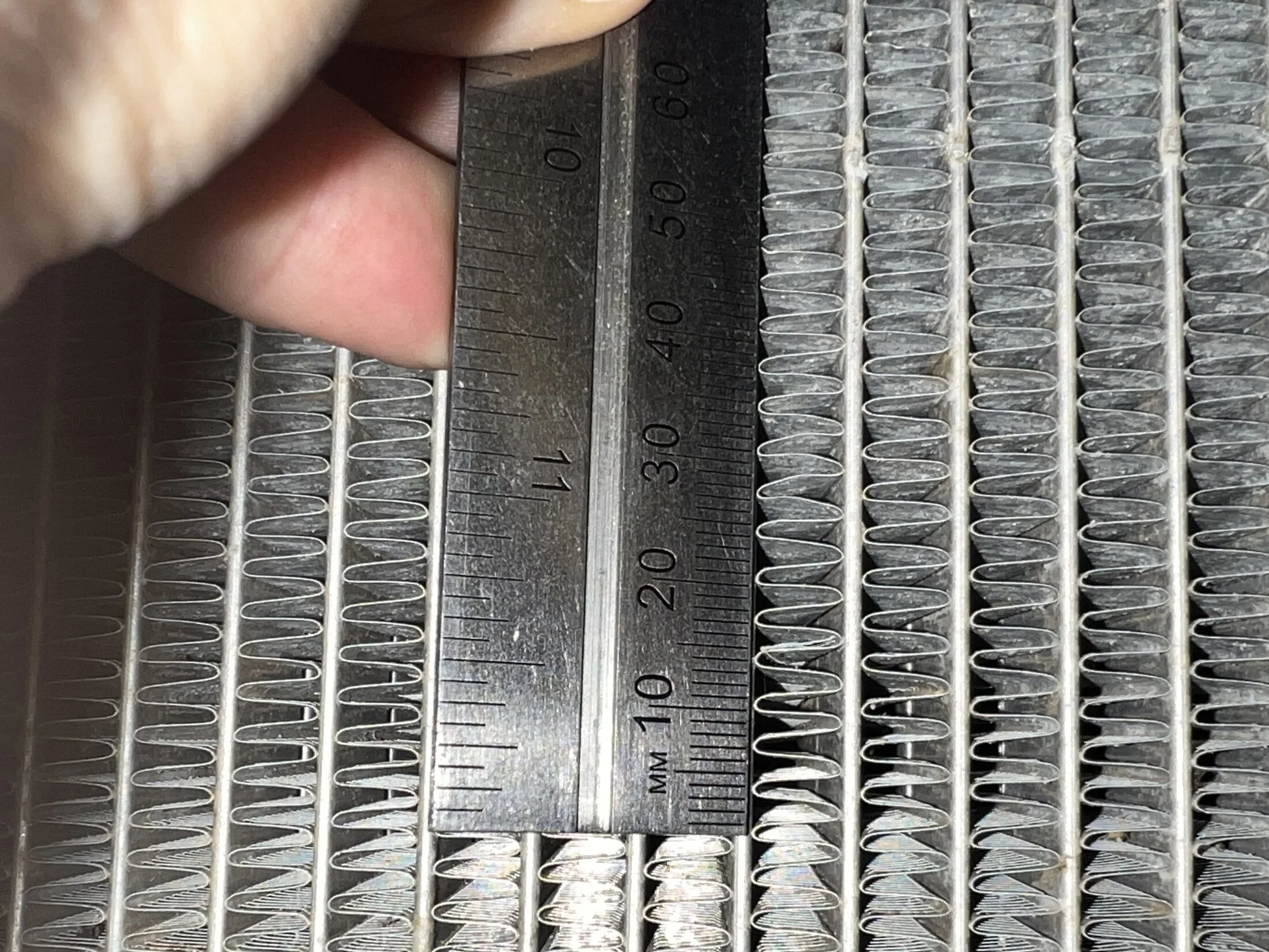

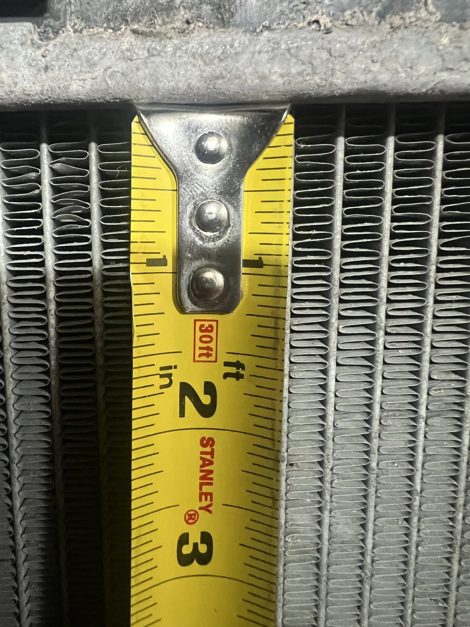

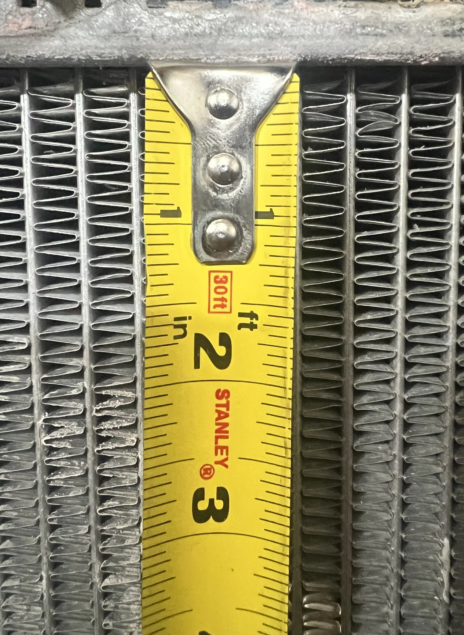

Anybody have an actual OE 16400-50360 they can measure in MM's?

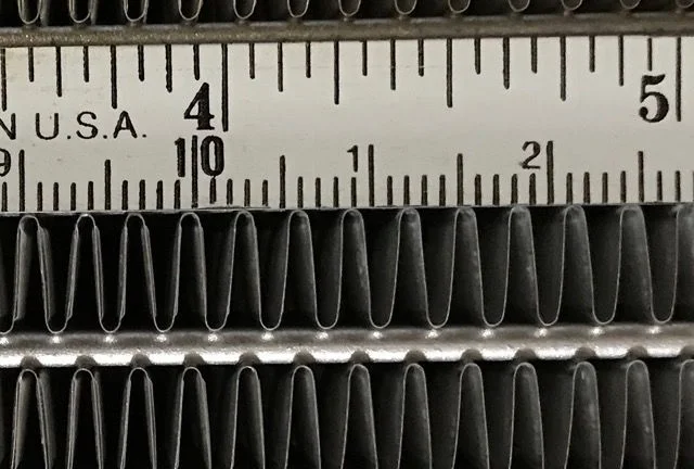

Here is the Denso 221315 (98-07) radiator. 3mm fin pitch.
Here ya go:
Not the best picture, but kinda hard to get the shot between the fan blades. Let me know if you need a better one.
Can't 98-03 uses SLL pink aswell?
I believe anyone can use SLL pink, but if you had the LL red in their previously you need to keep to that change schedule.
@awesomeissquid It looks like 3.5mm from the pic… though perspective is a bit from an angle.

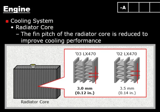

So 1998-2002 LC/LX has the 16400-50360 part number (3.5mm fin pitch) and the 16400-5029 part number (3.0mm fin pitch) was for the YM 2003-2007 LC/LX?
The original 98-02 part number was <16400-50210> and the original '03-'07 radiator was <16400-50290>
Some years ago, the 98-02 part number was superseded by <16400-50360>. More recently, it seems the 50360 radiator is listed as the replacement for all years 98-07. All these radiators are interchangeable and probably fine for all of North America.
The <16400-50290> radiator, is the best of the bunch but also more expensive and maybe unnecessary. I suspect it'll go by the wayside in the future. If you have a lot of trinkets blocking the radiator, the 50290 might be the best choice for all years.

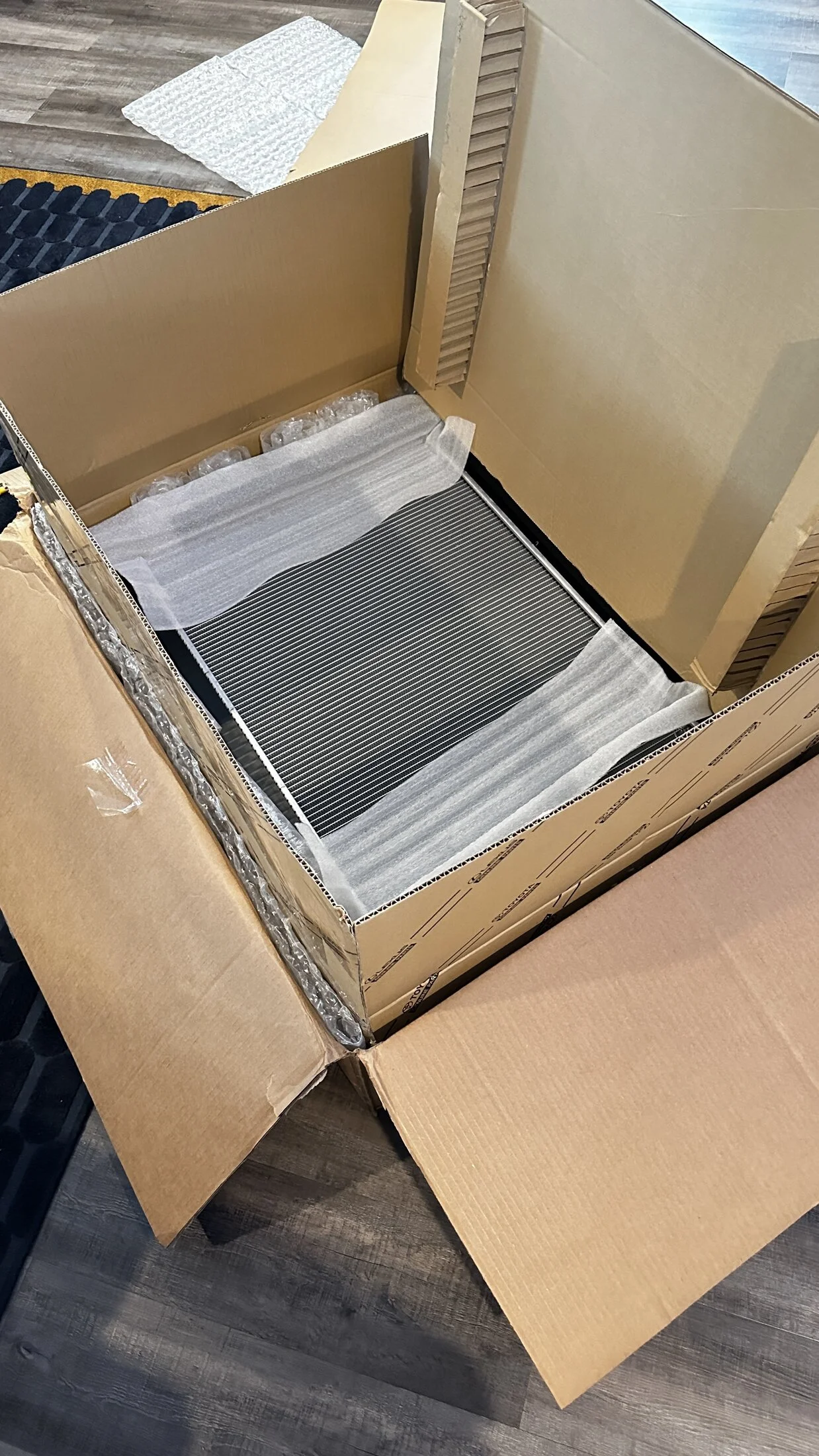

Date ordered from Toyota Decatur: September 8th. Received it today October 1st.
First impression, packaging is a 10/10, double-boxed. Checked the fins on one side and appears to be pristine without any bents.
Took a while but looks like it was worth it.
I was honestly expecting the worst based from the testimonies who ordered online. Inspected the radiator further and it came with the side foams and no distortion on the shape or whatsoever, even came with a brand new OEM radiator cap. For the price? Worth it indeed. Highly recommend the guys from Decatur.
Same experience here. Eric and crew are Serra Toyota did a fantastic job getting my radiator to me in one piece.
If you can wait for a 25% off sale and the month or so delivery time the OEM radiator is a no brainer, IMO.
