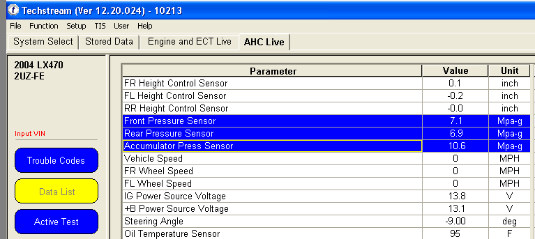

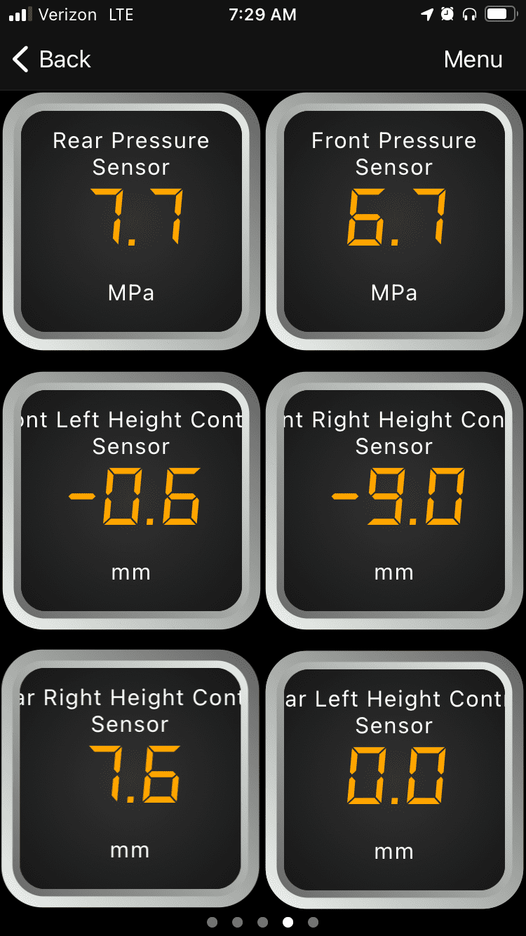

So, I was going through the steps and got the following readings from my height control sensors at neutral: it looks like my rear left isn’t measuring a change in height at all. Could this be a reason for my suboptimal ride?
There’s only one rear sensor - it shows up as the right rear on Techstream. Perhaps the 0.0 reading on left rear is because there is a placeholder for it in your software?
Ok this makes more sense. I appreciate your help.

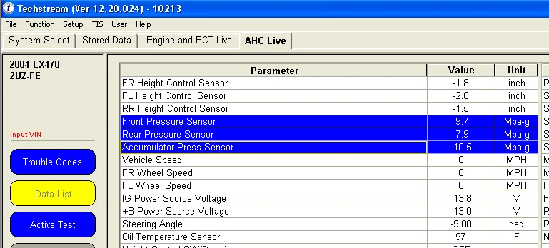

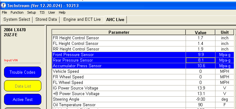

I knew it must have been discussed somewhere, and there does exists an over 40 pages of "Definitive list of AHC maintenance items". However, I'm struggling to read through all those posts to summary the correct way to use TechStream to measure AHC. Is it supposed to disconnect the temp sensor somewhere for the correct reading? Highly appreciate if anyone can point me to the right post...
I tried to read the pressure last night, and seemed could only read the pressure for "H" and "N". There was no reading (0) when at "L", or the pressure reading just stay unchanged when going from "N" to "L". Is this expected?
It seems my pressure was extremely high? Will the new globes relief the high pressure? Or I also need the new T.B., and/or Spring/Spacer?

Pressure readings are only really valuable when going from L to N.
Your pressures are a little high. Adjust the front until you hit the target (6.7 ish maybe?) And then we can discuss rear options.

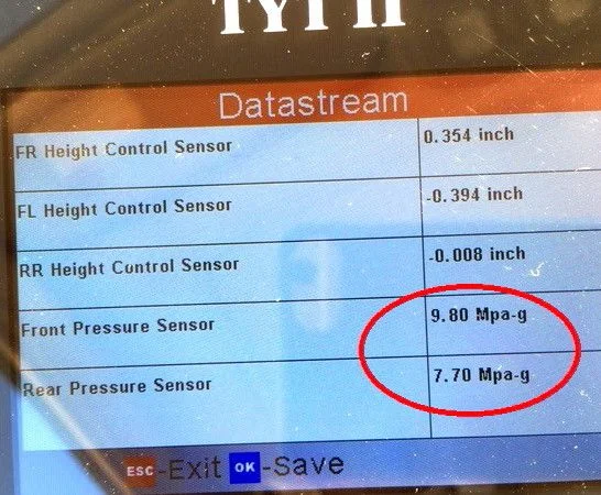

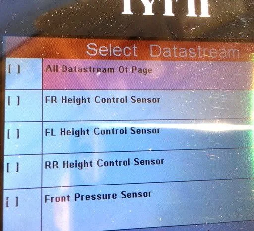

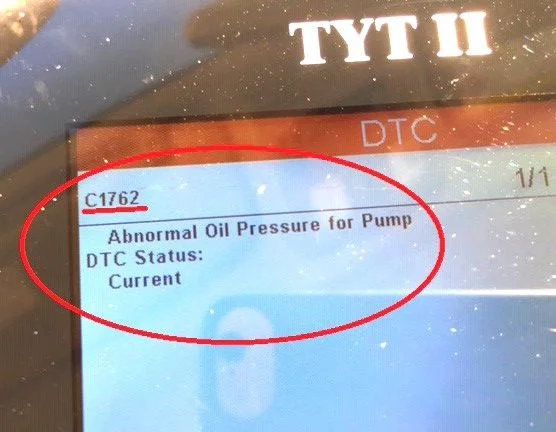

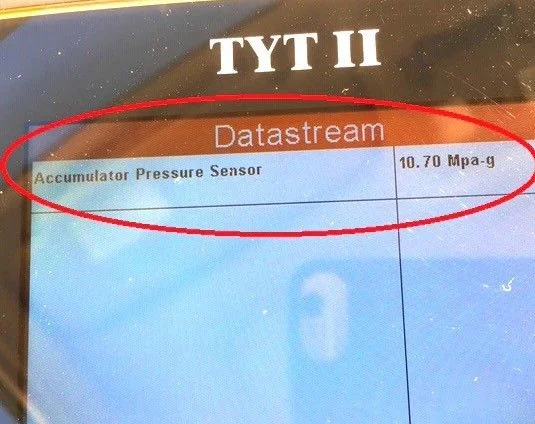

I need to attend to my AHC pretty soon too. Thought I'd play with my TYT II a little and see what it will scan/read on the AHC since I didn't want to fool with techstream. It showed a code (pump pressure out of spec). Then I was able to access my pressure readings and not surprisingly I am a bit out of whack. So I need to order new rear springs, new globes all around and go to work.....I suppose.
I apologize for the poor photos (glare on the screen), the sun was shining right into the vehicle.
