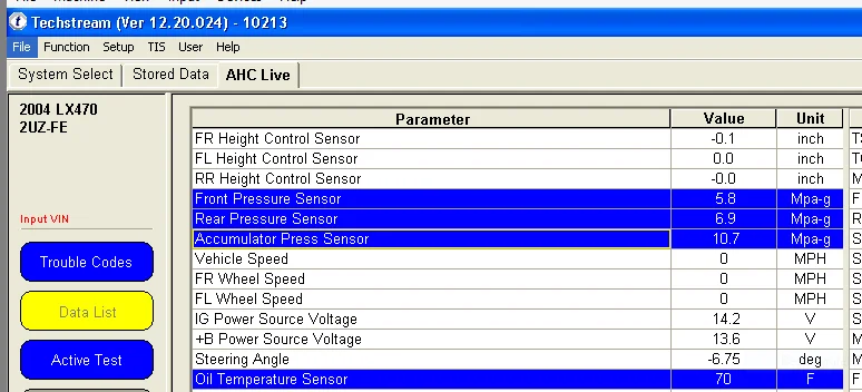

Can you try again and make sure that you see accumulator pressures before and after? You may need to let the car sit and idle for more than 60 seconds after any height change. When you see 0.0 in techstream for accumulator pressure it means the accumulator has yet to fill. It must be filled during both the before and after checks of fluid levels.
So I did another run of test, and gradation test is pretty stable at 9~10 ticks.
  • Front Pressure: 5.8 Mpa (6.4 if I sit in)
  • Rear Pressure: 6.9 MPa (7.1 if I sit in)
  • Accumulator Pressure: 10.7 MPa
  • Gradation test: 9~10 steps!
Really don't know why the gradation test is getting better from 6 ticks, after cranked the TB. I also did a test drive over bump, and expected the ride should be better with the better gradation test result. However, I couldn't feel any difference, and the ride of LX is still bumpier than my other SUV with conventional suspension, no matter if I set the suspension to Comfort or Sport.

Rear pressure is a bit high, front is a bit low. If you don't plan on adding any weight, it might be worth a turn off the torsion bars. Rear would benefit from a pair of spacers or King if you plan to add weight (sorry if you already mentioned changing springs).
I wouldn't expect those minimal pressure deviations to cause a bumpy ride, though.
Is it bumpy at all speeds? Or just low speeds? If I recall, you've got old rear control arms. That's improved both my 100's, though more with my 99 at 275k than my 06 with 225k. Probably worth doing if you plan to keep the car a while.

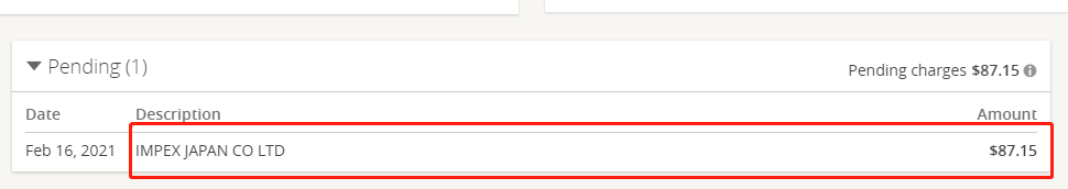

Finally my orders got updated. Just paid the shipping and now count the days...

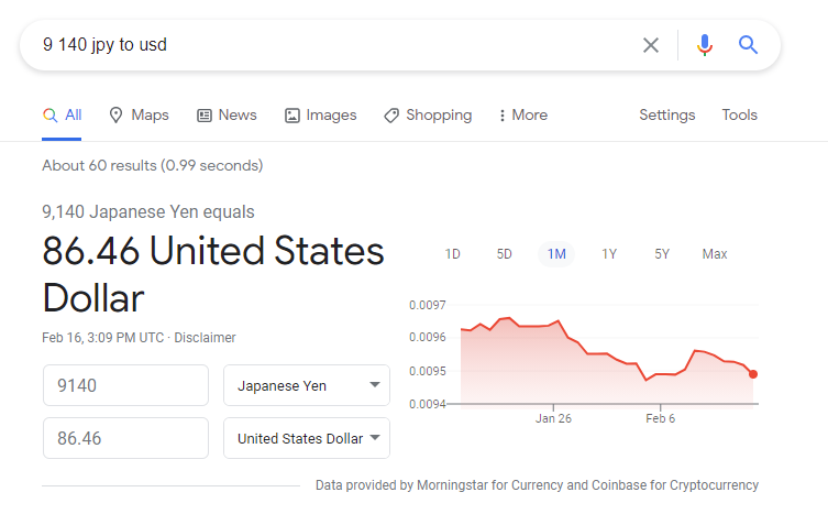

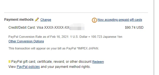

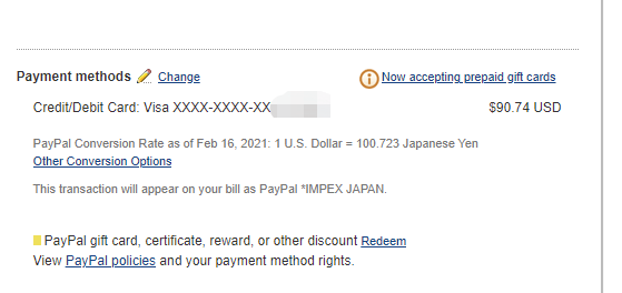

Just to show how much PayPal may over charge you by using their default currency conversion.
The total shipping including tax is 9140 JPY, and PayPal will charge you $90.74, while the normal exchange is $86.46.
By click the link highlighted, "Other Conversion Options", to change to directly bill JPY to my credit card, my Chase card only charges me $87.15.
However, you have to make sure your credit card doesn't charge foreign transaction fee which lots of card don't.

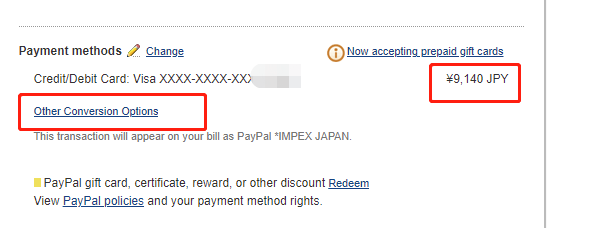

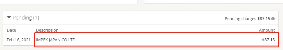

View attachment 2586924View attachment 2586931
View attachment 2586932View attachment 2586934
Four dollars.......
Damn that PayPal...! ;)

I think what we're seeing there is Paypal charging pretty typical foreign transaction fees. Most free credit cards charge foreign transaction fees and since Paypal is a free service that makes total sense. Their fee might be an extra 1% high, but no biggie.
It is good to be aware of foreign transaction fees, though. The cards I use now all have no foreign fees, but if you're not aware of that you can get an ugly surprise if you buy a long list of items from Partsouq or Impex and pay foreign transaction fees.

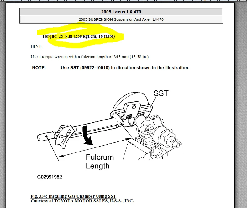

Finally I replaced the 4 globes over the weekend with the one ordered from IMPEX Japan. With the info/tips/knowledge shared by the great people in this great community, like @PADDO , @suprarx7nut , @tjb , @IndroCruise and ..., the whole process went smoothly.
A couple of experience want to share:
  • For the 36mm Fan Clutch Wrench, I rented this set from O'Reilly. It worked pretty well even the opening is slightly larger than 36mm. I have to mention that the store staff told me they didn't have the tool for loan when I first went directly to the store for it. However, when I came back and ordered it only, it's available for pickup within 1 hour! One thing to keep in mind is that O'Reilly requires to return the loan tool within 48 hours for a refund.
  • 3 of the globes could be easily removed with the fan clutch wrench, except for the front driver side one. It was because of the position, once fit the wrench onto the nut, didn't allow any movement to loose it. So the wood chisel I bought from Harbor Freight Tools worked nicely to remove this one.
  • Per the FSM, Pg. 362, of 2005 LX470 "suspension and axle.pdf", the torque for the globe is minimum 18 ft-lbf. However, there is no way to use the torque wrench with the rental wrench. So just use it as reference.
