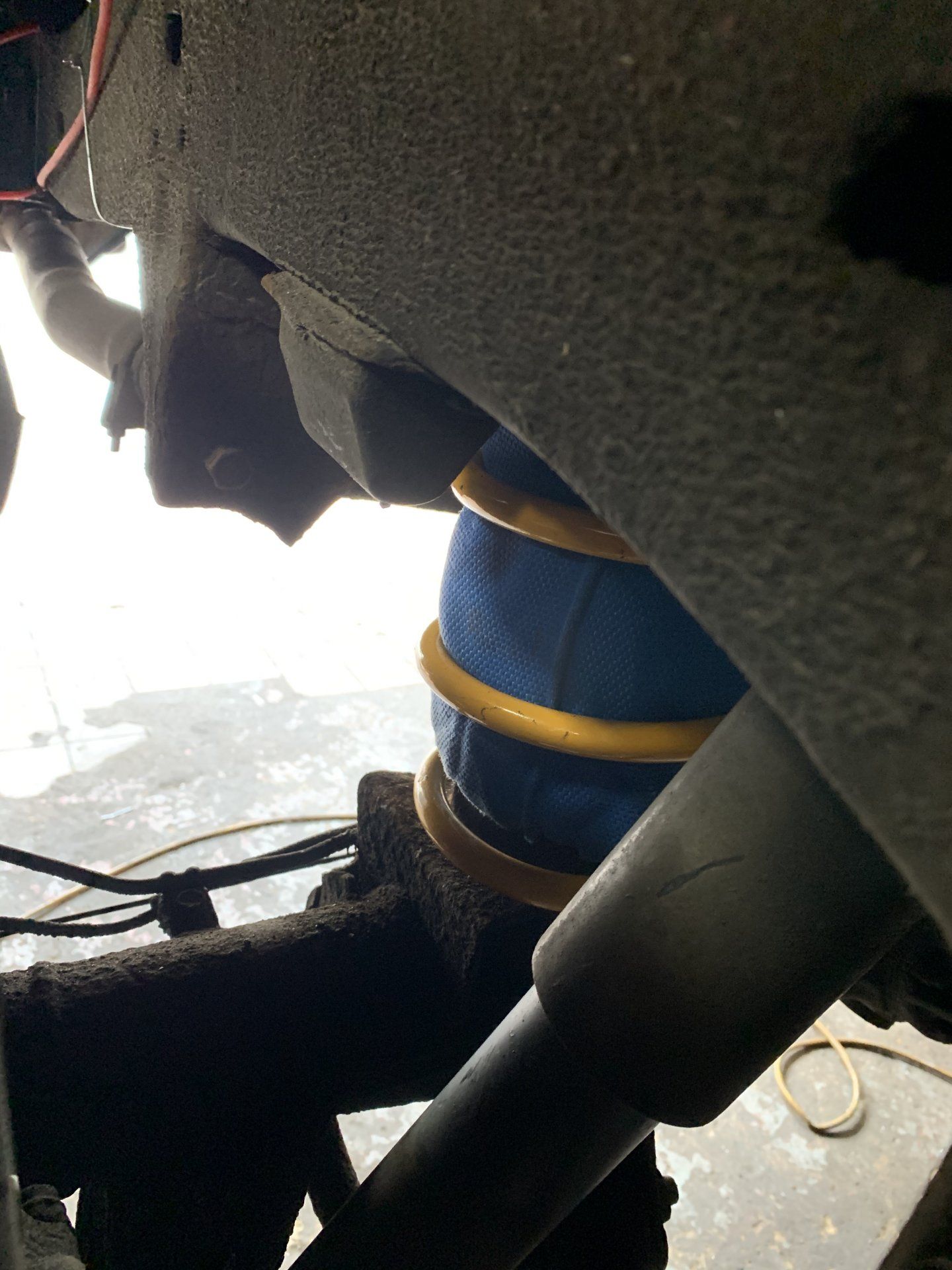

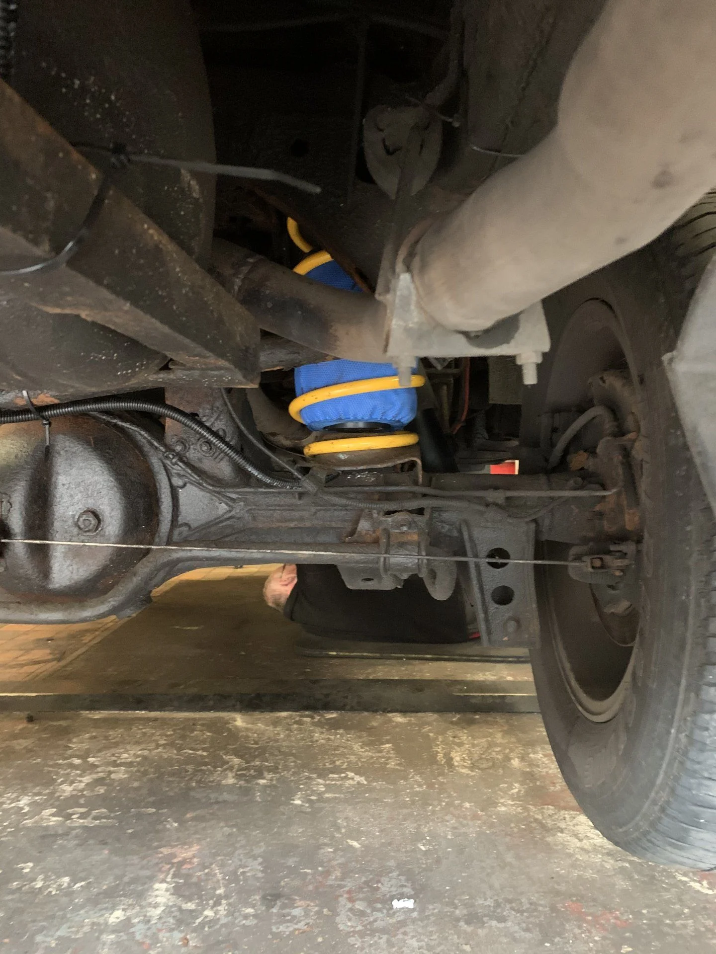

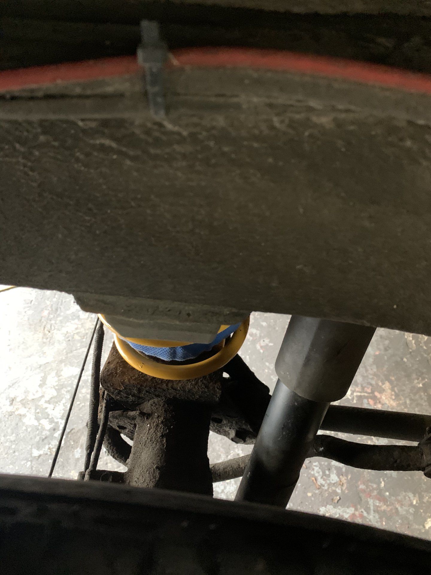

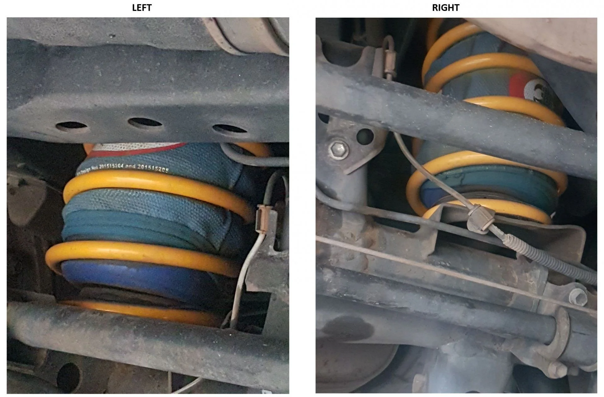

I fitted King KTRS-79 springs and at the same time included similar Firestone airbags for AHC from CR5114HP - Air Suspension Helper Kit for Coil Springs - High Pressure .
The KTRS-79 springs have made the ride a little more firm when the vehicle is empty but is very good when heavily loaded for long distance travels. The compromise suits our use and there have been no complaints from Mrs Indrocruise or other passengers!
The airbags have been operated with air pressures as @saudi describes for a little over year in a variety of outback conditions. They certainly are very good for variable loads. Did I really need the King springs AND the airbags? I am not so sure about that. The King KTRS-79 springs were better for my application than OEM replacements and I did not want to fiddle with spacers. Maybe the airbags could have come later if really required. The lighter alternative of OEM replacement springs with spacers plus airbags was considered and may have given slightly more ride comfort as well some ability for variability loads but I am happy with the stronger springs. Anyway, it is done now.
I liked the idea of the additional stone protection that comes with Kevlar sleeves -- but after a year and many height movements from "N" to "HI" and back (as well as movements from time to time "N" to "LO" to "N" and "LO" to "HI" and back when testing AHC pressures and 'globe' condition via HI/LO Test, etc -- the sleeves are slipping.
Raise times have been getting progressively longer -- now about 30 seconds from "LO" to "N" without a load, about double the time suggested in the FSM -- and so I am wondering about friction between the airbags/sleeves and the coils slowing the raise, or, whether I have a tired AHC pump or problematic height accumulator. I am thinking the Kevlar sleeves may come off -- they are not achieving much when the airbag is left exposed.
Anyway, it would be very helpful if you could please advise whether you are experiencing longer suspension raise or drop times since installing your airbags?
