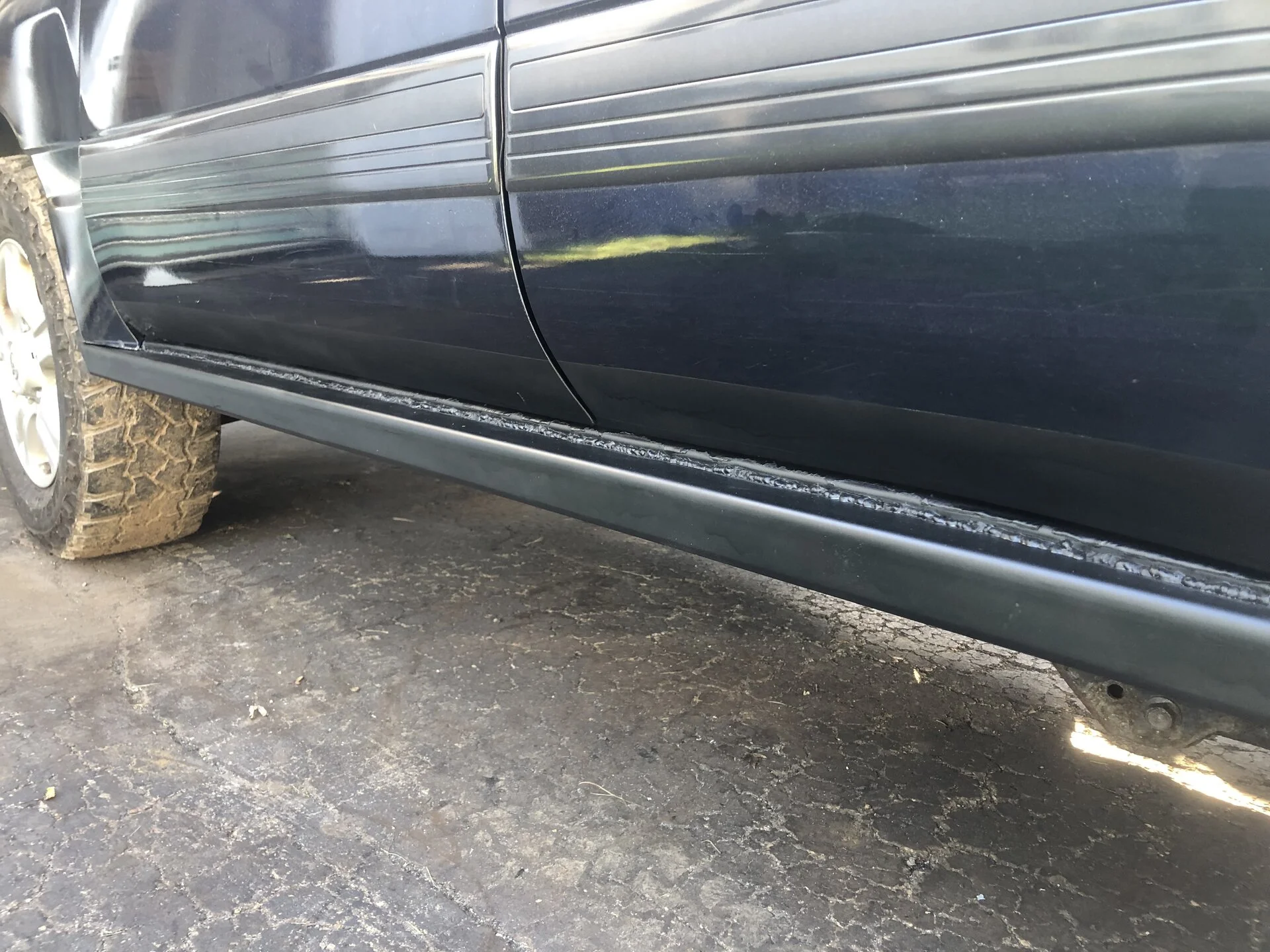

Does anyone know if they exist and have a link for them?
I hope to attack the rust in mine this summer and would rather have some preformed Panels to work with rather than forming them by hand.

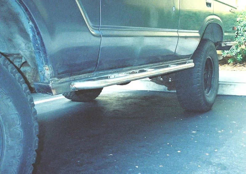

There was a guy in Poland on eBay at one point, but shipping was like $400. I chopped mine and tubed them.

I did this to my Sprinter van a few years back. Cut out the inner and outer sections and grafted in 2x3 .083 wall.

The biggest thing with this job is weld heat and balancing that heat. The tubing I used is 1/8th wall and the body panels obviously much thinner.
I planned to follow up your thread with my process or make a new one, but until then I would be willing to share any notes with anyone attempting this.
It’s also worth noting that I in no way intend for these to be a full weight slider option. I view them more for light duty body protection (small trees, brush, etc) and an easy cheap choice to replace roached rockers.

Right on! I don’t see them as a full on HD slider either but they are 2-3” higher than a normal slider and the higher up, the less work they get. The added clearance will be nice.
I had the problem regarding welding the existing sheet metal to the thicker box tubing. No matter the settings on our welder I would too often blowing thru the sheet. I was able to knock it down and clean it up fairly well. Adding a coat of paintable body schutz to the rocker section really helped clean it up.
The welding took forever. I was advised by one of our engineers on my approach. All welds were about 2” in length max, alternating from the front of the truck to the back, pushing my weld in opposite directions. Another key was I took the outer rocker skin and used a tube drop to hone in on my weld settings and figure out my technique for welding the opposing sizes. It was an entire weekend of welding all day - 4 welds over 6’ long while trying not to a) burn and crack the body and b) still get enough heat penetration without blowing through.
Still super solid after a year plus.
